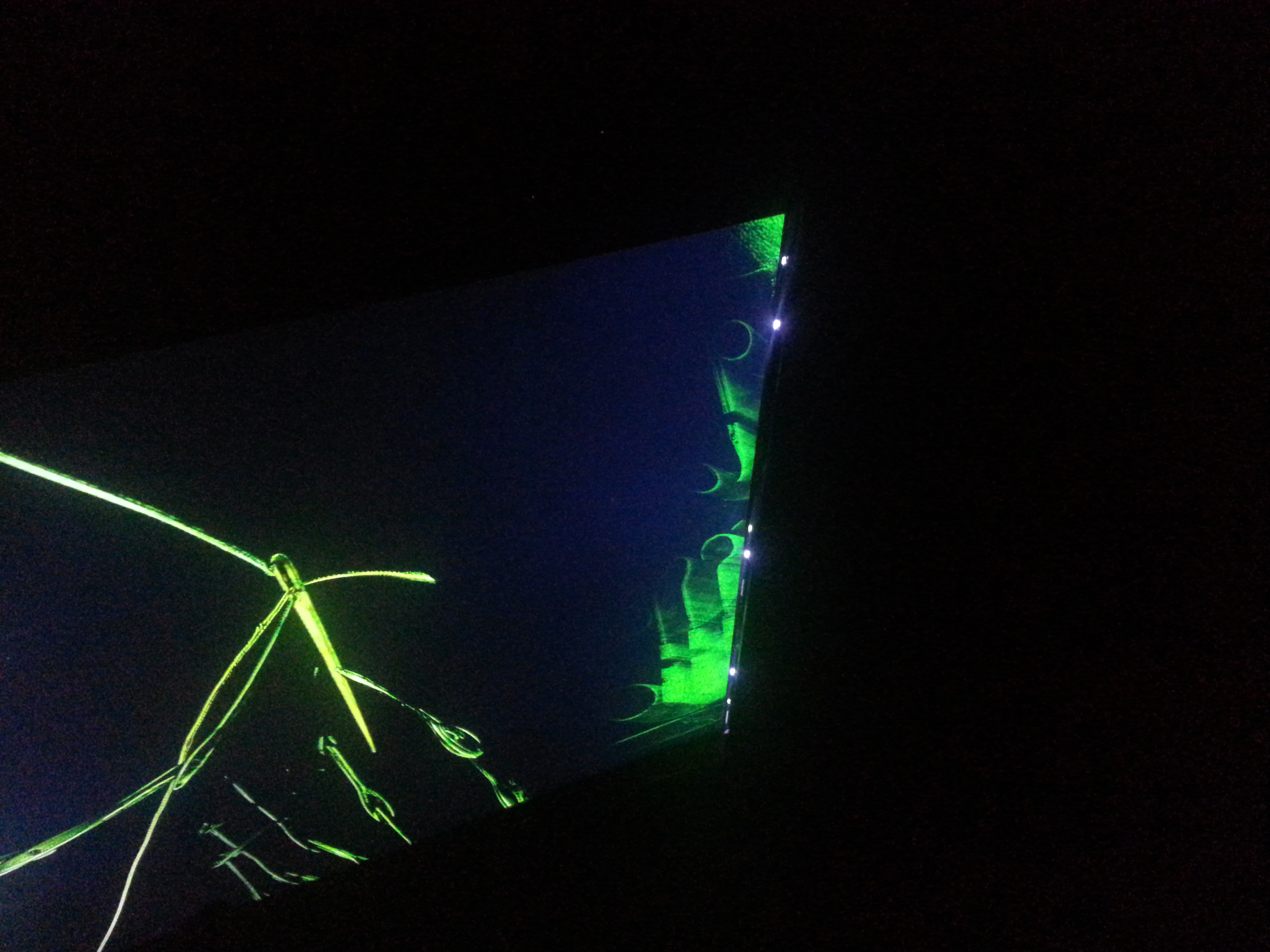

    Sharp Aquos LC-70LE650U Turns on and works but displays is slow
    The TV is choppy, images and text are not clear, and there are horizontal lines at first until the screen freezes and then starts to display vertical lines. It looks like the screen has a 1 second refresh rate.
    After I first pressed the menu button. After a second the menu shows but everything is slow.
    After a few minutes the screen froze and it started with the vertical lines. It first started on the right side if that matters.
    I can take pics of the back if needed, first set came out grainy.

            Re: Sharp Aquos LC-70LE650U Turns on and works but displays is slow
            It looks like this now
            And it takes 5 seconds or more before the menu screen starts to slowly fade in.
            Are these the tab drivers?
            The screen also is showing this
            The screen seems to go from black to green to white and back to black.
              no... those are the interconnection cables between the two side edge boards. There are three tab driver cables on the top edge board and two on the bottom.
              BUT your latest pictures are "not looking so good"... :-( :-)
              The side drivers usually affect horizontal issues. There are also ones along the lower edge boards (can't remember how many). You might try reseating the cables at the tcon board (cleaning the cables first with some "spirits").
              NOTE: you can help yourself with some "simple" checks. Disconnect one of the tcon cables and see what happens with the picture (of course, with the power off). Then repeat the "test" with the other side of the tcon. IF the picture improves with one side versus the other, you can go from there.

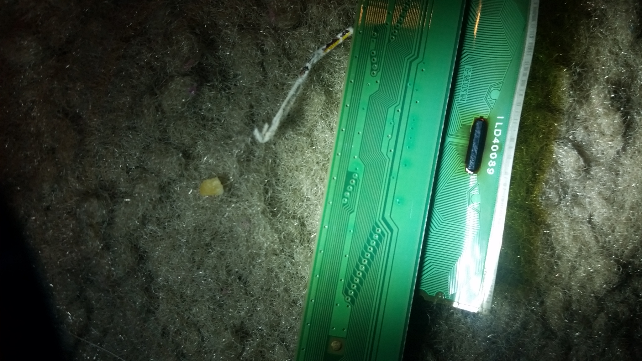

                          The left side is perfect other than the vertical line.
                          I was pressing on the tabs and one of them was very hot while all others were not. This is on the right side bottom.

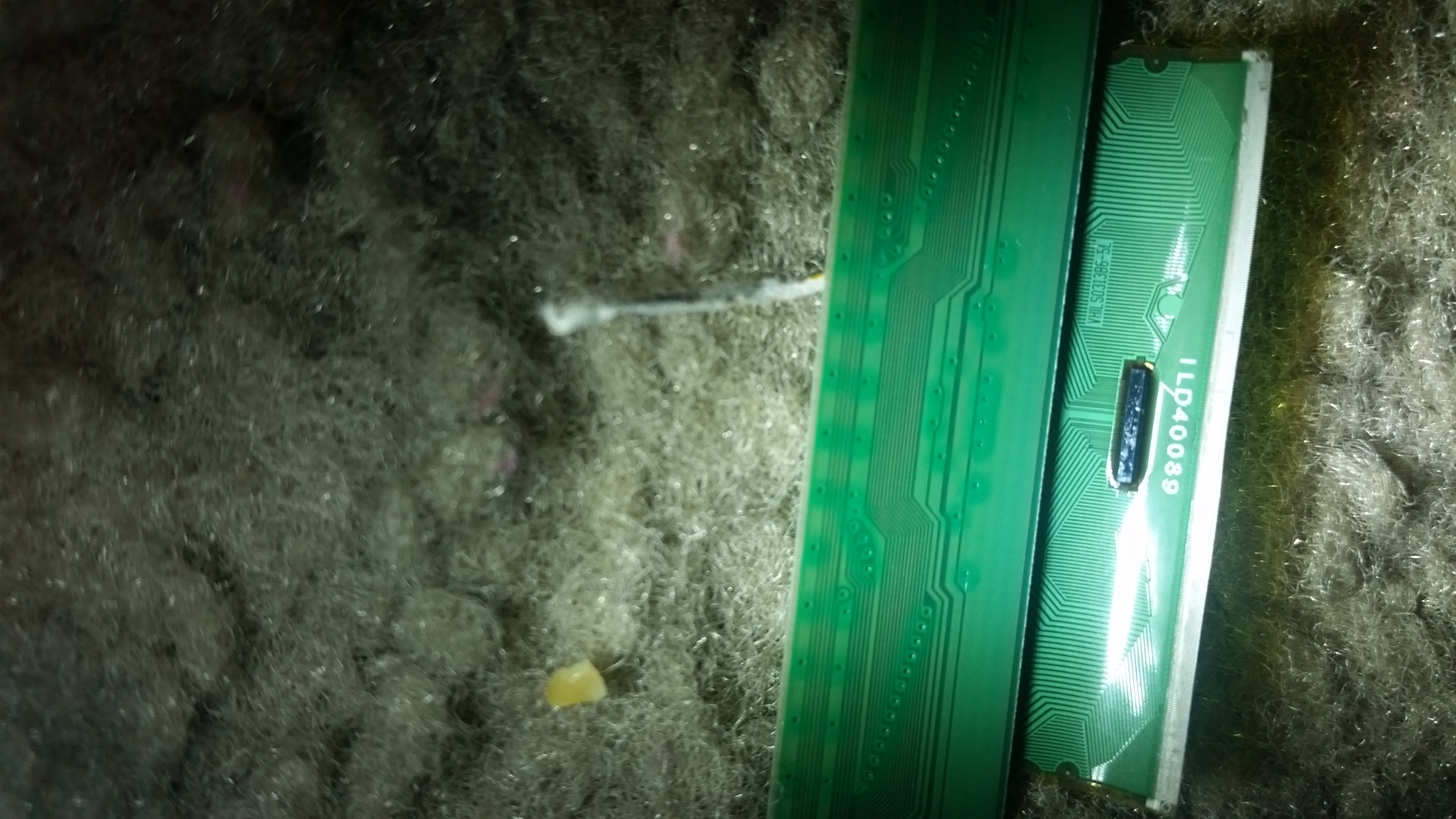

                                Okay first of all it's easy to mistake that hot tab bond with the bottom of the panel getting hot. Normally the bottom of the backlight drivers where are the LED strips inside the TV are Normally get very warm. For some reason I noticed on a few of these that I have worked on just the bottom of the LED backlighting is very warm to the touch feeling it from the metal frame on the back side. In order to successfully determine if your tab driver is getting hot is to keep the boards away from the panel and then feel it if its still hot it's definitely shorting out and therefore if that is the only tab that is getting hot and the others are cold to the touch I would definitely say it's causing your problem. Those are not supposed to get hot they stay moderately cool to the touch when operating properly. Honestly if it were my TV I would say that the t-con is OK because we have an operating left side with the right side disconnected and we do not see the inherent problems that we are seeing with all the tab drivers connected. I would honestly go ahead and remove those tabs and the driver boards from the right side of the screen. But that's just me if you feel confident with doing that go for it. Replacing the t-con will most likely put you in the same situation you're in now. This is of course a non reversible operation. And knowing what I know now about Sharp LCD panels I would say that this is a 99% repair success. Of course this only adds time to an inevitable failed panel but I have not seen anything yet on the other side from the operation that we have performed on this forum. Mine is the first one to have that operation performed being a Vizio using the sharp 70 inch lcd panel and it's been running solid for 2 months with no hiccups.
                                That picture you took of that tab on the very bottom looks awfully dark in the center. Compare that driver IC with the other drivers on those boards. If it is darker in the center than the other ones which should not be dark at all then it is definitely bad. What's happening is that it is dragging down most likely the 1.0v core voltage on the tcon board. This is causing a plethora of different visual problems on the screen including vertical lines and slow refresh. It's obvious that these tabs short in a different manner on various panels that I have seen on this forum now. Some present themselves with a solid stripe across the screen, others present themselves with a rapidly flickering screen, some present themselves as a solid black line going across the screen and then others just completely short that tcon out shutting it down completely. In on sharp tvs it will shut down with a 2-5 blink code if the short gets bad enough and the voltage drops significantly on the tcon board to trigger a fault.
                                Here is what a good driver ic should look like.
                                  And here is a failed one. Notice how dark it is in the center around the perimeter of the IC?
                                    Is it possible to heat and remove them while the panel is still put together or do I need to remove the top part of the panel?
                                    • freakaftr8
                                      • Oct 2012
                                      • 3743
                                      You should be able to just pull them right off you do not need to heat anything up. And what do you mean by pulling the top part of the panel off? It looks like you're already to the point where you can remove the right side ribbons. Judging by your picture.
                                      Your metal frame surrounding the side of the panel is the only metal frame you have to remove and it looks like you're already to that point
