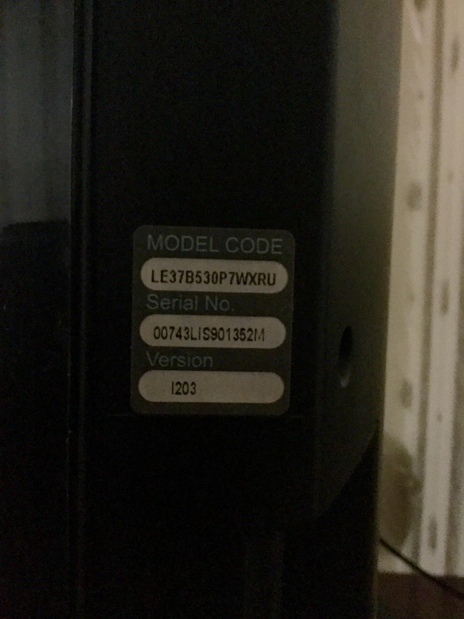

                  I am posting this here as I believe the issue on my TV is also a backlight problem. I am going to follow the steps in this thread, as well as similar ones here, but I wanted to post my specific problem in any case.
                  I have a Samsung LE37B530, specifically LE37B530P7WXRU (Russian model). The issue I am having is that when I power on the TV I usually get a black screen with sound. If I shine a flashlight on the screen I can see very faint images. Sometimes the TV will work normally and occasionally I get screen flicker intermittently.
                  The issue seems to have worsened over time as it started with just flickering when I was using the TV with my laptop via HDMI. Now it is almost always black screen with sound. I reset the TV to default settings via remote (exit button for 12 seconds then chose reset when it appeared on TV) but it did not seem to have any effect.

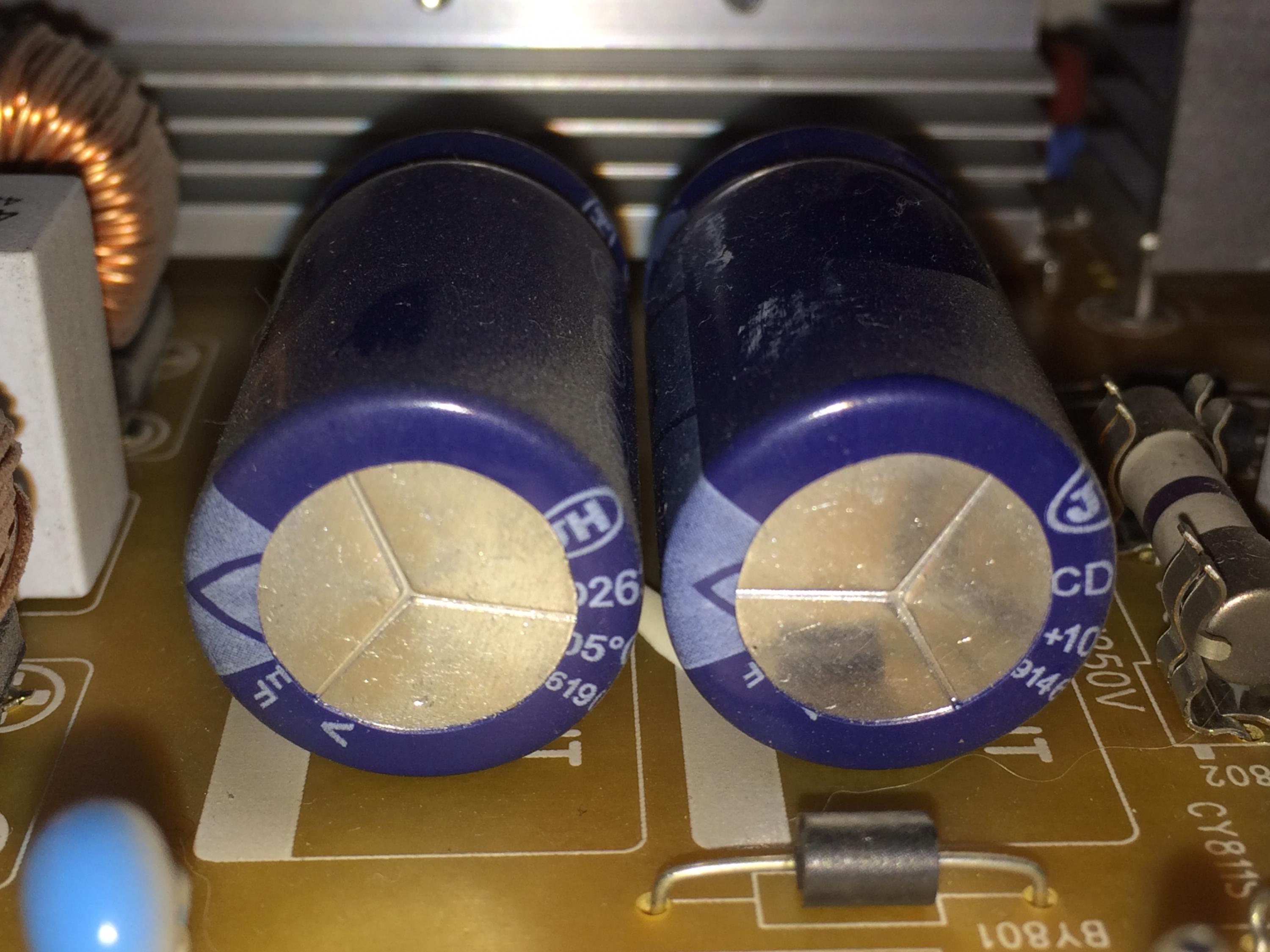

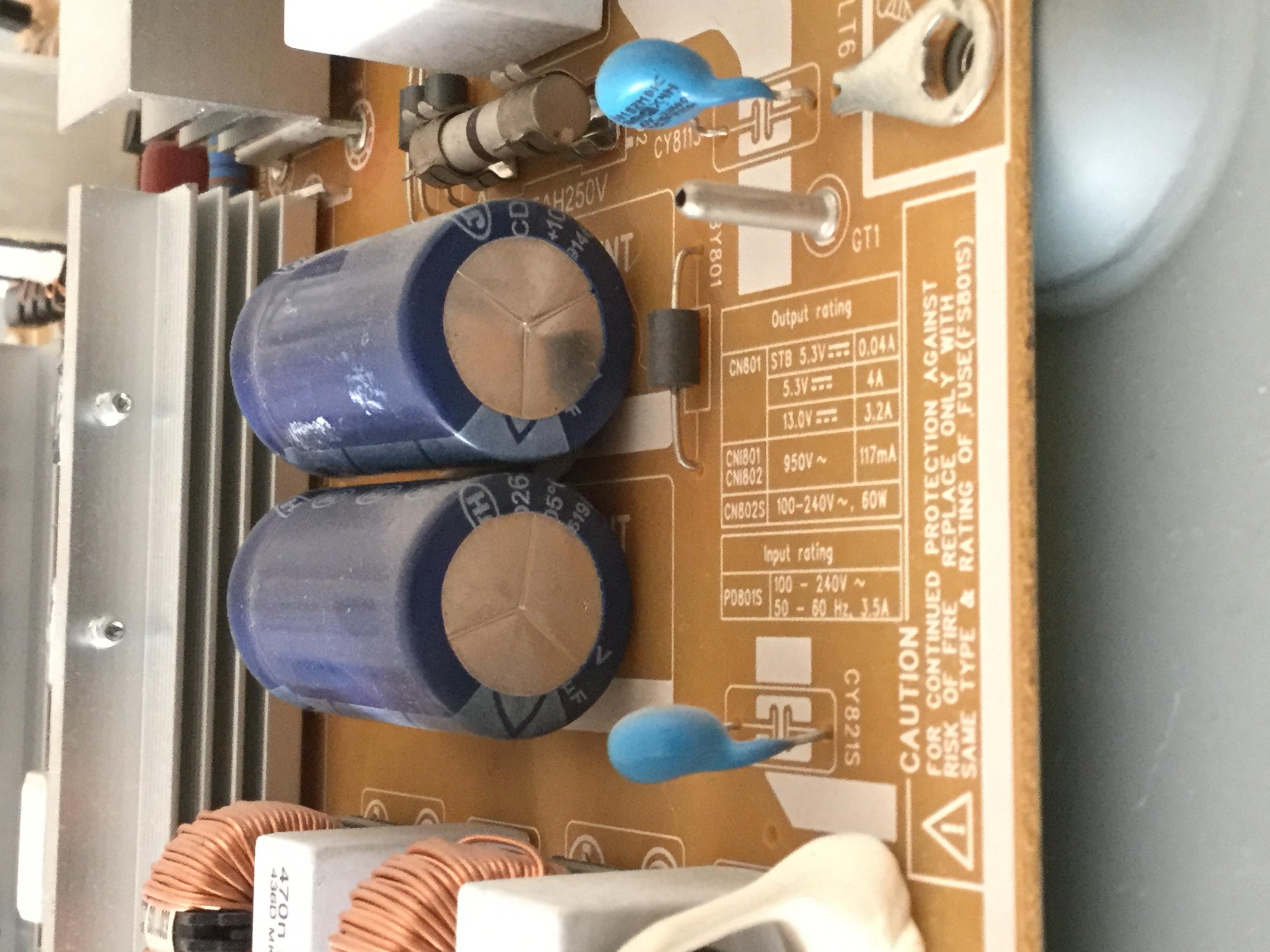

                        Re: Samsung le37b530 flickering backlight
                        I would check the DCV between the two legs of the main filter cap to see what you have, it should be around 380~400VDC.
                          #32
                          Sir, thank you for the response and advice. I assume you mean the 2 big blue capacitors in the attached photos. I set the multimeter to 1000 DCV and get a 1 reading on both capacitors.
                            1VDC? Are you sure your meter is OK? Where EXACTLY did you put the meter probes? TV plugged in and turned on?

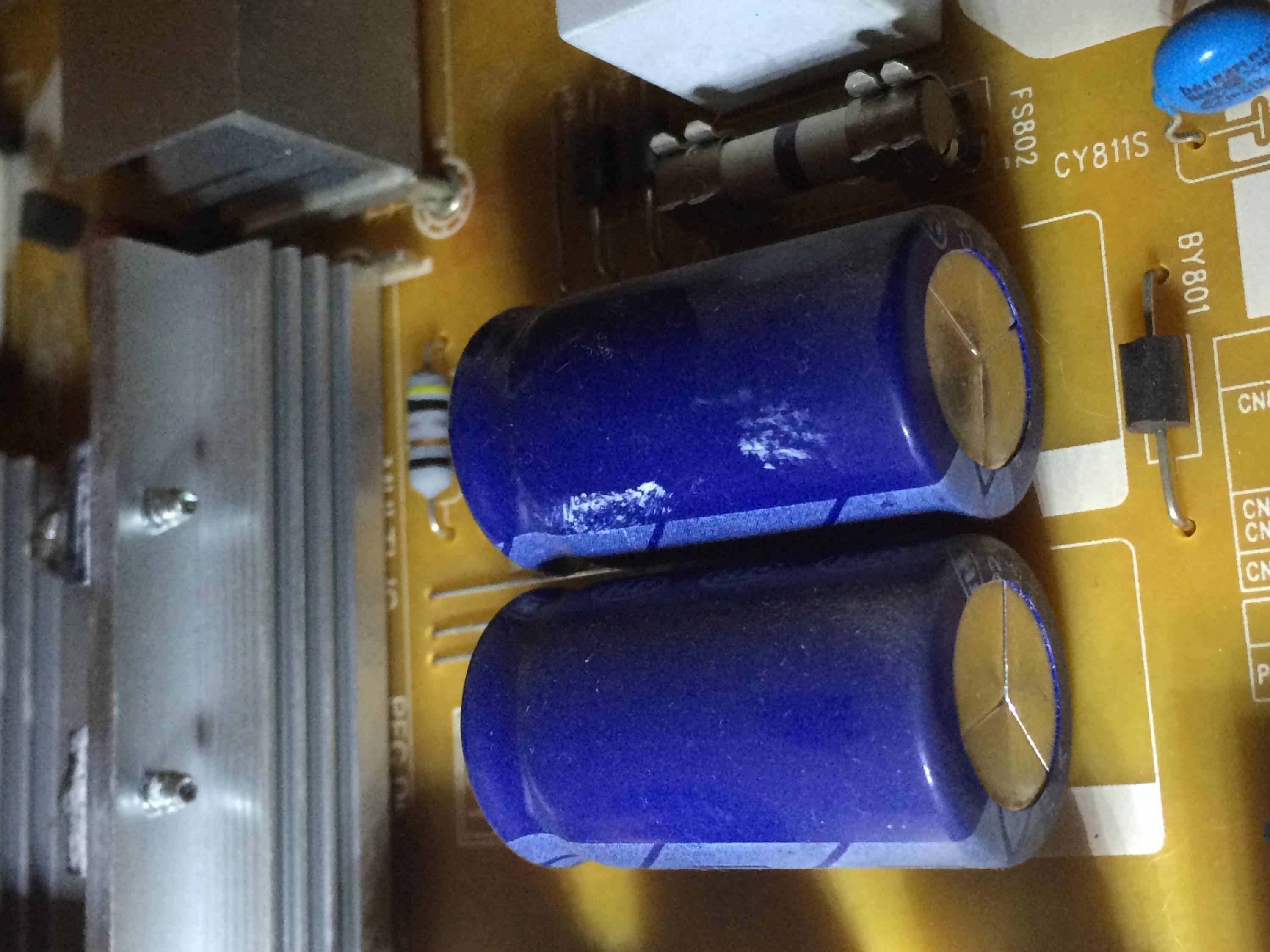

                                  The meter is telling you it thinks it is OVER RANGE even on 1000 VDC scale which is impossible. The meter is bad.
                                  Roger that. I'll go get a new one on the 1st.
                                  I'm assuming the capacitors are likely the problem with the TV due to the intermittent problem. I had a similar issue on a PC LCD once and replaced the capacitors. It still works fine 6 years later. The capacitors also aren't bulging but they aren't as recessed as I think they should be. I'll attach a pic but it is likely hard to tell. Obviously I'll do more proper troubleshooting once I replace my meter.
                                  Thank you for you assistance and advice!

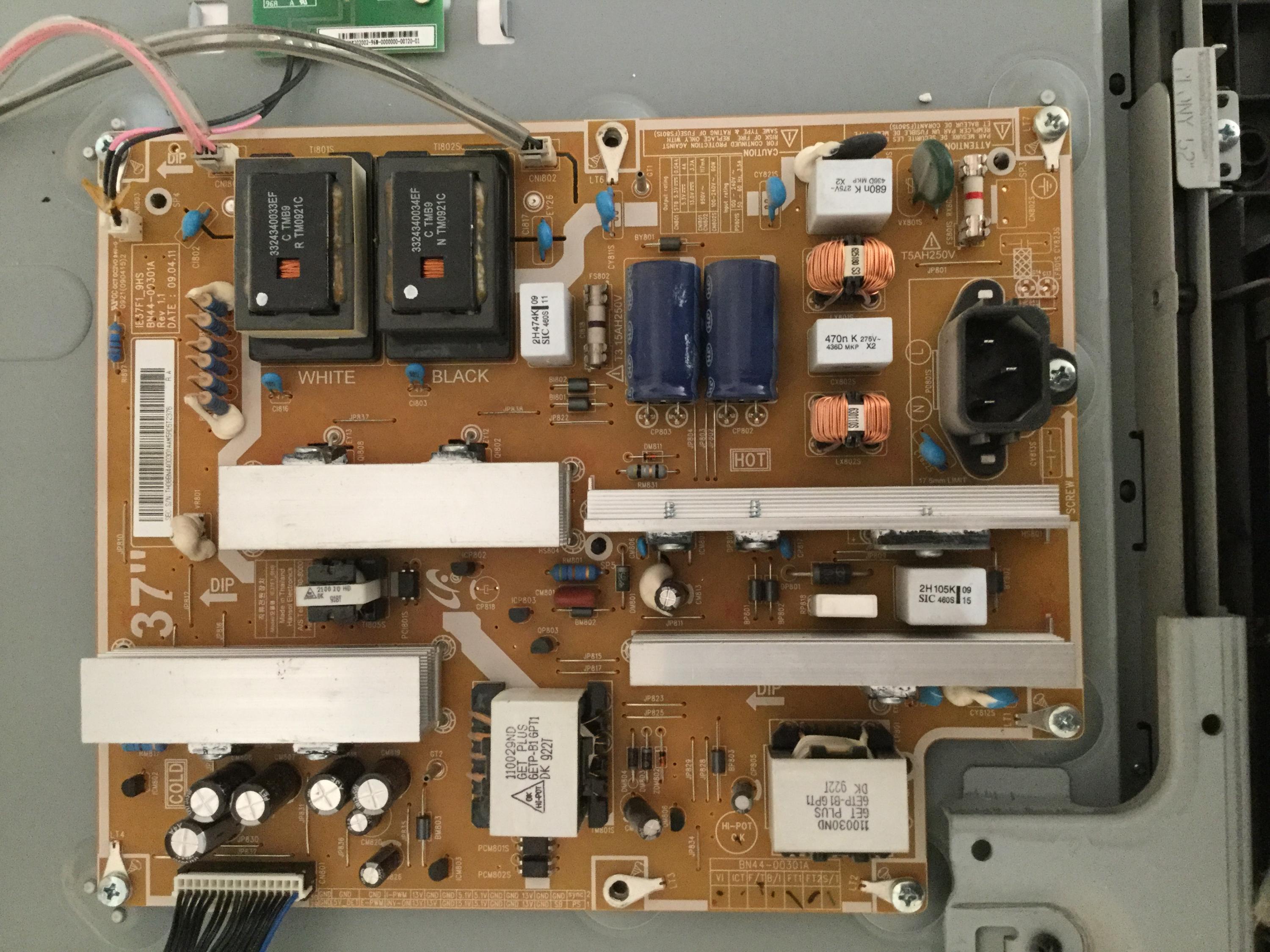

                                    I am not suspecting the main filter caps problem but the PFC Boosted Voltage problem that is on the edge of shutting down/restart.
                                      #38
                                      Any idea where that would be and what it would look like on this TV? I understand the concept of what it is but otherwise lost on that one. Here is the service manual for this series of TV.
                                        https://drive.google.com/open?id=0B4...FROQ19IeXV1cm8
                                        That is why I have you measured the Voltage at the two legs of the main filter caps, but you need to get your meter to read the dcv correctly first.
