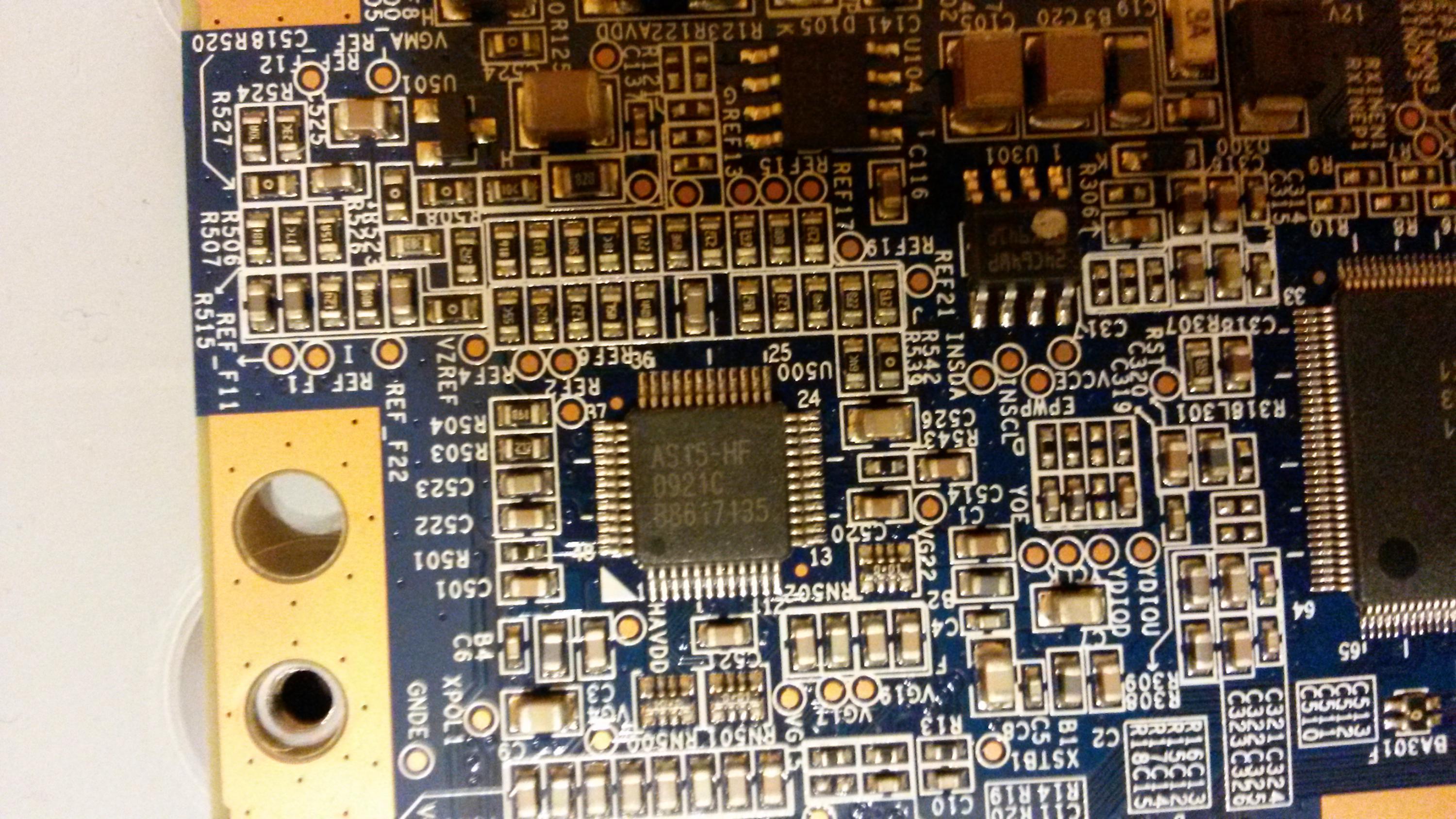

                        • apeter1
                          • Nov 2015
                          • 21
                          • Hungary
                          Re: Samsung le37b530 flickering backlight
                          There is AS15-HF chip on the tcon.
                          Could it be fault?
                          Thanks,
                          Péter

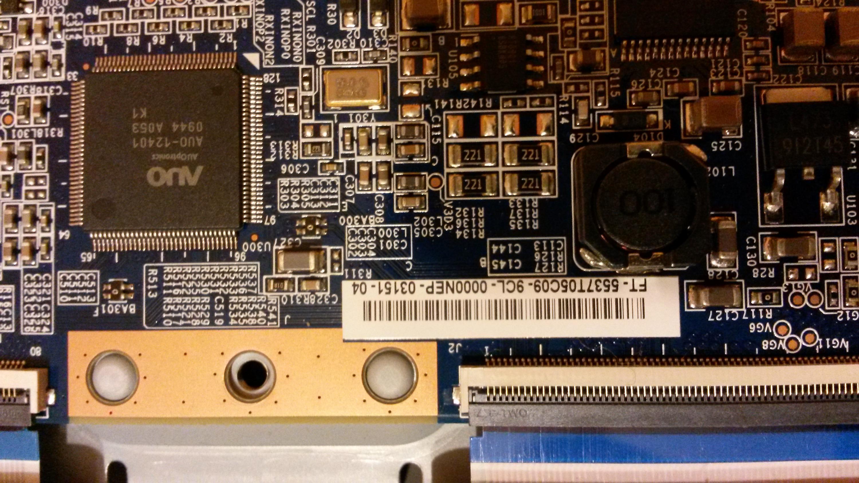

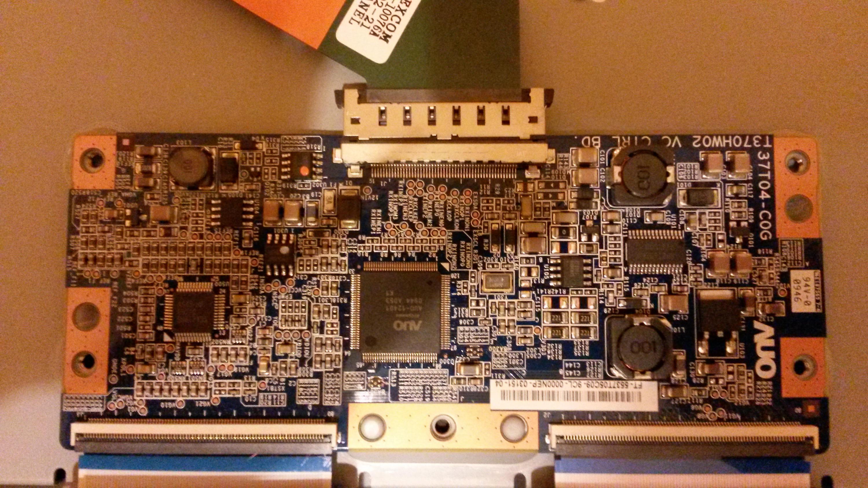

                            I'm posting pictures...
                              How goods your soldering
                              If you able to solder try changing it out.
                              Is it getting quite hot when tv is on ?
                              • CapLeaker
                                Leaking Member
                                • Dec 2014
                                • 8196
                                Tough call... Tcon or the panel itself. Post the voltages of the as15...
                                  It is very hot when tv is on. How mach chance that the Tcon is bad?
                                  I would repalce the Tcon is not too expensive. The soldering may very difficult for me.
                                  Tcon no.: FT-5537T05C09-9CL-0000NEP-03151-04
                                  Is only this number with Tcon good for this TV?

                                      • cliff_hootarski
                                        • Jul 2006
                                        • 411
                                        use 55.37T05.C09
