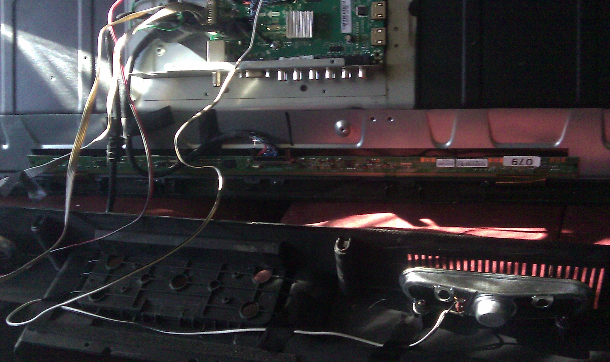

                    #49
                    Re: oCosmo Model CE4001-HM06P7A,....completely dead..no standby light....
                    update....using remote .....tv does power on and backlight comes on but no picture...no osd...nothing
                    fyi... tv tcon is not removable.....so any ideas?

                              #54
                              update..i get 12v at fuse on tcon........both sides. ....lcd panel not turning on...no pic no osd...nothing

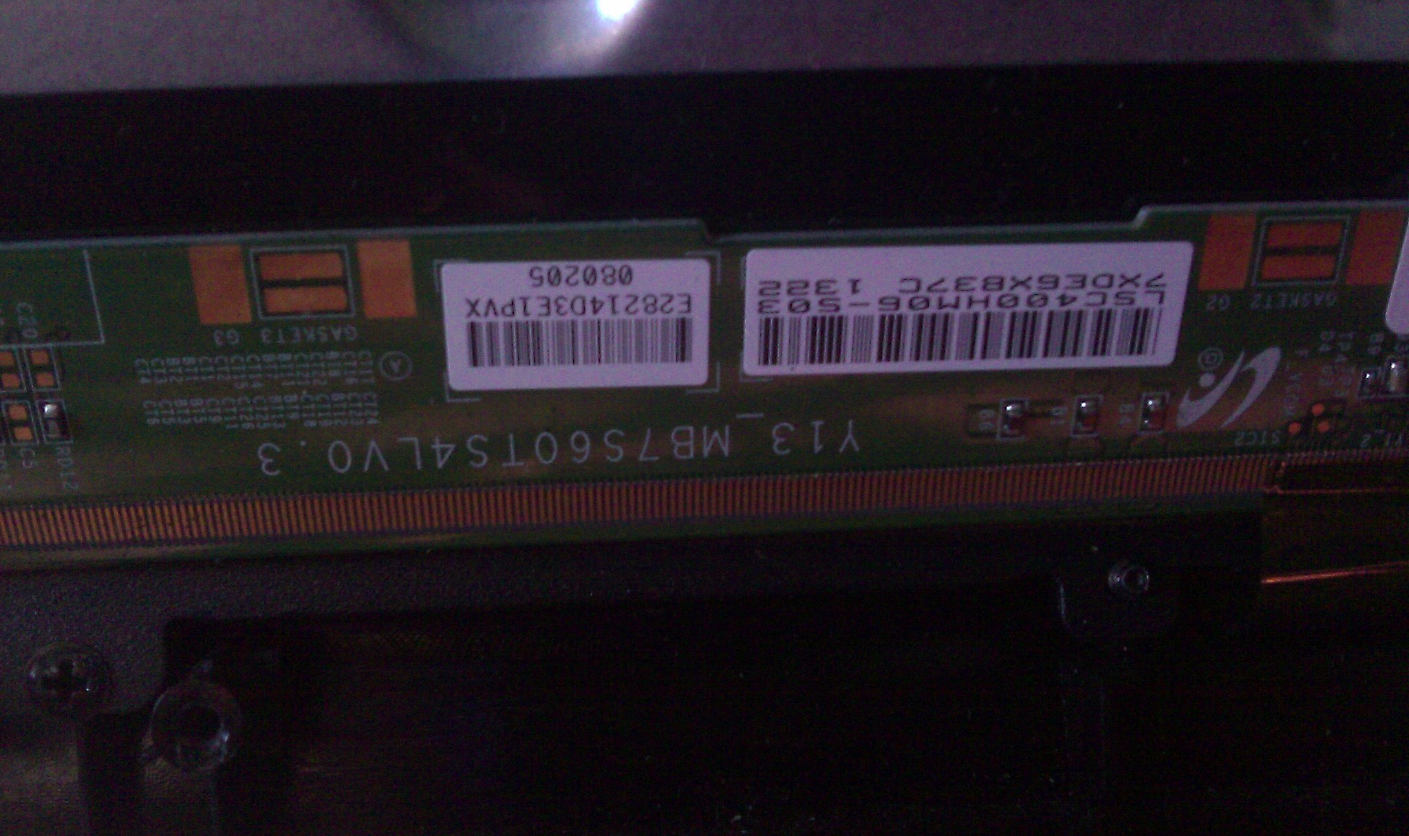

                                        #59
                                        here is a pic of the unusual tcon board that appears to be not replaceable
                                        the ribbon cable is permanently connected to the tcon and possible to the panel

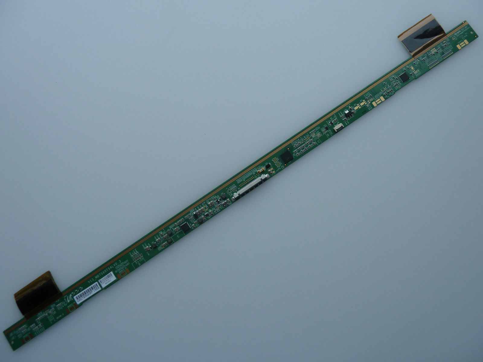

                                          #60
                                          now im confused....where does the ribbon cables attach if not directly to panel
                                          here is a photo of the board out of tv from some ebay seller ....item was sold
                                          but it appears it may be replaceable.....i would have thought the ribbons go from tcon directly to panel like most lcd tv i have seen
                                          i cant find this part anywhere online at all..........nowhere
                                          im hoping it may be replaceable and not diresctly mounted to the panel like i thought it was......usually the ribbon cables are directly mounted to panel and then hook up to the tcon via connectors....from what i have seen but this one the cables are mounted permananet on the tcon
                                          i still do not know if the board is def or the panel is.or bad connection to panel...i fo get 12v at the fuse on the tcon but panel will not power on
