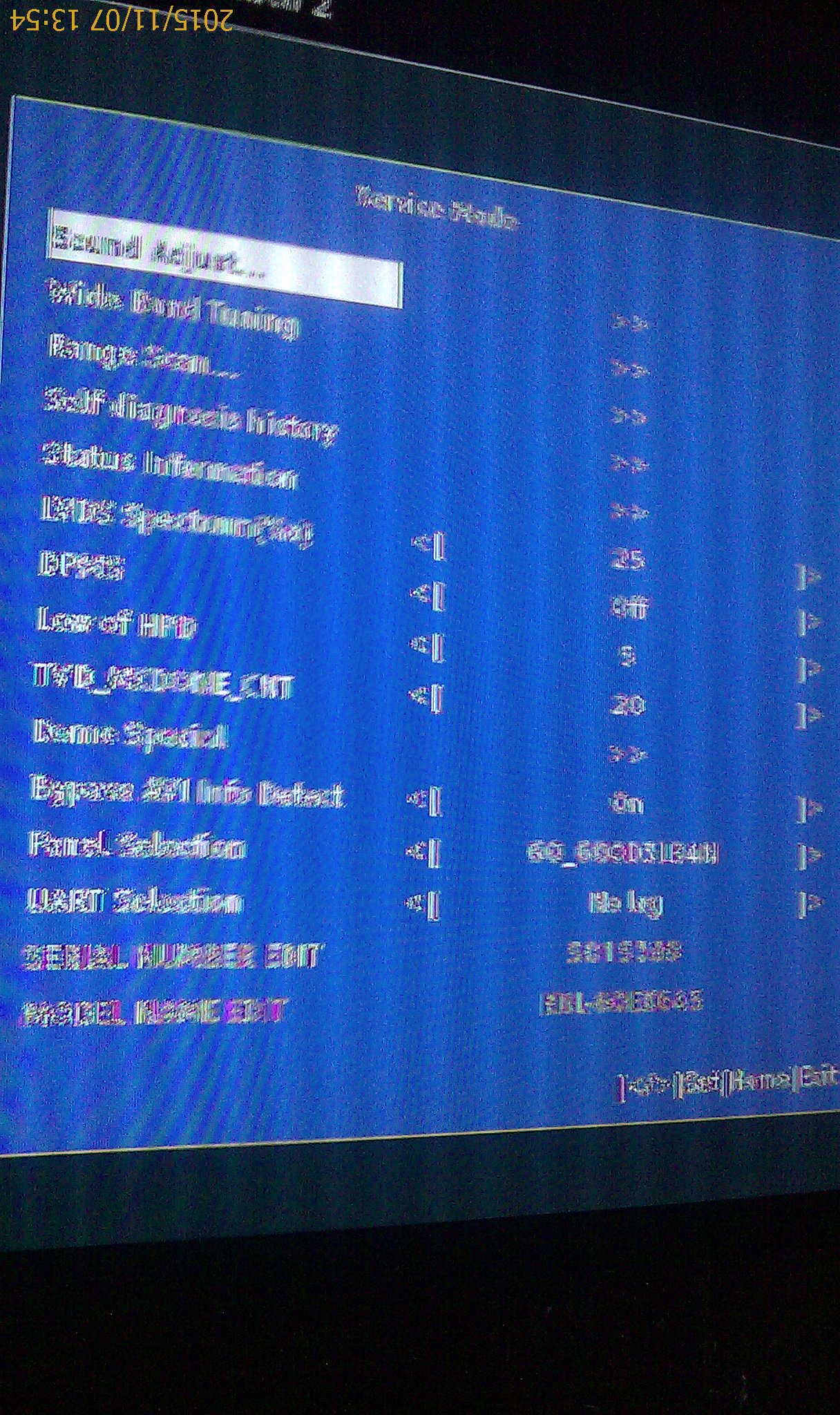

                #47
                Re: lcd sony KDL-46EX645, ...standby light is on....will not power on..no clicks..
                attached it a photo of service menu screen its hard to make out since display is messed up but f anyone can direct me to where there may be an adjusment to fix the issue that would be great
                im still thinking the board is bad or not compatible for some odd reason but ill try anything at this point and i rotated the pic 180 degrees so it can be easier to read since display on tv is upside down

                  #48

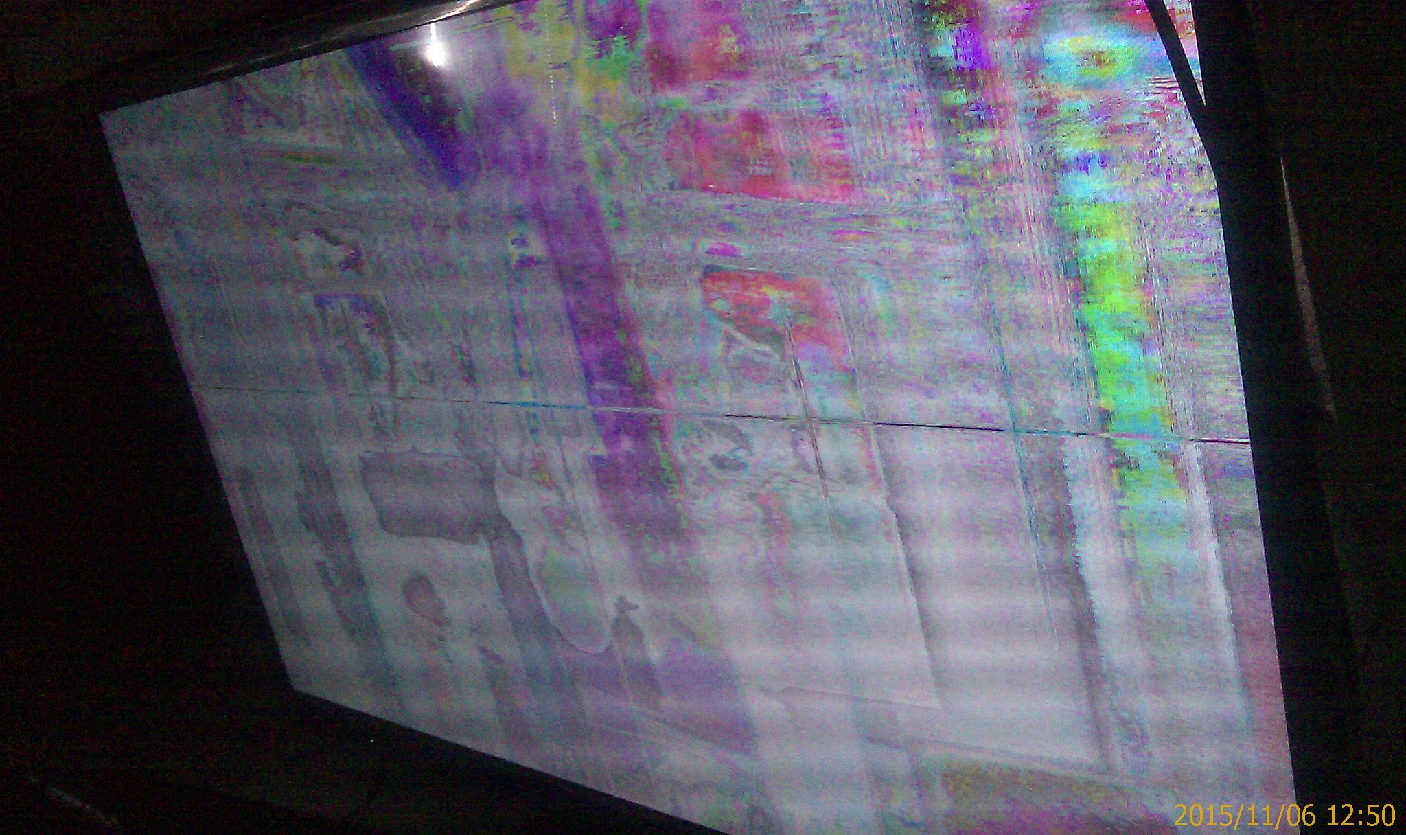

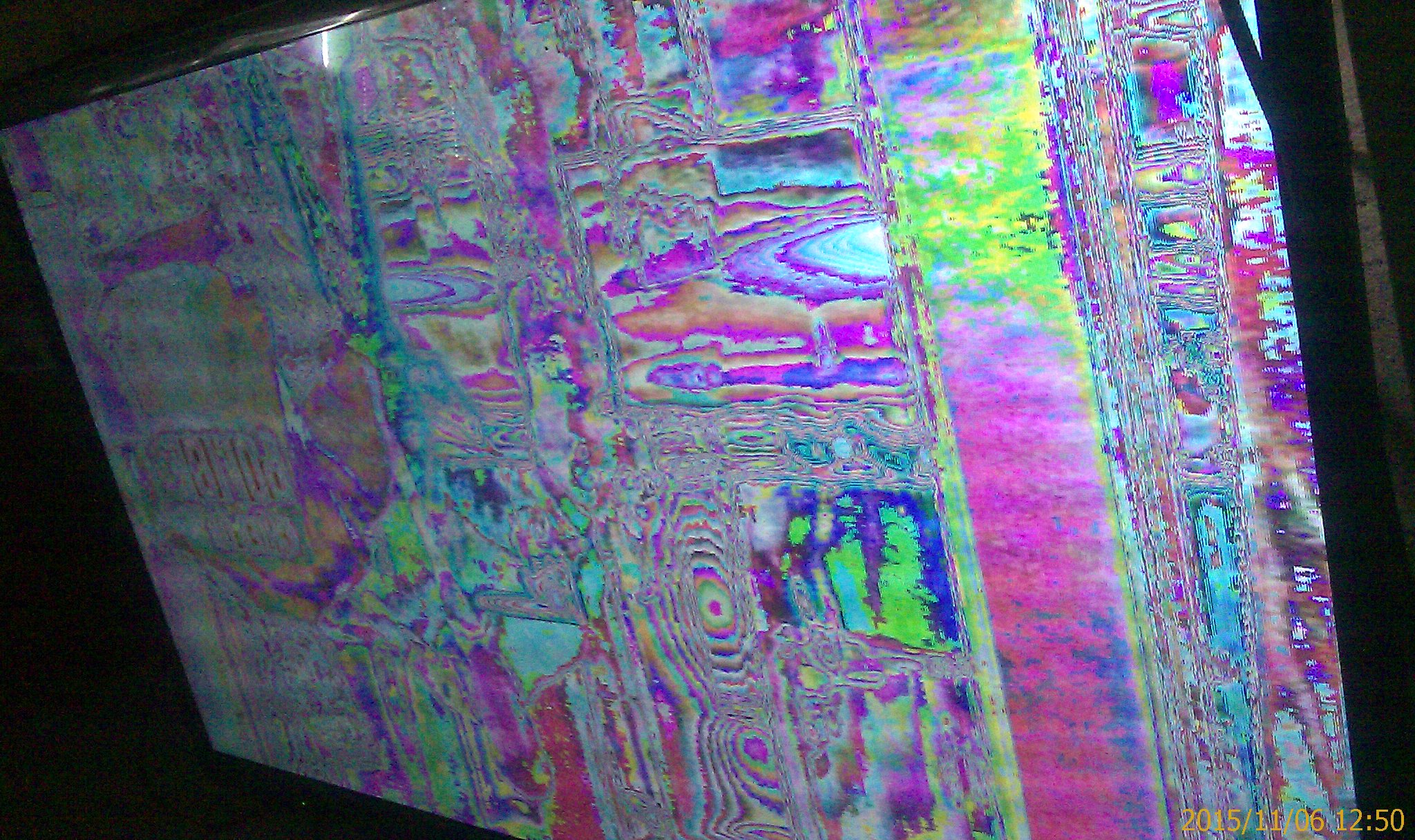

                    #49
                    here is a photo of the display when i tried playing a dvd

                                  #56
                                  hey i just noticed something....if u look at my service menu photo under panel selection it says 60.60xxxxxxxx
                                  could that be something???
                                  is the 60 referring to the 60 inch panel version?? or is that irrelevant?
                                  • shelby5041
                                    • Feb 2009
                                    • 1505
                                    • united states of america usa
                                    #57
                                    according to shop jimmy the panel i have is correct
                                    600D3LB4N
                                    and this is the same number on my service menu so i guess thats also a dead end

                                          #60
                                          yes i understand.......i can get into service menu see my photo of service menu i posted
                                          what i will do when i get home is make sure my panel number matches the panel identification in service menu
