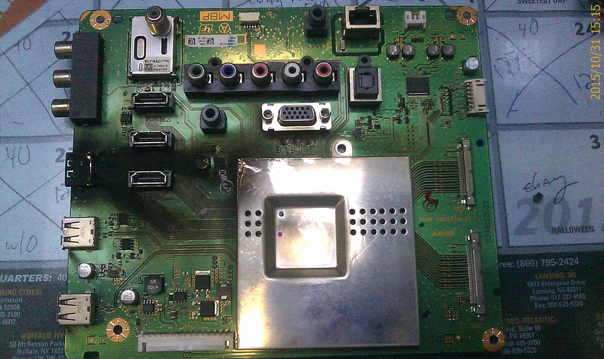

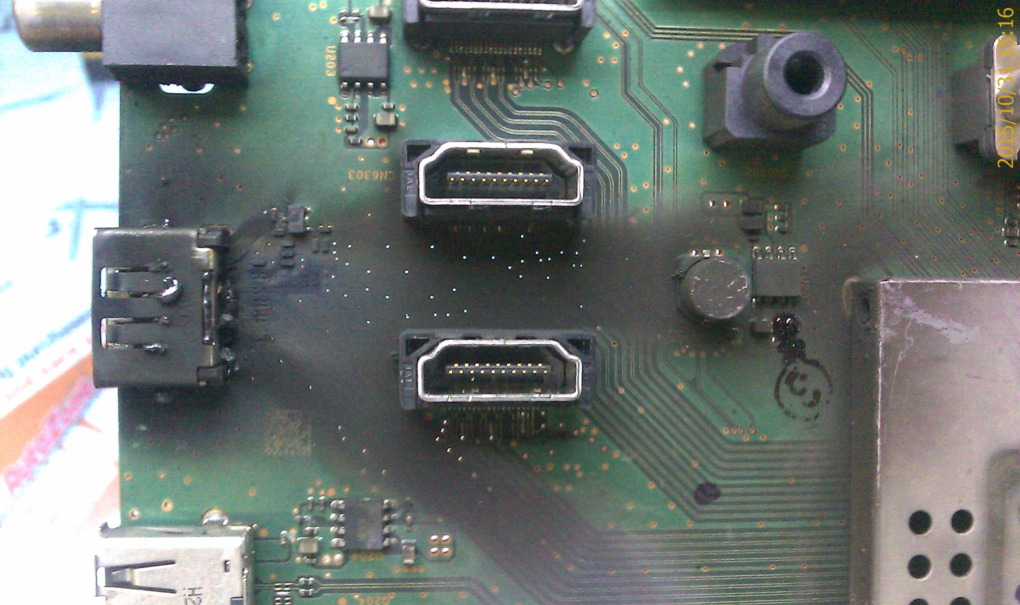

      Re: lcd sony KDL-46EX645, ...standby light is on....will not power on..no clicks..
      here is a photo of the main board as you can see hdmi port is fried
      i get a standby light but tv willnot power on...
      the ps seems to have good voltages.....is the fried hdmi port the issue?
      if so can i just desolder the hdmi port and see if that works?
      my other ocosmo tv has the same exact issue.....fried hdmi port and standby light but will not power on
      is this a common issue?
        More than likely the hdmi ports were hot with a surge. They dont normally spontaneously blow up lol
          The surge probably killed the fuses on the mobo and the main processor wouldn't surprise me. Probably best to get a new board as re-soldering hdmi ports and hdmi/cpu processors is very hard.
