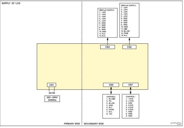

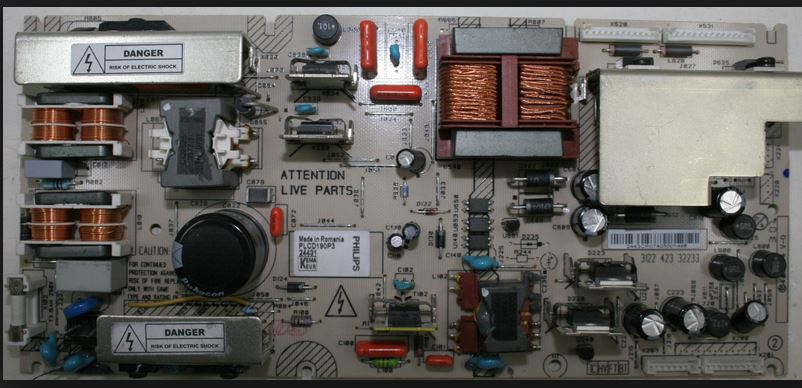

    I am trying to check out a power supply but cannot find any information on the pin outputs. If anyone has a schematic or can tell me the pin outputs for X200 and X203 I would appreciate it.

    Found:
    May be of use to someone else at a later date.

        Some voltage measurements at backlight side:
        BL-ON: 2.8V
        PWM: 3.2V
        D|M: 0V ? Not sure what this is for

          Hi everybody. I have this same model of PSU. I was wondering if anybody has the complete schematic. Thank you.
