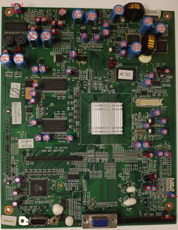

                        Re: Polaroid FLM-2632, Blue LED, no sound, no picture, no backlight, cannot turn off
                        I've added main board (899-KC0-GF271XA) with capacitor values if anyone need it.

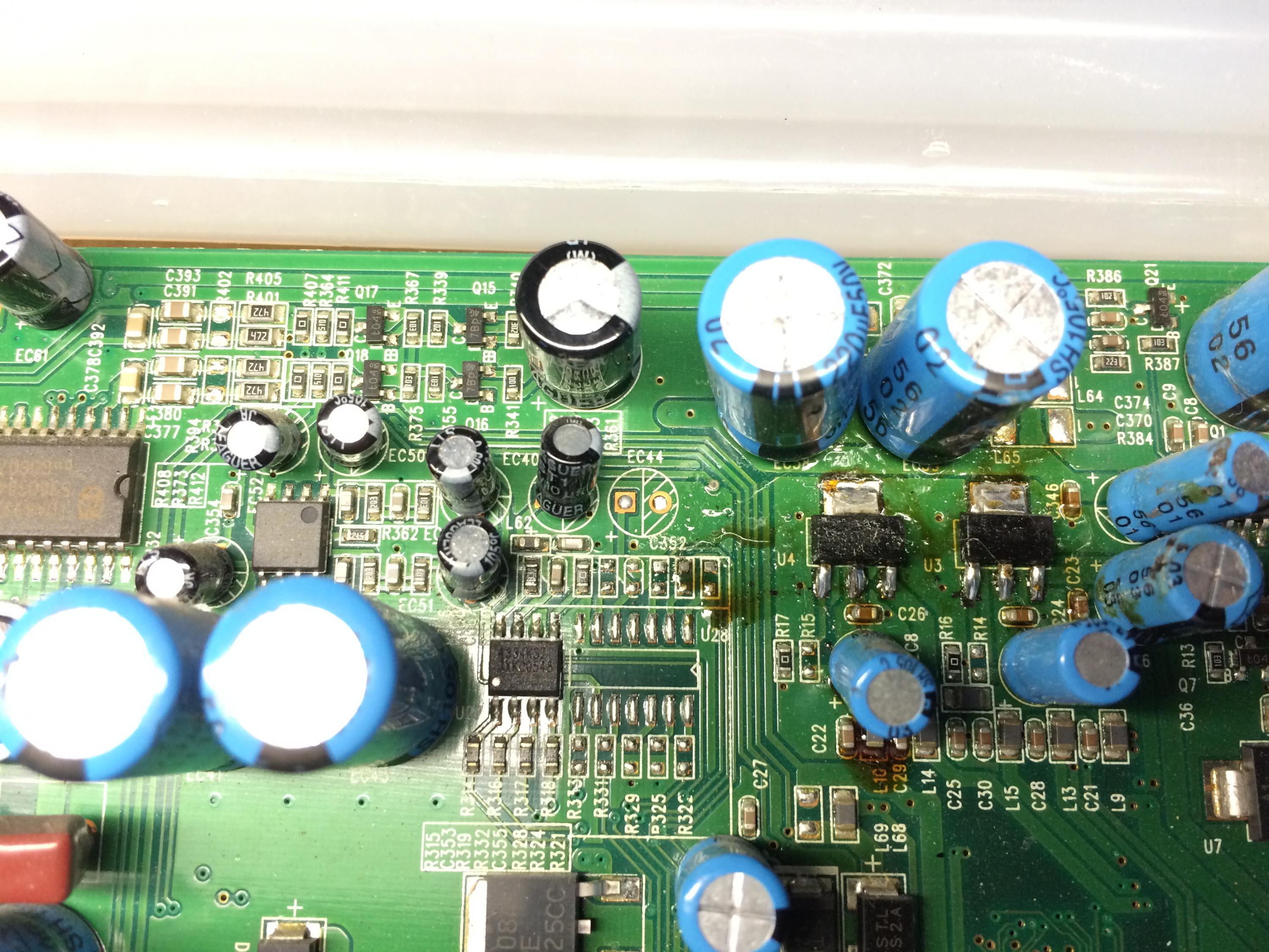

                            FYI: I'd received my replacement main board this afternoon from electroparts eBay seller.
                            At first I did not have much faith that this main board was going to work because of the flux paste on the board. but, it did. now, I just have to put the TV togather. thank you all for your help on this, especially to budm, and vinceroger69.
                              I think the flux points to what needs to be replaced.
                                Thanks for the follow up glad its working now and yes does look like those two voltage regulators? have been changed for some reason maybe if someone else has this fault they should check these first just in case.

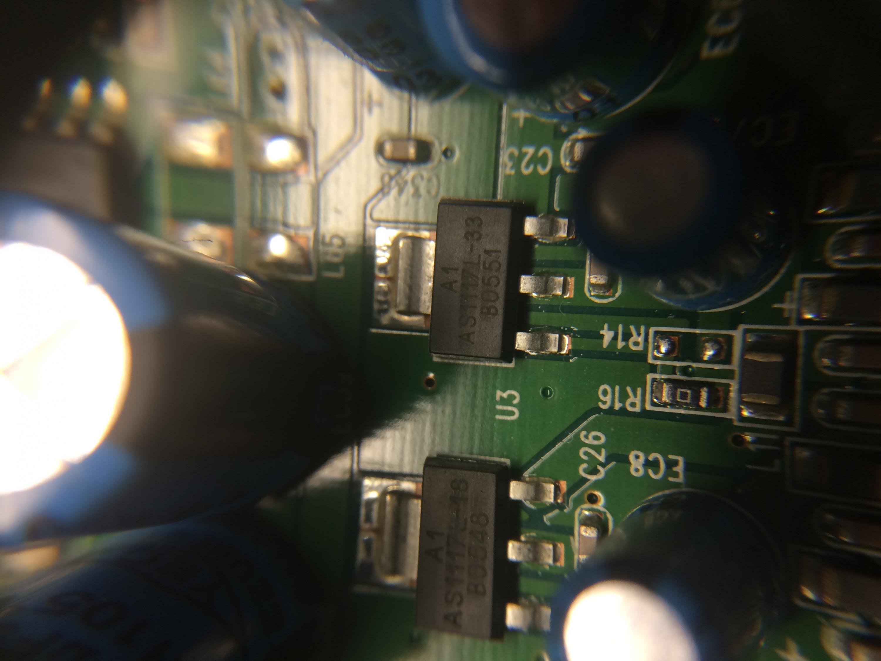

                                  I have included a close up picture of the Voltage Regulators for those interested.
                                    #37
                                    1.8V (1117l-18) and 3.3V (1117l-33) series fixed output regulator.
                                    You can test the DCV on all 3 pins with ref to the chassis GND to see what you get.
