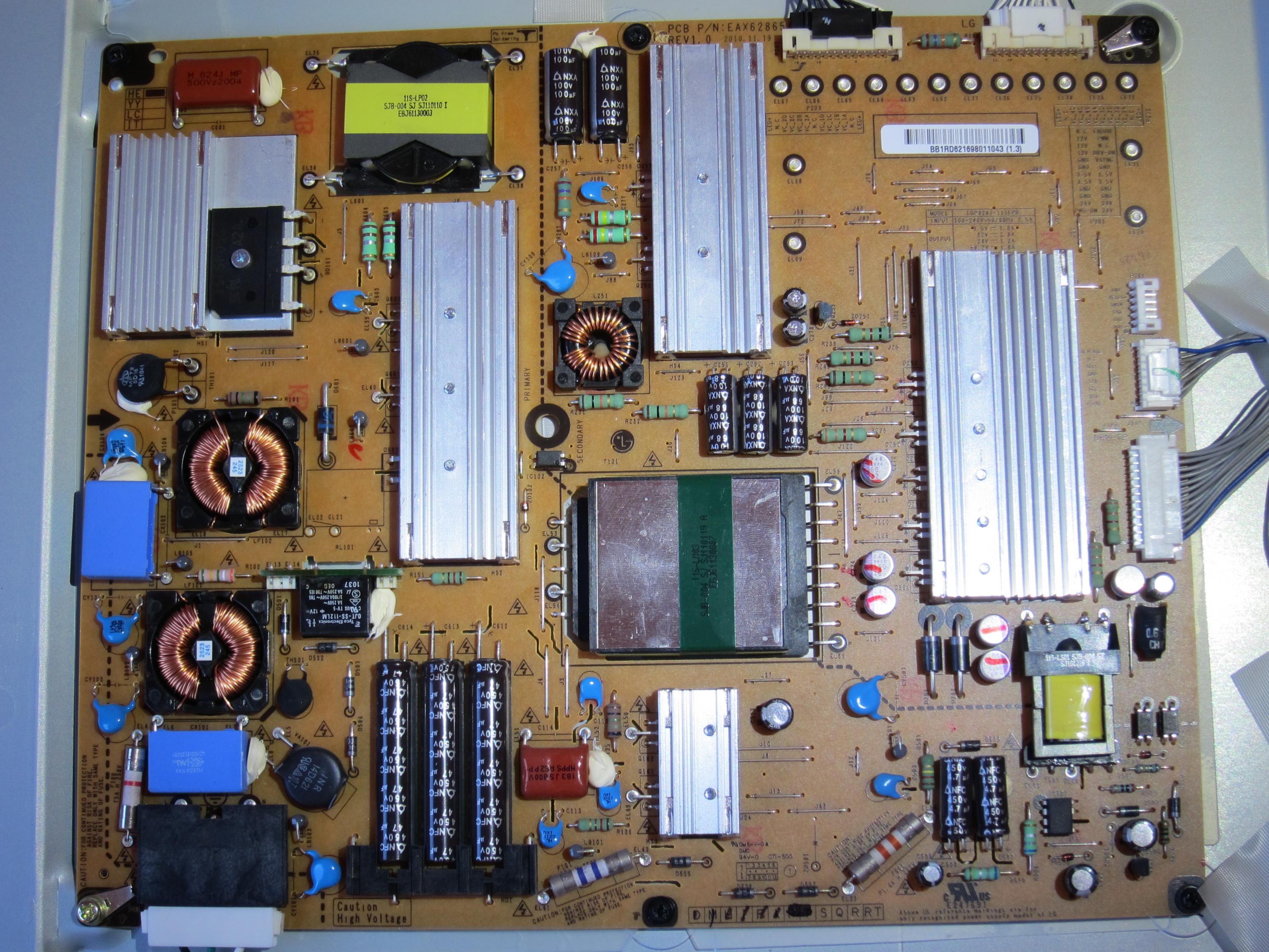

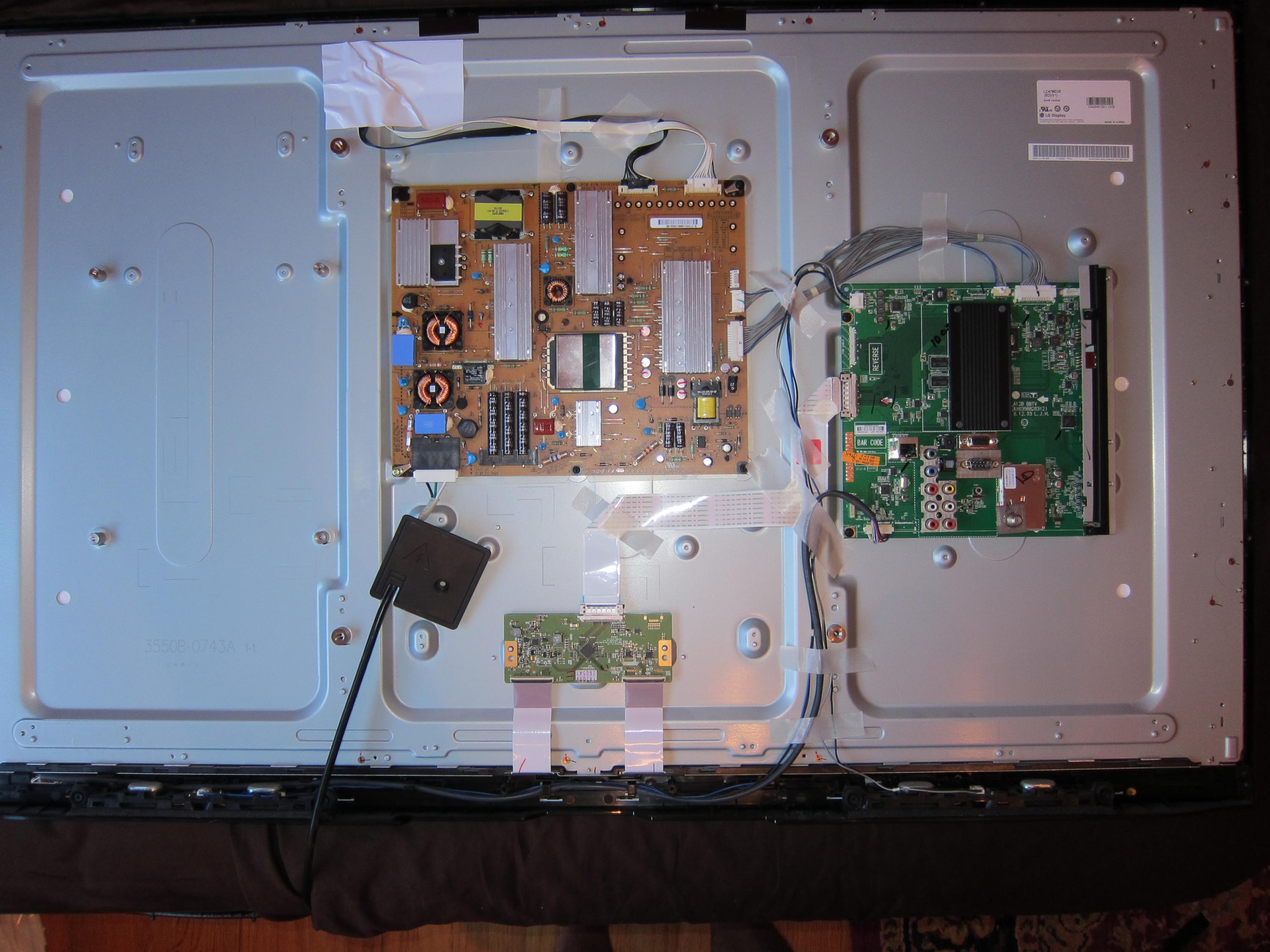

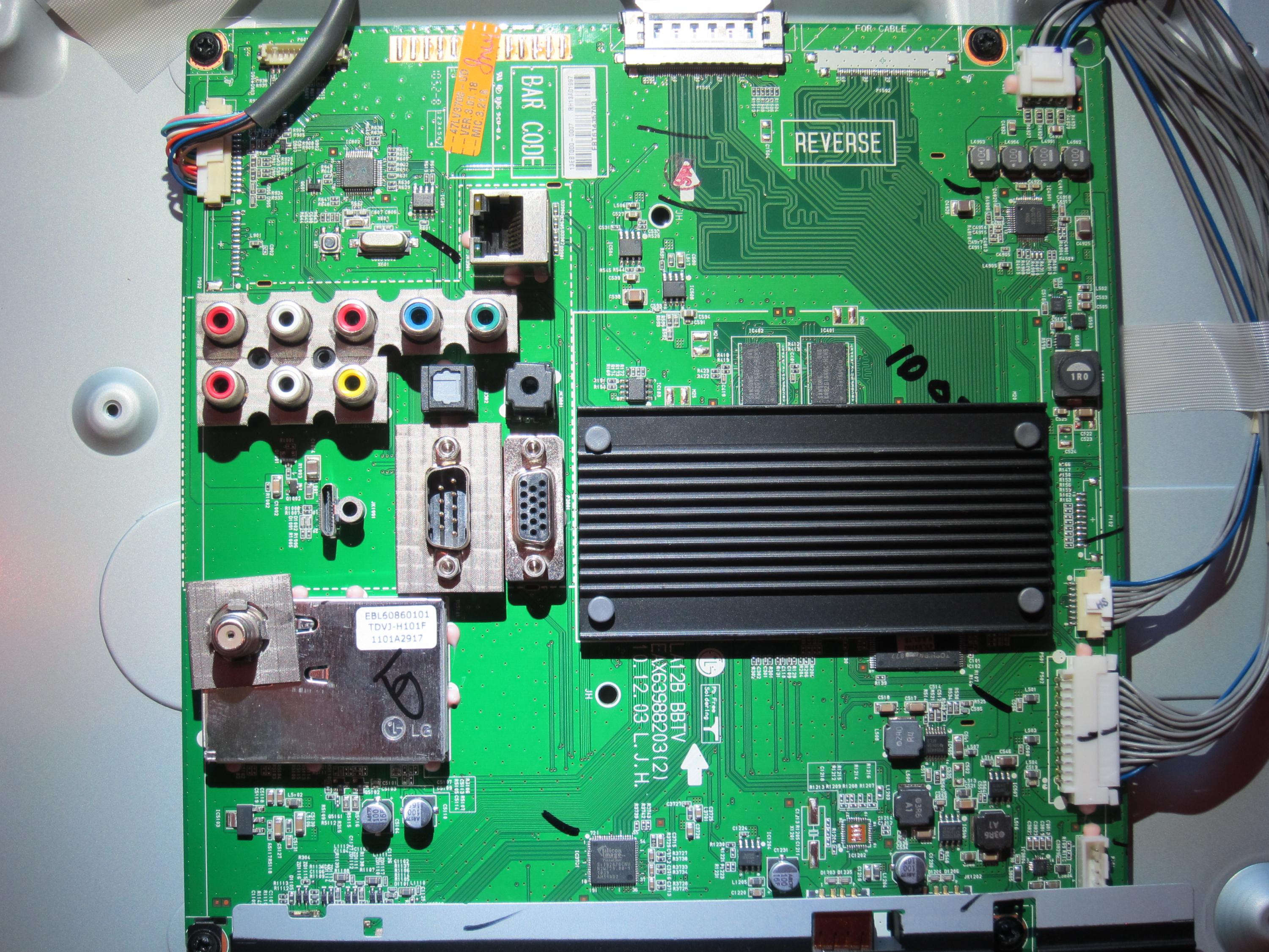

Anyone have any thoughts on this? I attached pictures of the boards inside etc...

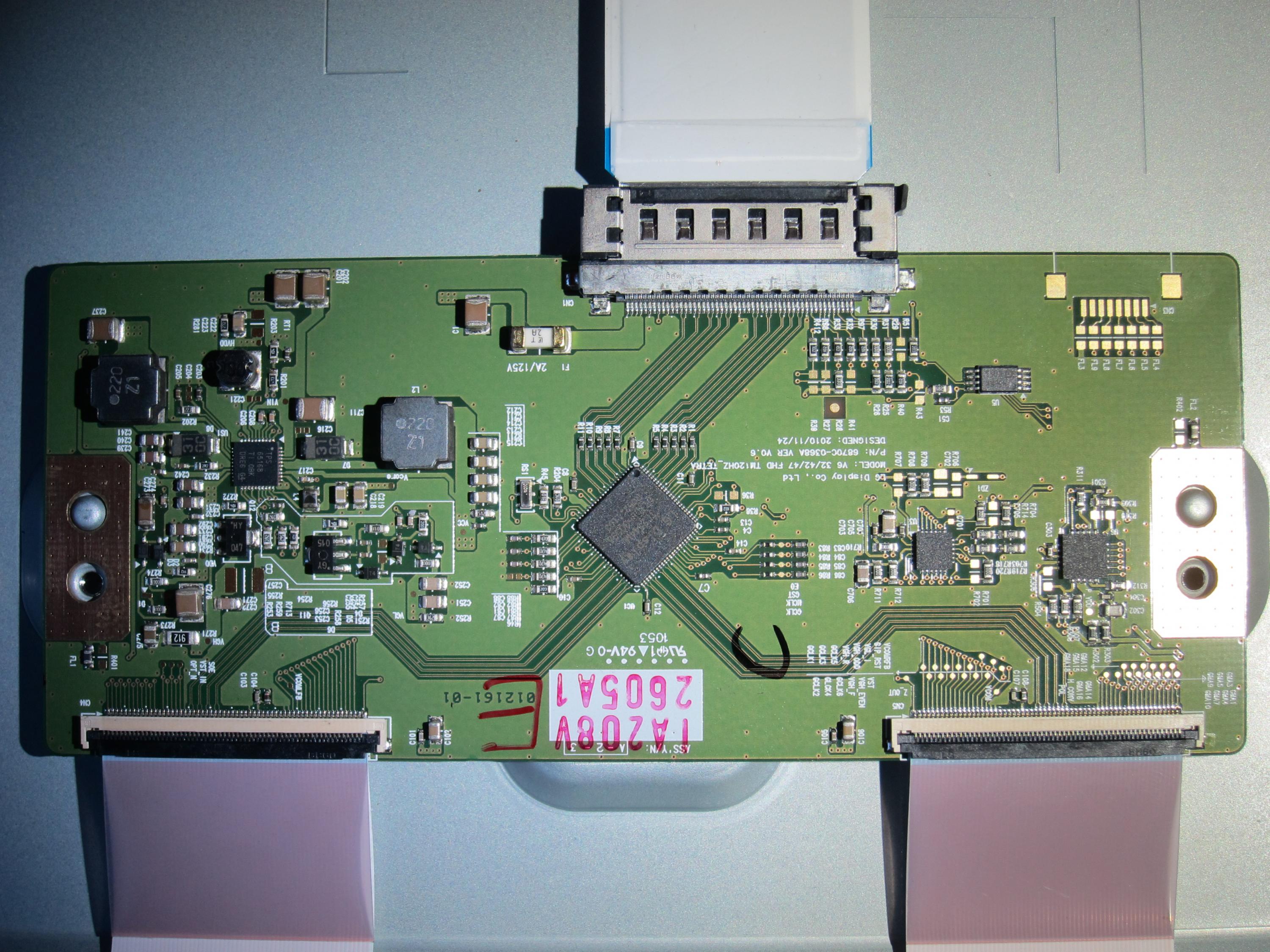

I checked the fuse on the Tcon its 12v on ether side and its good
Unplugging ether side of the Tcon results in white being displayed on that side of the screen.
