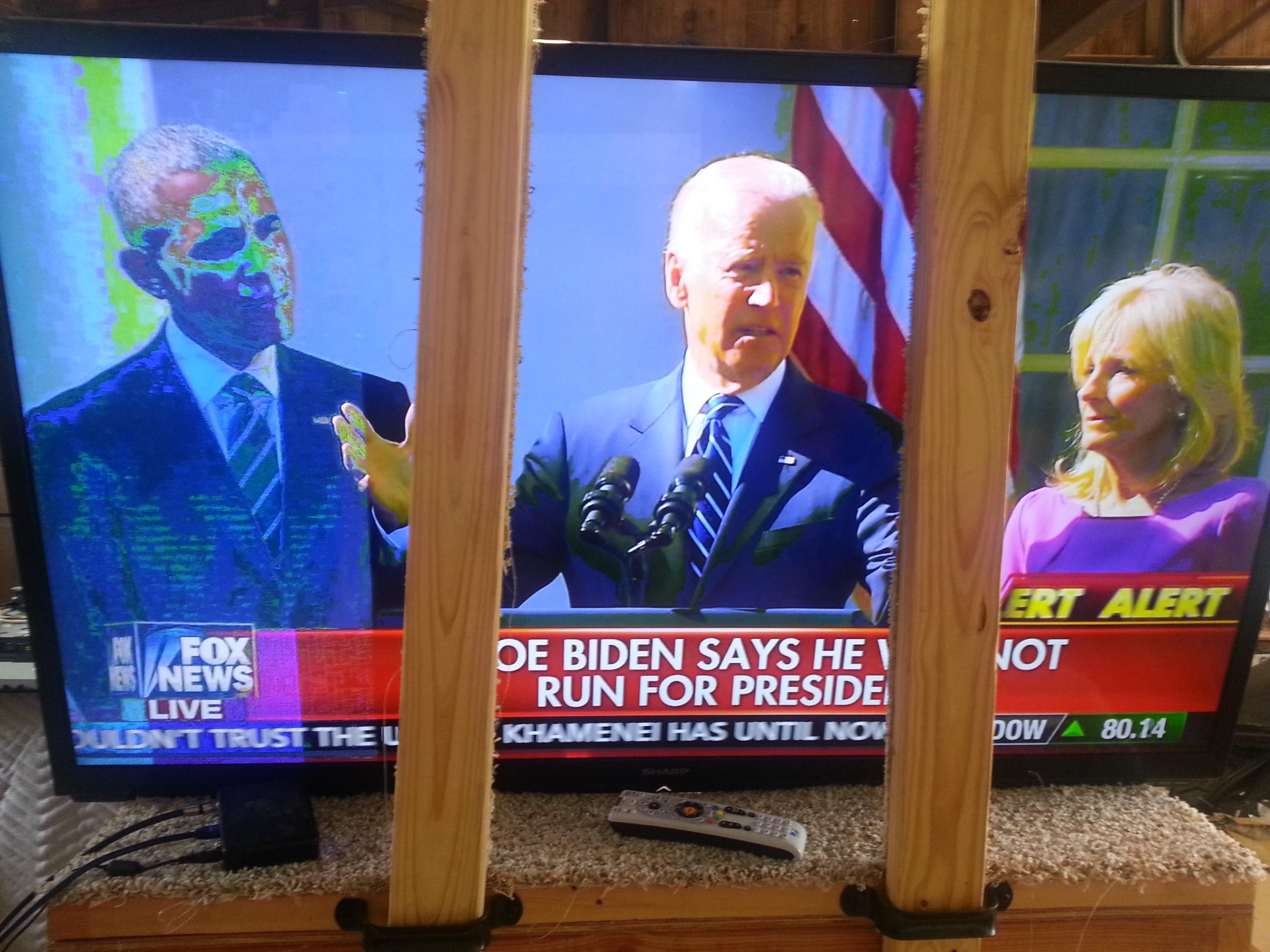

                              Bad connections on OFL and STB..I have backlight and picture..is this a T-con or possibly T-con cable issue?

                                The moment of truth. Looks like a tcon problem. First try reseting all the cables on the tcon and reseat.the lvds cables too tcon side and mainboard side as well.
                                Did you bypass the fault? Sharp TVs like the shutdown in an instance of a fault. If you're bypassing the fault you're seeing the fault now

                                  I have done as you recommended with no improvement. Chip in center of t-con gets very hot!

                                    The ic on the tcon is supposed to get very warm. This is normal to some degree. Hot though? There may be a short. Try a new tcon for starts. Your error code may be thrown by some load down of this board making the power supply go to shut down.

                                      It gets downright HOT enough that you will not leave your finger on it for too long..I ordered a T-con today..
