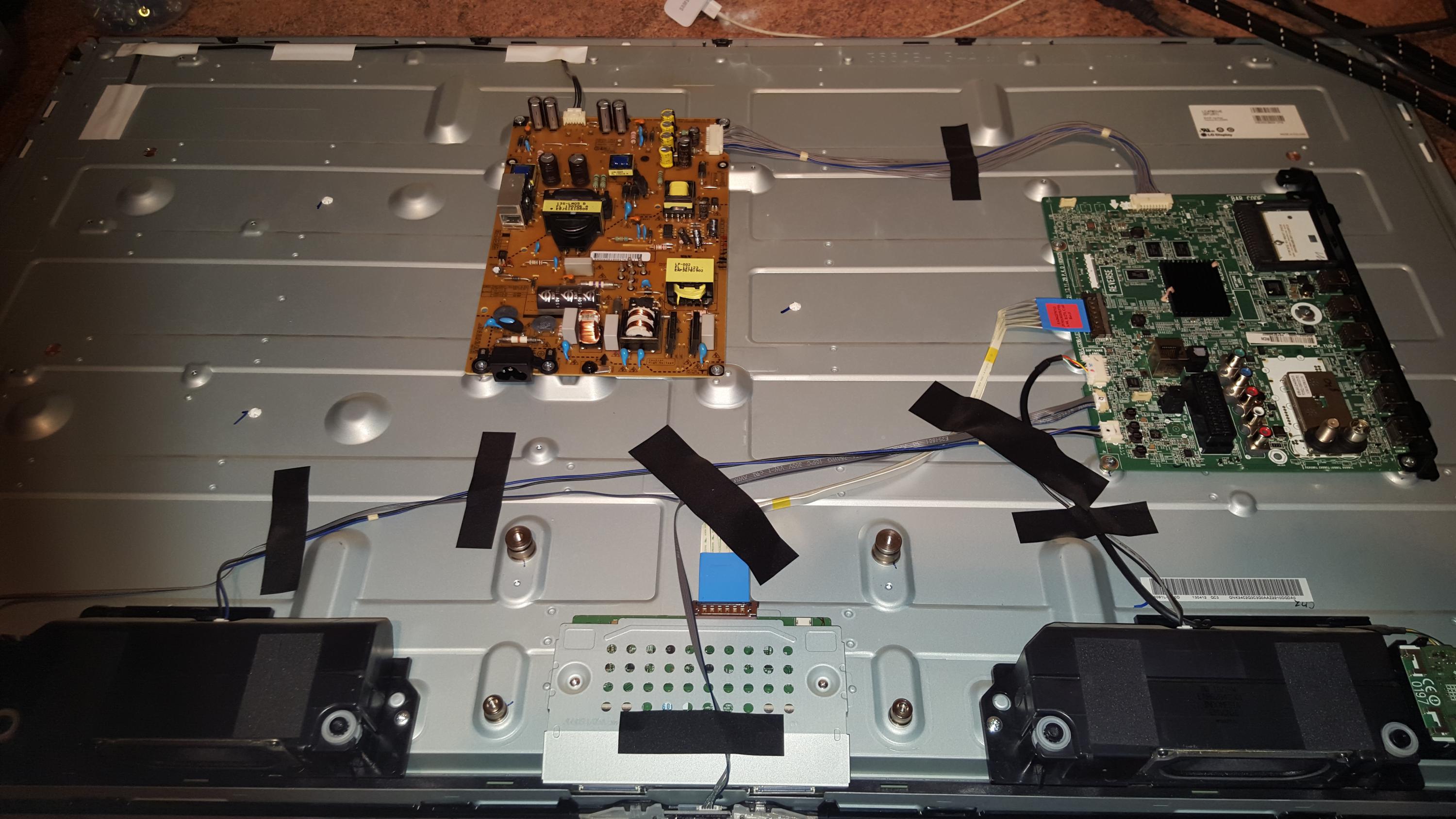

    Hello Guys
    had this tv a few weeks now its fine one minute then a few weeks later it will restart itself then fine again after leaving it off for a few days but back to the same fault again which seems to be a a very random intermittent fault
    i have added pictures and a video

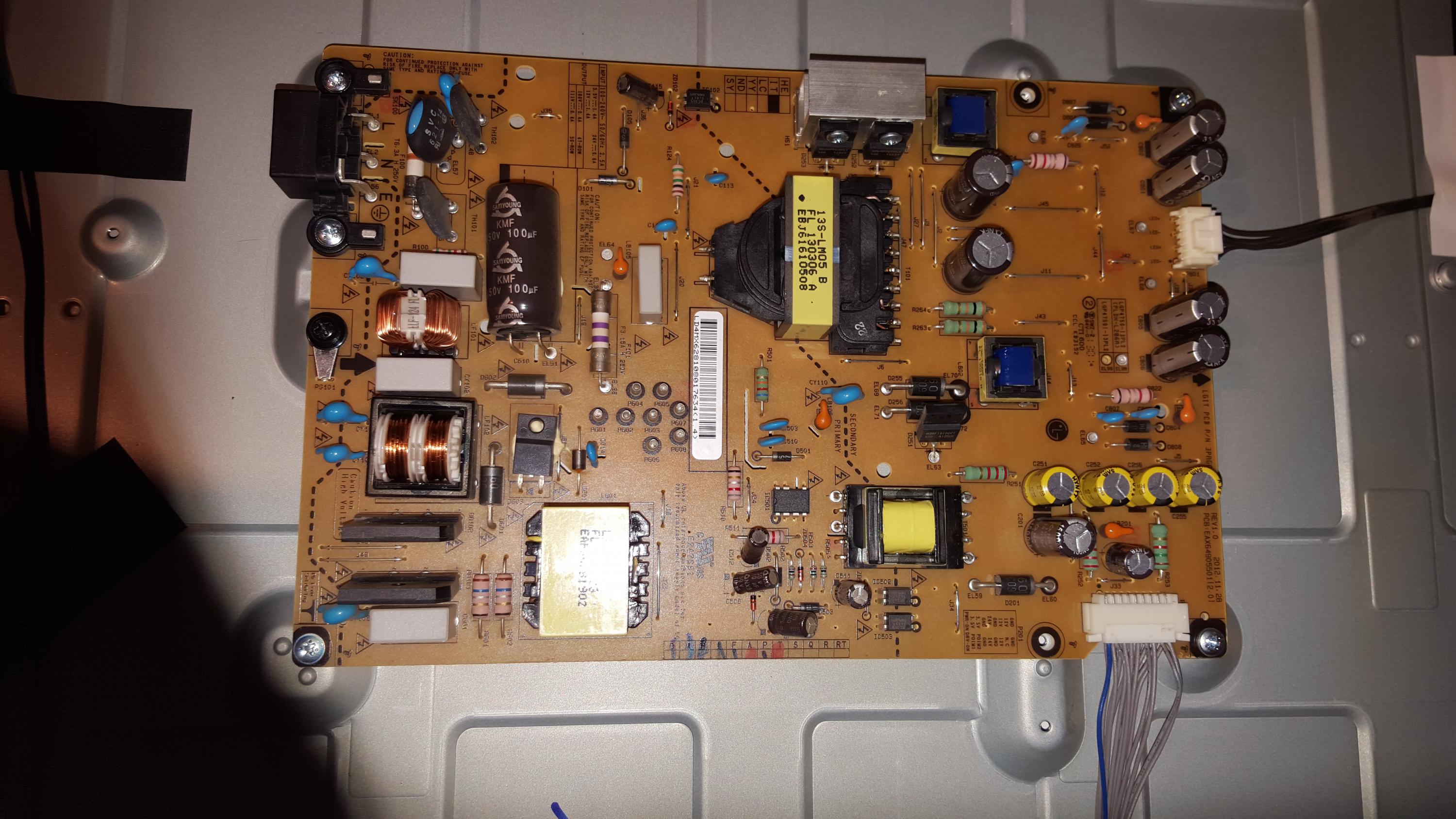

    voltages
    GND GND
    12V=11.9V N.C=24.4V
    12V=11.9V 12V=11.9V
    GND GND
    24V=24.4V 24V=24.4V
    GND GND
    3.5V=3.3V PDIM2=1.08V
    PWR-ON=3.3V DRV-ON=3.16V
    could a bad led bulb cause this ?
    thanks
    VIDEO:https://www.youtube.com/watch?v=bcR0...ature=youtu.be

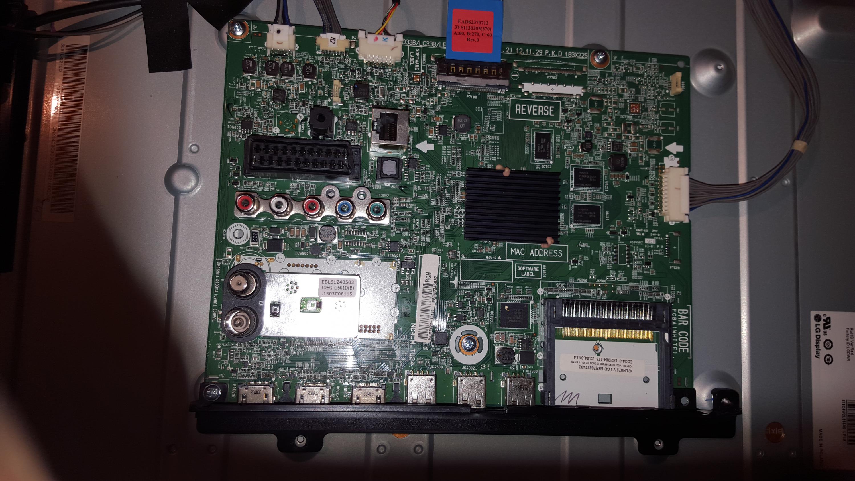

    I had the same issue on the 42" version it happened when ever I pressed "settings" on the remote. I ended up reflashing the firmware sorted the issue.

        Will see if I can find the firmware for this set, then you will need a service remote if you have one ?

            so i got into the service menu and done a factory reset ill try and test it also would it be worth changing the main board ?

                realised today i had a 42LN578V tv with cracked screen and the parts seem the same so i have swopped this into the 575V i will update again soon
