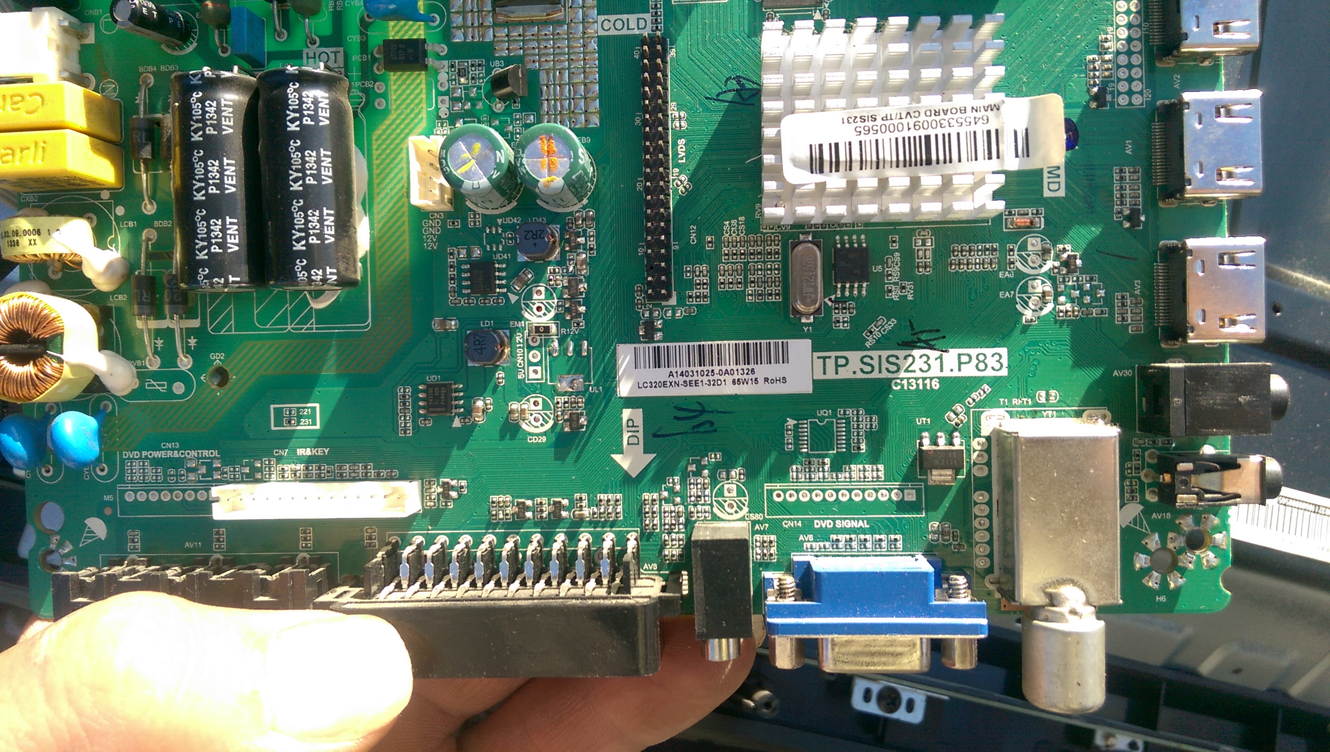

    Have been given a (no real brand name) GVA LED LCD to try see if I can repair. Its probably not worth the time and effort but hey its good learning experience for myself :P
    TV model: GVADLED32C
    Main board: TP.SIS231.P83
    Symptom: TV turns on and after 5-10mins the picture will fade from right to left to a black blank screen.
    I noticed the back lights must work as the TV does display some sort of black lighting on screen as soon as I turn it off it goes totally black like it should.
    After it goes into this state I cant turn the TV off and on again to get a picture, I would have to leave it for say 24 hours or so before I can get a picture to come back up. Does this sound like failing caps? I have checked these and they look fine (not tested with an ESR meter yet) on the outside but being the type of cheap arse TV it is they are probably cheap and nasty caps?
    There are no stickers to show testing values that I can find but can see on the back of the main board some labels to certain pin outs ect... so mayb u guys can help from these?
    I can find replacement main boards for say $40 but these are from different branded TV's (same main board number TP.SIS231.P83) hitachi, would these be plug and play or will they have a different TV's firmware installed on it and wont work straight off the batt?

    Ah the super reliable powersupply-mainboard-tcon combi board!
    What could possibly go wrong!
    That tv is an absolute mutant and should be put out of existence.
    To answer your question, yes it's the same mainboard used in hitachi, technika and many others. It won't matter what one.
    It's not failed caps, its probably bad solder under the processor, corrupt EEPROM flash.
    Since it seems to be heat related you could try using a can of freeze spray and see if you can freeze a component to get it to last longer.

      Processor being the CPU yeah? I can try reflowing the CPU with my bga rework machine tho how do the larger caps go with heating the board up to 170-220*? must they be removed 1st? this mother board is thin and I can see its not 100% flat with no real board support so it wouldnt take much to bend/twist naturally breaking these solder joins under normal use.
      If its eeprom flash I think that's far from my capabilities tho where would I find where its stored?
      Ive got freeze spray on hand what are the main components to try freeze 1st? is it best I turn the TV on and when I get picture feel for components which get warm/hot and then just spray them? sounds like I need something that can display thermal imaging that would be handy.

            My bet would be on a BGA solder under the main cpu.

                can u put any insight on if I need to remove caps before attempting a reflow or even re-ball on the CPU? or will they be fine

                  I have had luck with reheating a main board the only thing that I have run across in some models are the component sockets melting slightly. It depends on what kind of composite plastic they're made of. You could attempt a heat gun on the main processor or you could attempt some freeze spray on the processor to see if that is indeed the problem. You should see the screen disappear immediately after you heat or freeze components on the board until you get to the right part.
                  • freakaftr8
                    • Oct 2012
                    • 3743
                    Re: GVA LED LCD picture dissapears
                    I use this method. Oven at 450 f or 232.2 c for 8 minutes.
                    Then open the door and turn the oven off and let it sit for another 15 minutes before you pick it up

                      I have a BGA rework station id prefer to use that, I don't believe in heat gun methods unless they are only used for temp data retrieval and that's it. heat guns should only be used to strip paint LOL.
                      I guess the question I asked so its only the plastics I need to be carful of and not so much the elec caps? I can mask these with alu tape as my rework station uses IR so it should reflect most of the heat where its not needed.

                        Is the firmware stored on the IC (I think its BGA actually) that's directly above the CPU that's rectangular shaped?
                        if firmware is an issue with other motherboards that I can find but are not the exact same as mine shown, could I simply swap over that small chip? I guess that's provided this board does have a good flash tho but can I rule out bad flash somehow or is the only way to do that is to read whats on it?

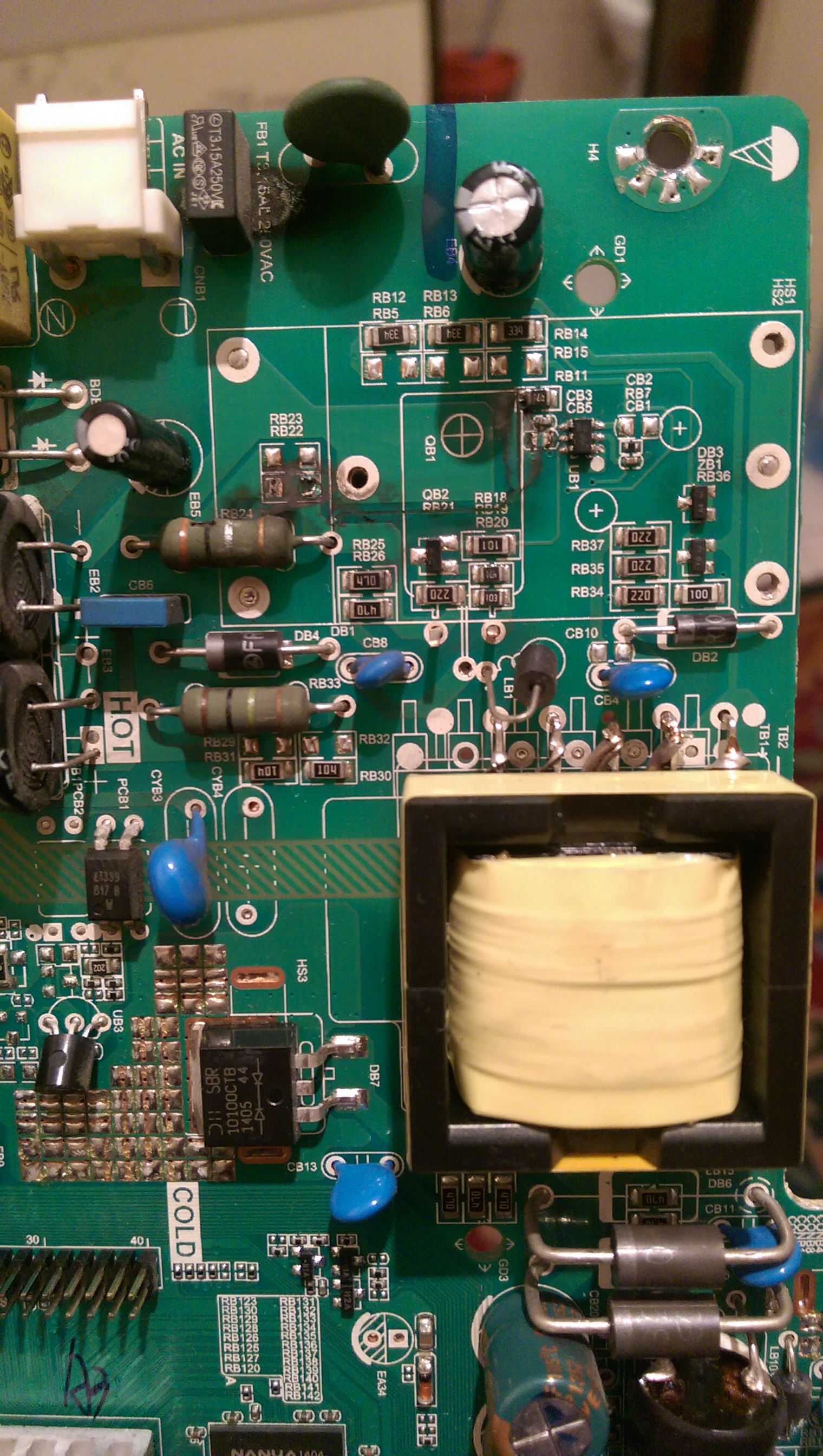

                          Hi to all.
                          Can someone help me with some smd value please?
                          My power board was burned out from high voltage.
                          • Klevi

                            Hi could you please let me know some value.
                            I have some buried resistances and caps.

                              TBH--With that sort of damage--On a combo mutant, where no schematics available, be cheaper and quicker in long run to just replace the whole board.
                              It wont be just those parts that have been blown to bits, it'll be a whole lot more--prolly the chips too....

                                sure i'll have a look when I get it back out of the TV at some time. can u list the references to the components so I know which ones u need exactly?
                                seems these are hard to find even a replacement board for them so these TV's are pretty much a throw away jobby. I still haven't bothered to try re-balling the CPU yet.
