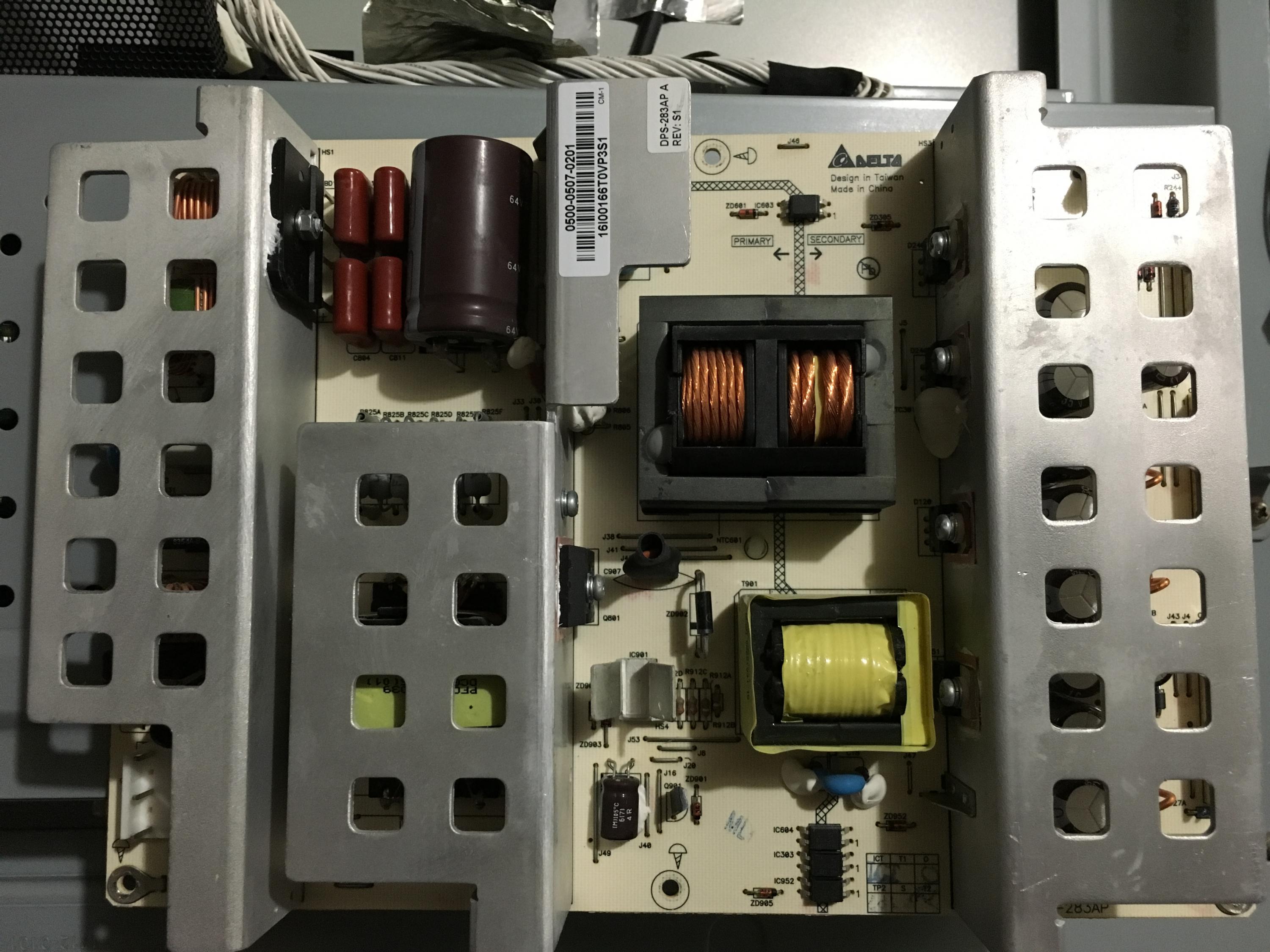

    I've never repaired a TV before and I'm pretty new to trying to fix electronics, though I can solder into a PCB and I can use a multimeter.

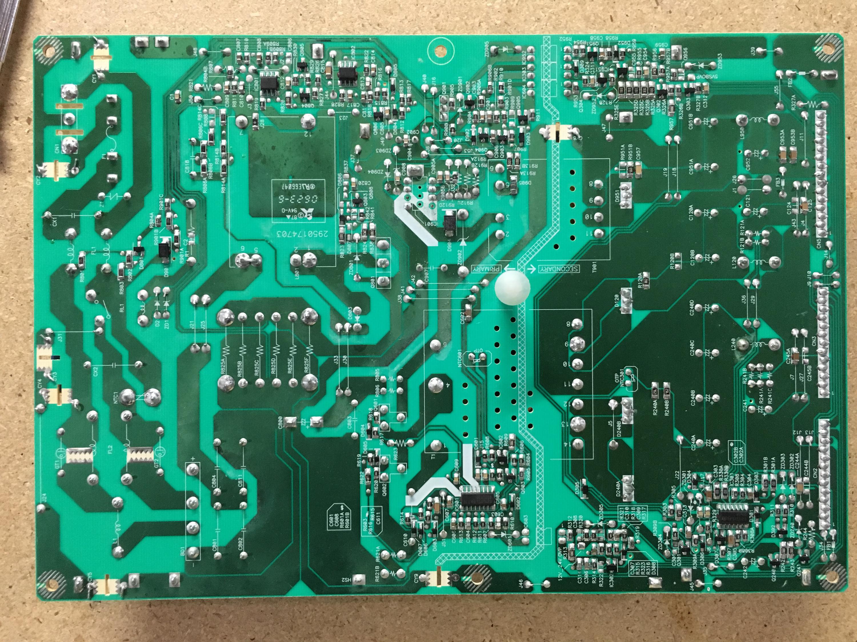

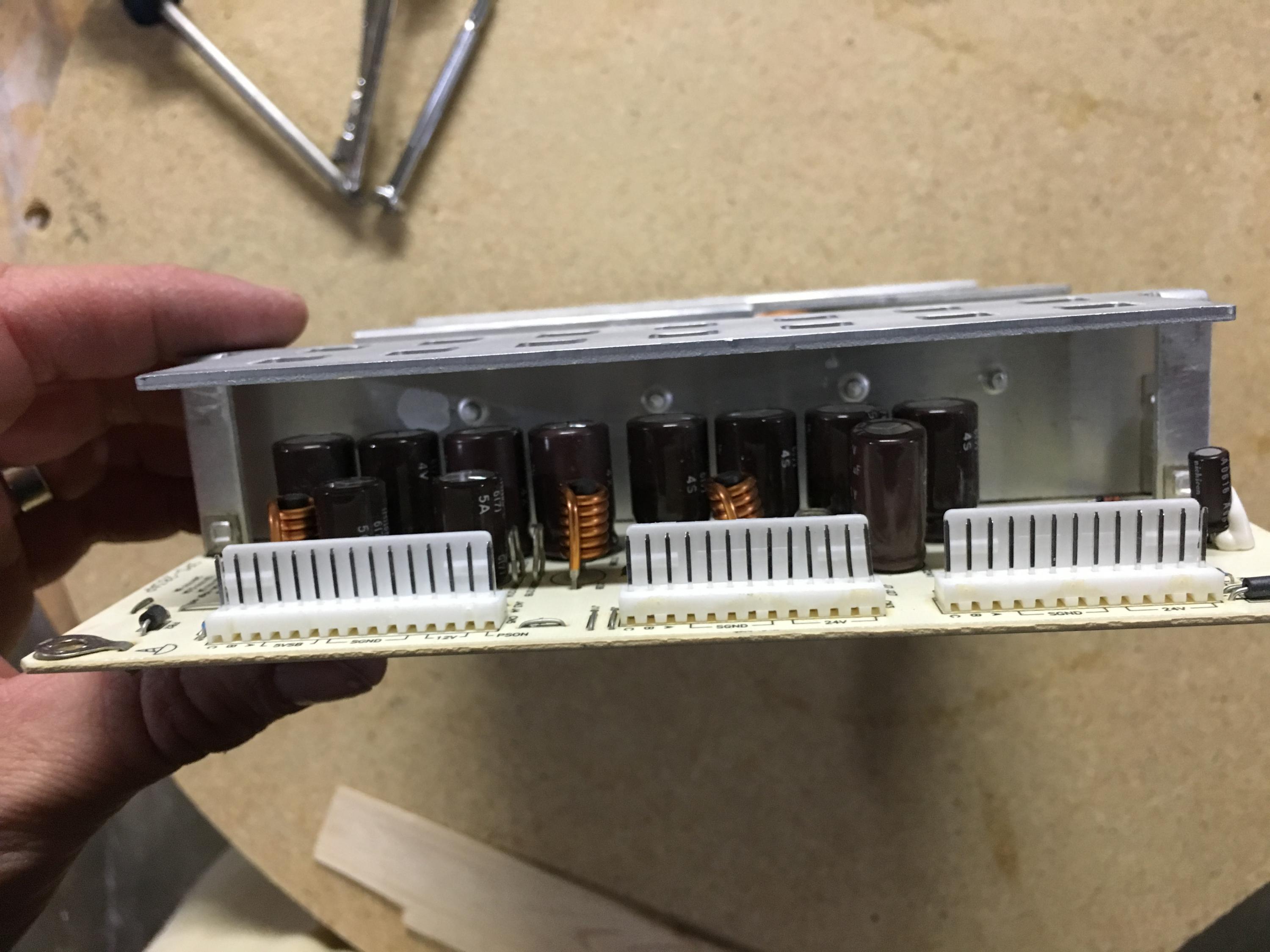

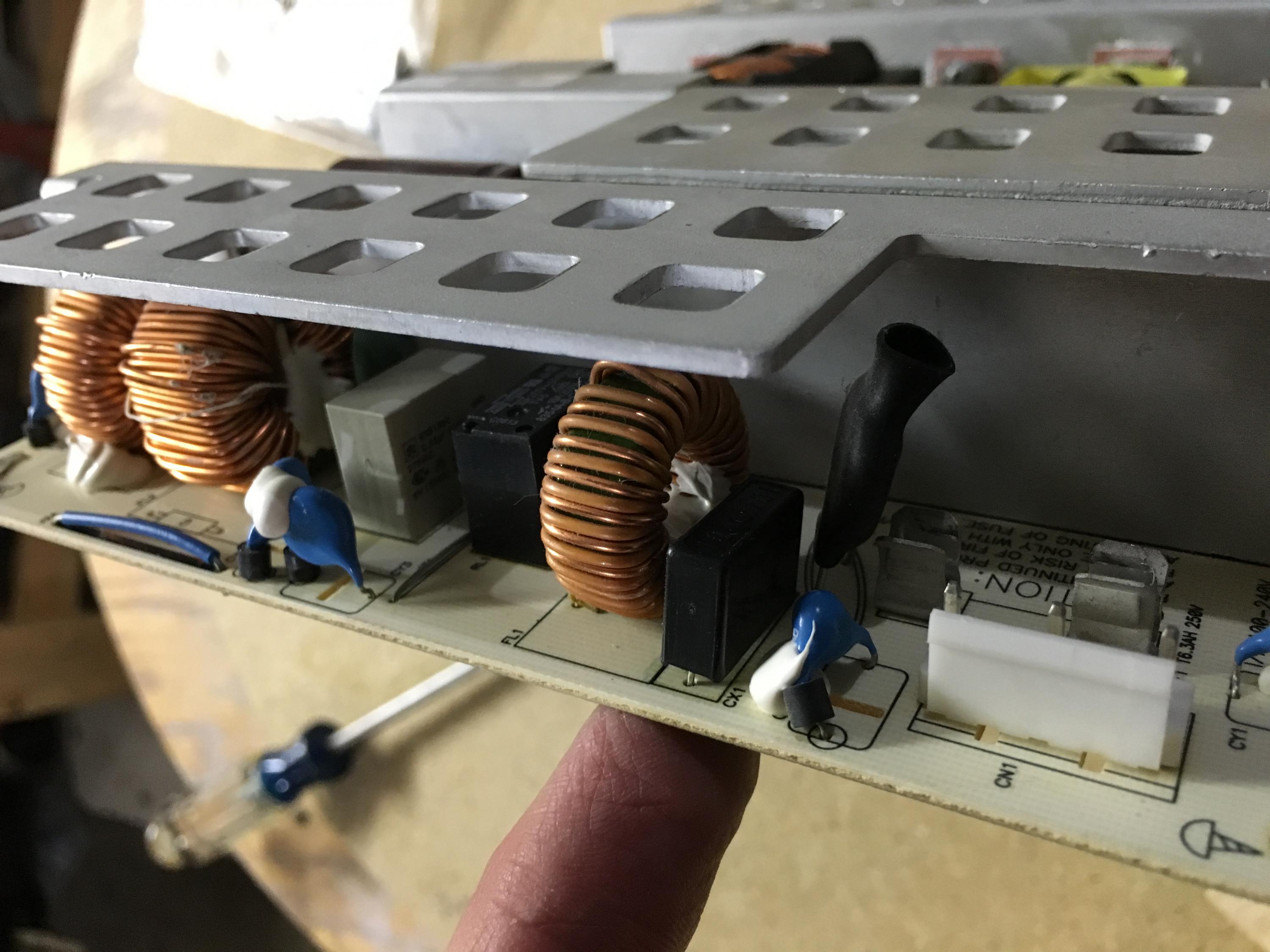

    I have a Vizio GV42L HDTV -- its an LCD flat screen. Its totally dead. I took it apart and the fuse was blown, so I replaced it. I didn't see anything else obviously wrong with the power board. When I plugged it bag in, I heard a variety of snapping-popping sounds without any signs of life from the TV. Taking it apart again, the fuse is blown but again no other obvious pathology on the power board.
    I attached some pics of the power board. What should I do next to figure out what is going wrong?

    You need to start testing the power devices such as bridge rectifier, POWER MOSFETs, ETC. You have shorted out circuit some where on the board.
    I do not know how much of the component level troubleshooting you want to go, the new board is about $40.
    http://www.shopjimmy.com/vizio-0500-...wer-supply.htm

      Oh, that's a much better price than I was finding!
      If I did want to test said components, is there a thread or guide you could recommend that would explain what they look like and how to test them?
