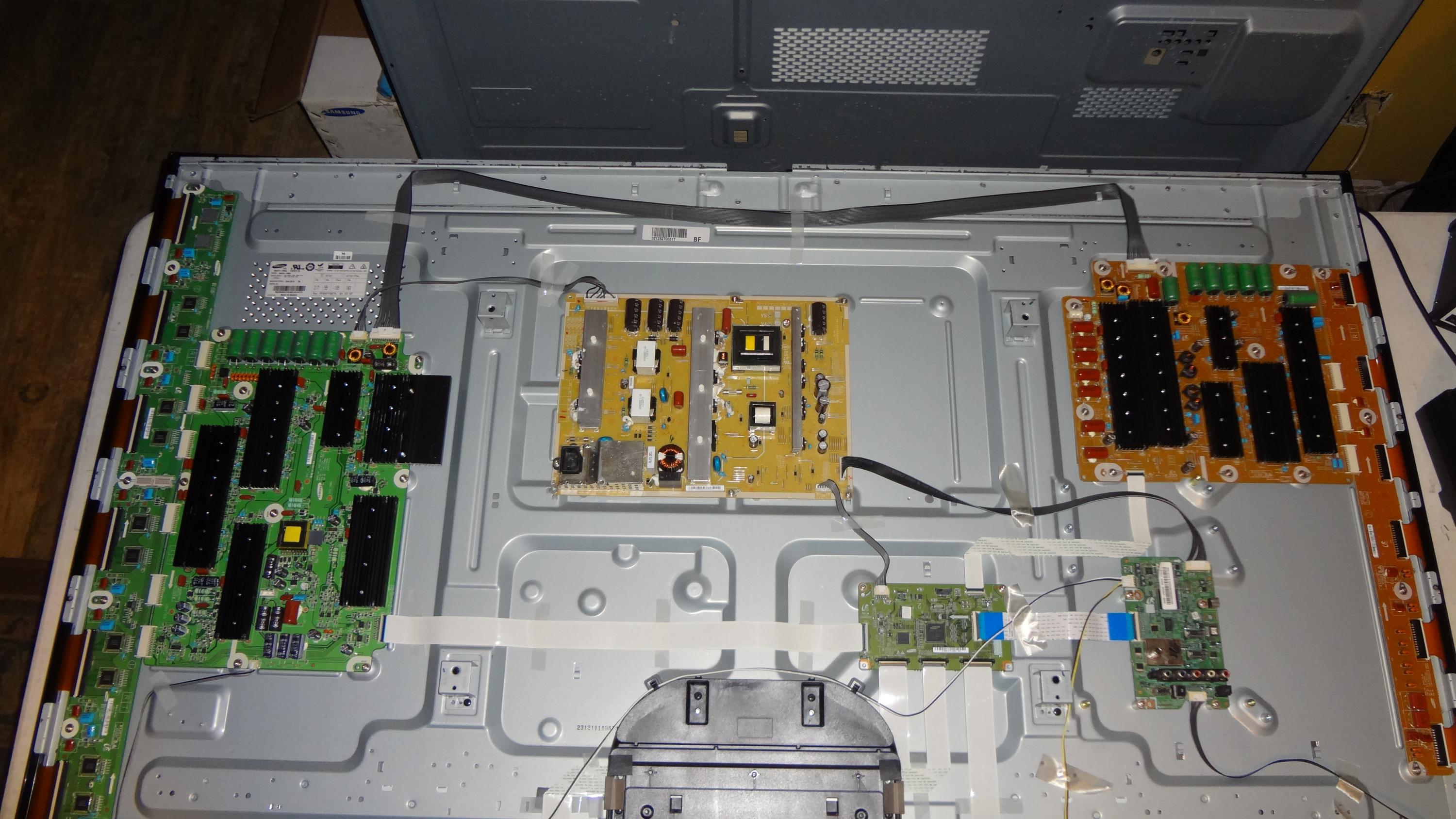

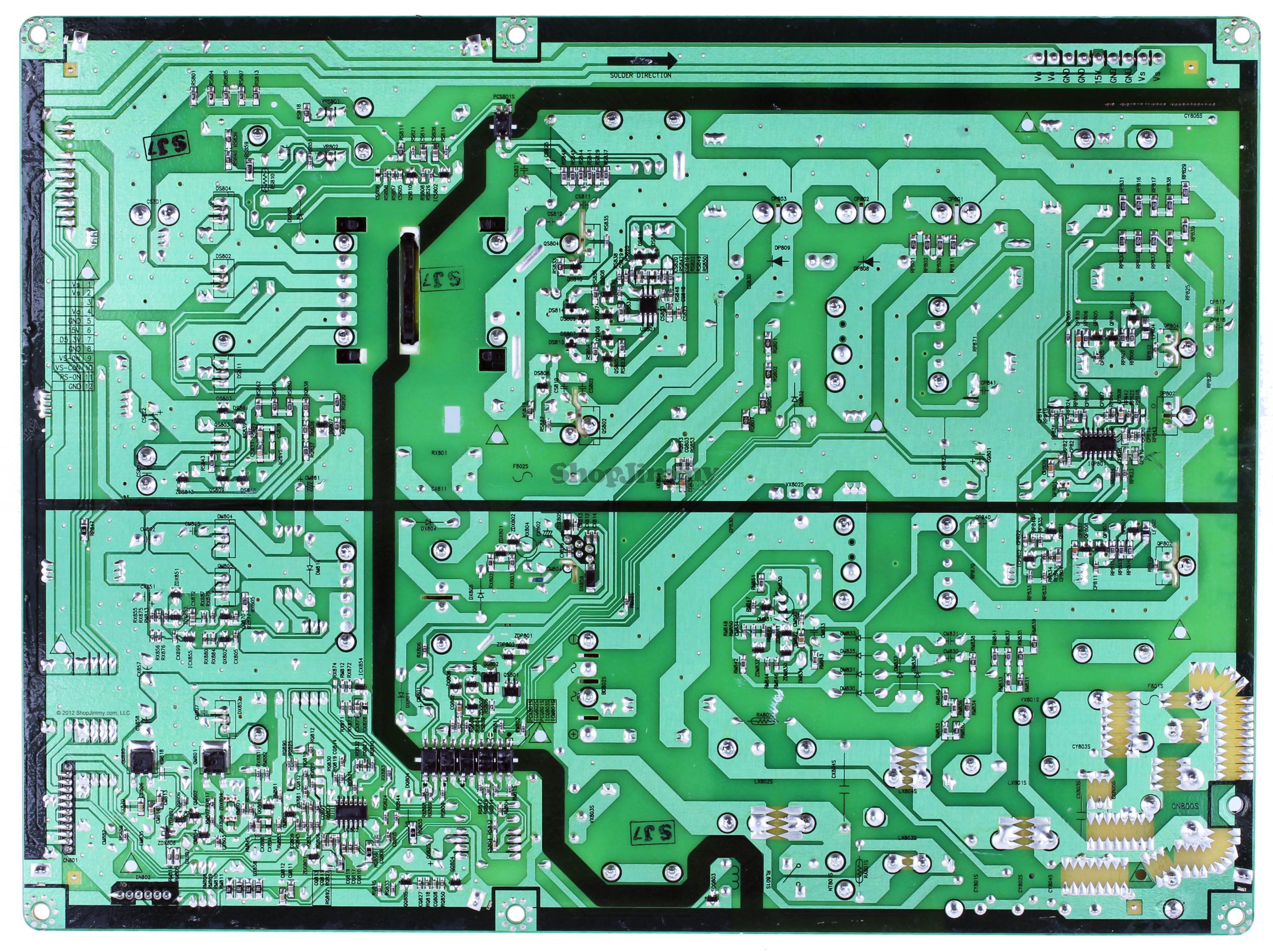

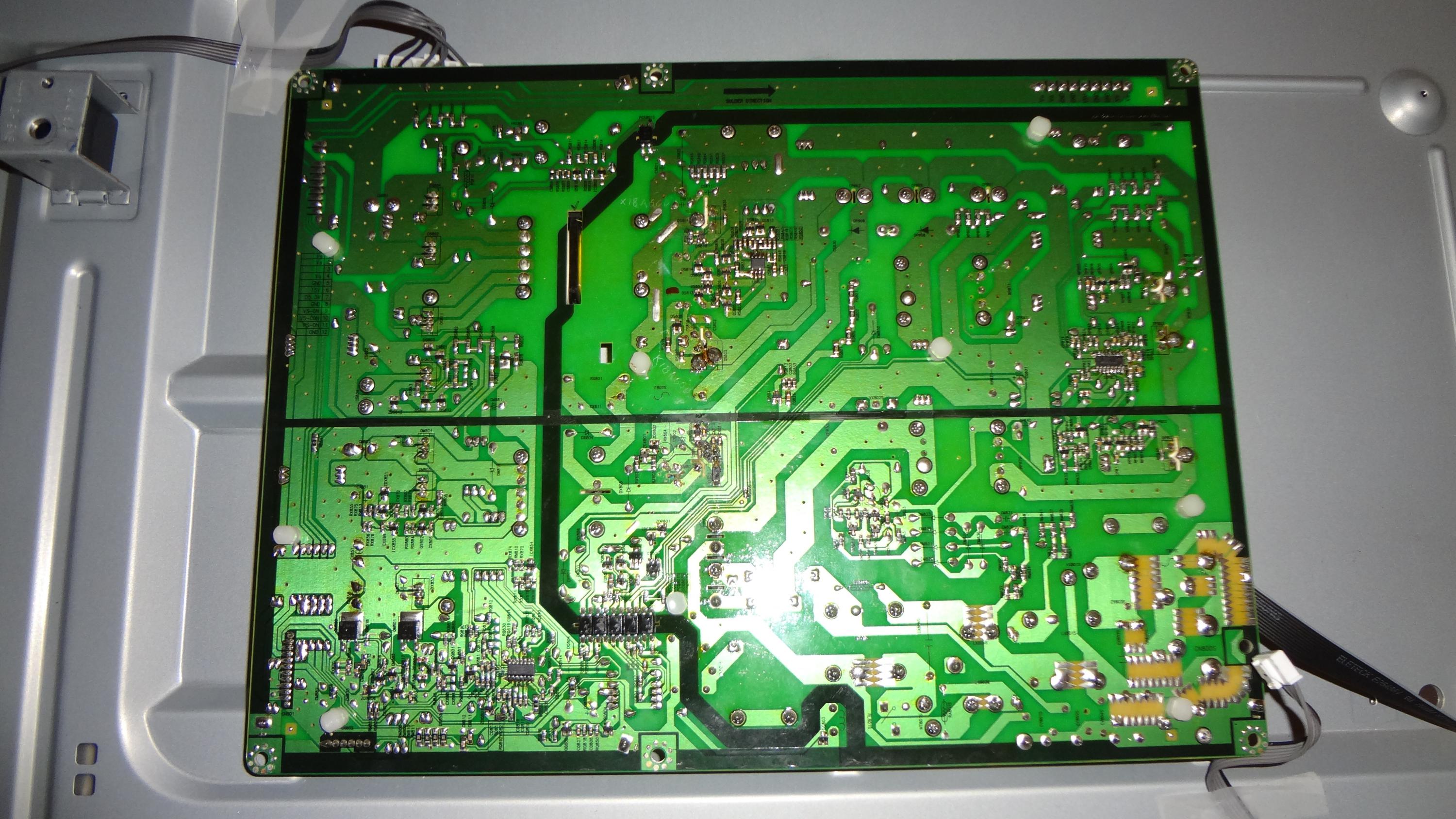

    This TV has no standby light.

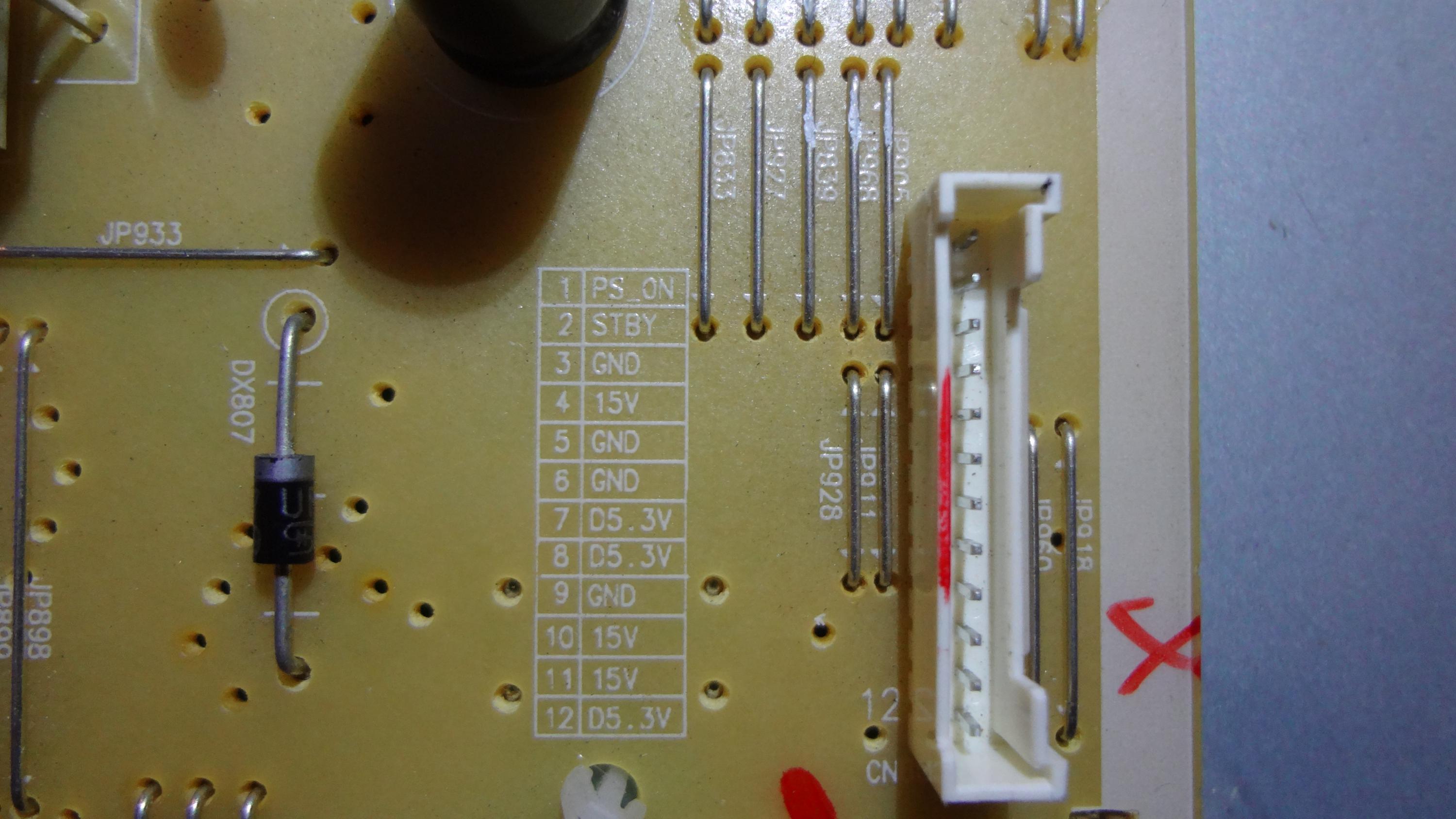

    I've measured the voltages at connector CN801:
    CN801
    1 PS_ON - 2.3VDC
    2 STBY - 0.53VDC
    3 GND
    4 +15V - 0VDC
    5 GND
    6 GND
    7 D5.3v - 0VDC
    8 D5.3v - 0VDC
    9 GND
    10 +15v - 0VDC
    11 +15v - 0VDC
    12 D5.3v - 0VDC
    I also tested the same connector with the main board unplugged only change is:
    PS_ON - 3.74VDC
    STBY - 0.44VDC
    I've checked all diodes on the top and bottom of the board and they all test good.

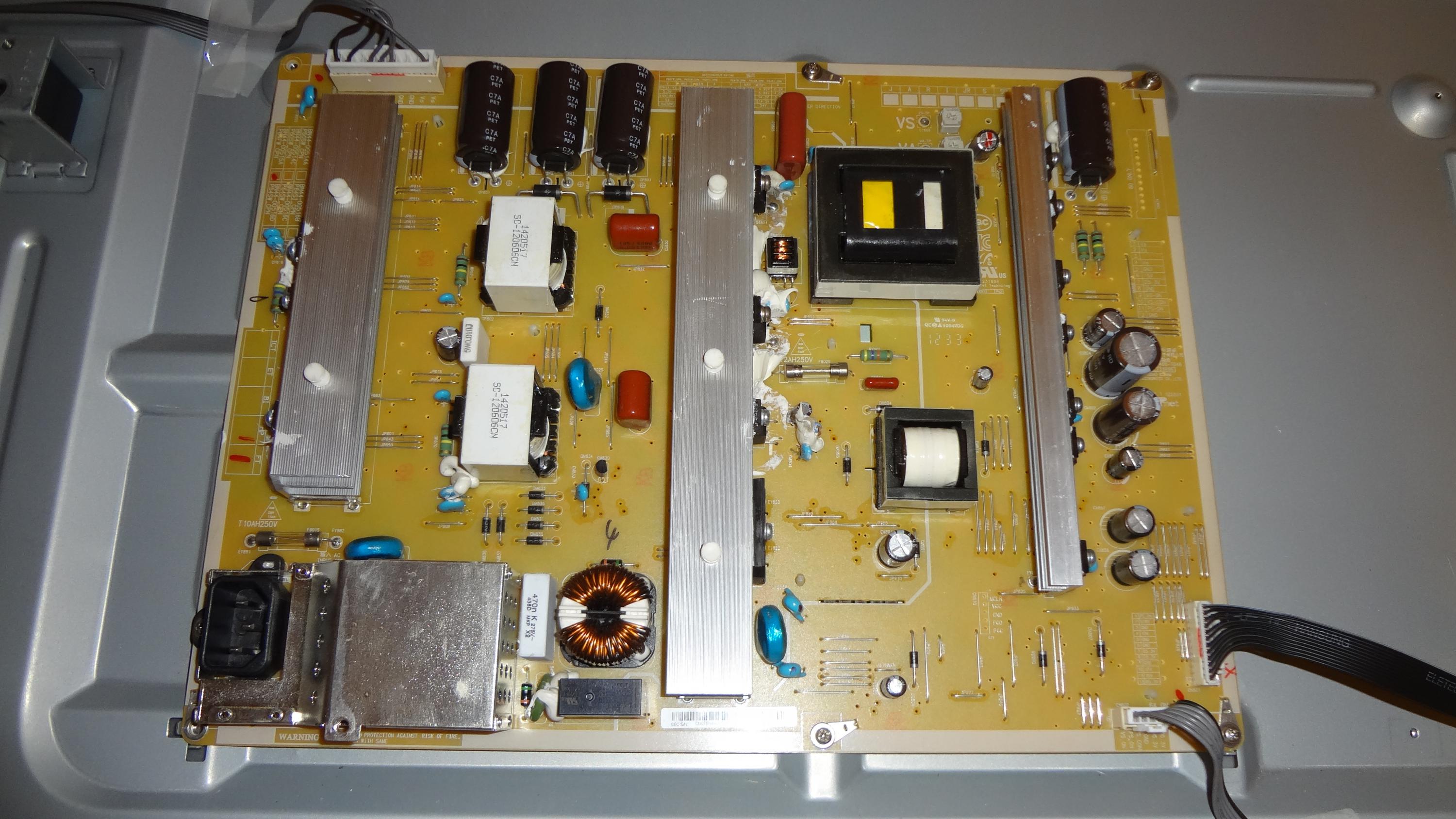

    Looks like somebody has changed some of the transistors and one of the ICs on the heat sink.
    They did a really poor soldering job so I removed all the components as well as the heat sink cleaned it all up put it all back together still tests the same as above.

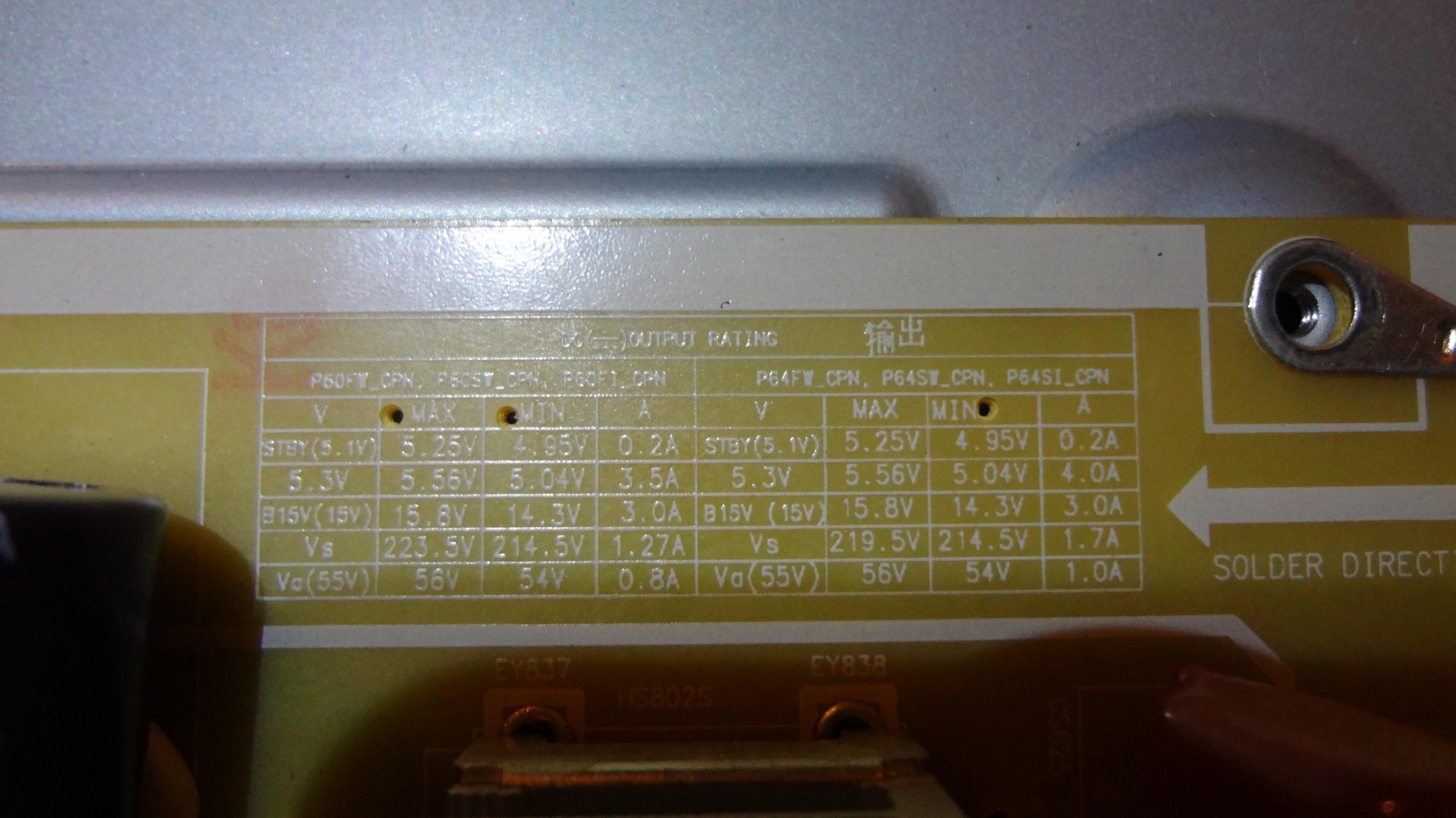

    This is the first plasma that I've attempted to troubleshoot but 0.5VDC for STBY voltage seems way to low?
    Pictures are before the cleanup job. Looks much better now got rid of all that white silicone.
    Re: Samsung PN64E533D2F
    1 PS_ON - 2.3VDC
    2 STBY - 0.53VDC
    Something does not add up in the reading, if main board only getting 0.53VDC to run the board, then I cannot see how the PS-ON command signal from the main board can be higher than the STANDBY Voltage, it has to be measurement error some where.
    What is the board P/N? I need to see the pin names and numbers on the connectors on that power supply board.

      Check fuse F802s. Also the 2 transistors on that bank near F802s. Check middle pin to end pins. Bet the lower one or the upper one is shorted. Also check the other two transistors at the end of the power supply that were replaced. Bad solder connections will automatically short those MOSFETs out. Also if you look underneath the board near the two transistors by the power connector that were replaced there is that IC. That is a regulator IC. That's known to fail as you can tell it looks like its been replaced before.

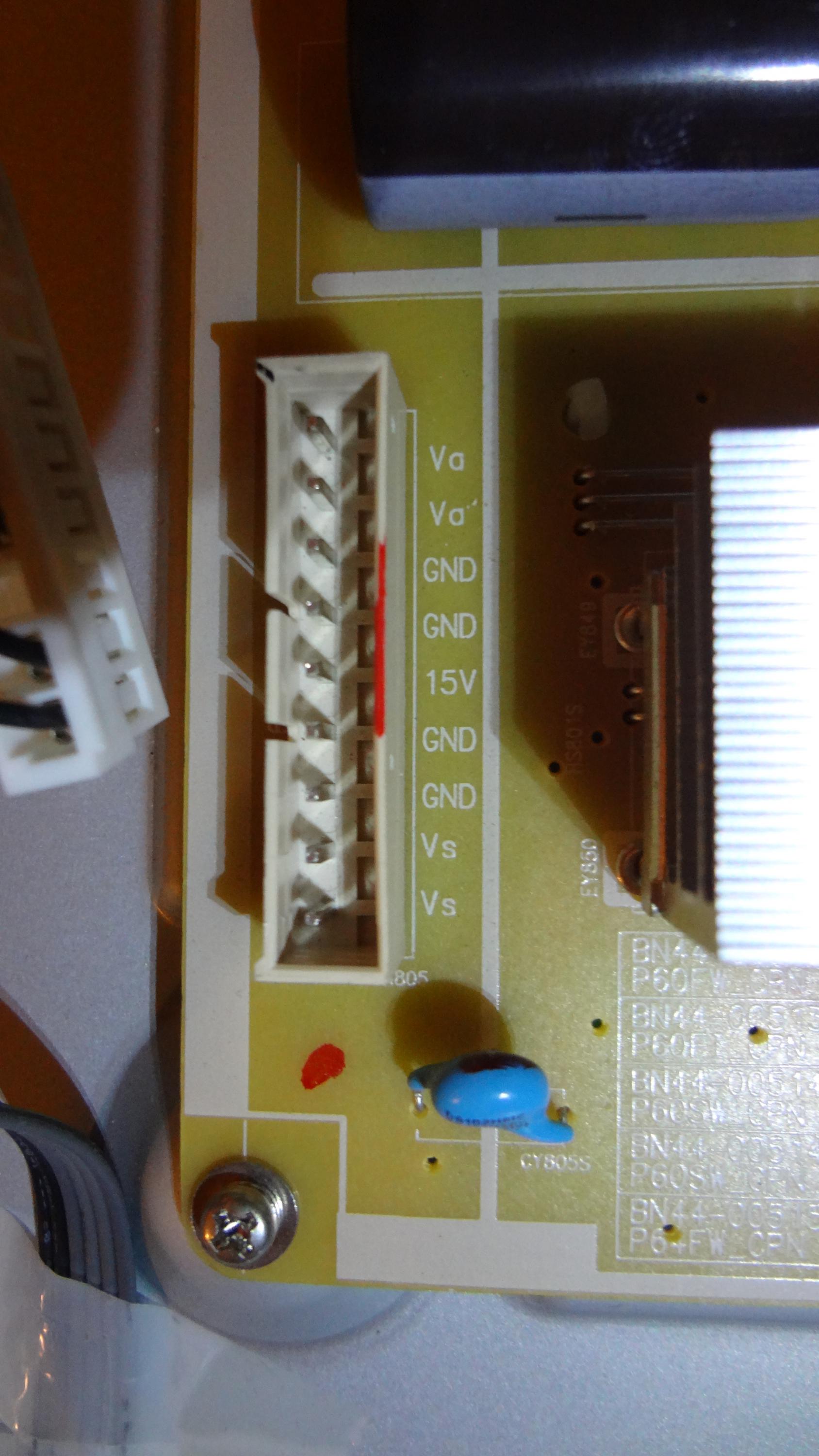

        Power board P/N BN44-00515A
        I'll check all those suggested parts.

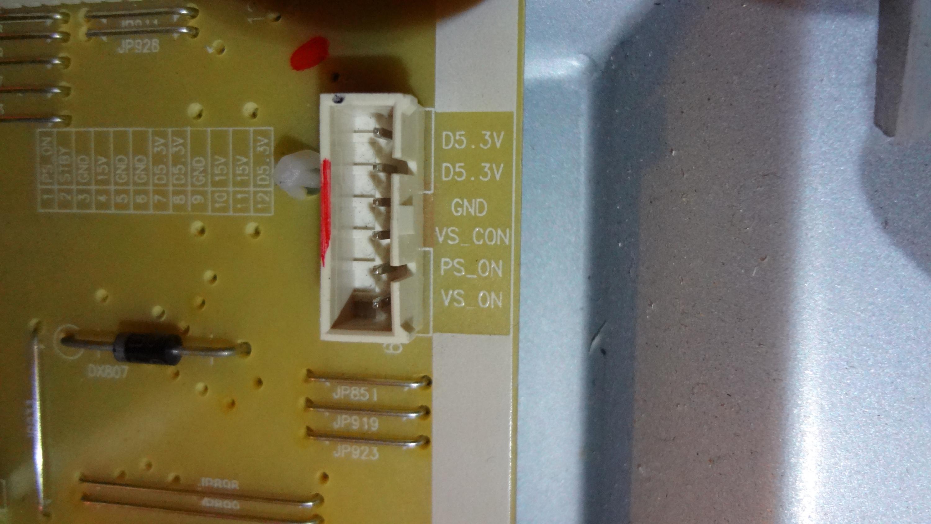

        Also attached pictures of all connectors on the power board.

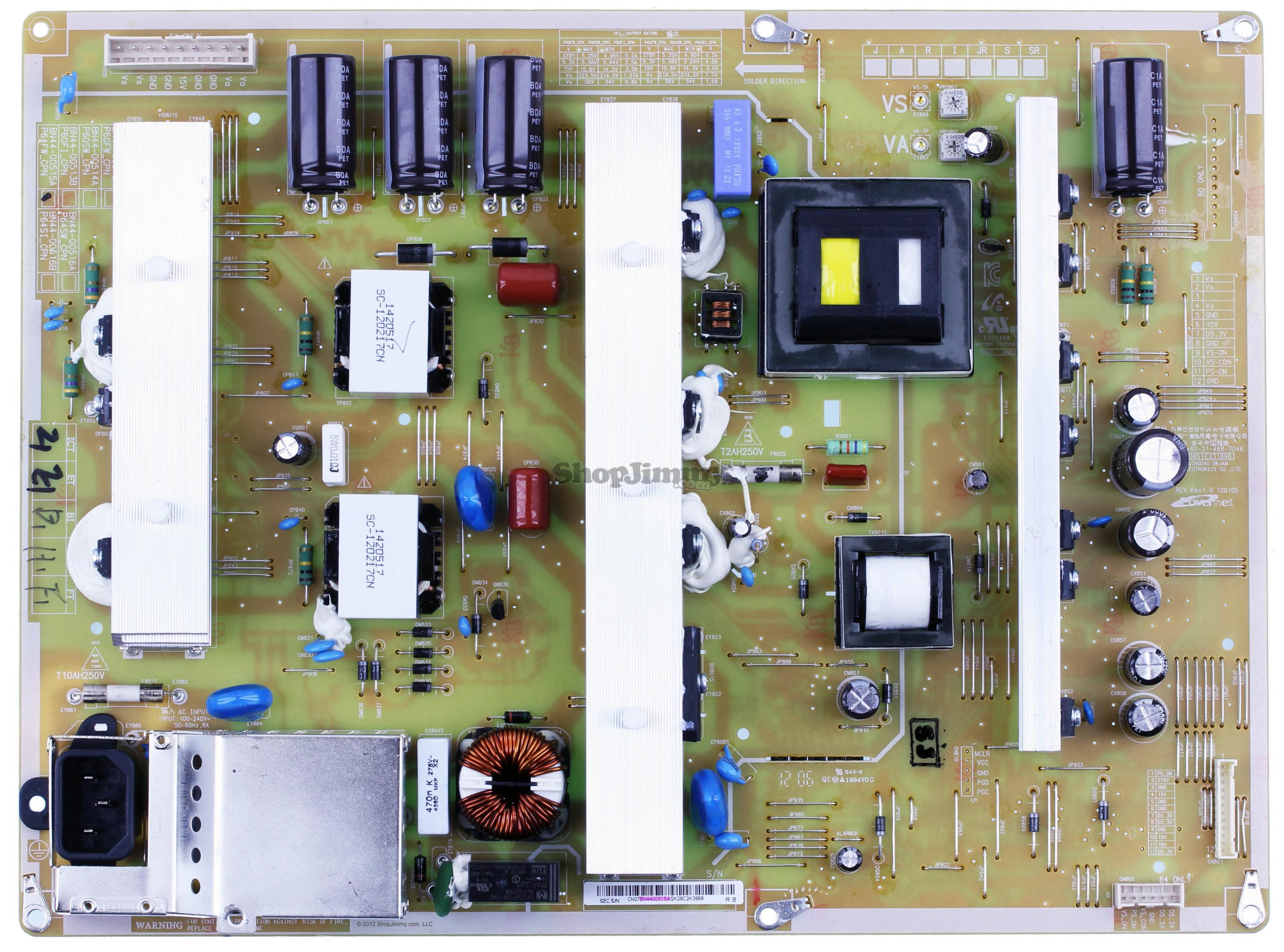

          Just in case you thought that the white stuff wasn't original:
          http://assets.shopjimmy.com/media/ca...00515a-top.jpg
            LoL, yea I knew that stuff was supposed to be there. Whoever tried repairing this board before I got the TV did a crappy job of trying to work around the silicone and heat sink.

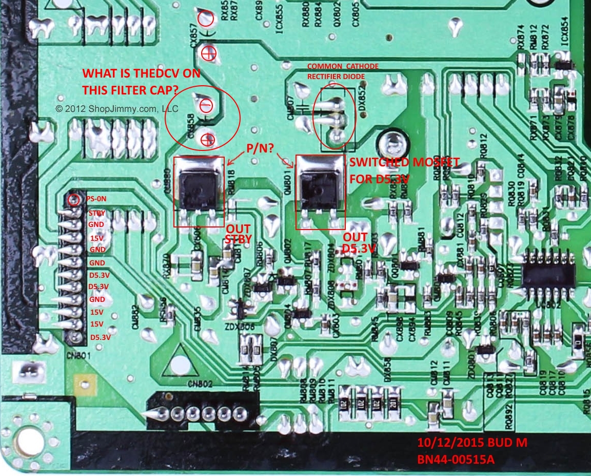

              OK, you need to check the DCV (between the two legs) on that filter cap I marked.
              I also need the P/N of those two devices.
              BN44-00515A Pictures provided by SHOPJIMMY.

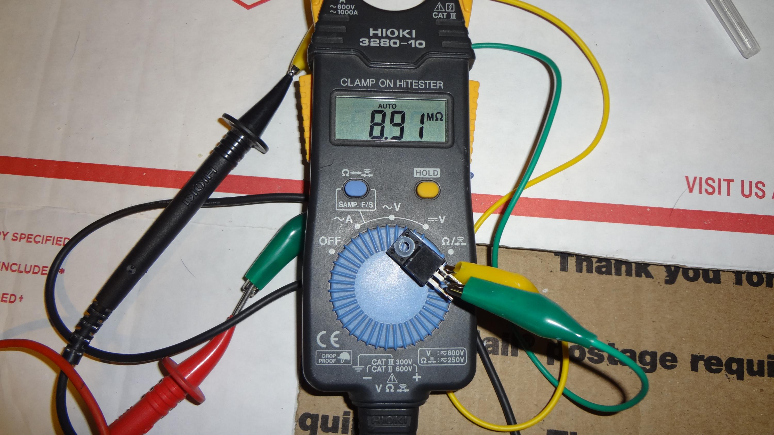

                Before I saw post #7 I've taken all the transistors from the heat sinks to test for shorts and QS804 P/N 12N50 source and drain are shorted.
                  QS804 is the the VS SMPS section, it is the lower half of the Half bridge drive for the VS Power transformer. Did it cause the main AC fuse to blow?
                  Fuse F802S is for the STBY SMPS section. So the STBY power supply should still be working.
                          The cap you marked CX858 shows 5.3VDC
                            OK, so we do have DCV feeding the QM800 and QM801 but some how you only have <1Vdc on the STBY pin 2.
                            Notes; I expect higher than 5.3V due to the Vdrops on the switched devices.
                            'D4184' I am not sure if the full P/N will be 2SD4184 (NPN) which is not MOSFET.
                                OK, that makes more sense, it is N-CH MOSFET.
                                So what DCV do you have against GND on S, D, and G?
