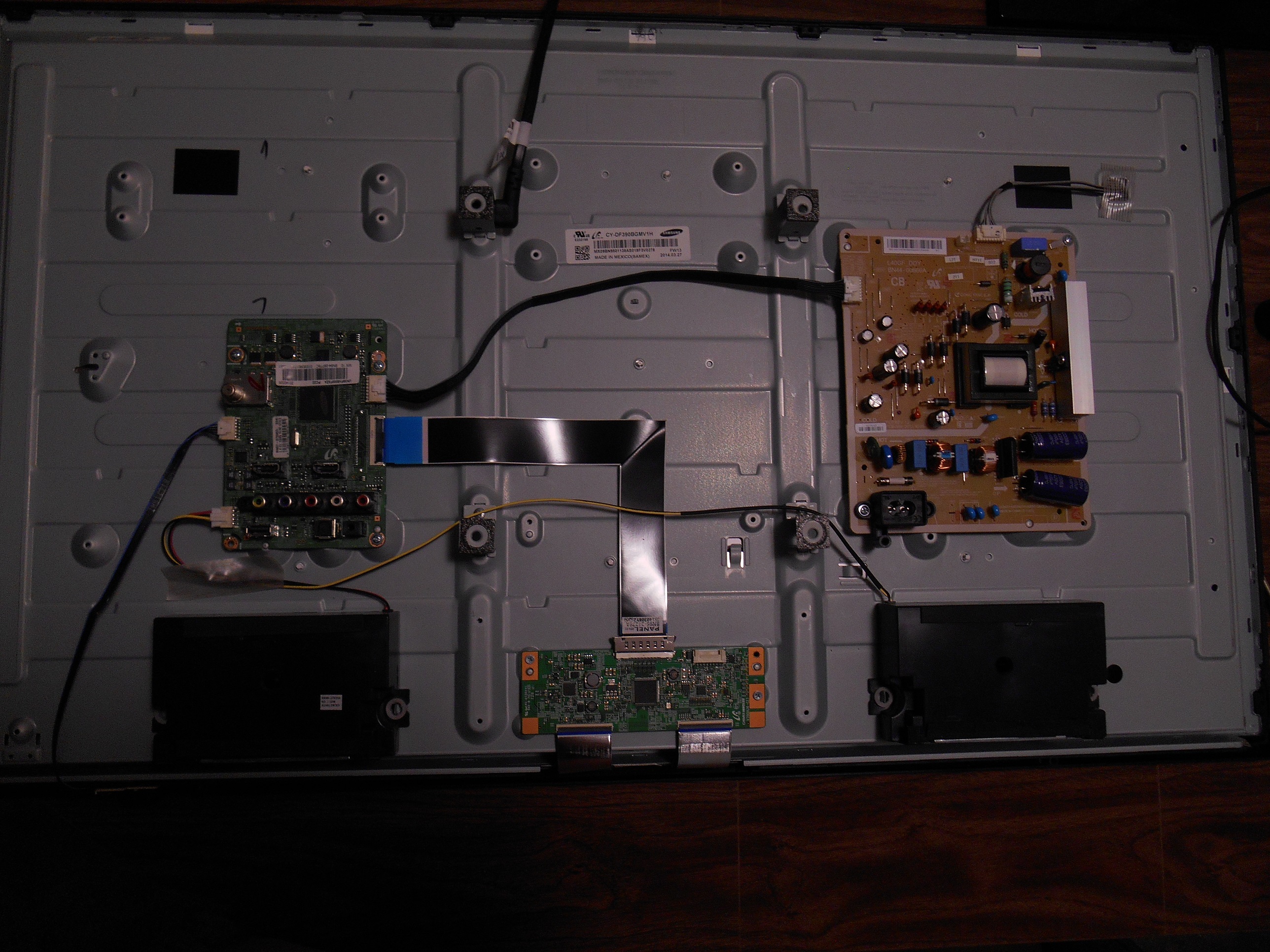

    Just out of warranty at one year old, this started out intermittently then got progressively worse, now it takes many cycles for it to work if at all before giving up ;-)
    Turn the TV on and it makes the Samsung powerup noise, backlighting comes on but nothing on the screen. After about 15 seconds, it will cycle through the powerup again and keep cycling until it eventually comes on. When it is cycling you can't turn it off to stop this, it has to be unplugged. Plugging it back in results in the same cycling until it finally comes on or until you unplug it. Once on, the TV will work fine for hours till turned off.
    No swelled caps or cold solder joints on the PS board, unplug the main board and the backlighting comes on and all voltages seem to be normal and stable at 5.25V and 13.05V, have not load tested them yet. Cursory inspection of the main board under magnification shows no obvious flaws or solder problems.
    When the TV finally comes on and you shut it down, the 5V standby voltage is present and stable. Tried unplugging the power button as well as the TCON cable with no change.

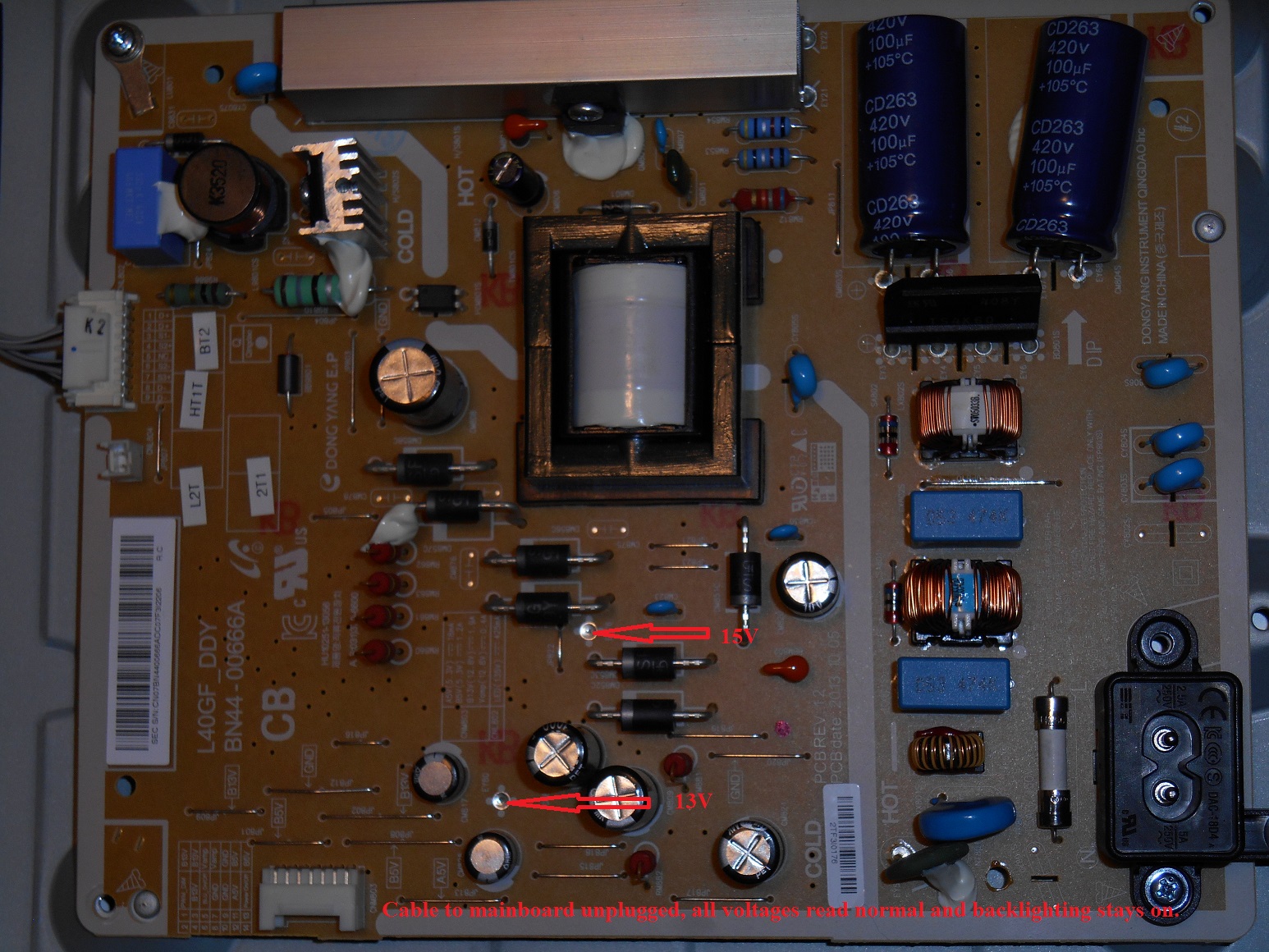

    The two PS test points indicated in pic read 13V during cycling, the one marked 13V (EY80) goes to 0V when cycling, then back up, but the one marked 15V (EY76) cycles up to 15V and back. With main board unplugged EY80 stays at 13V and EY76 measures 15.4V.
    PS BNN44-00666A
    Main BN94-07695D

    Connector CNM803 pin 14 POWER ON-OFF swinging LO and HI (<1 to >2V)?

      Re: Samsung UN39FH5000FXZA LCD TV power on cycling
      Yes, 3.5V while backlighting is on for 15seconds then drops briefly to 0V, then next cycle, repeat.
        Since the STBY Voltage for the main board is steady by the PS-ON is not, then you have the problem on the main board somewhere.

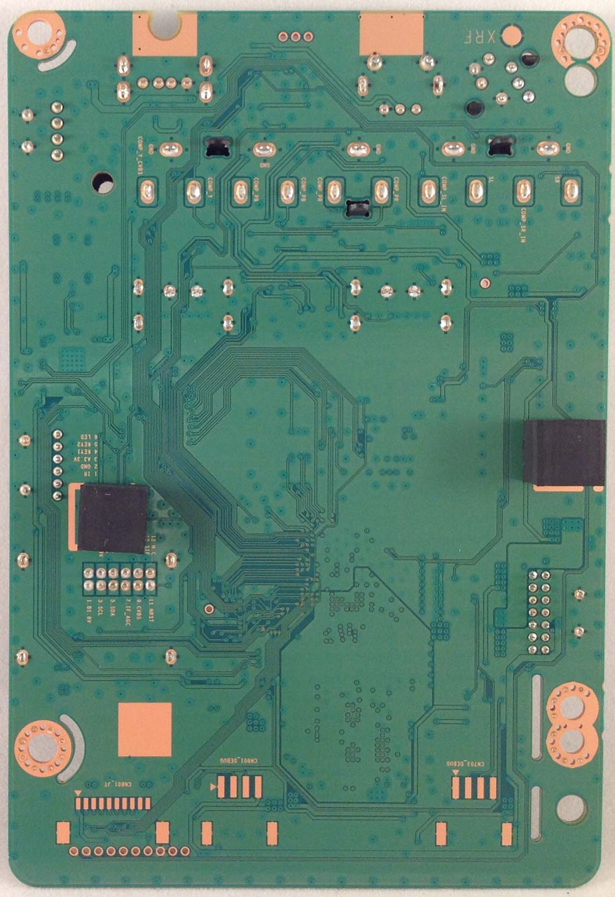

          Included pics of the back of the TV and both sides of the main board for future.

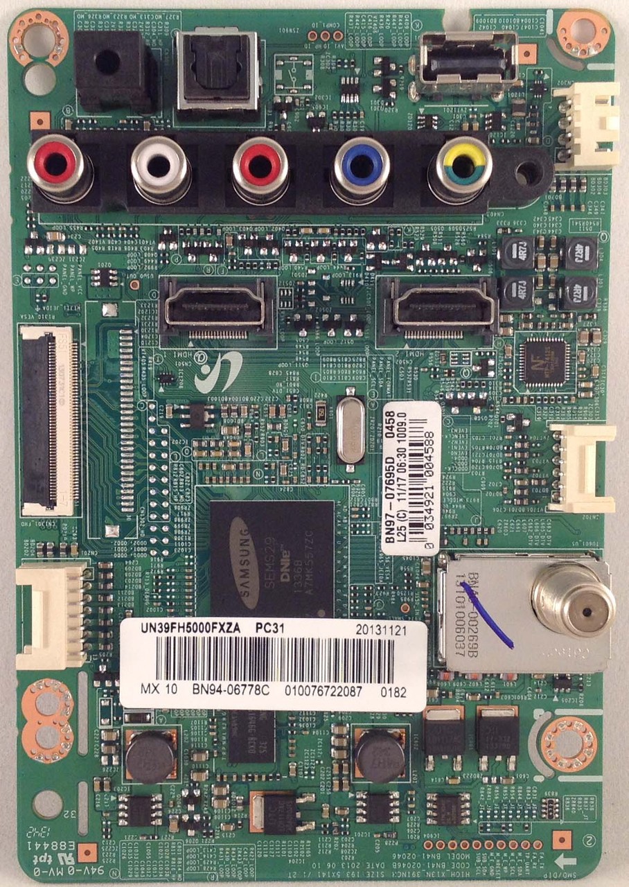

            intermittent PSon = main board problem. I think your mainboard is a BN94-06778C. In order to trace, you would have to remove the sticker. Better look for a replacement board.
              You are correct on the part number, screwed that up in original post.
              PS BN44-00666A
              MAIN BN94-06778C
                Update: A close look at the main board under magnification revealed a few questionable solder joints on the regulators, one IC, and the pins of the PS connector. Reflowed them and no change, so I guess without any info on the main board I will just replace it.
                I also did voltage checks at the main board connector and all voltages that should be there are present and stable, ruling out a bad cable.

                      A locally sourced main board solved the problem, thanks for the help.
