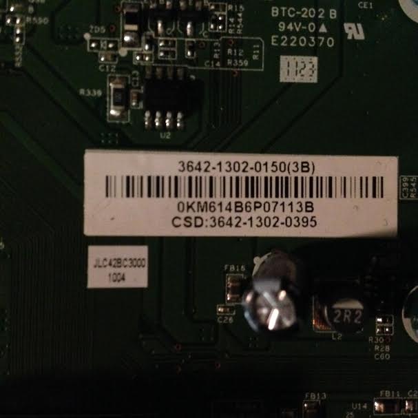

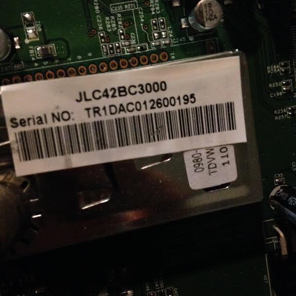

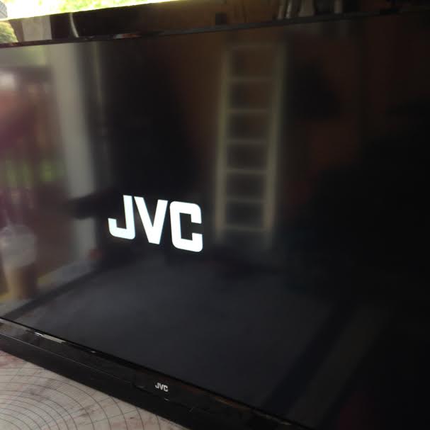

    JVC JLC42BC3000 screen froze on "JVC" logo.
    Hi, I'm trying to repair the logic board " 3642-1302-0150 " on my JVC LCD tv. I'm looking for any help possible. I've repaired another in the past by mailing off the logic board but I'm more interested in learning how to repair it myself. I have the back cover removed, multi-meter, pencil, paper, and a double shot of espresso ready in hand. I do not see any puffed capacitors or burn marks. Currently the screen lights up and the JVC logo sits in the screen. No buttons work and TV only powers down if I unplug it. Where should I start? Thank you in advance-

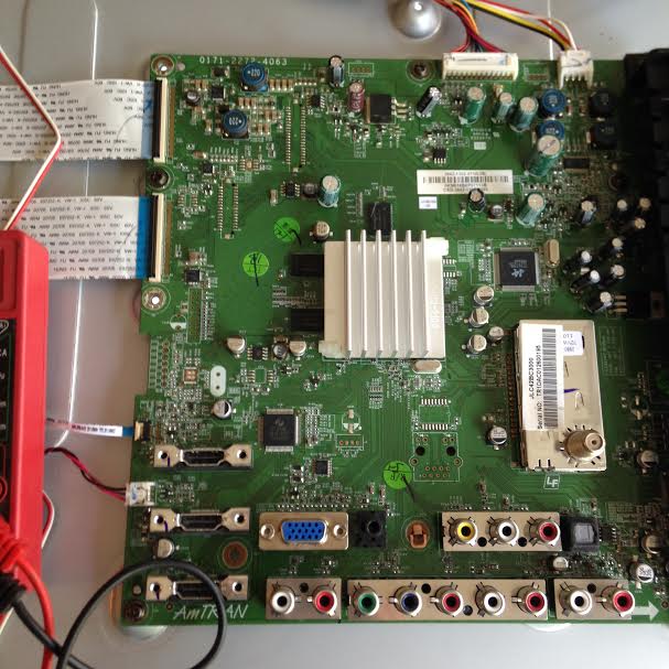

    Re: JVC JLC42BC3000 screen froze on "JVC" logo.
    Attached pictures-

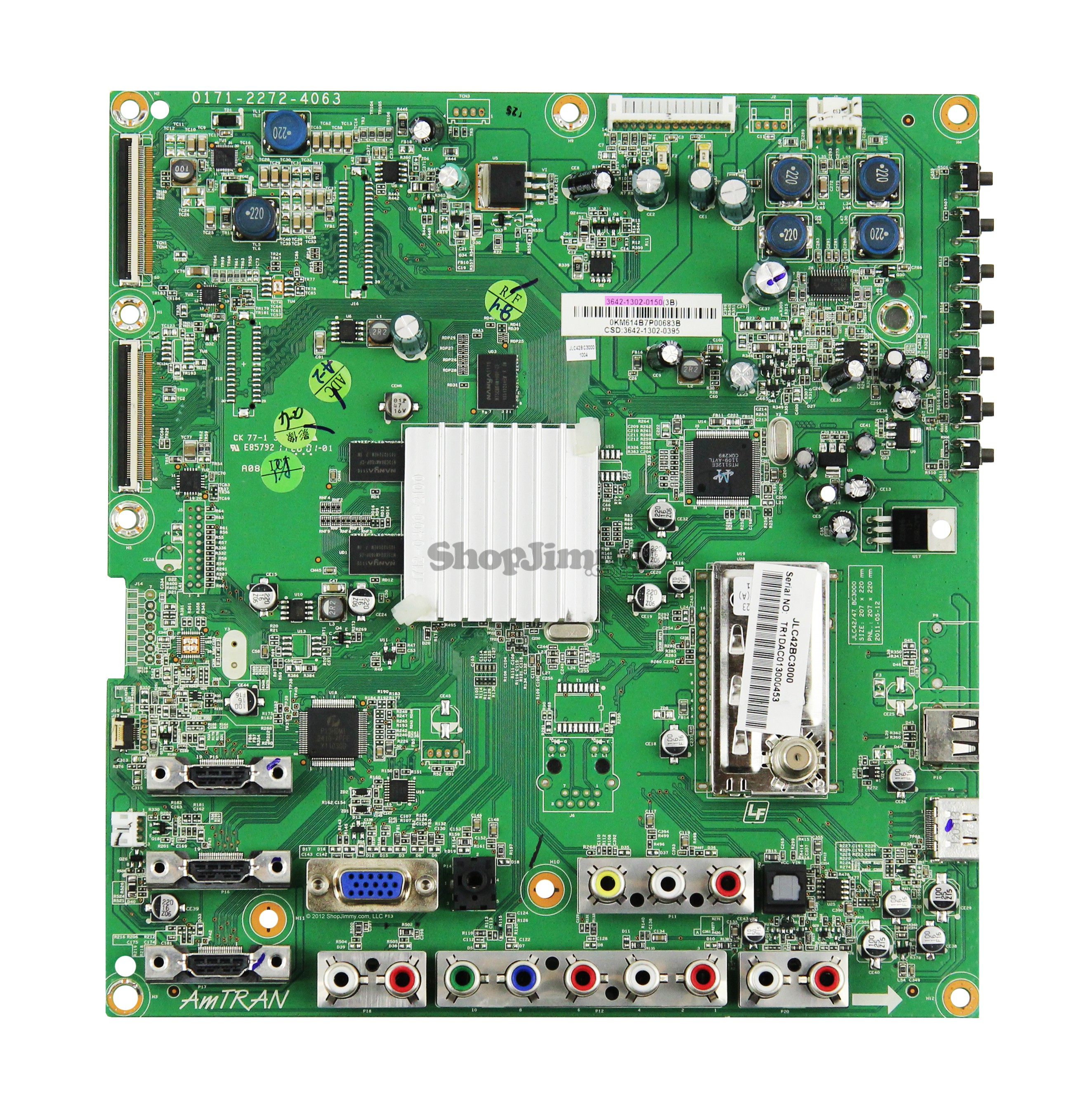

      http://www.shopjimmy.com/catalogsear...VC+JLC42BC3000
      There are at least two fuses on that main board that I can see, also Voltage regulator ICs that you need to check.
      Pictures provided by shopjimmy.
      Read the link below my signature on how to test and report the readings that will be easy for us to understand.
      BTW, the main board is made by AMTRAN which is the same company that makes board for VIZIO which has history of bad Voltage regulators 1117 series. This JVC is just a rebadged.

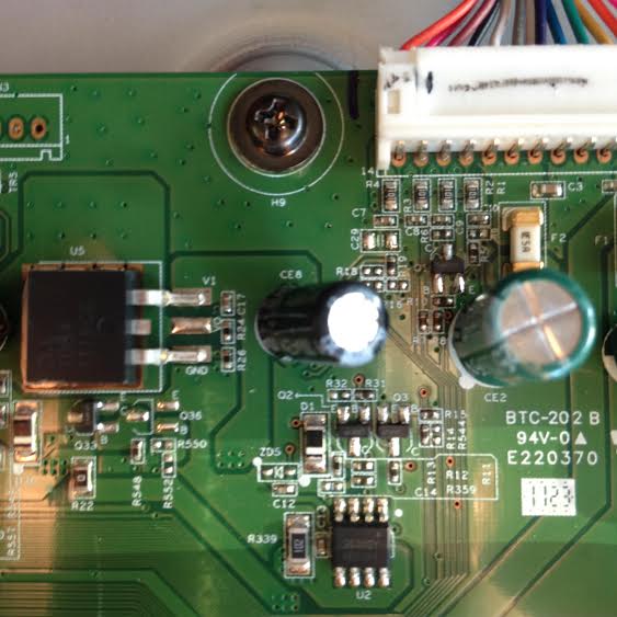

        Thank you budm. I assume the fuses your talking about are F1 and F2?
        F1=5.28VDC on both sides of gold terminals
        F2=12.29VDC on both sides of gold terminals
        These are the voltage regulators that I located, there may be more that I'm not seeing.
        1084-VI= 5.22VDC VO=3.28VDC GND=2.05VDC (U5)
        1117 #U9: In=5.23VDC Out=3.28VDC ADJ=2.02
        1117 #U3: In=5.26VDC Out=3.29VDC ADJ=2.04
        949D32: In=12.25VDC GRN=0.00 Out=5.04 (U17)
        Also (U5) 1084 only has 2 of the 3 pins attached to the board. I've attached a picture showing this. the voltage on the detach and on the solder point are both the same. It may be designed this way.
        Here are the voltages for the 14 pin connecter:
        VBR_B - 3.22VDC - Orange
        Status - 0.0VDC - Red
        On/Off - 2.63 - Brown
        On/Off - 3.18 - Black
        12V - 12.27 VDC - White
        12V - 12.27 VDS - Grey
        12v - 12.26 - Purple
        GND - 0.01VDC -Blue
        GND - 0.01 VDS - Green
        GND - 0.01 VDC - Yellow
        GND - 0.01VDC - Orange
        5.2VSB - 5.8 VDC - Red
        5.2VSB - 5.29 VDC - Brown
        5.2VSB - 5.28VDC - Black
          you have an ESR meter or an oscilloscope to check the caps?
            "5.2VSB - 5.8 VDC - Red" This one is probably an error because the other two are the same.
            Your Voltages look normal but I do not know what the status pin is should be HIGH or LO for normal operation, right now it is sitting LO.

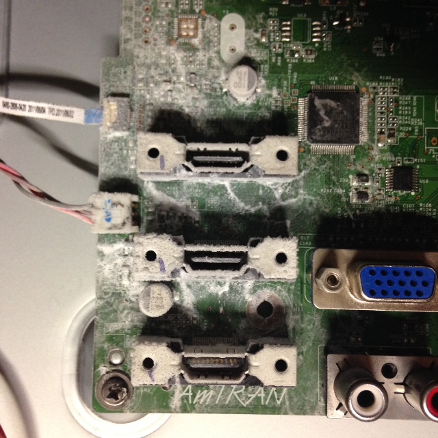

                                • Langston
                                  • Oct 2015
                                  • 16
                                  an eeprom MAY work again if cooled good enough. That trick doesn't work on every eeprom, but it does work on a large percentage. You can apply that trick too on a bad eeprom that you want to read out and then program a new eeprom with the retrieved data. So you don't need to go ".bin" hunting.

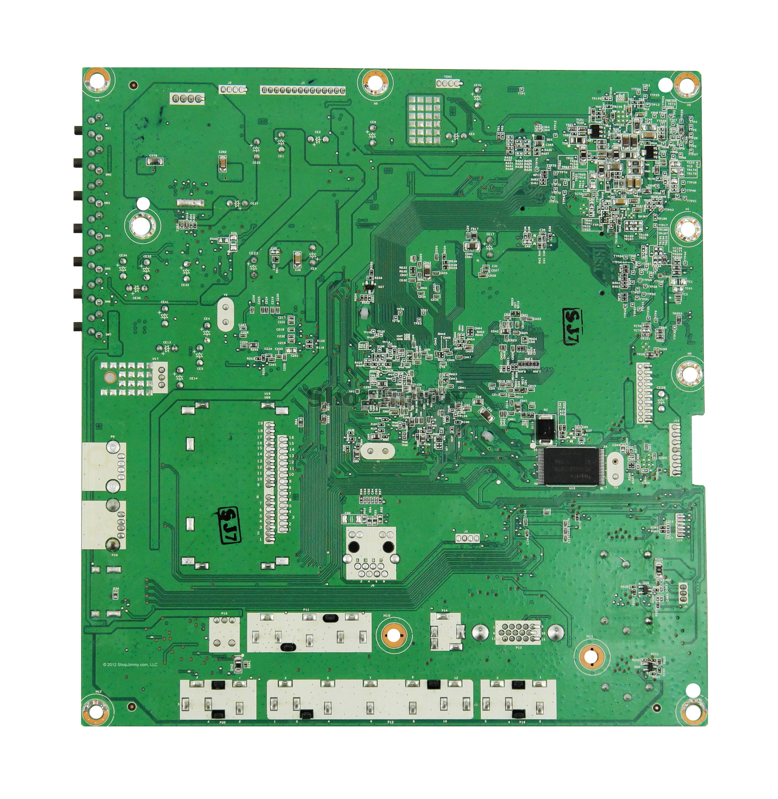

                                  I've isolated the area to this corner of the board near the HDMI inputs. Still can't pinpoint the exact problem. If I freeze individual components it doesn't boot but if I freeze the whole corner it boots and works properly. Any idea what component would be fixed by freezing on this corner?
                                  See attachement-
                                    I wonder if the HDMI chip is locking up the processor. How hot does the chip get?
                                    • Langston
                                      • Oct 2015
                                      • 16
                                      Thanks budm, Which is the HDMI chip in the picture you provided from shopjimmy? Also what is the round (capacitor??) CE39?
                                        U18 (80-PIN IC), what is the P/N as printed on the top of the IC?
                                        CE39 is the SMD lytics cap.
