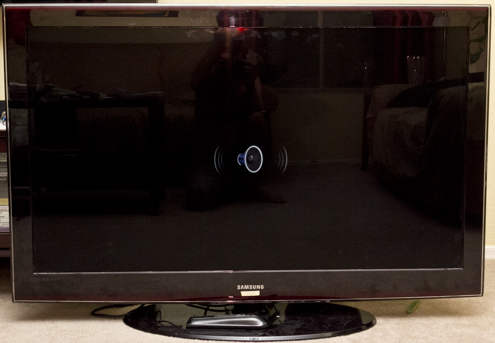

Is this a main board issue on Samsung LN52A650A1FXZA?
  • Pioneerx01
    • Apr 2015
    • 241
    • US
    The TV initially works just fine. All the menus, options, channels, sound,...
    Let's say I am watching CH3 via coax cable. The TV would work just fine for about 30-120min. The actual duration is random, but it always more than 30min. Image is running and suddenly it freezes as if someone would press pause. However, the sound still works just fine and you can hear the rest of the broadcast just fine. You can still increase volume, pull up the menu,... just the image is frozen. When I change the channel I get black screen with a icon of a speaker in the middle on black screen. You can hear the sound of the broadcast, but no image. Still the volume, menu, info works just fine. I have to turn the TV off and on, than I am back to 30-120min clock before it happens again.
    Now I want to watch something through HDMI. Everything works fine, within 5 min I instantly get vertical lines on entire screen of various thicknesses and colors, no pattern. The TV power cycles itself, comes back to HDMI and the playback just keeps going. Withing 5 min different vertical lines on entire screen of various thicknesses and colors, no pattern. This did not happen on the coax side. If I leave it it will just keep going like that. Sometimes the TV juts power cycles, no lines.
    Anyone has a clue about what can be the problem?
  • saddle_au
    Waste Warrior
    • Jan 2013
    • 121
    Re: Is this a main board issue on Samsung LN52A650A1FXZA?
    I would be looking at the regulators on the main board and the stability of the 12v and 5v coming from the power supply.
