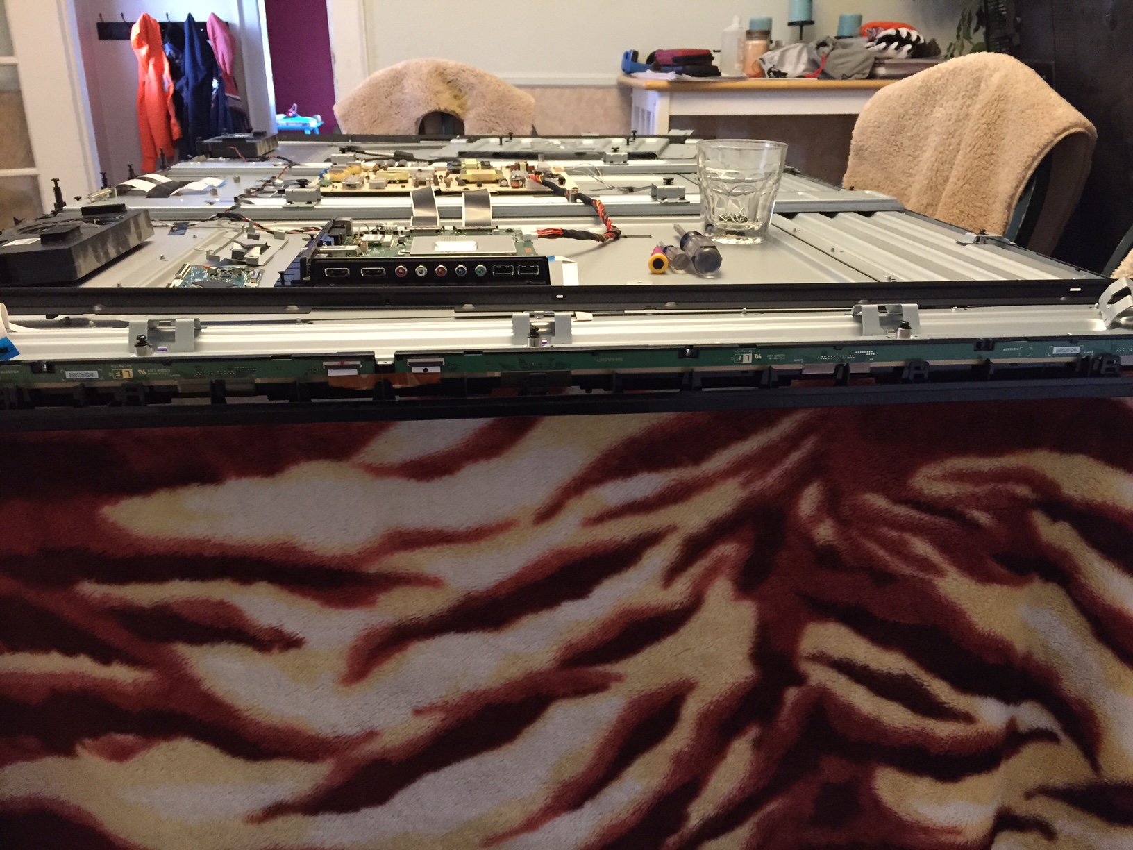

                        Ok so I have my board out and I'm trying to test the resistance of the transistor in question. Problem is I'm not sure I know how to read this multimeter.
                        I have a range setting. I can set it to Ohms, KOhms, and MOhms. I get readings for KOhms and MOhms but I get no change in the reading for Ohms. The stock reading is 0.L
                        When I touch the leads together I get 00.00 except when I'm on the regular Ohms range and I get 000.5
                        Can you help me understand what setting I need to have this on when I test the transistor?

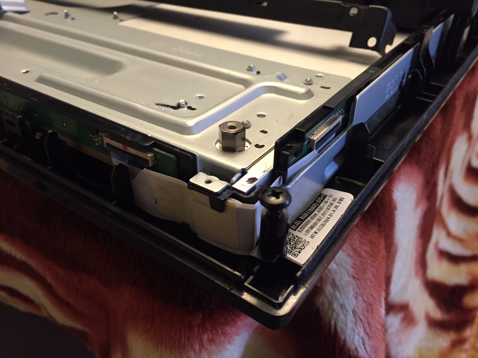

                              #454
                              Re: e701i-a3 no picture but backlights
                              Lets see if I attached the photos correctly (I'm on mobile at the moment so it's a little wonky). If not I'll edit when I get back to my PC.
                              One picture is of one of the gold tabs attached to the side panel
                              The other two are my multimeter, 0.L being with the leads touching nothing and the 00.00 being the leads touching each other. I couldn't adequately get a photo while actually testing the board. I'll see if I can get help from someone later today.

                                #455
                                Thanks... not really worried about the testing photos... I trust you... :-) as I think your test is correct and is likely indicate a good transistor.
                                Further, the picture of the tab appears to be good although it is clearly showing the driver itself. As I asked before, you are able to visibly see all the drivers in question to determine their "condition"?
                                IF the drivers are fine, it is quite possible that you have a power board failure... maybe. You need to attempt to verify the voltages that are printed on the power board at the various connector... carefully, with the set powered.
                                BUT WAIT... did you do the "corner flex cable" test that I suggested, to see what happens (ie. does the set come up in some form)?

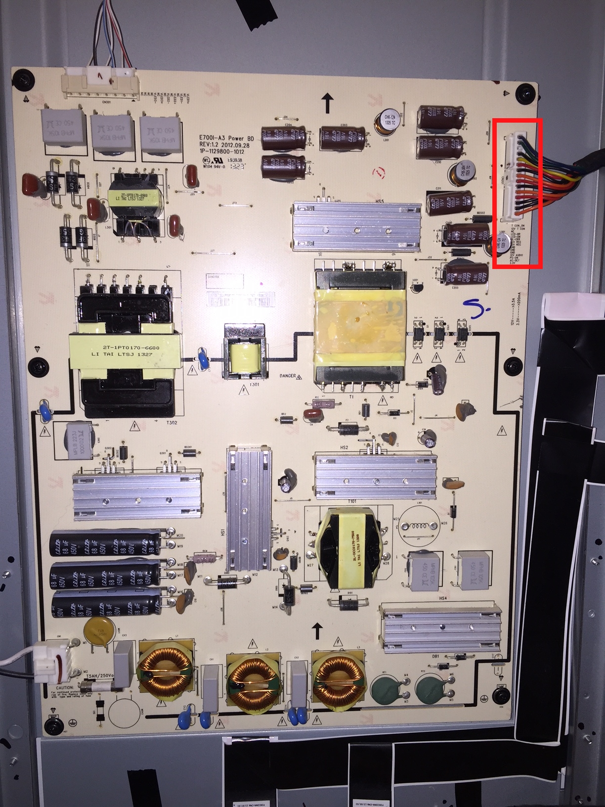

                                        hmmm... ok. Well, it is likely you have to go to the next step and check voltages on the power supply board.
                                        As for the picture of the "driver board", you don't need to look at the board itself, the tab driver IC is "embedded" / bonded to the actual cable about in the middle of the cable. When it is bad, the area around the ic gets a bit discolored from the extra heat.... can't really see the ic in the picture but don't see much of the cable.
                                        Anyways, I think you are moving slowly in the right direction. See if you can carefully measure some of voltages associated with the power supply and go from there.
                                        • MREasyGuns
                                          • Mar 2016
                                          • 11

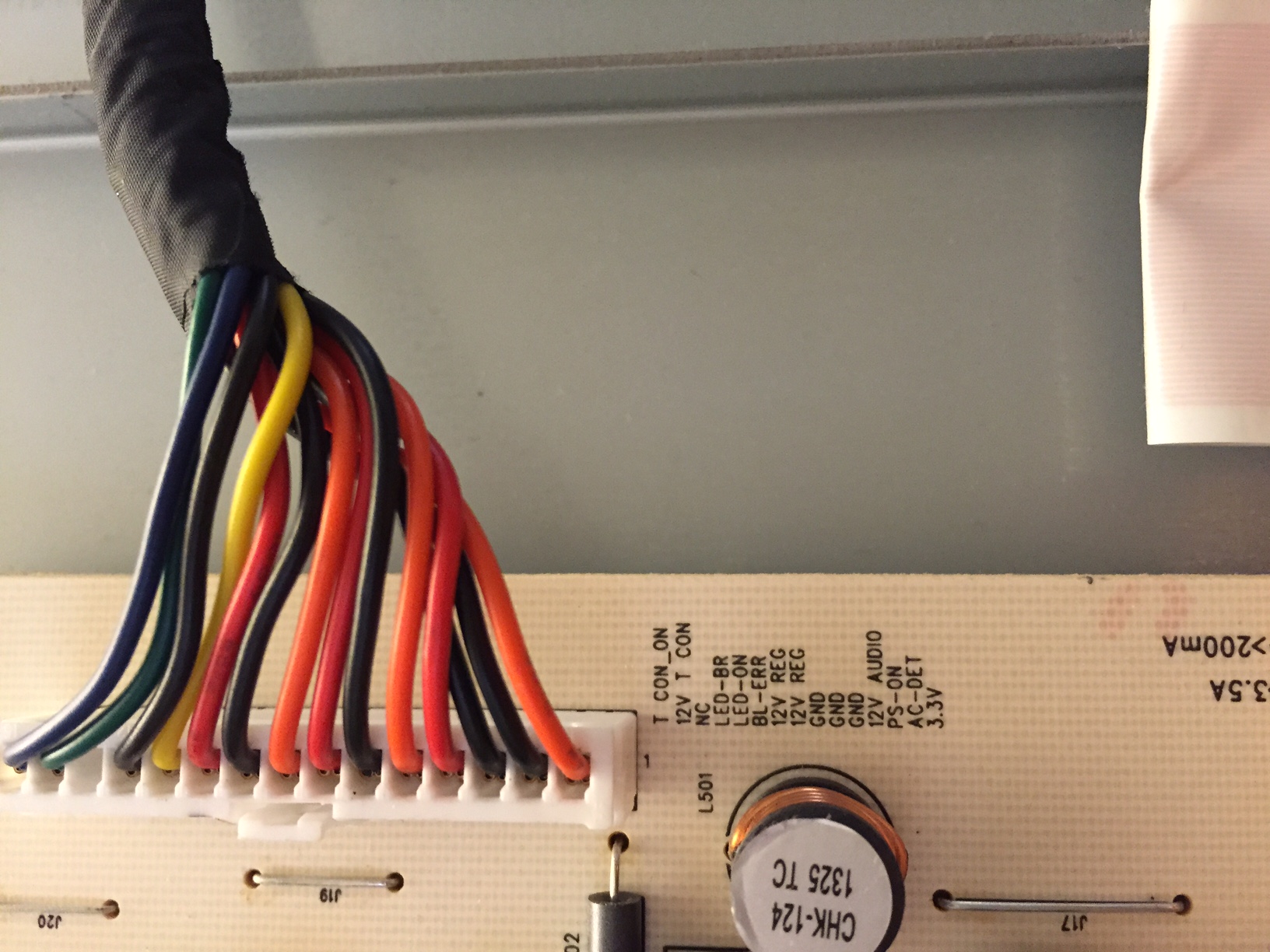

                                          #460
                                          Ah I think I see what you mean about the tab driver IC. I inspected them all again and didn't see anything that appears damaged to me.
                                          Tested the power board where the pins pins are that go out to the main board. (See pics). I used one of the ground pins for my black lead.
                                          Results are:
                                          T CON_ON: 3.2V
                                          12V T CON: 12.2V
                                          NC: No Cable
                                          LED-BR: 2.8V
                                          LED-ON: 3.2V
                                          BL-ERR: 0V
                                          12V REG: 12.29V
                                          12V REG: 12.29V
                                          GND
                                          GND
                                          GND
                                          12V AUDIO: 12.29V
                                          PS-ON: 3.3V
                                          AC-DET: 3.4V
                                          3.3V: 3.3V
                                          Does anything seem off? I should probably find a manual for the TV...
                                          Also, I'm assuming everything at the bottom of the board inside the thick black line is 120V AC and everything at the top is DC is that correct?
