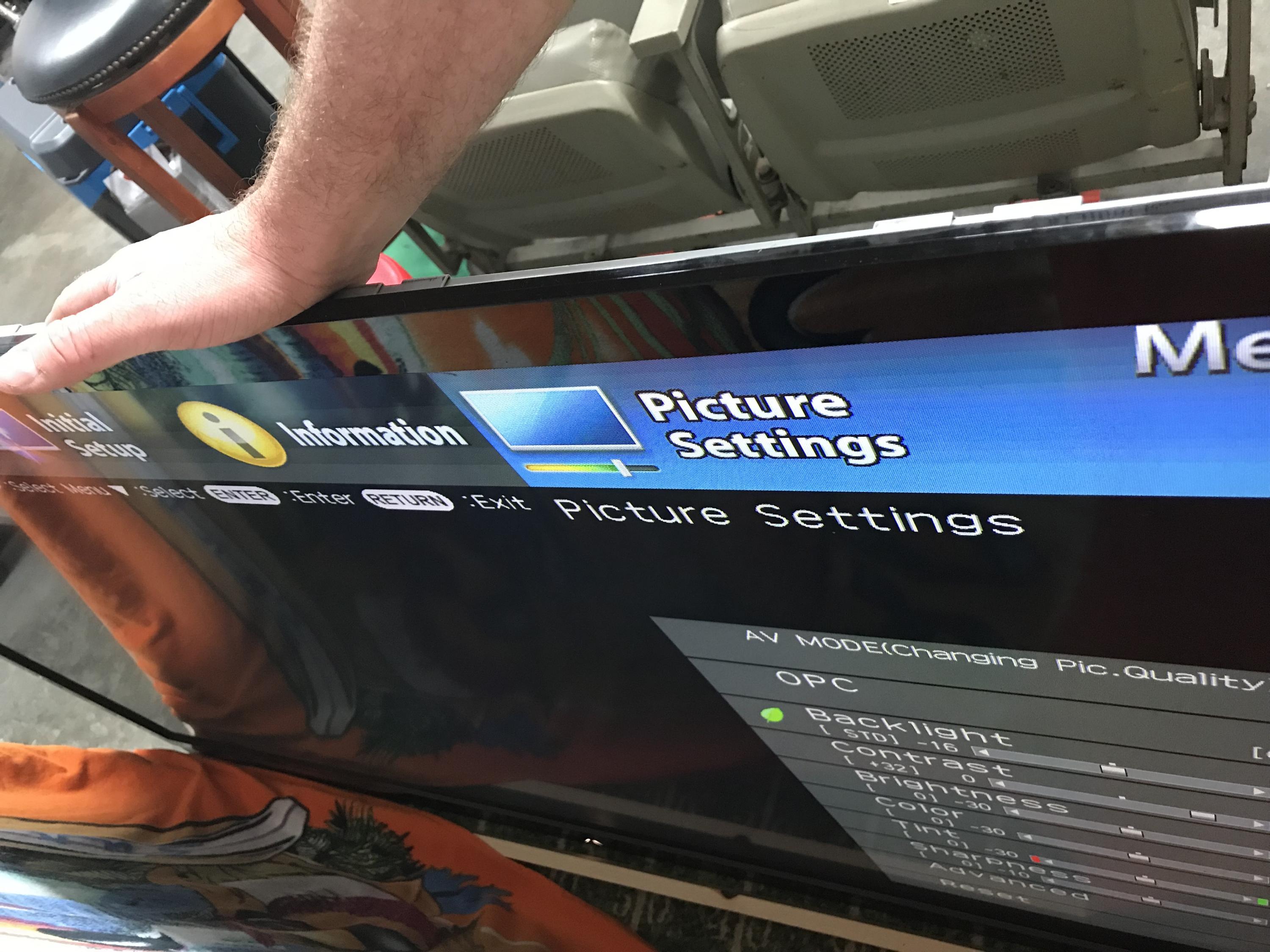

                      Hey there Bud, brand new to the badcaps forum. Have the same TV that you all were diagnosing here in this thread. I am a novice at this stuff, but I am learning. I wanted to test this part as you did(KIA378R12PI). I am having a similar issue as Peter, plug the panel in, and get the 2-5 code. I too was reading 7.5V on the PNL12V line when I push the power button. I get my standby voltage, voltage jumps on the AC-DET pin when power is turned on.
                      My question to you, is how do I test to see if this bad on my board? Do I need to de-solder it from the board? Am I testing in diode mode? If so, what value am I looking for?

                        You just have to test the Voltage at the input pin of the IC, It should be 12VDC, then output should be 12VDC, but you are getting only 7.5VDC so it is bad.

                          Thanks, tested it real quick before work this morning. Getting a standby voltage of 12-13V at first pin, zero on the remaining. When I push the power button, I get 7.50V on the second pin, 0V on the third, and 2.5V on the 4th. I will search for a spec sheet later today, but it sounds like it is bad and I will look online for replacement.

                            All your voltages look good except for the 7.5v output voltage. The 2.5v is the control voltage, which turns the regulator on. The third pin is ground. Regulator is definitely bad. The fun part is removing the heatsink to replace the regulator.

                              Bud/Jet, and to the whole thread, thanks for the advice. Got the parts in today. Heat sink was a little tricky to get, but patience is a virtue. Got the new regulator on there, re-installed the board, and voila...perfectly good TV saved from the scrapyard. Thanks again for the thread and the forum. Huge help! Sorry, the picture is upside down, was best I could do with the TV leaning against my bench.
