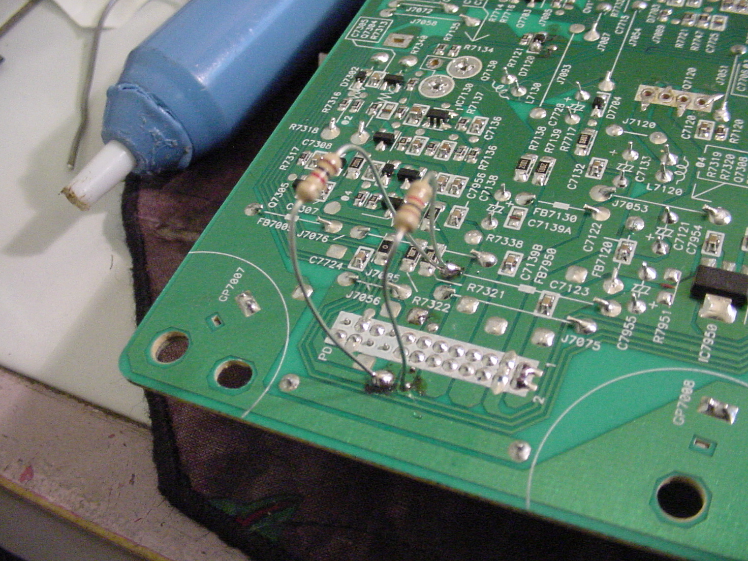

    My 70" Sharp TV LC-70LE632U developed a problem after I went on a trip and disconnected power to my TV for seven days. Upon return, the TV would not power on, only 2-5 code (12V PS problem).
    After changing all boards (t-con, main board, PS board in that order), I got rid of the code, and TV comes on, has sound but no picture. I did a flashlight test, and I can see that LCD panel is producing the picture but no backlight. There is no code. Tried powering it up a few times, even with the VOL- and INPUT buttons pressed as I plug it in the outlet, and no difference. The TV comes on as if everything is OK, but the backlight is not ON.
    Now, in the service manual it says to replace the "LED driver board", except - I cannot see that board on the back of the TV! There are only three boards here, and I even see the four screw holes exactly the shape and size of the LED driver board, but no board. The only explanation would be that the board is under the metal backing. Is that possible? Why would they place it in such a hard to reach place??? Here is a youtube video that shows what the back of the TV looks like with the cover off (mine is a different model, but looks almost exactly the same - same layout and same boards and same sizes)

    I just realized that my model of the TV does NOT have a LED control board!? I am looking at the service manual overall wiring diagram, and model 633 has an LED ctrl board, but model 632 does not.
    Any ideas what is wrong here? I would hope that the old broken PS board did not burn all LEDs, that would quite a feat... there are hundreds of them as it is a full array TV...

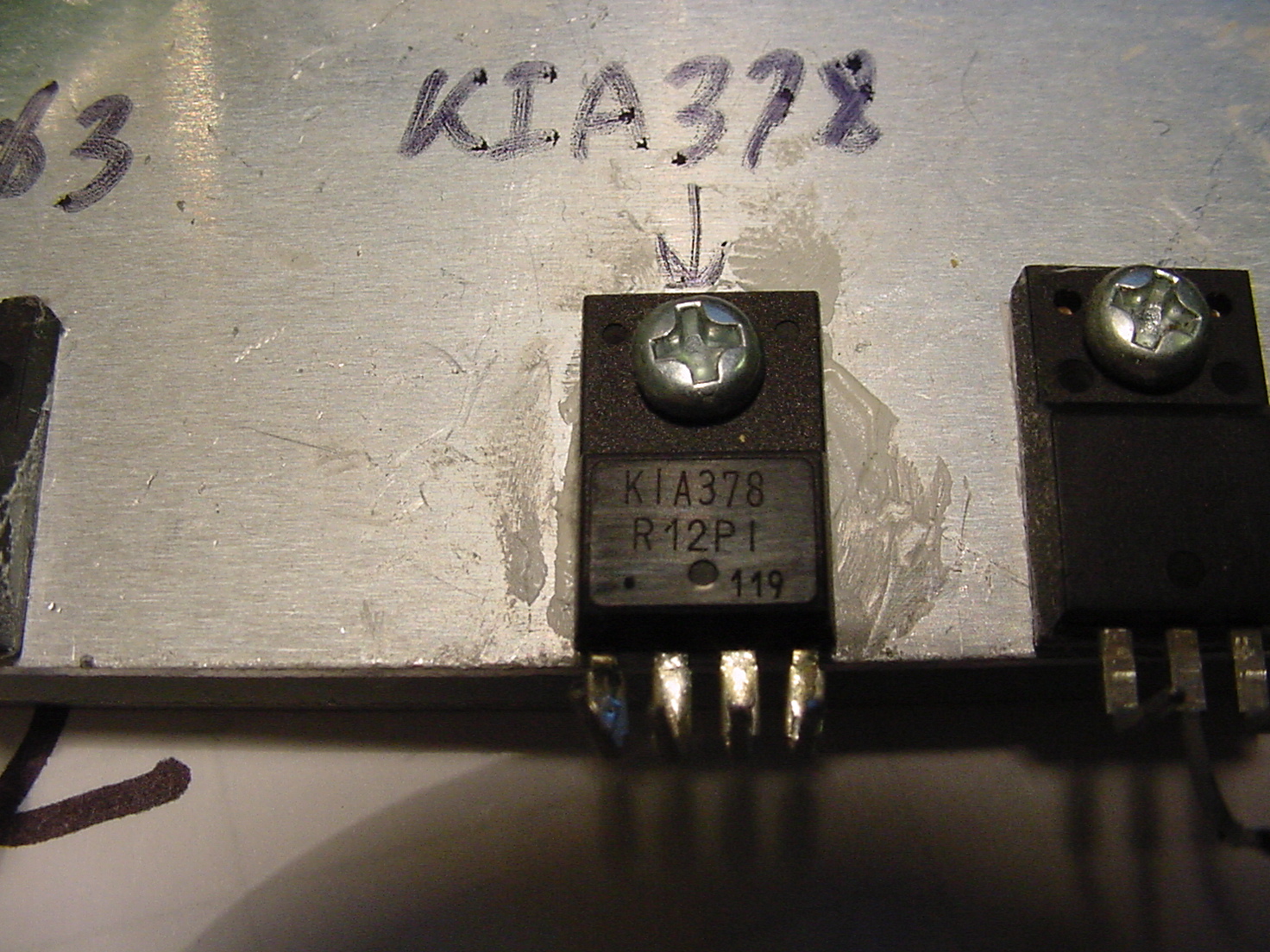

                                        Re: Help with Sharp TV - LED driver board etc...
                                        @PETER, So I tested out your board, the 12VPNL output is only putting out 7VDC instead of 12VDC. It has bad Q7120: KIA378R12PI so you need to get a new one.
                                        I just placed an order from EBAY.
