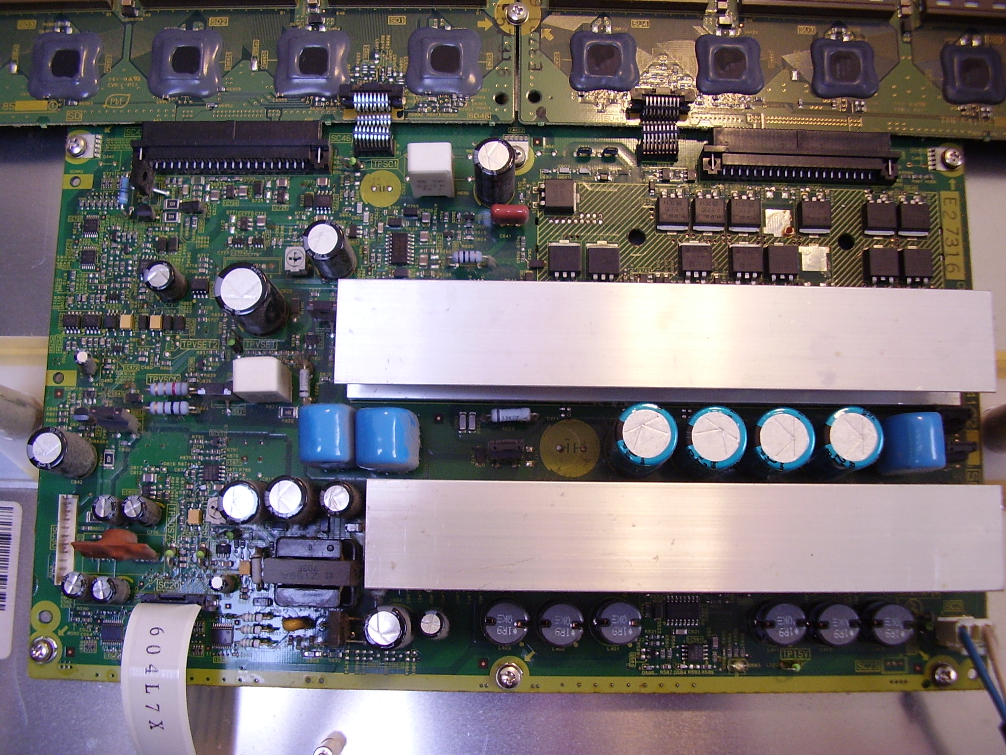

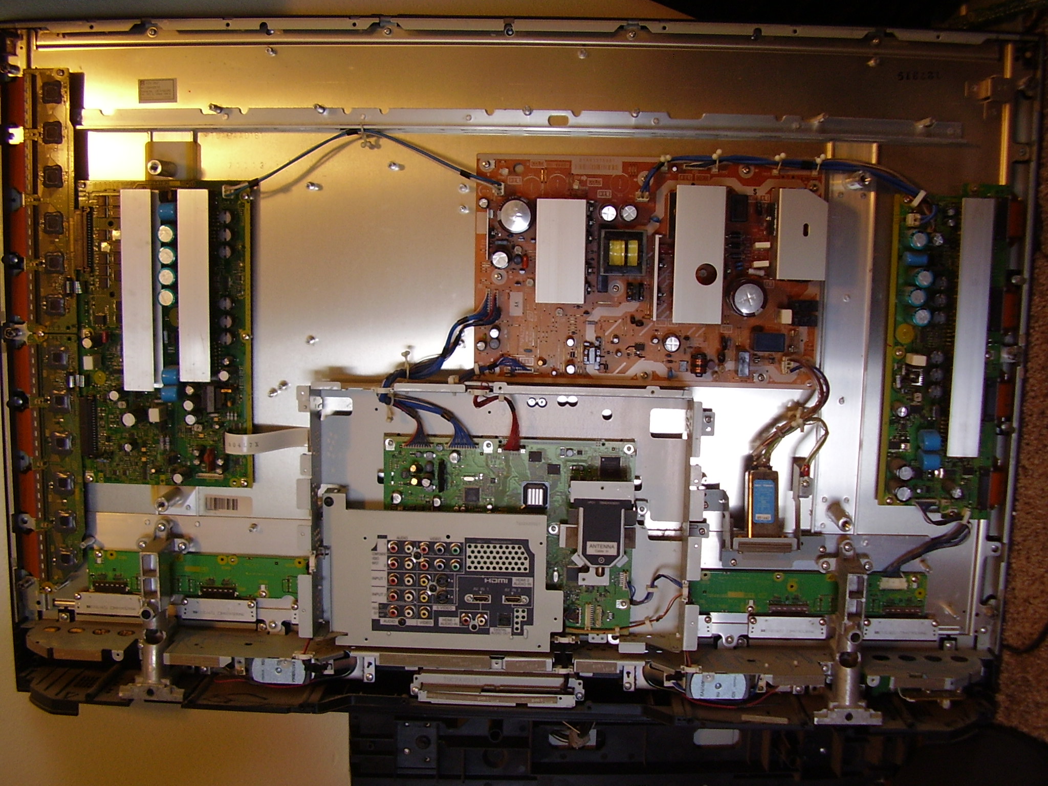

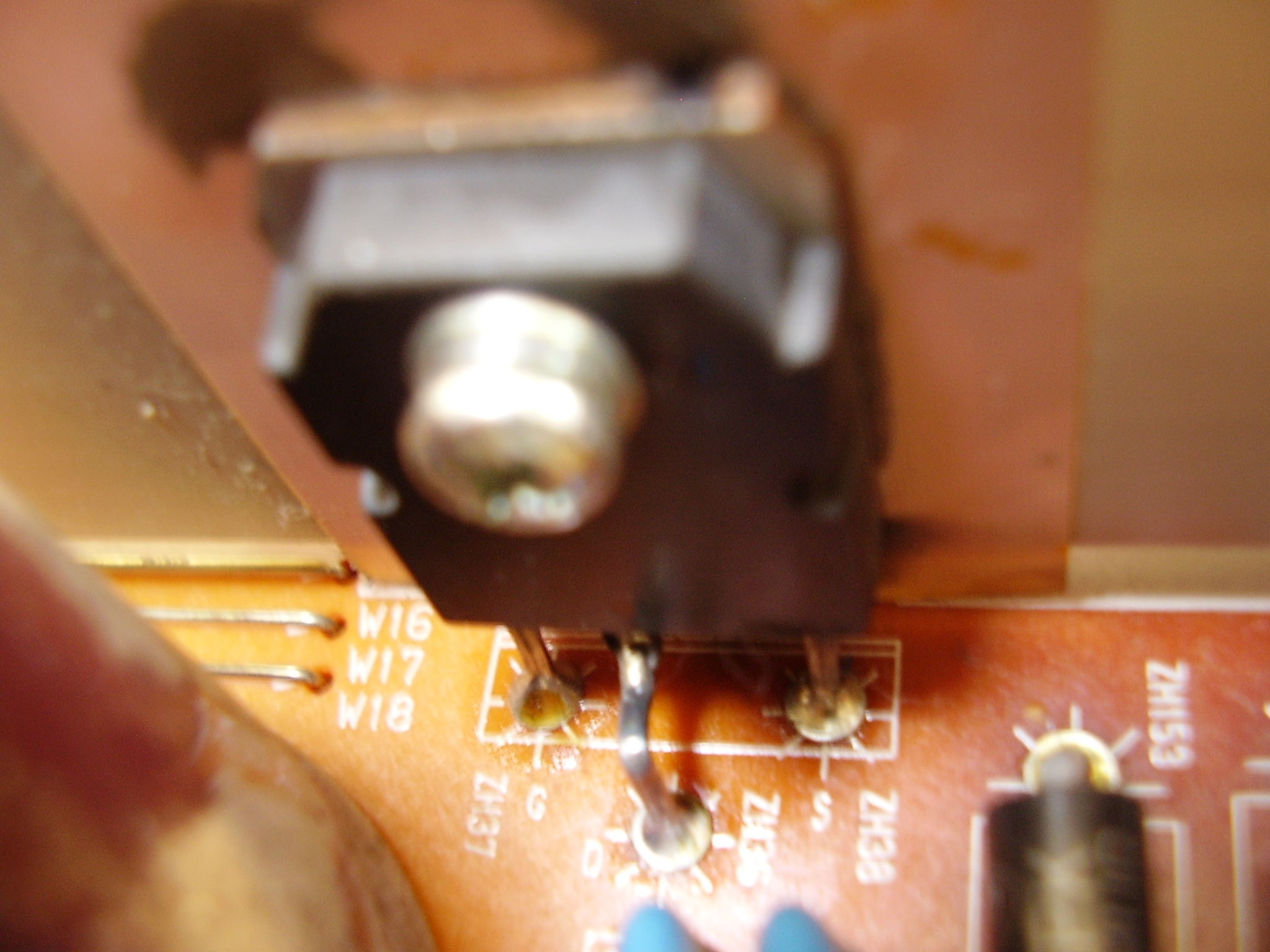

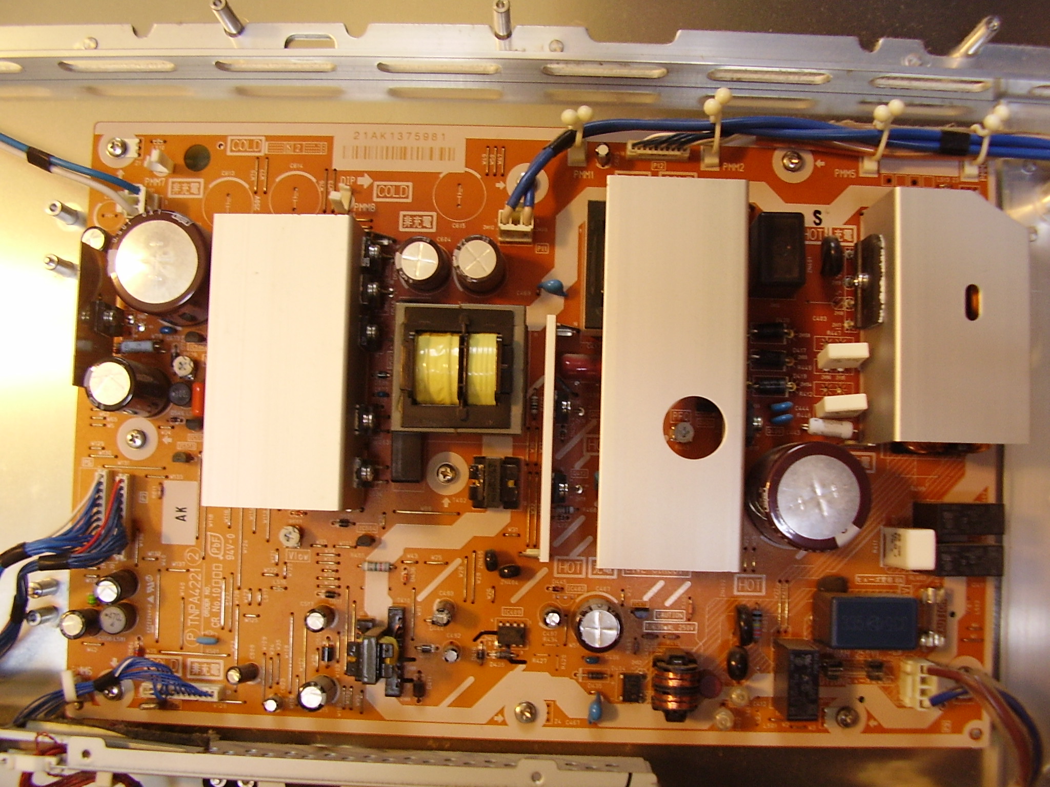

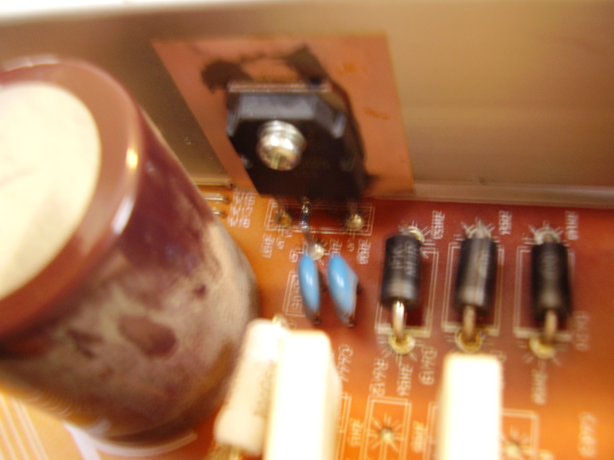

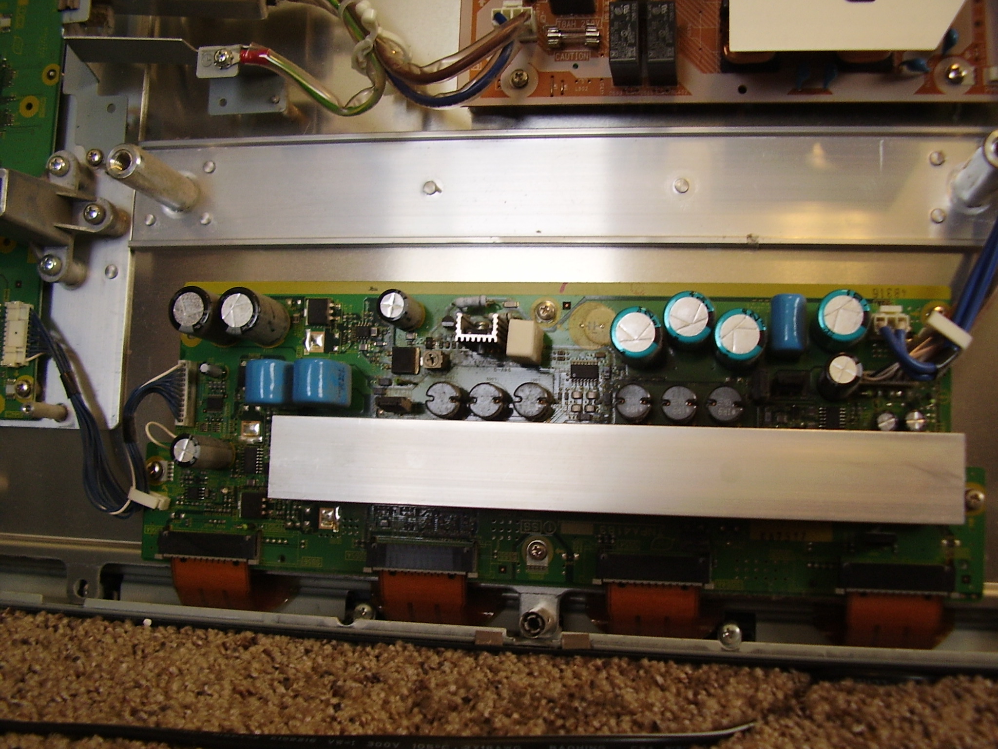

      Here are some pics of the boards and a close up of the mosfet that popped. I have a new mosfet but don't want to install it if it's going to do the same thing.

        I just took the mosfet that popped out of circuit and compared it to the new mosfet I just got and they read the same. So not sure why it popped, soldered leg couldn't handle the power??
          Re: Panasonic Th-42PX75U Question
          Can someone tell me what the pink pad is called that's between the fet and the heatsink? maybe isolation pad? There is a small hole in it and I believe the metal back of the fet is shorting out on the heatsink causing the pop. I thought the metal backing on the fet was ground but apparently not?
            "SIL" pad, it's thermally conductive but electrically isolating. It MUST be installed. The metal back of the FET is almost always the drain, which is typically the most positive voltage for an N-channel FET.
              Thanks for the reply Tom66, So if its using the pad is thermal compound needed or maybe just an adhesive? If I fold the top over just enough to cover the hole it should be fine?
                Update: Found a "SIL" pad on another bad board I had laying around for parts. Swapped the pads and put in two 6.3amp fuses I had laying around in place of the 8amp fuses and plugged it in and it now works perfectly. Thanks for the input guys, your help is indeed priceless.
