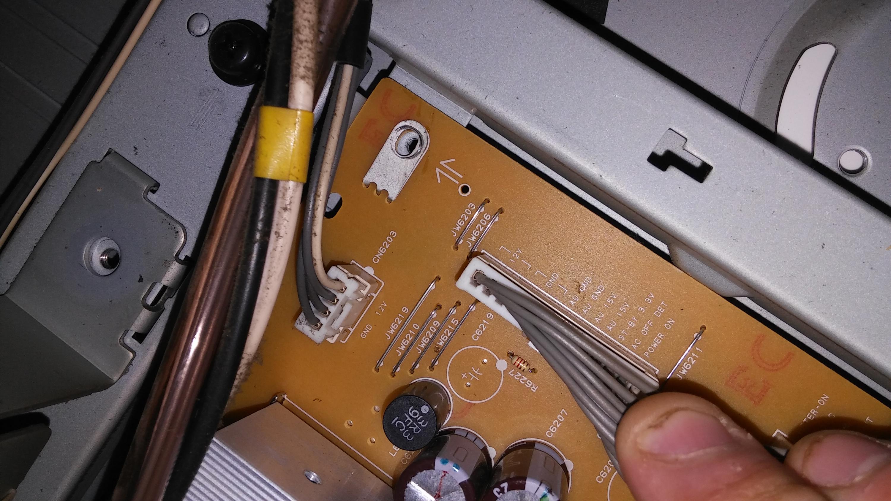

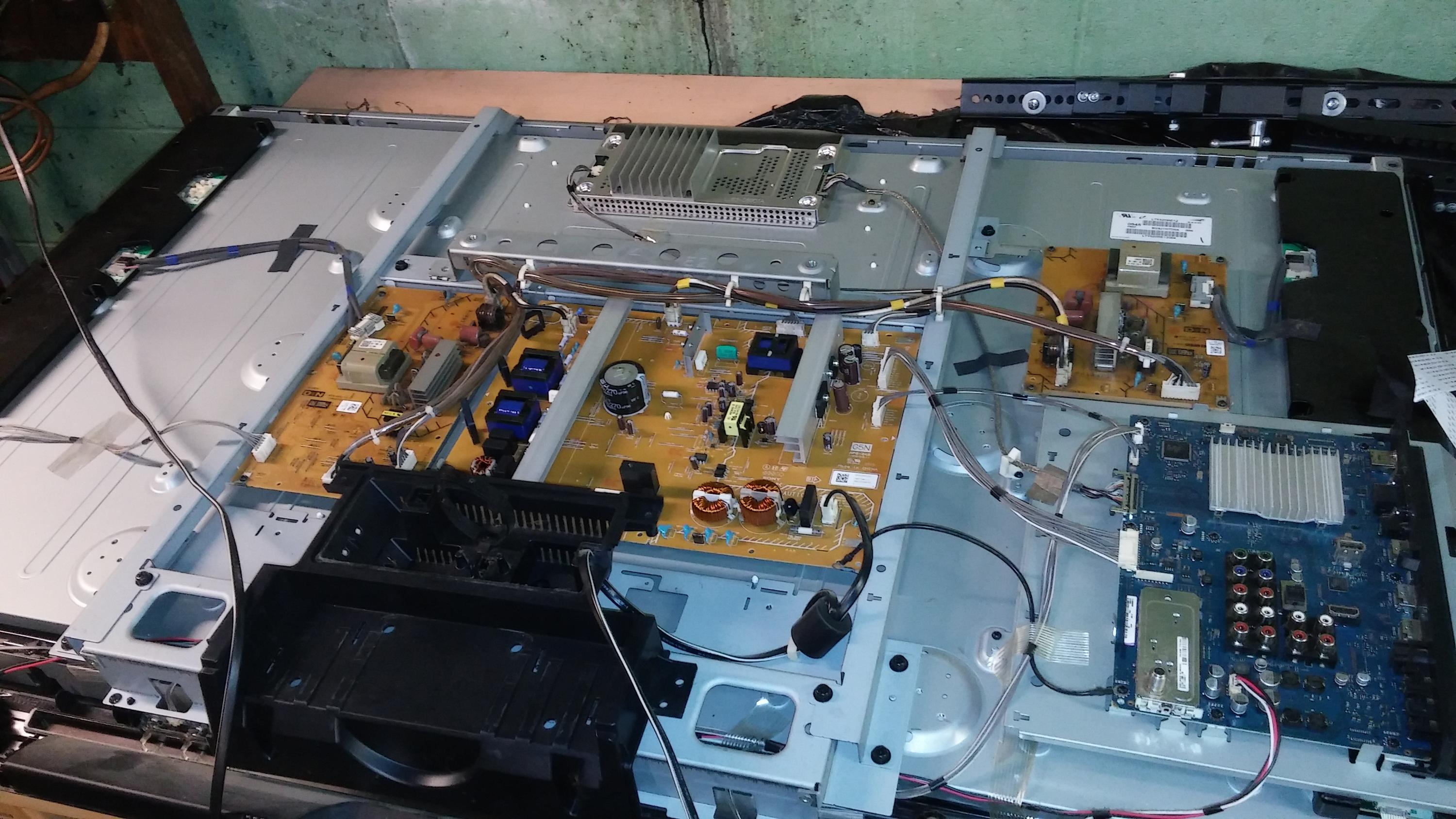

    so I got this set its dead guy said when we had storm it went out. it has no lit led outside for power or no blink code so 1st think I did was check stand by voltage its suppose to have 3.3v well its less then 1v so I get new power supply and same thing? im not to good with these sonys but still no standby it should be bad power supply right? is it possible the power supply I received was bad? just don't make sense that they both have under 1v, so im thinking its something else?

    Unplug the main board from the supply then check what your standby voltage is.

      I think the main board is dragging the PSU down.

          i have unplugged the main and same thing

            unlplug everything from the PSU and just plug into the outlet. See what happens.

              Samething

                actually no voltage. im not familar with working on these sonys but no voltage is present when everything unplugged, then when i plug main it goes to about half a volt

                    I guess we need hi res pictures from the PSU and the connector area so we can see the pinout.

                      i dont know what the opto is can you please send me better detail thanks. I even changed power supply from a used one and same thing...
