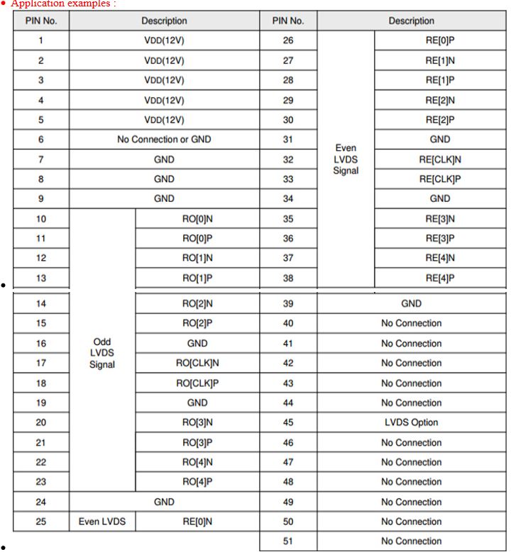

    Video is still upside down. Got the pinout for LCD connector from main board to LCD panel but have no idea how to rewire for correct video. Can someone point me in the right direction.
    Here's the diagram.

            the easiest way to resolve is to get into service menu mode of tv, not the normal user menu. in service menu it shd have an option "mirror". change it to flip it. or next u can do is the hardware. check out the brand of the panel, and google the pinout (your pinout above is connector side), i believe pin6 is used to flip the image. yours is 51pin standard lvds signals hopefully. all else failed, u can simply flip the whole tv around and wall mount it.
              I was in the service menu, no mirror option in there. Not familiar with LVDS signal. I'll check pin 6 to see if it is ground or NC and do the reverse. Pin 45 is LVDS option, not sure what the option is !!!. Google wasn't any help in finding a way to reverse the video, only found the diagram that I've included in the thread. TV belongs to a friend and he was using the stand, no wall mount. I did suggested to mount it upside down, RCA logo will be reverse but it will make a great piece of conversation

                you didnt get my message.
                i was saying - check out the brand of the panel, from the panel label. and google the panel model for pinout. i would do that first before doing any soldering on the board. u could make the problem worst if pin6 has different function eg if its a power line or gnd.

                  I've googled just about everything from the TV, model #, board #, LED panel #. firmware, etc. you name it, I've googled it.
                  Did checked pin 6 of the LED panel connector, open or grounded, it doesn't change anything.
