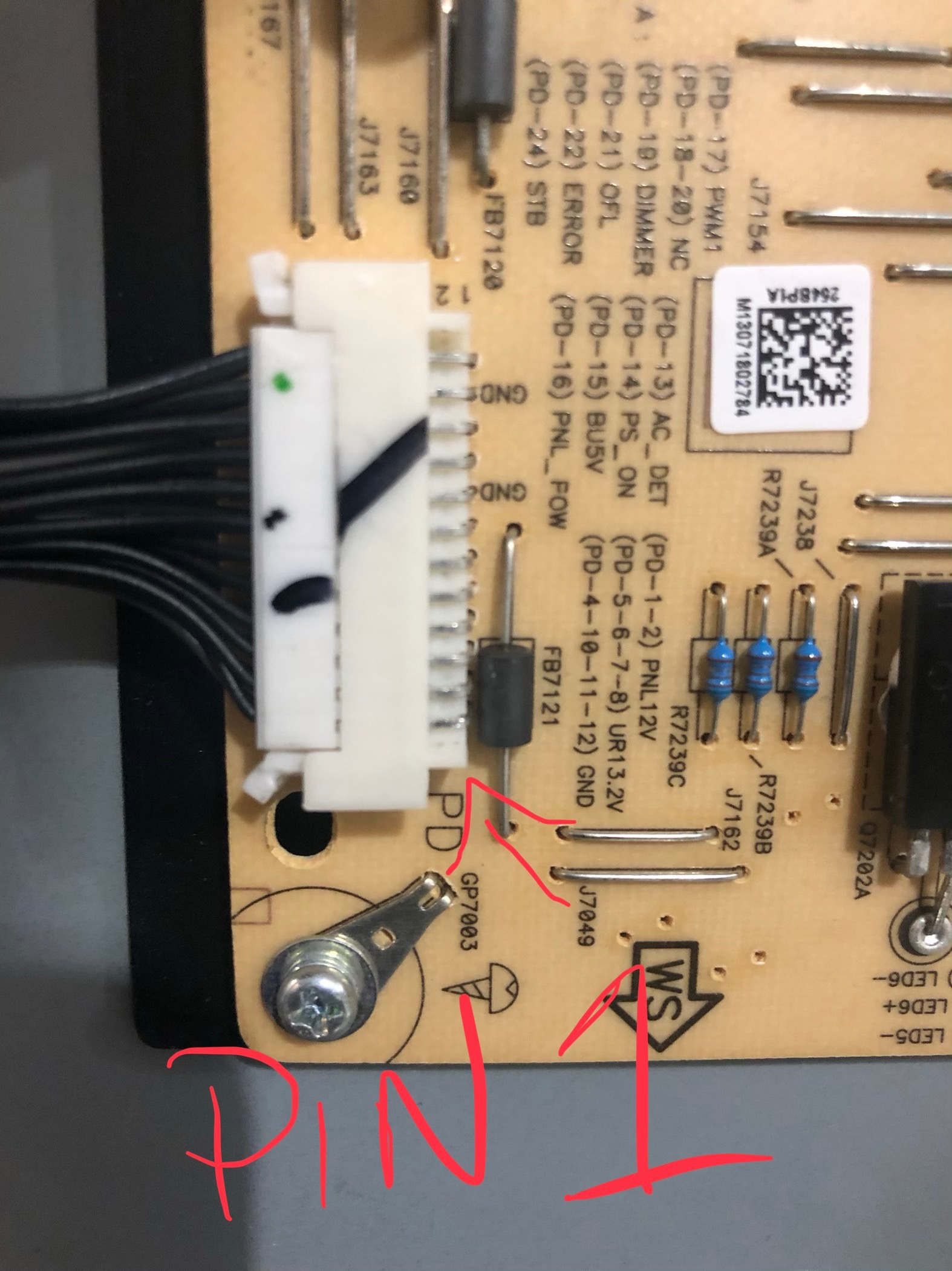

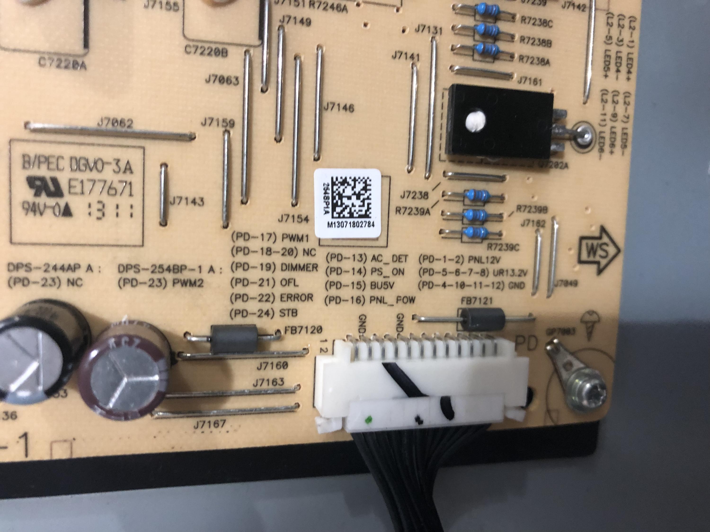

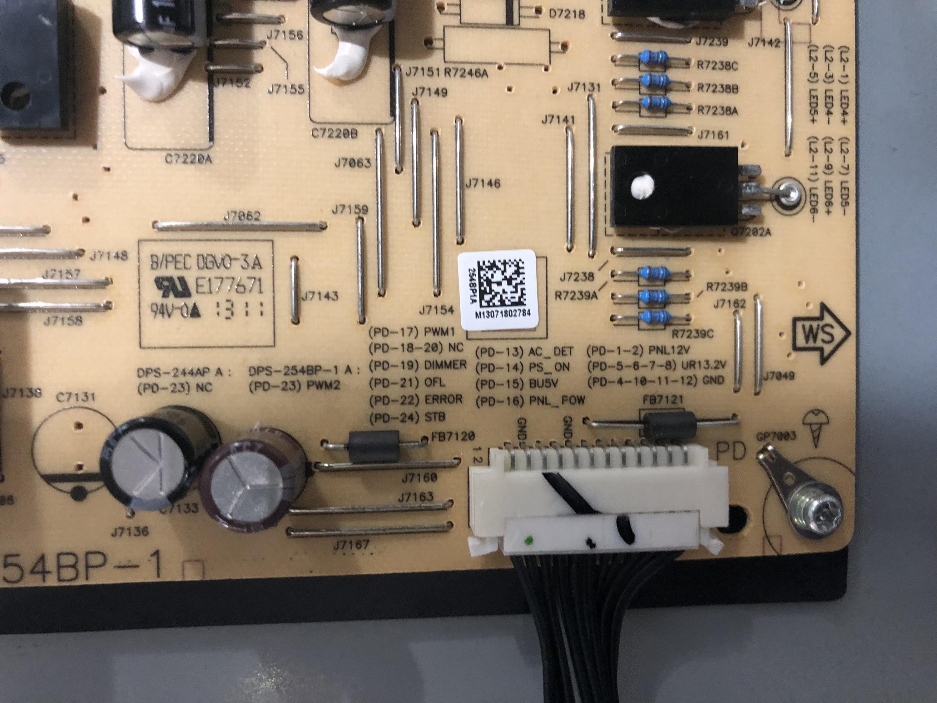

                                    Also I am getting ready to test the voltage on these pins but they are a bit confusing to me.
                                    Is this the pins I am supposed to test? How do I know which is 1 (beginning) and where it ends? Doesn't seem to be labeled.
                                      #298
                                      Re: Sharp LC-70LE757U Flashing 2-5 :-( can it be saved economically?
                                      PD connector: The exposed pins you see on the top side of the board are the ODD number pins, pin 1 is printed on the left side of the connector, pin 2 is printed right blow. The EVEN number pins you will have to use the skinny probes on the wires entrance of the connector. You can also look at the bottom side of the board, you will see pin 1 and pin 2 markings.

                                        Thank you. Right now the TV is upside down vertically leaning on something so its a bit hard but Ill be following up in a separate post with the readings I got from top to bottom. Thanks again!

                                          Ok, so with ONE side of the edge tab ribbon cable disconnected (the left side) these are the readings on got on this pin. I attached a photo since my TV is currently standing upside down I checked from bottom to top. This is my first time doing this so please forgive me. I have a "auto range" multi meter so I am not sure if it is even giving the correct readings but maybe since you guys have so much experience you can tell if i did something wrong.
                                          The TVs blue light in front was on and steady (no blinking since I did the volume+channel down reset and disconnected the cable.
                                          As I mentioned, even when I disconnect the edge board ribbon cables no luck on getting the TV on so bud suggested it could be some other problem. I also changed the P/S, Tcon and main board but still same symptoms. Im hoping to save this one from being scrapped so any and all help is appreciated!
                                          Please remember the readings are from bottom to top:
                                          8.8v
                                          .659
                                          12.7v
                                          12.5v
                                          5.04v
                                          3.32v
                                          02.2v
                                          02.3v
                                          13.36v
                                          03.6v
                                          11.92v
                                          Thanks again!
