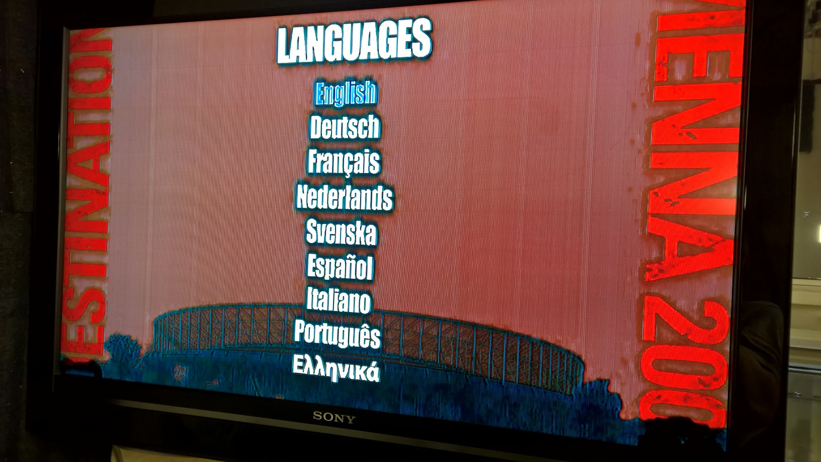

    This Sony KDL-40V3000 has a distorted picture. Looks saturated.
    Worst from coldstart, better when warm but not OK.
    Panel or T-con should be the options here?

    Don't you think this is actually related to T-con failure?
    It's possible to see the picture distortion changes as it heats up during the first 30 seconds of operation.

      I'll try a T-CON for starters.
        Re: Sony KDL-40V3000 distorted picture
        Check the GAMMA Voltages on test points on the T-CON board. Did you reseat the cables already?

          Budm, what should the gamma voltages read if OK?

            GAMMA Voltages If from ! to 14 they should increase or decrease uniformly. Do as BUDM said measure the voltages and post then we can determine a fault.

                Here's the Gamma voltages:
                VGMA1: 15,44
                VGMA2: 15,07
                VGMA3: 14,93
                VGMA4: 12,60
                VGMA5: 11,61
                VGMA6: 10,62
                VGMA7: 6,71
                VGMA8: 4,83
                VGMA9: 7,66
                VGMA10: 7,90
                VGMA11: 7,89
                VGMA12: 7,10
                VGMA13: 5,30
                VGMA14: 5,30
                VGMA15: 5,30
                VGMA16: 6,30
                VGMA17: 8,51
                VGMA18: 5,60
                VGMA19: 3,10
                VGMA20: 0,456
                VGMA21: 0,299
                VGMA22: 0,214
                VCOM: 6,68
                AVDD: 15,42
                (V)
                Does the low reading on gamma 20-22 indicate a fault?

                  A lot of those readings look bad from what i understand it should be a steady gradual voltage drop im sure someone more experienced will comfirm
                    Yes, it is bad.

                      Gradual voltage drop or increase, but only ever moving in one direction (Monotonic function)
