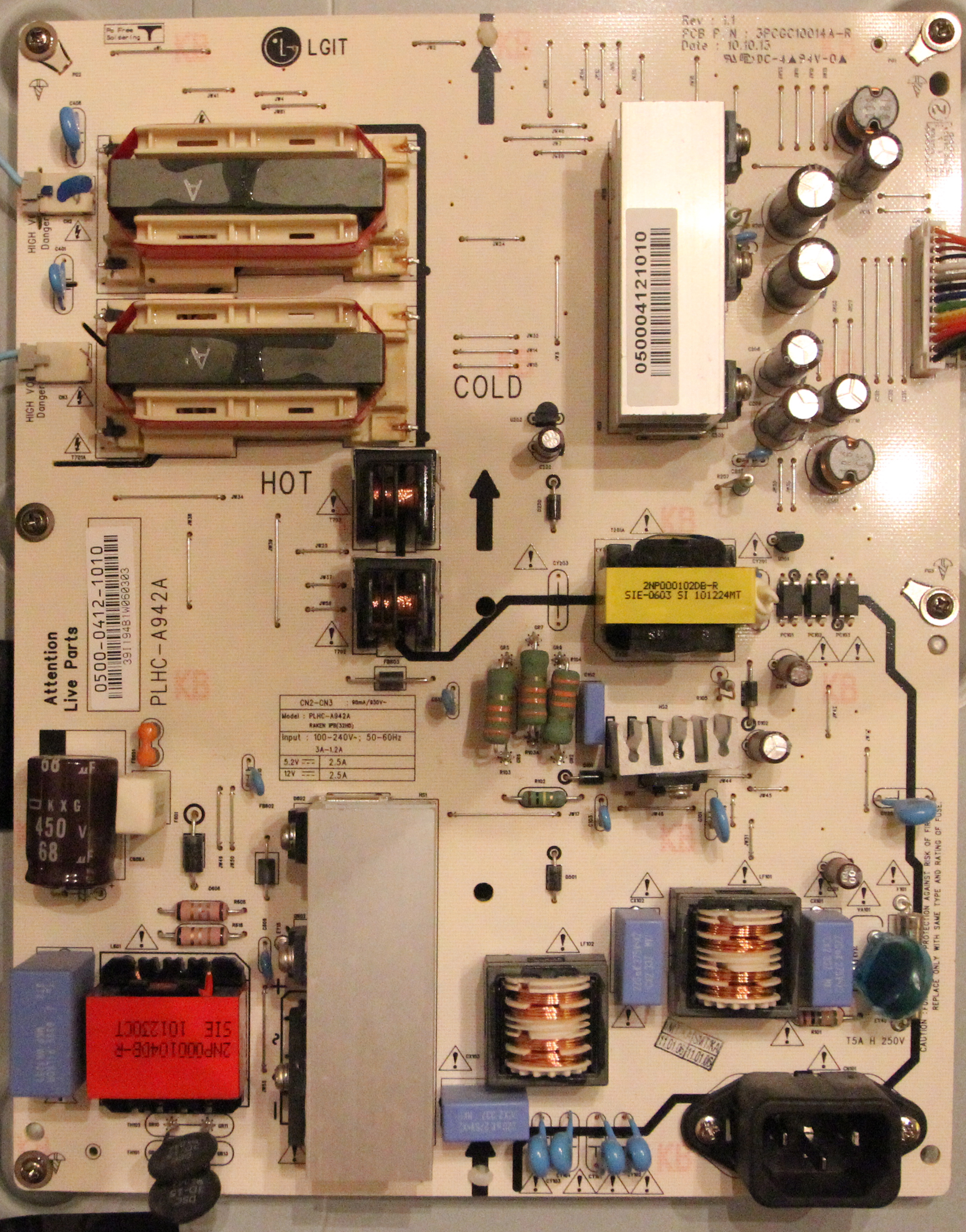

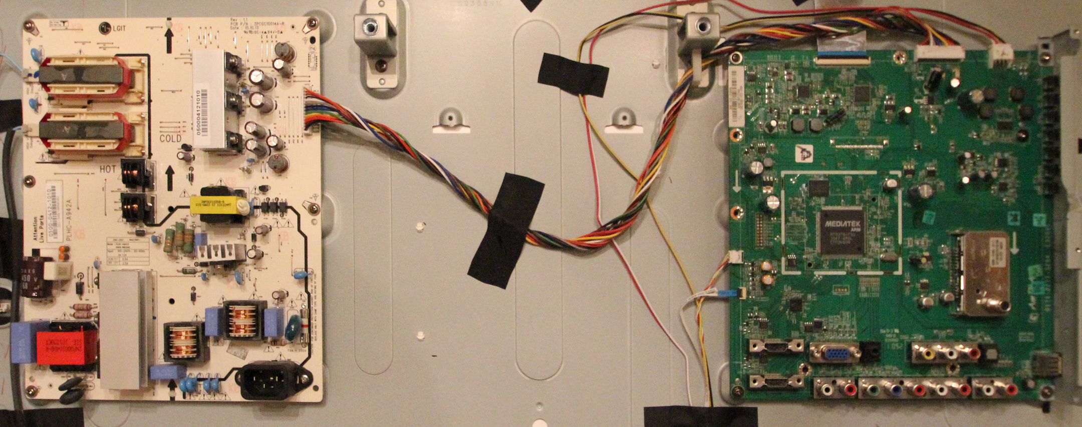

    Vizio E320VL showing no signs of life. 14 pin connector on power supply not getting a reading on the 5 volt pins. Large capacitor showing around 168 volts. Smaller caps look fine, but is it worth replacing anyway?

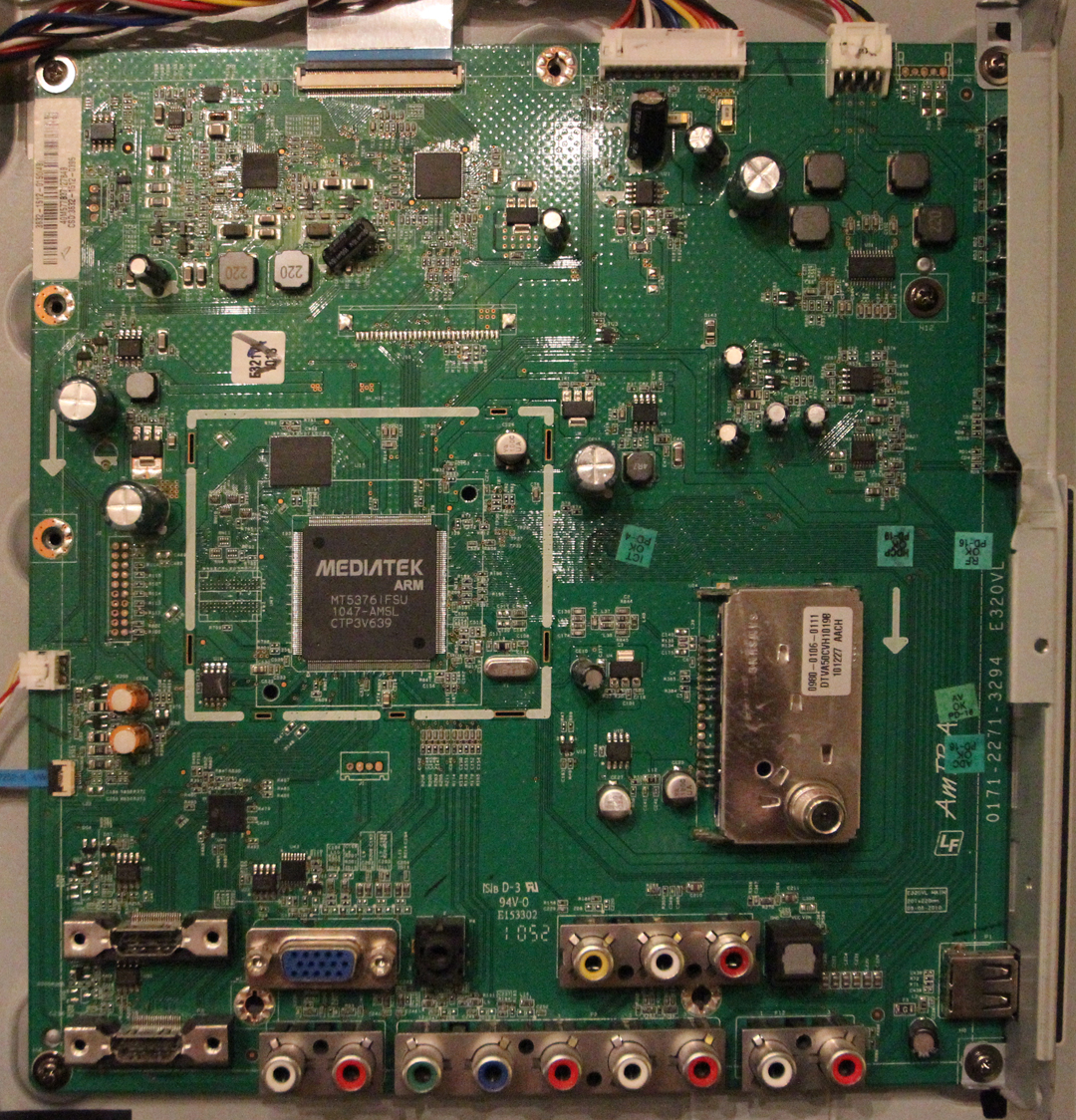

    I have a new eprom for the unit if anyone thinks that could be the culprit. Thanks for any help. Phil

    If you do not even have standby Voltage then there is not much you can do until you fix the standby power supply section first.
    Try running the power supply board by itself to see if you will get the standby Voltage.

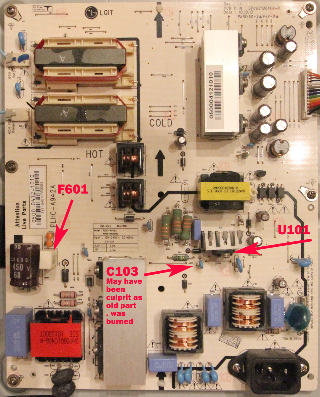

                  I took a $20 gamble on the 5V repair kit. Looks like it fixed the problem. TV working great!
                  When taking the old parts off I found one part (C103 in photo) was burned on the side. Might have been the only problem but went ahead and replace two of the three other parts (didn't replace the fuse). Thanks for all your help.

                    Re: Vizio E321VL - now power
                    Same TV same issue. C103 burnt. f601 no continuity. replaced C103 and F601 with a "NTE 5WD15". The 5WD15 i had to modify because it was axial. TV works fine now. total cost $1.50.
