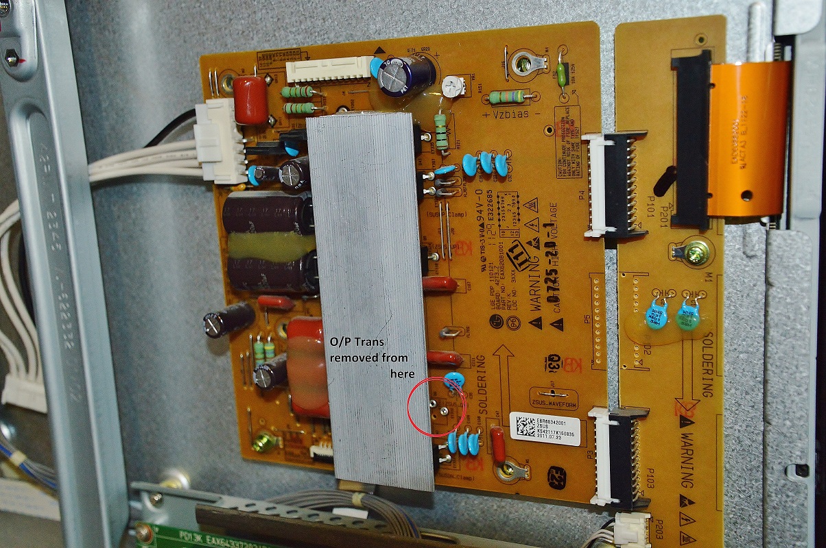

    This is a much younger set than the one in my last thread (funeral to be held later), this 42" plasma packed up almost 3 years old to the day. It belongs to a retired couple, good friends, and I rather embarrasingly recommended it at the time!
    Apparently after a couple of slow start-ups, it wouldn't come on at all. I could hear the tell-tale whines from the PSU, so I took it away for a better look.
    Soon discovered a short on the Z-sus panel (EAX620B1001), turns out to be o/p transistor Q6. It's a 30F124, one of a pair- the other measures OK passively.
    It it normal for these to fail or could we be looking at something causing it?

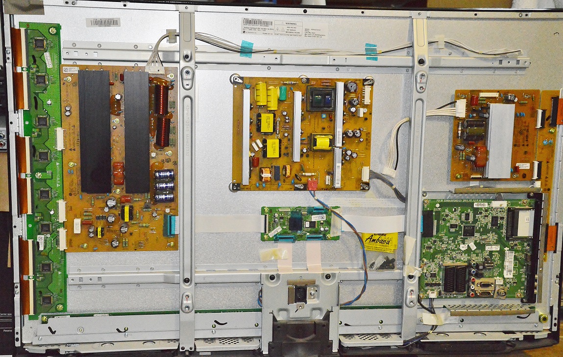

    Posting pictures of the back of your tv showing the boards with clear pictures may help you more with fixing your problem
      Re: LG 42PT353 Z-sus fault
      Tried to upload pic's earlier without success- worked first time this morning!
      And here's one of the Z-sus board, showing here the shorted IGBT was removed from.
