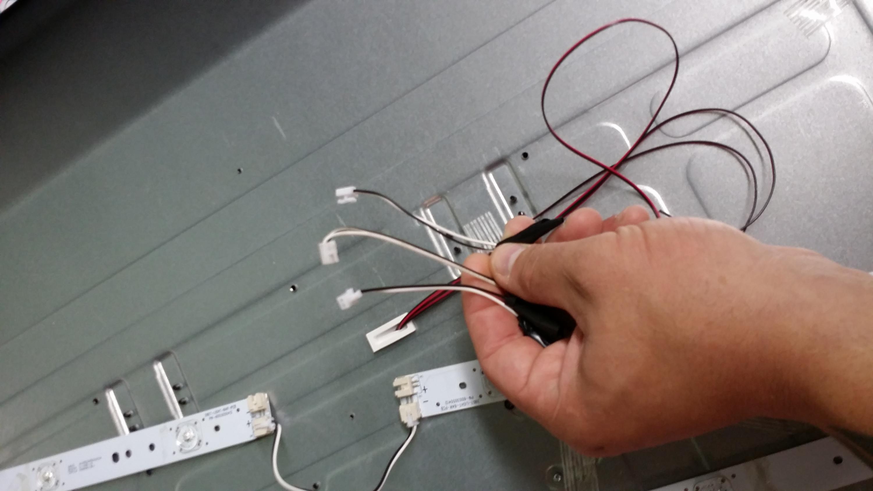

help me run these led strips please!!!
    Re: help me run these led strips please!!!
    ok here are the pictures, the one is the 3 sets of red and black that are coming out from the power supply, then as you can see the way these leds are jumped there wired differently, then here is a pic of the 3 sets of wires coming to the boards. look at the connectors how can I run these to work
      Need the pictures of the whole bottom side of the board, whole top side of the board, closed up the bottom side of the connector to be able to see the traces on that connector. It may be hard to take the pictures due to the fact that the boards are stacked on top of each other, but the setup looks familiar.

            OK, looking at the traces and the pinout of the connector, you are correct that the 3 stings (10 LEDs per string) are connected in parallel, so the total Vf is around 35~40 V range, the filter cap for the boost converter is rated at 100uF 100VDC.
            The substituted LED strip has 8 LEDs per string (4 LED string connected in series to form 1 large string of 8 LEDs).
            When one of the old string went bad (open circuit?) I would expect the other two strings to still light, but if the LED shorted out then all the LED string will be off since the VF will drop down.

              so how can I wire them to them led strips
                So on the old broken strips connected, one at a time, does it light up and stay lit? I am trying to understand what kind of protection circuit it uses since the amount of the new LEDs is not the same as the old one.
                  yes If I took the bad strip out the good one would work

                    OK, that means the bad strip is shorted and caused the Vf to drop to below the VF for the good strips to run, but I expect the bad strip will to be on but but not all the LED on that bad strip will light up.
                    It seems to me that since you can run just two strips (same Vf but total current draw) without it going into protection shutdown, it may mean detect the Vf of the string, since the old one had 10 LEDS, the new one only has 8 LEDs per string so the circuit goes into shutdown.

                      im thinking it is shutting down cause im putting a red and blck intoa connector that is either marked + or - did u see how the end of the connectoprs are labeled amd set up
                          As long as the + (red) represent the Anode and the Black represent the Cathode then it should light up unless there is detection circuit that detects the total Vf of the string, if the total Vf is below then it know that there shorts on one or more of the LEDs, or wire is shorted to GND.
                          So to prove that theory you will need to use 7.5V 2~3W ZENER in series to make it think it has 10 LEDs instead of 8. the Zener will be connected in reverse polarity.

                            I'm thinking the 8 Leds are drawing more current. The the LED driver chip I had work on in the Westinghouse 26" TV. had a current sensor input in the chip and if the chip drew to much current then the circuit told the processor and the processor shut the LED driver chip down.

                                There should be a Power MOSFET that the Cathode of the LED strings will be connected to the Drain then the Source pin will be connected to the current sensing resistor, this junction point is then connected to the Feedback pin of the LED Driver IC to maintain the constant current through the LED string by PWM the Gate, so with less LED the circuit may not have enough range to turn on the MOSFET less to too much Voltage is developed on the sensing resistor which then activate the protection circuit.

                                  The Zener will be connected in series with the LED string, the + from the board will be connected to the Cathode of the Zener, then the Anode of the Zener will be connected to the + of the LED string which is the RED wire.
