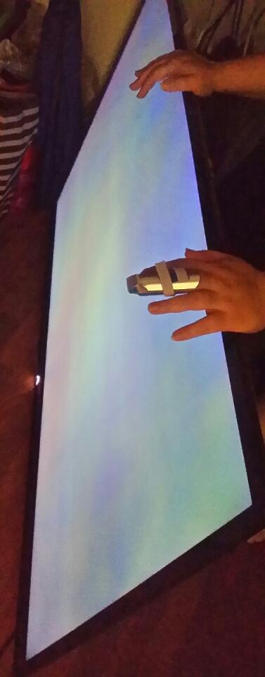

                            Is there some other way to force this set on? Since the Softkeys will not work

                              I actually decided to solder wires onto the tabs as a test and it actually worked since I tried several times holding fingers on the softkeys and, got the light to stay solid
                              Just thought I would add this in the event someone else runs into the same problem
                              But, still no backlight nor video at all

                                Hello Sharp TV experts
                                Our Sharp LC-80LE642U displays one short one long flash error code which is a backlight error. I went into service mode and there were 8 lamp error counts recorded. I reset the count to 0 and did a reset. The last monitor error cause was 16 B00014639:12. 16 is the code for backlight error. I tried to power the tv up but went back into error mode.
