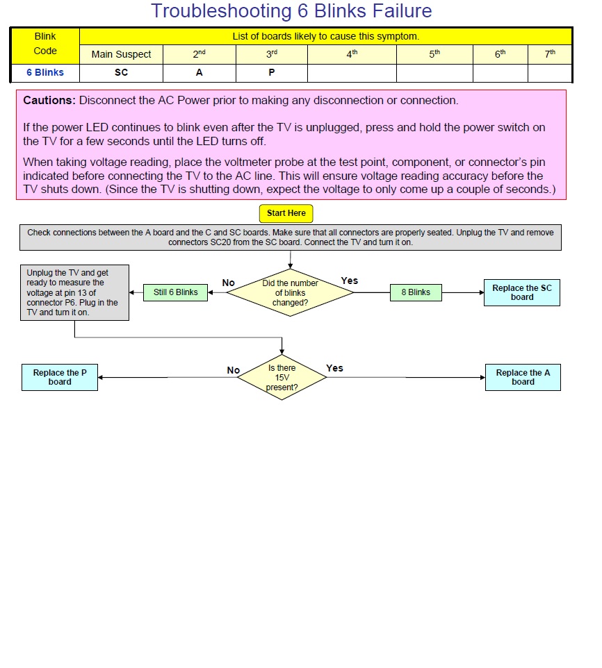

    I just joined the forum to get help on this issue. My Panasonic TC-P55GT30 was on and working perfectly a little over a week ago. When I went into the other room and came back, it was shut off. When I unplugged it and plugged it back in, I got the seven blinks from the LED. I unplugged it for 24 hours, plugged it back in and got the seven blinks again. I chatted with a Panasonic rep online, who told me to hold down the power button while plugging it in. This also did not work.
    I ordered the SC card repair kit from ShopJimmy and my father in law is currently looking at the card. I wasn't sure about the different tests but he's going to see if there are any shorts in the resistors etc.
    Thanks in advance for any advice you can give.

    Re: Panasonic TC-P55GT30 will not turn on, seven blinks from LED
    Its definitely a SC issue, I own this same model. Repaired the SC my self as well.
    Also be sure to test the Buffer boards in case they popped with the SC.
    There is a thread with hundreds of posts in regards to this issue on similar and same model.
                      Power cord wont die. According to the service manual :
                      The energy recovery circuit and Vscan are monitored in the SC board. Failure of any
                      these 2 circuits triggers the SOS6 line causing the unit toshut down and the power LED
                      to blink 6 times.
                      Under normal operation, the output voltage (MID) of the “Energy Recovery” circuit ranges
                      between 68V and 138V. If the voltage drops below 67V or increases above 139V, the
                      error detect circuit (IC16581) is triggered. This causes a high to be output to pin 15 of
                      connector SC20.
                      Pin 15 of SC20 (SOS6-SC1) also goes high,if the Vscan generating circuit fails.
                      The voltage from SC20 is connected to the Peaks – LDA3 (IC8000) on the A board via
                      the DC level shifter section of the ASIC (Application Specific) IC (IC5000)
                      If this voltage goes high, the TV shuts down and the power LED blinks 6 times.
                      This condition is normally caused by a defective SC, A, or P board. (SC>A>P).
                      6 blinks can also be caused by open connection between the C boards and open
                      connection between any of the C boardand the A board.
                      Did you order the right repair kit? You need the repair kit with most parts as its not only the fets that get shorted.
                          did you repair it or someone else? I'd be inclined to think SC with 6 blinks

                                  TV is getting 6 blink error code after replacing SC instead of 7. I replaced the power board and sub power board with no difference. I will be sending those back to that seller. Could 6 blinks still mean SU or SD? Or is it the A board?
                                  According to the service guide, it says it's either the SC board or A-SC FPC whatever that means. I couldn't find anything on Google about thst.
                                    Your confused, so am I . When i said I'd go down the path of SC fault that's what i hoped you'd do and not waste time and money elsewhere.
                                    6 blinks is one of those one that for me spell SC where 7 could be Sc or sd/su.
                                    To help you understand A-SC FPC that is the flat pack cable A-SC, AKA SC20
                                    I would contact the provider of the SC board and inform them you suspect the SC is faulty and giving 6 blink code.
                                    There's probably a way to isolate enough boards to fire this up to check P and A pass but I'd be inclined to either see if another SC can be sent or if you know what you're doing probe the SC transistors and see if anything is shorted.
                                    Do you have an image of the current board for us to see. Which seller did the board?
                                      have you seen this flowchart?
                                      • Ben09
                                        • Jul 2015
                                        • 20
                                        According to the flowchart, after disconnecting SC20 it gives 8 blinks. So I will contact the seller and have them send me a different one.
