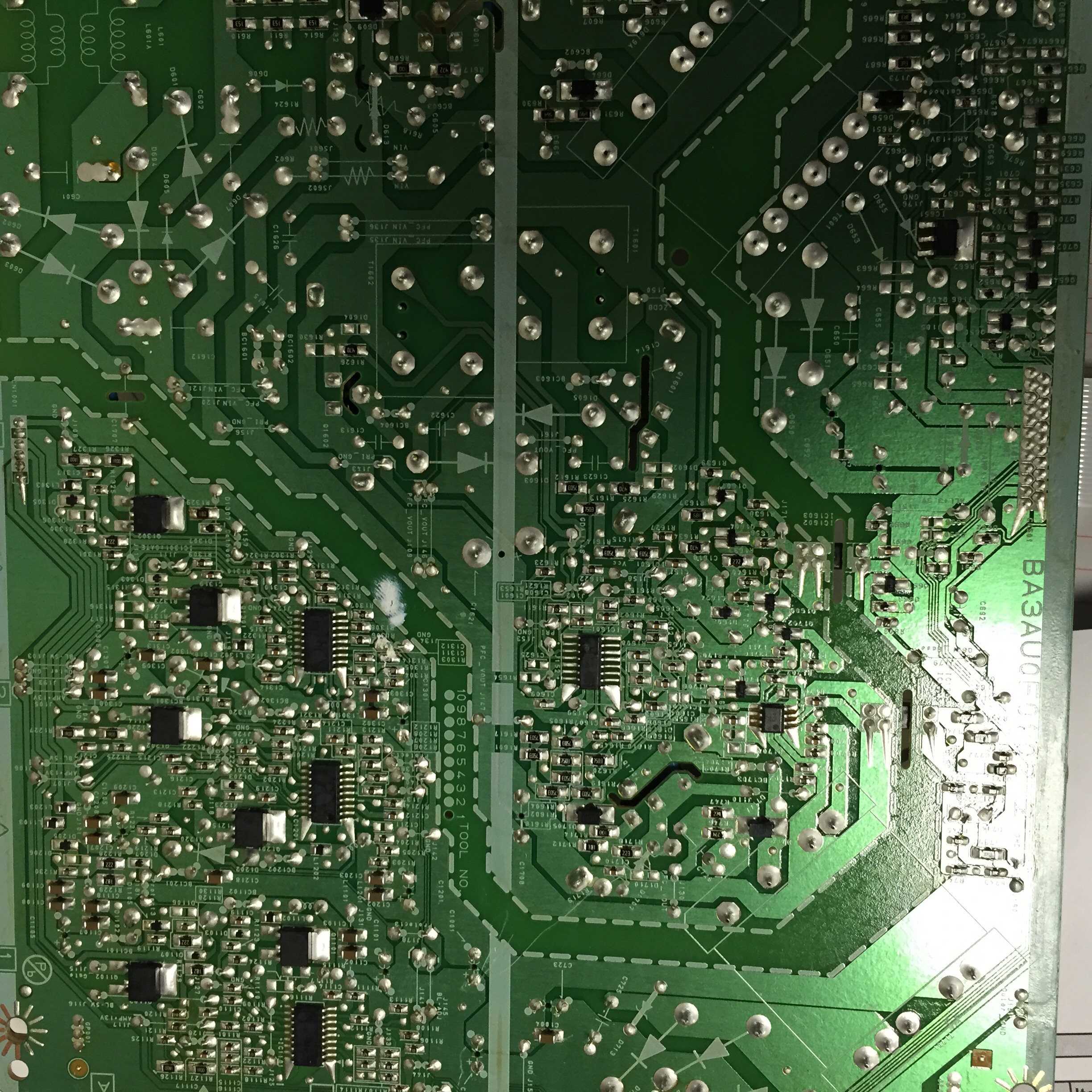

    I have a 46 magnavox tv the led will not light up.the tv will not turn at all it is dead.I am thinking it might be the power supply since the is no led light at all.here is a pic of the power supply.

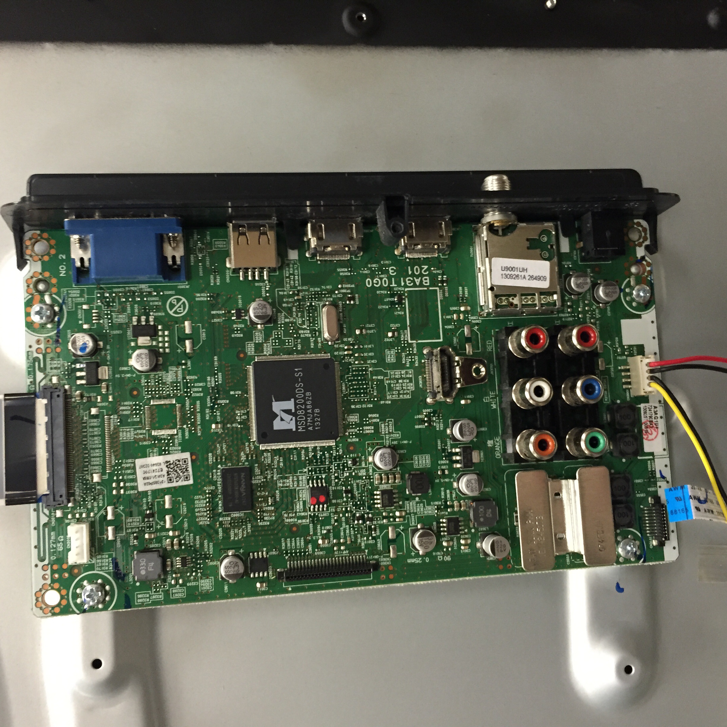

    Another pic

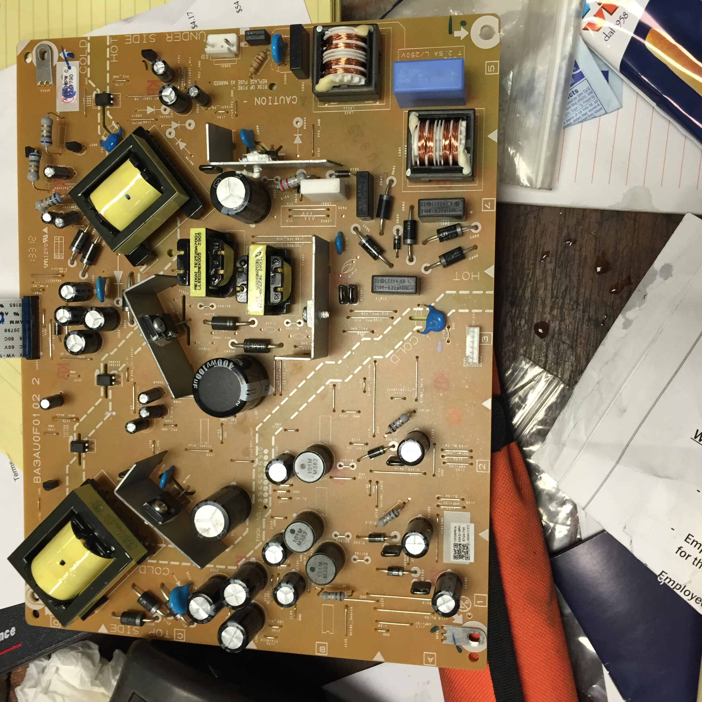

      Another pic

        After checking the power supply for voltages there were non coming out .the one i was looking for was the 3.3v it was not there and i also disconnected the cable coming from main board to the ird sensor to make sure it was not shorted.there still was no voltages since friend needed his tv decided to just replace the power supply.Instead of component troubleshooting the 3.3v line.Replacing power supply fixed the tv.hope this helps someone.
