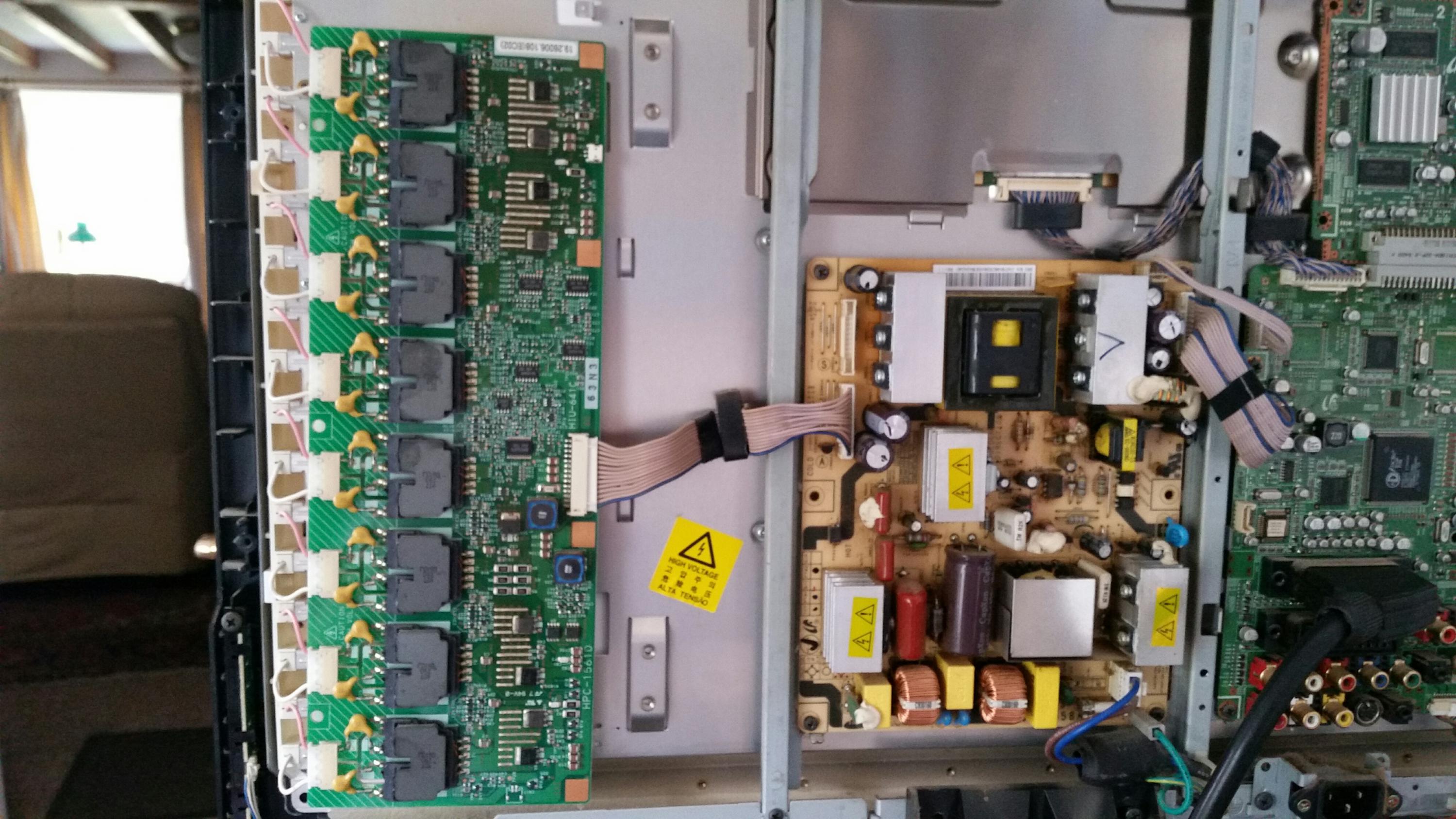

    I have a Samsung LE26R73BD LCD.
    The tv turns on and very briefly displays a picture before the backlight fails. I can still see the picture if I shine a torch through the back of the tv.
    The tv stays on and seems to operate properly, i have working sound.
    I am trying to determine whether this is a fault with the inverter or the psu.

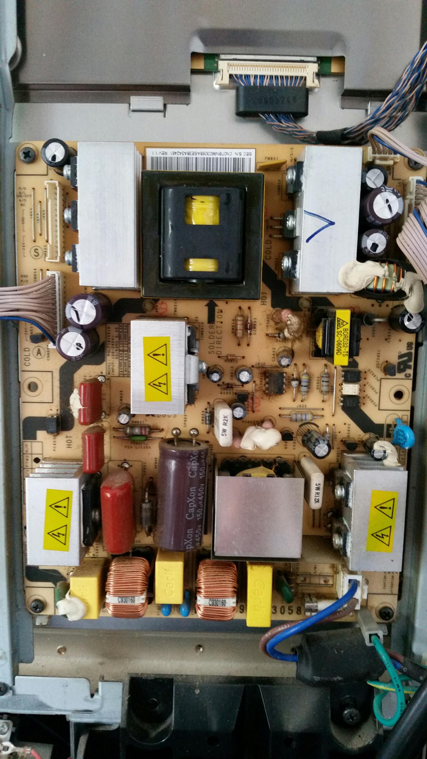

    The psu output to the inverter is marked as 24V. When tested the psu is outputting 33V at all times whether a load is present or not.
    Is the psu overloading the inverter? Or do I have a duff inverter?

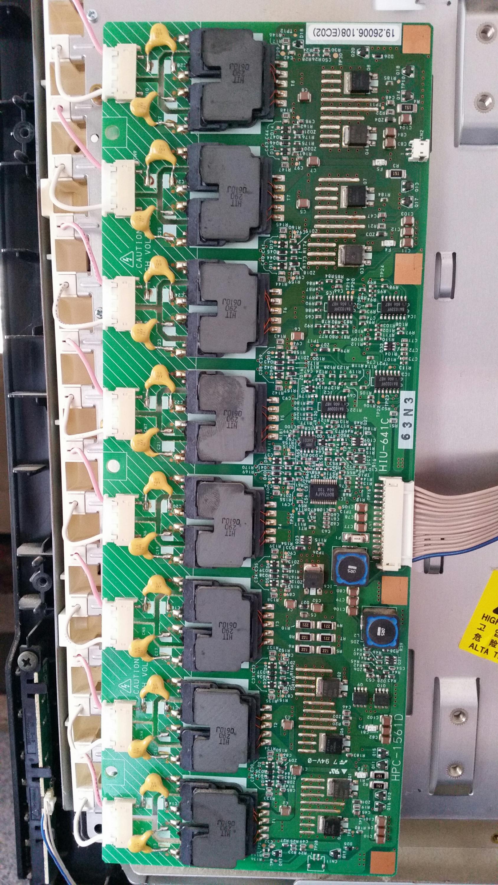

    If it is an inverter fault. Would I be able to replace it with the following:
    http://www.ebay.co.uk/itm/INVERTER-F...item3f4c9ba100
    This has a completely different part number to mine, but is from the same model of tv.
    The only inverter I can find that matches my original is £55. And I may as well throw the thing away at that price.

    Pictures Attached

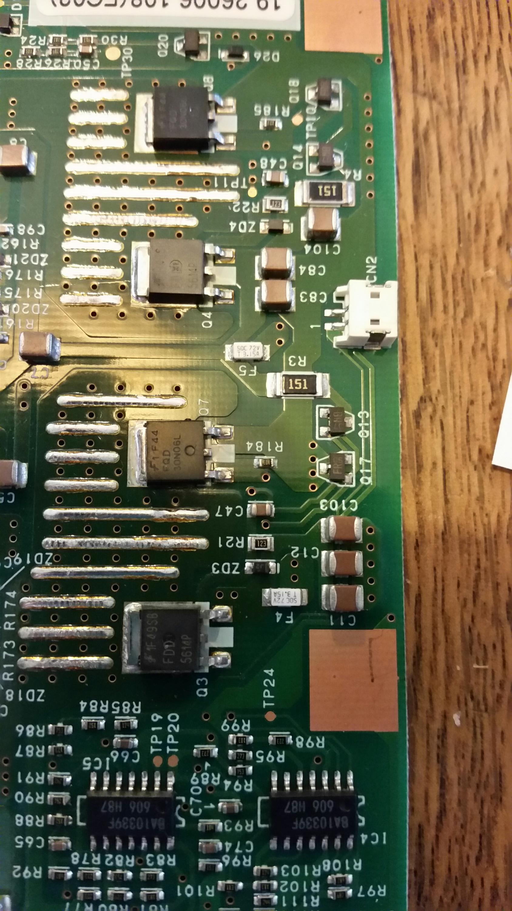

      I have tested the fuses on the inverter board.
      F5 (Pictured) Seems to have no continuity. All others seem ok.
      Could the psu outputting 33V to the inverter board have caused the inverter to fail?

        I am guessing that the psu outputting 33v is not right, can anyone help me identify the voltage regulator on the psu board? Can this be changed?

            I fixed one of these a while ago - bad transformer on the inverter (made by DARFON)
            This one looks like it uses a different inverter, but still worth checking transformers.
            Also check backlight on/off signal (marked BL ON/OFF, BLON, ON/OFF, etc.)

              Have just tried another meter and low and behold we are getting 24V from the PSU.
              One multi-meter in the bin!
              As mentioned above I found a bad fuse on the inverter board. Do you think this is likely to be the culprit? If so, I linked above to a board on ebay, any good?
              Or possibly a bad lamp?

                B/L Signal reading a constant 5.1V

                  Yes, a bad fuse could easily cause this issue.
