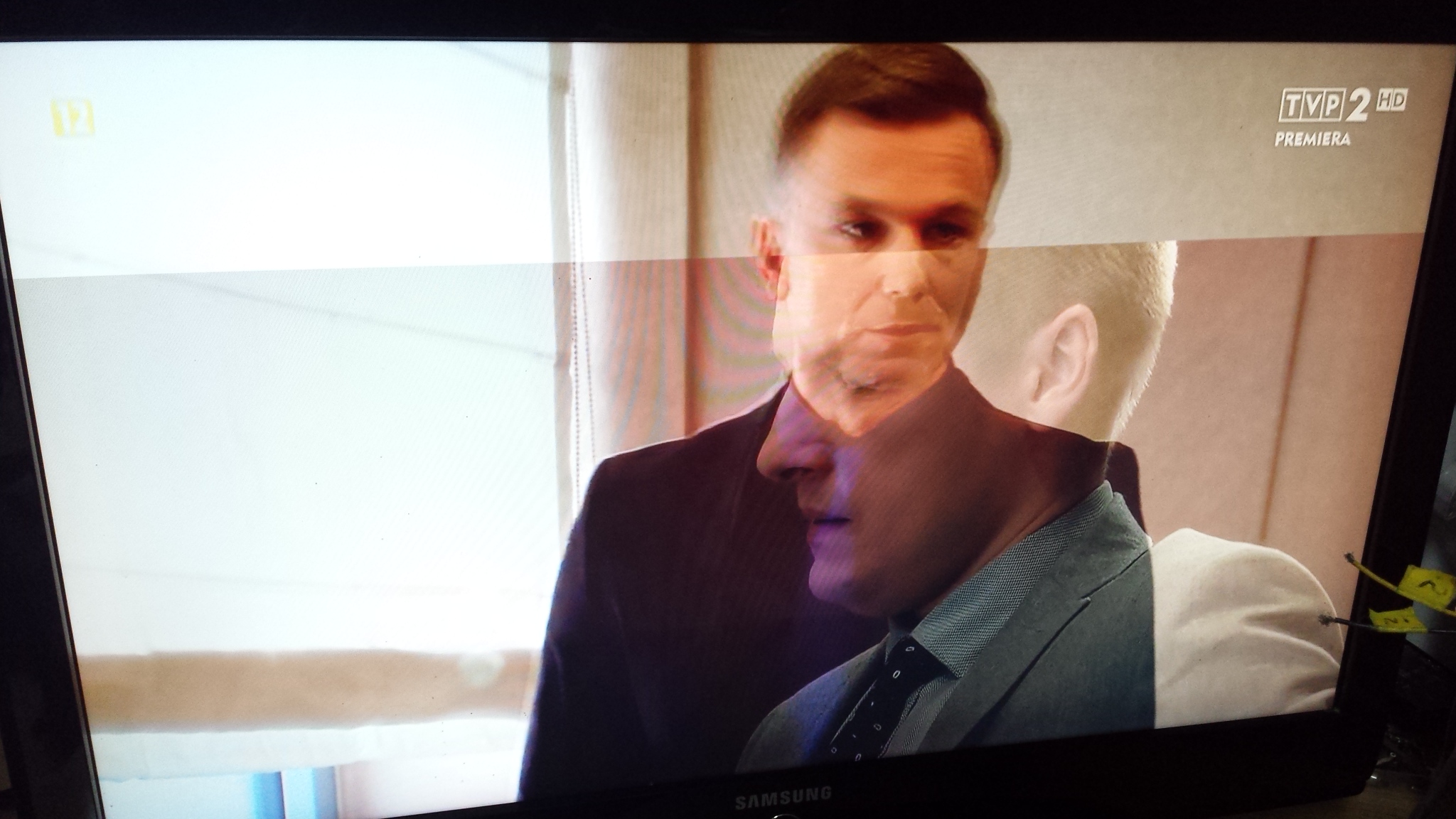

    Hi
    I have this Samsung that have an intermittent Fault it seems to get worst
    when the tv gets hot
    I managed to find a you tube video exactly with the same fault :
    https://www.youtube.com/watch?v=du7T4y0vPE0

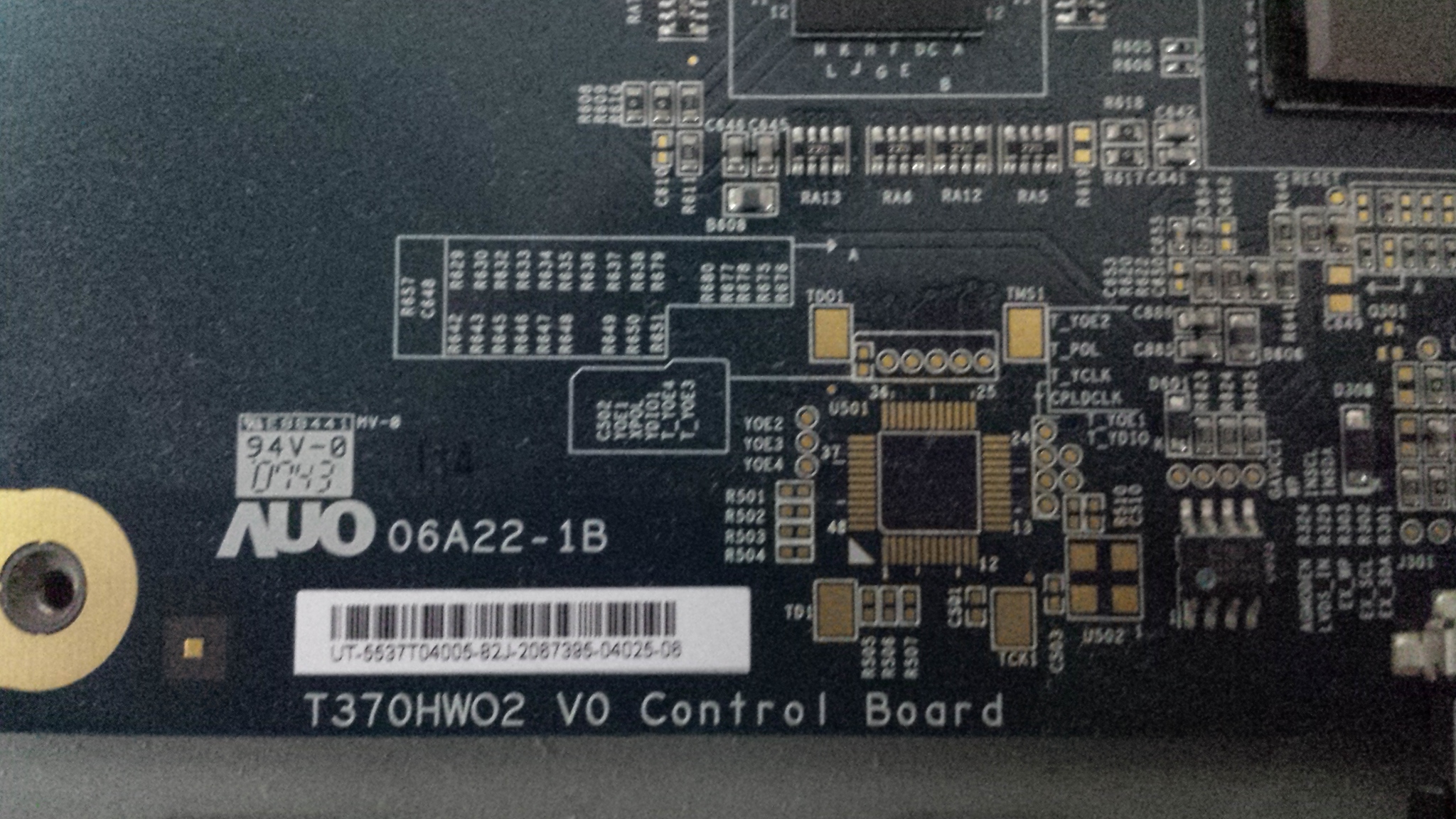

    I have replaced the T-Con Board 2 times from different suppliers with no
    success ( it could be that they are selling faulty t-cons or something don't Know )
    Has anyone got this problem before or can help a bit ?
    Thanks in advance

    Re: Samsung LE37M86BD Picture Fault
    Check or replace AS15-HF or RM5101 on this modules if they are suspicious as faulty.
      That doesn't look like a tcon fault. I'd say panel, or mainboard.
        hi
        I exclude AS15-HF T-con was replaced .
        now before i Buy the main board how can I be sure it's not the LCD Panel ?
        also might bee help full to know that when the tv is working ok you can see horizontal line
        only visible on white picture ,
          It's almost certainly the panel.
            Had the identical fault on a LG,it was the panel itself at fault.
                Hi
                Just to confirm you are right that the LCD Panel is the problem , I discoverd that by pressing the upper part of the lcd the problem disappear momentary.
                So Thanks very much .
