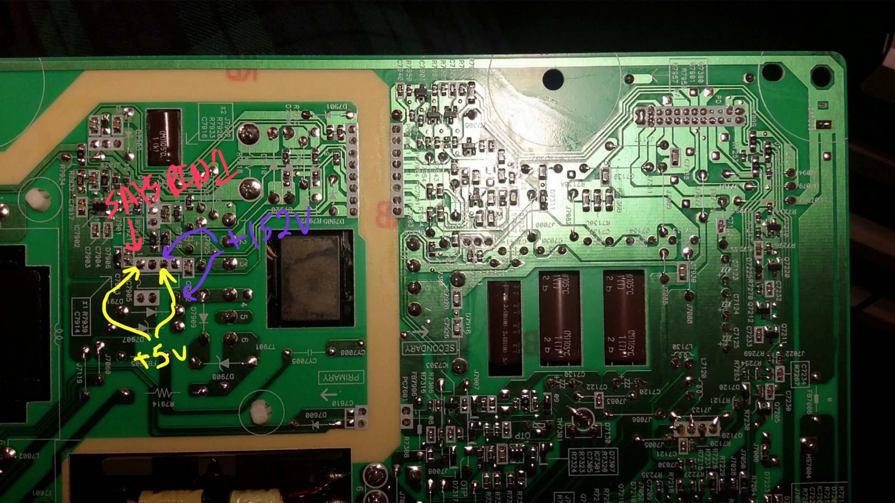

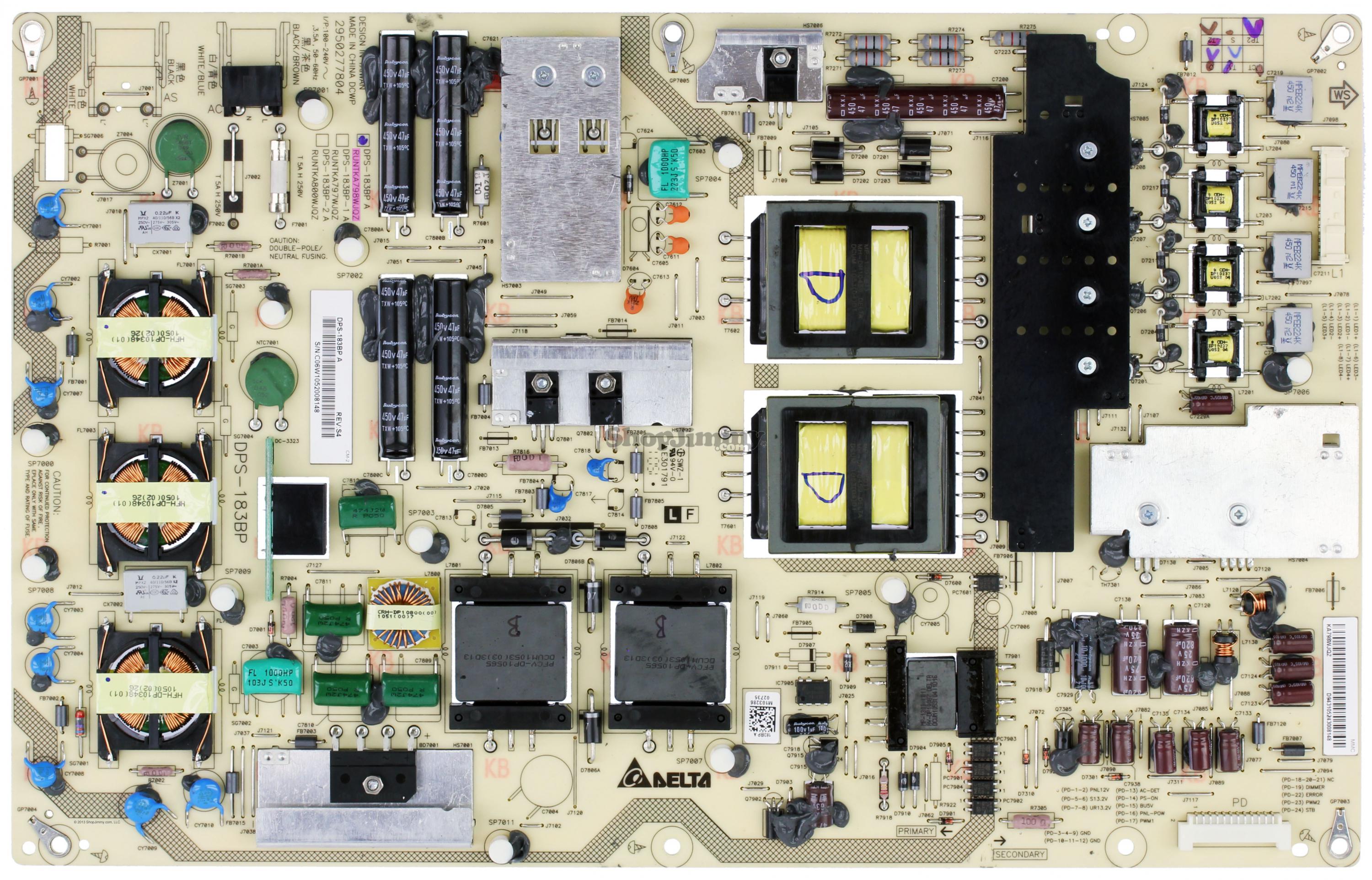

    Hello. My name is Sean and my neighbors home was recently struck by lighting. It came in via the phone line and pretty much took out everything on his LAN. The TV was connected to a u-verse box and so i suspect the lighting came in through a video connection. I have an electronics back ground so i offered to look at the unit. It is currently dead with zero signs of life. No power indicator at all. I removed the back cover and did the standard visual inspection for damage. To my surprise there appears to be not one bit of visual damage. I checked all the diodes, caps, ICs, transistors, etc visually on the power supply. I also looked over the main board too. I electronically checked some of the componets using a ohm meter. Including checking the fuse. Looking for obvious shorts on transistors, etc. I took some voltage reading on the primary side and everything appears normal all the way to the mosfets, etc however the low voltage side is completely dead. There is no 5, 12, 13.2, etc vdc at all. The unit was off when the strike hit. I suspect the strike did its damage to at least the 5vdc standby curcuit preventing any chance of the PSU from turning on.
    I downloaded the Sharp service manual but of course they omitted the PSU schematic as its made by delta. So i could use some guidence on where to look for the components that supply the 5vdc. I also have posted images of the board here. Thanks in advance for any assistance.

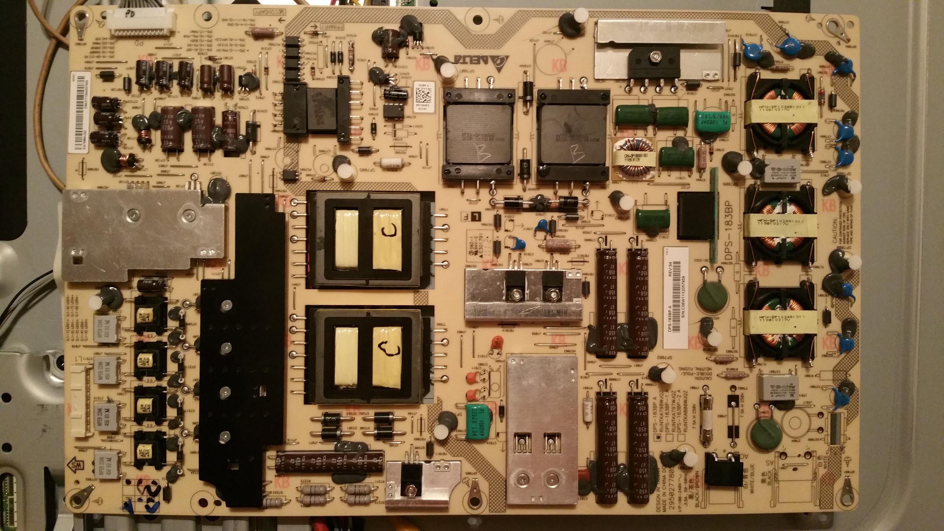

    Re: Sharp Aquos LC-60LE832U No Power or Standby Voltage
    Is it DELTA DPS-183BP-A?
    http://www.shopjimmy.com/sharp-runtk...t-inverter.htm
    So the main fuse on the power supply board is good for sure? If it is, then what DCV do you get between the two outer legs of the bridge rectifier?
    You may also have some damages on the main board too, especially the HDMI chips which more likely that the surges come through the HDMI ports.

      The power LED drive unit part number is RUNTKA798WJQZ. There is 169vdc coming out of the rectifier bridge. I agree on your comments about the main board. I thought i would try to get the powerr board operational and go from there. Thanks
        OK, so at least you are getting the 170V for running the standby power supply section, we now need to look at the standby section next.
        Details circuit tracing will be required next.

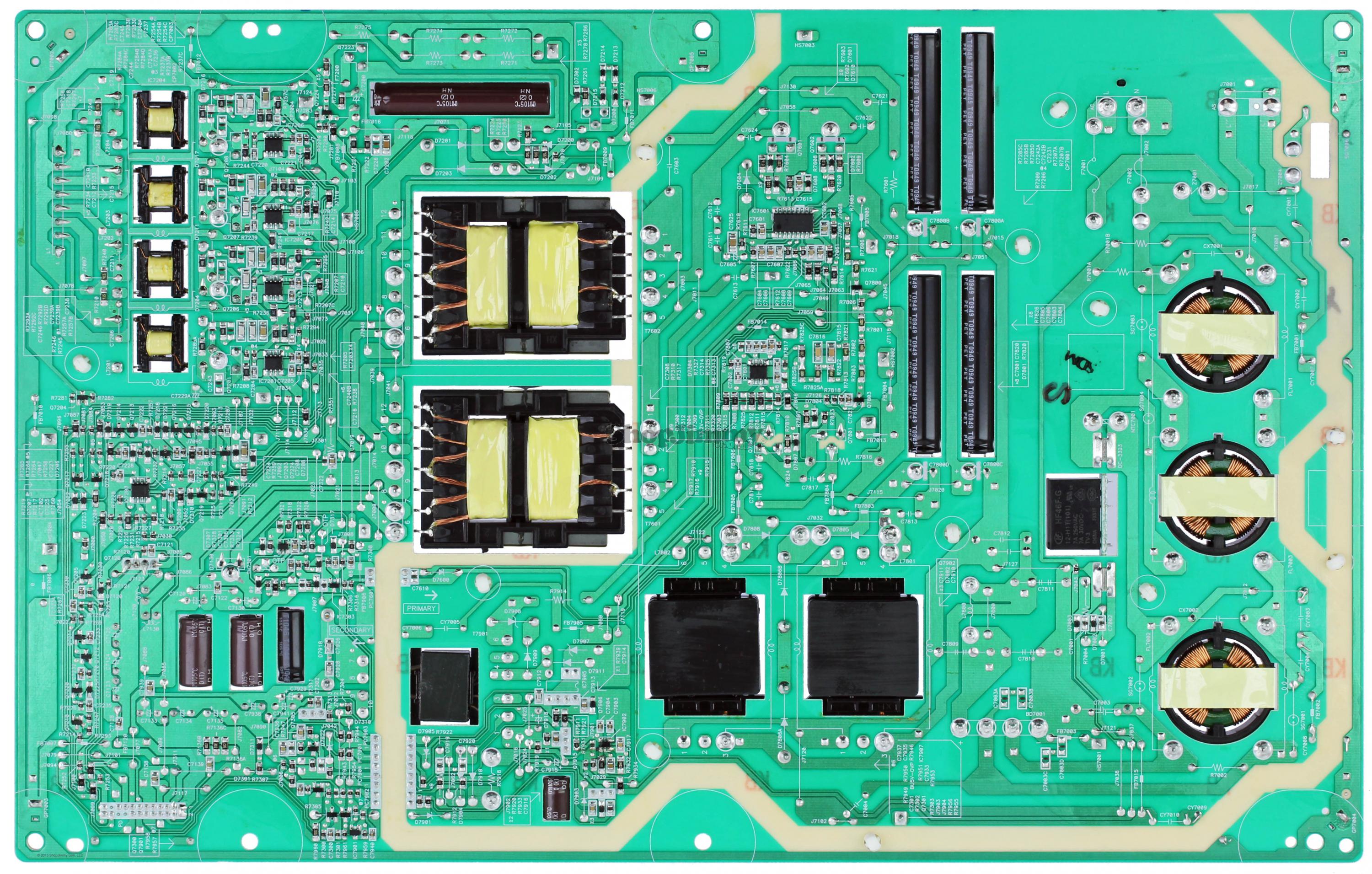

        Pictures provided by SHOPJIMMY.

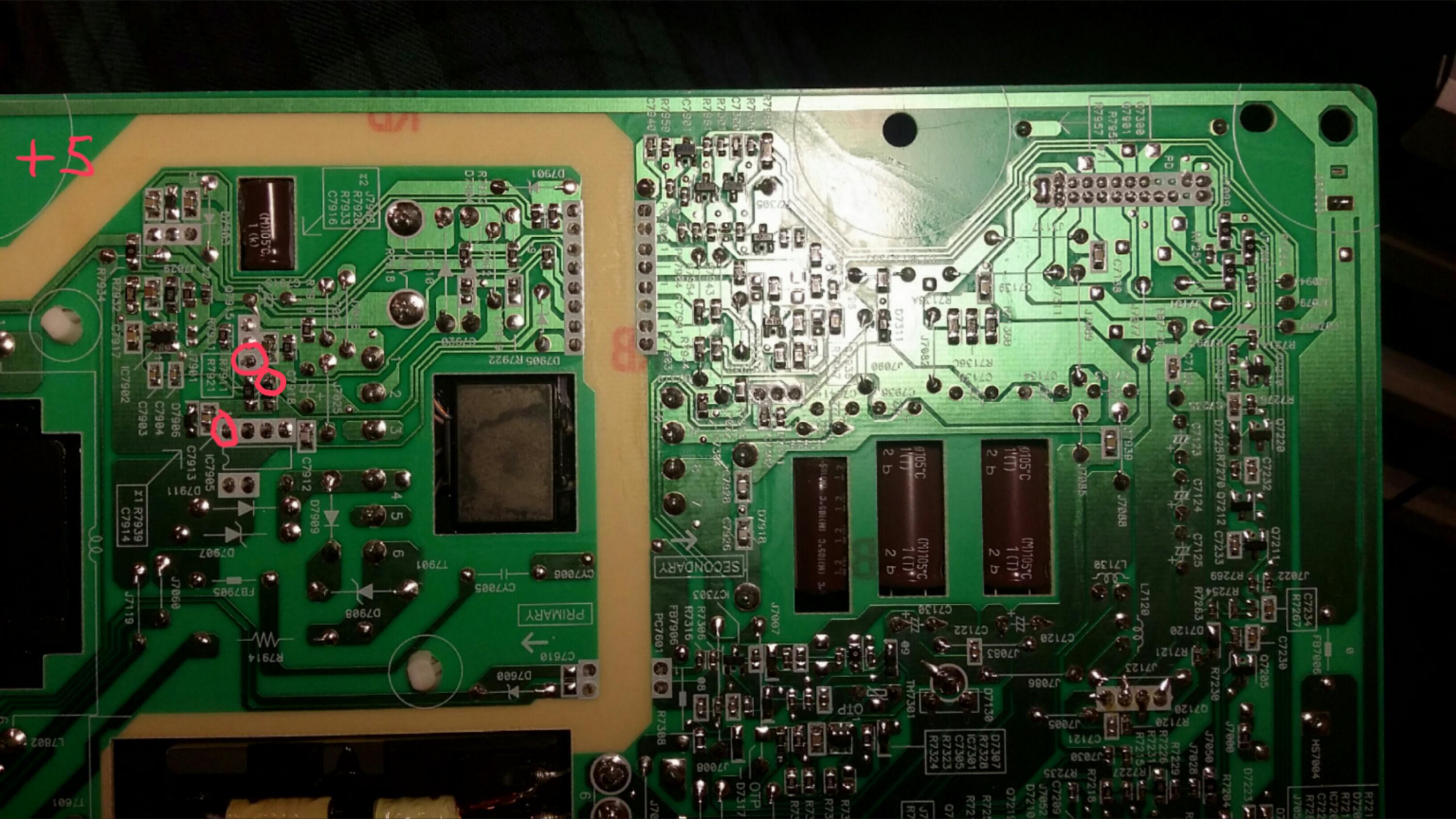

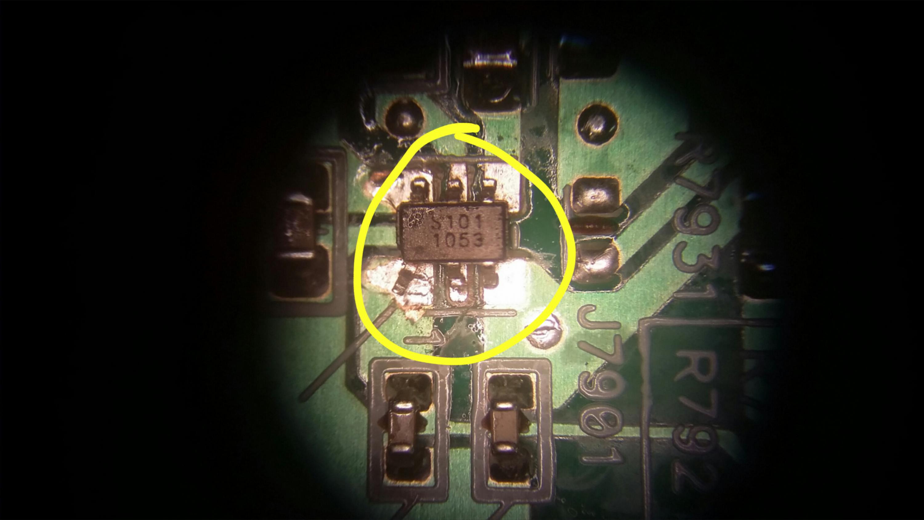

                          Looking for what might be pulling down the voltage. I traced PIN 4 of the IC7905 and found it connecting to a 6 pin part, pictured below. I did some resistance checks to ground and found it to be very low (700 ohms). When i tried to lift the pin, the part crumbed. Once the PIN was lifted, i checked the voltage across PIN 4 to Ground of the IC7905 and it now shows 1.5vdc instead of 0.28vdc.....and the resistance is now in the meg ohm range. I suspect the part below is toast but i have no clue what it is. I cant find it online. Furthermore should i assume the IC7905 is damaged too?

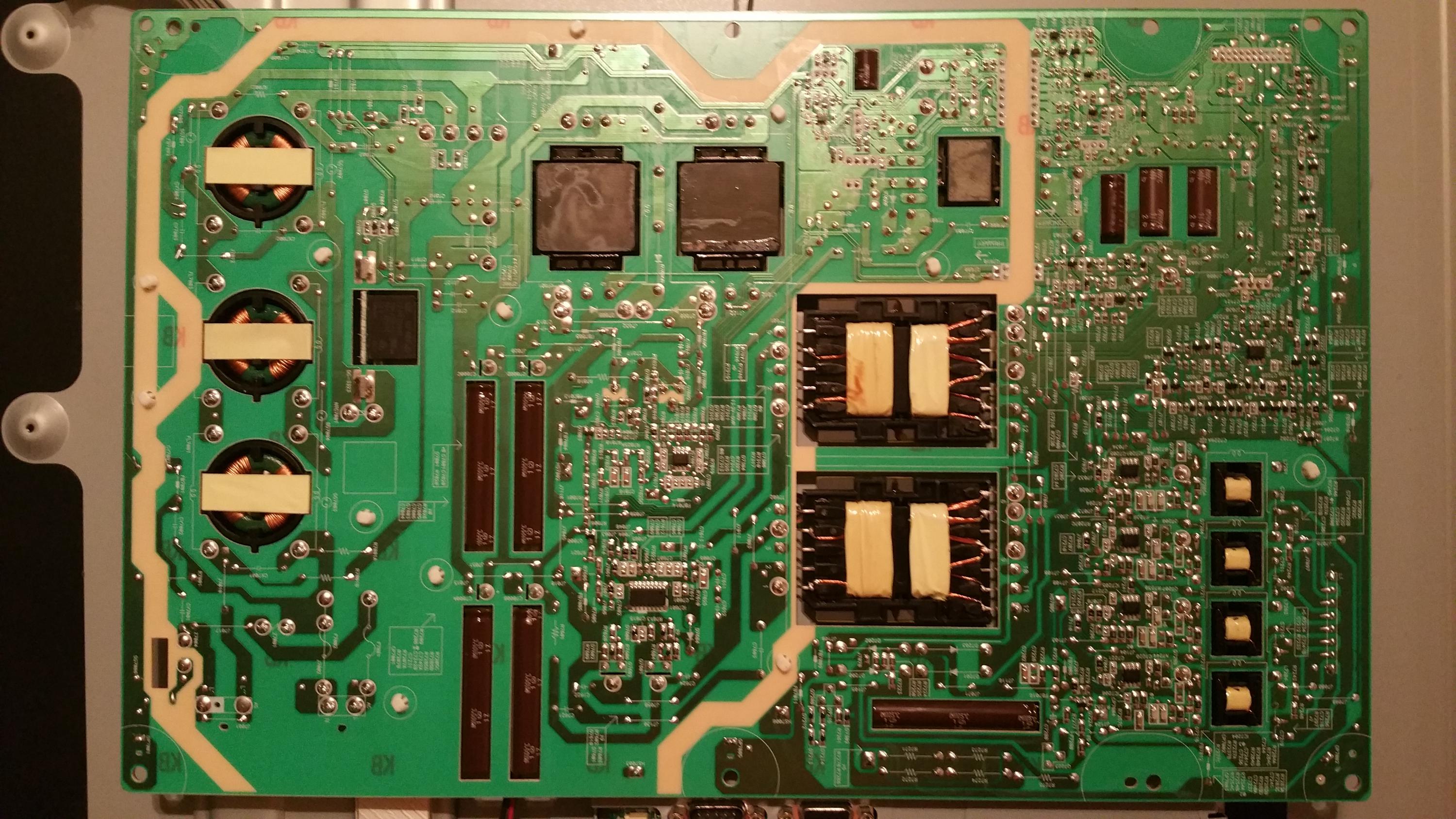

                            • Sfuchs
                              Sean
                              • Jun 2015
                              • 22
                              • Usa

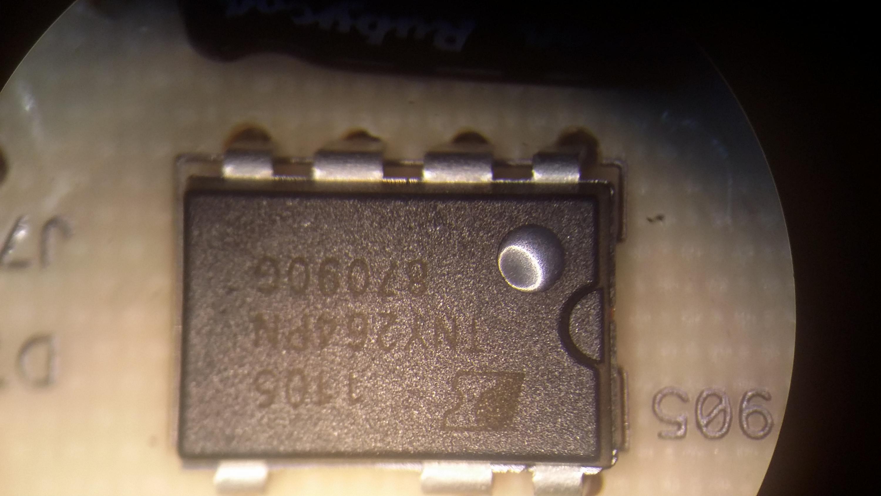

                              See image, i think its clear on how the pins are numbered and i double checked the readings....i am using pin 3 ground as my reference. Should i be using something else?
                                I think we need to verify the P/N of that IC.
                                Based on your picture, pin 5 is the Drain pin.
                                • Sfuchs
                                  Sean
                                  • Jun 2015
                                  • 22
                                  • Usa
                                  Image attached, looks like a TNY264PN
                                    Originally posted by ammarben
                                    IC7905 the 5vdc standby curcuit
                                    str-a6059h
                                    I should have verify that!
                                    So I need to look at the spec sheet next, we just wasted time due to not fact checking.
                                      So now we know that the SMPS IC is TNY not STR, so what you fond connected to pin 4 is probably causing the problem, we now need to find out what this IC is.
