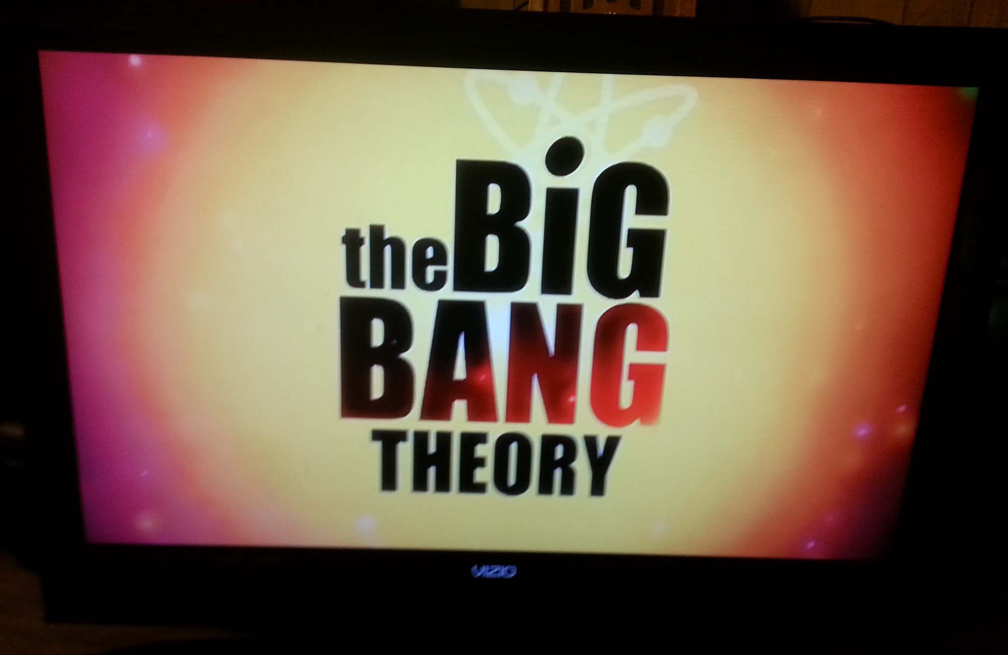

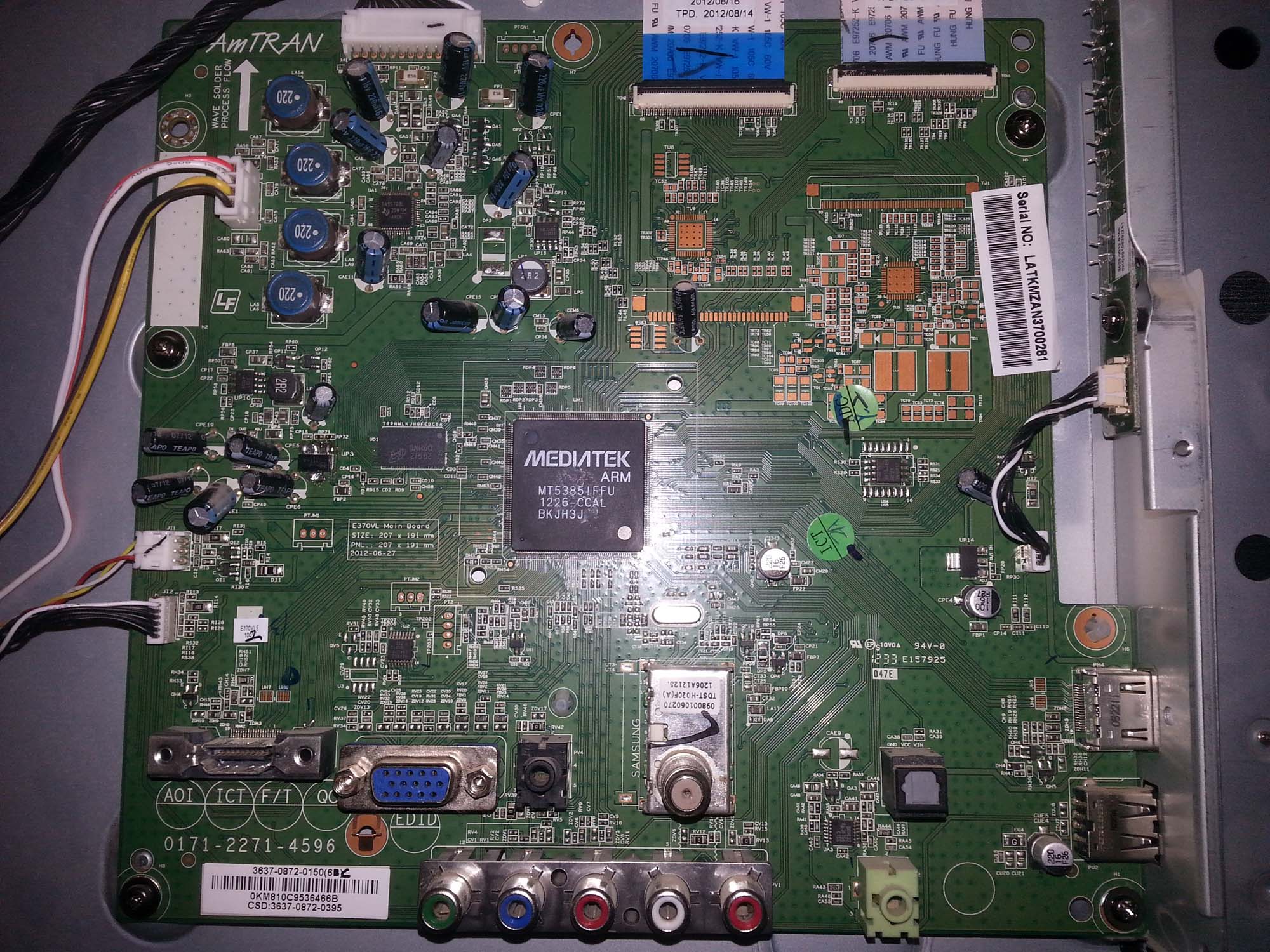

    I could use some help with this. I'm working on a friend's Vizio E370VLE and the standby or vizio logo flashes orange and white at about 1 second intervals. The TV comes on, and it's been on for about 3 hours this morning. I've got picture and sound, basically it works fine but the logo keeps blinking. I've checked a few things but have yet to take any pictures of the boards. I'll post some pictures in a bit. Here's what I know.

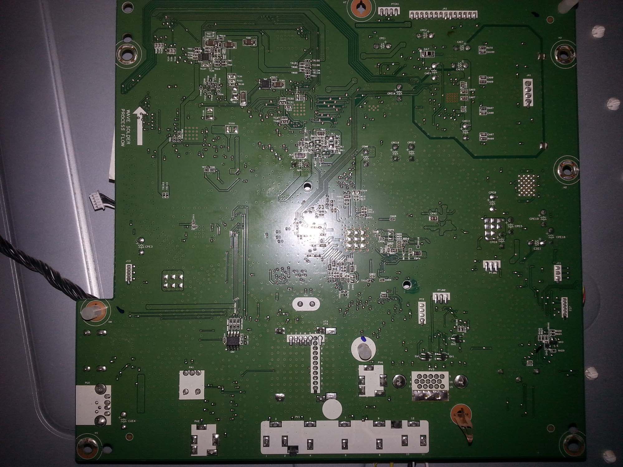

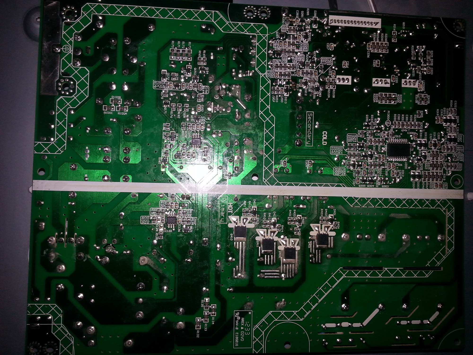

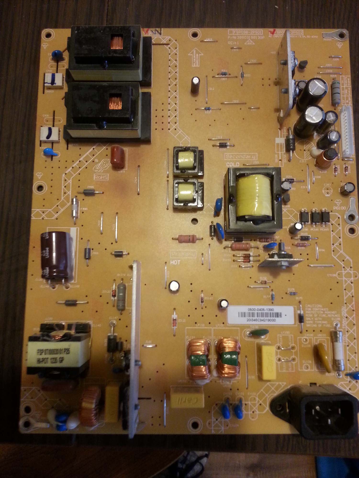

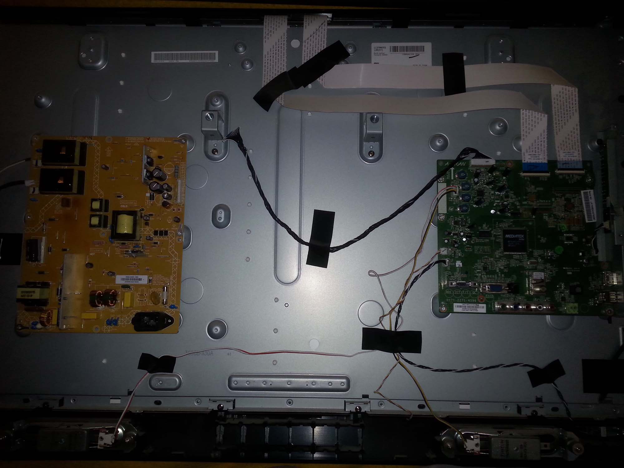

    Here are pics of the PS front, back, and pins connection.
      Re: Vizio E370VLE Standby/Logo flashing while on
      Here is the Main board front and back, plus a shot with boards in place back of unit open.

        very unusual problem, this maybe a corrupt eeprom. I will try resetting the TV back to factory.
        I'm thinking resetting the TV could fix the problem or go from a working TV to not working TV.

          Thanks ecking767, I'm not sure if I want to possibly kill it. I was thinking black tape over the logo.

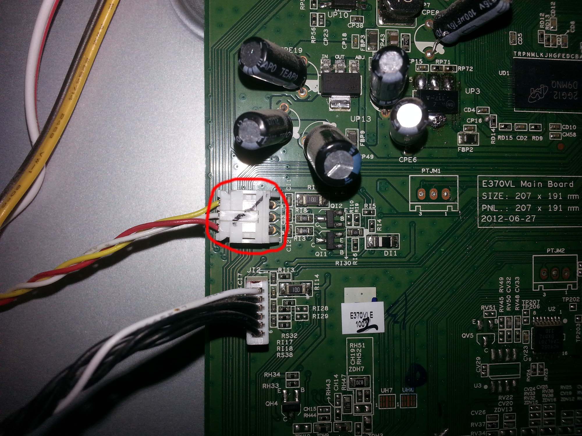

          I did find something though and I'm in the process of hopefully resolving the issue. In the photo attached is the connection for the standby/logo light. (Now, instead of black tape I have an option of just unplugging the light. Just kidding I'd like to see if we can figure this out). I found on the connection that the voltages are dropping. Starting from the top of the picture and going down the three connections read:
          1. 5.08v
          2. 2.78 ---drop to 1.92v then back to 2.78v
          3. 3.59 ---drop to 3.13v then back to 3.59V
          These are the voltages being sent to this connection from the main board. I just have to find from where they are being sent.

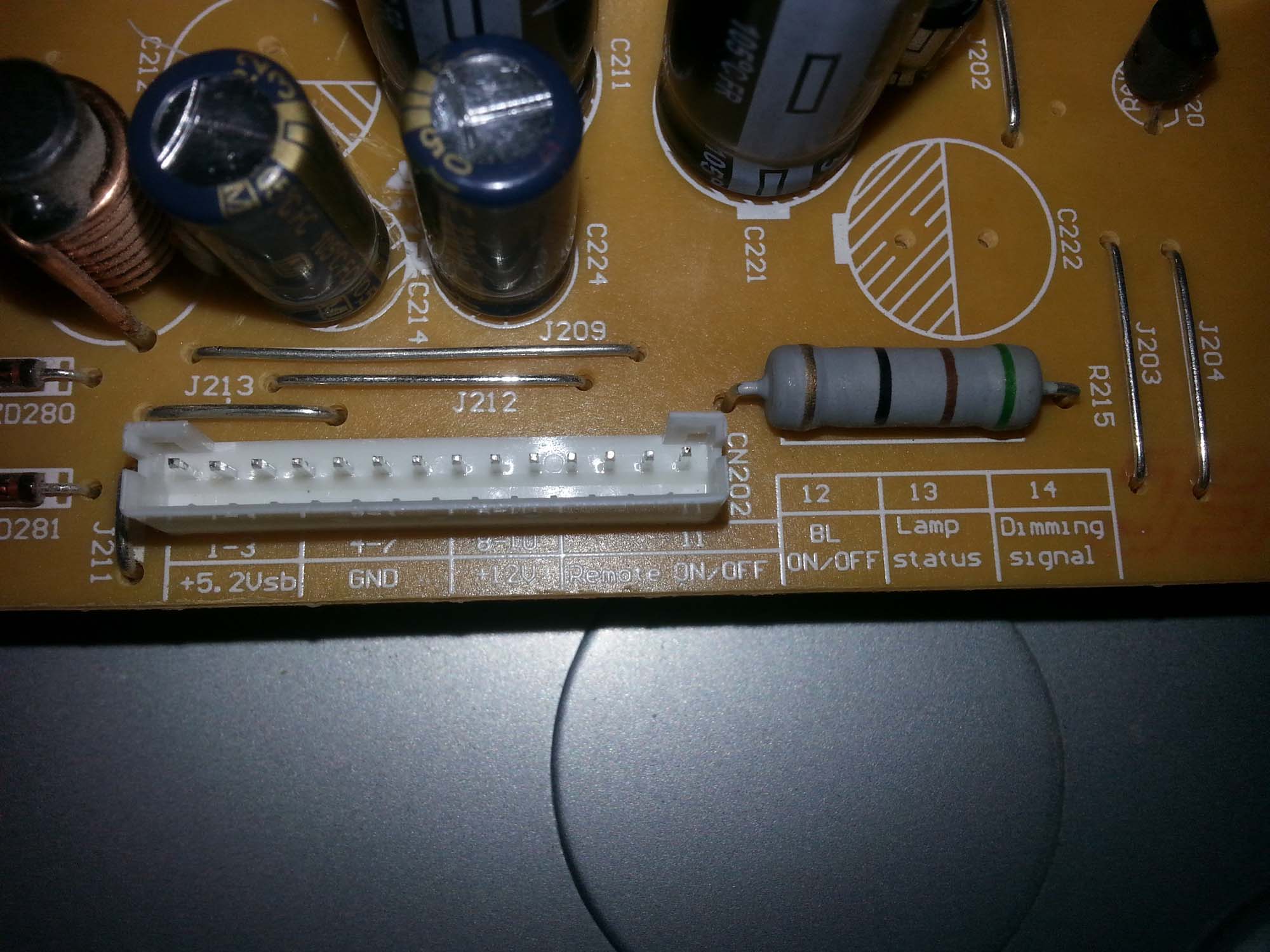

          From the close up picture you can see that I replaced UP3 but no changes in the voltages from the OP. I checked voltages on the PS on the 14 pin connection and they all read true to what they are supposed to be, and with no variations in voltages like on this connection.

            Ecking, by golly you were right! I got to looking into some things in the menu and found this in the System Information.
            Before Reset:
            Model: E370VLE
            Version: 0532
            Source Type: DTV
            Resolution: Unknown
            Vertical Freq.: 0
            Progressive: Unknown
            After Reset:
            Model: E370VLE
            Version: 0532
            Source Type: DTV
            Resolution: 704x480
            Vertical Freq.: 29.97
            Progressive: No
            It looks like it was a corrupt eeprom after all. Thanks for your help!
