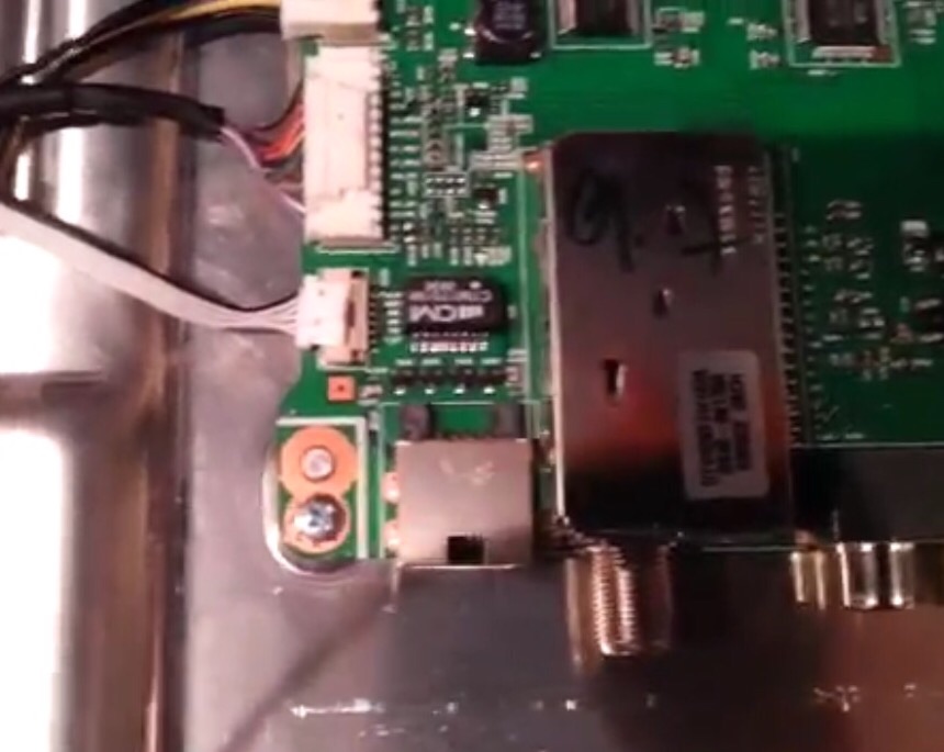

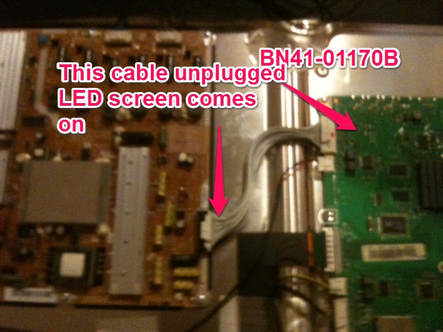

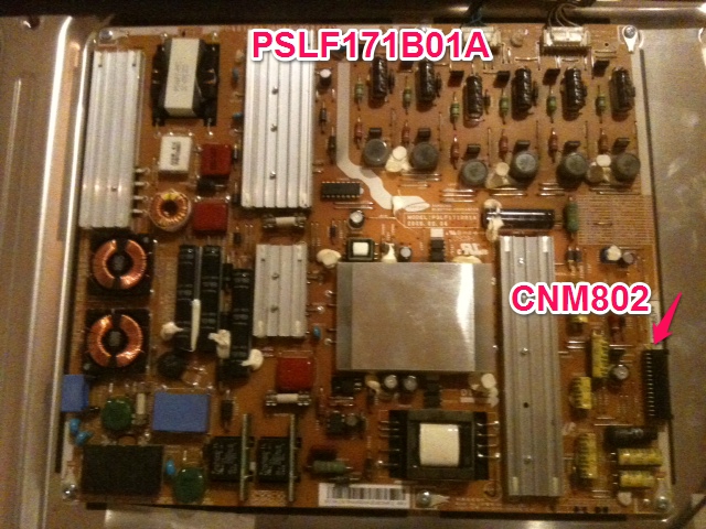

I have a Samsung UN40B6000vf /xza that makes clicking noises sounds like a relay. Shows no power like it clicks on then clicks right back off. When I unplug connector CNM802 that goes to the AV board it will power on then the LED lights up bright white.
I checked voltages on that connector and got

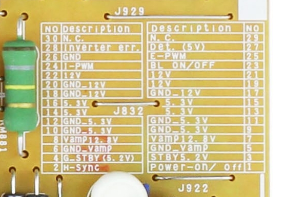

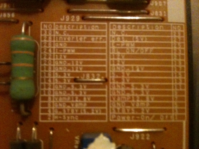

Looking at the power supply board PSLF171B01A are in question
Pins
8 Vamp 12.8 is showing none
10 GND_5.3 is showing 13VDC
12GND_5.3 is showing none
18GND_12v is showing none
19 12v is showing none
Any guidance or help will be greatly appreciated. Thanks,
