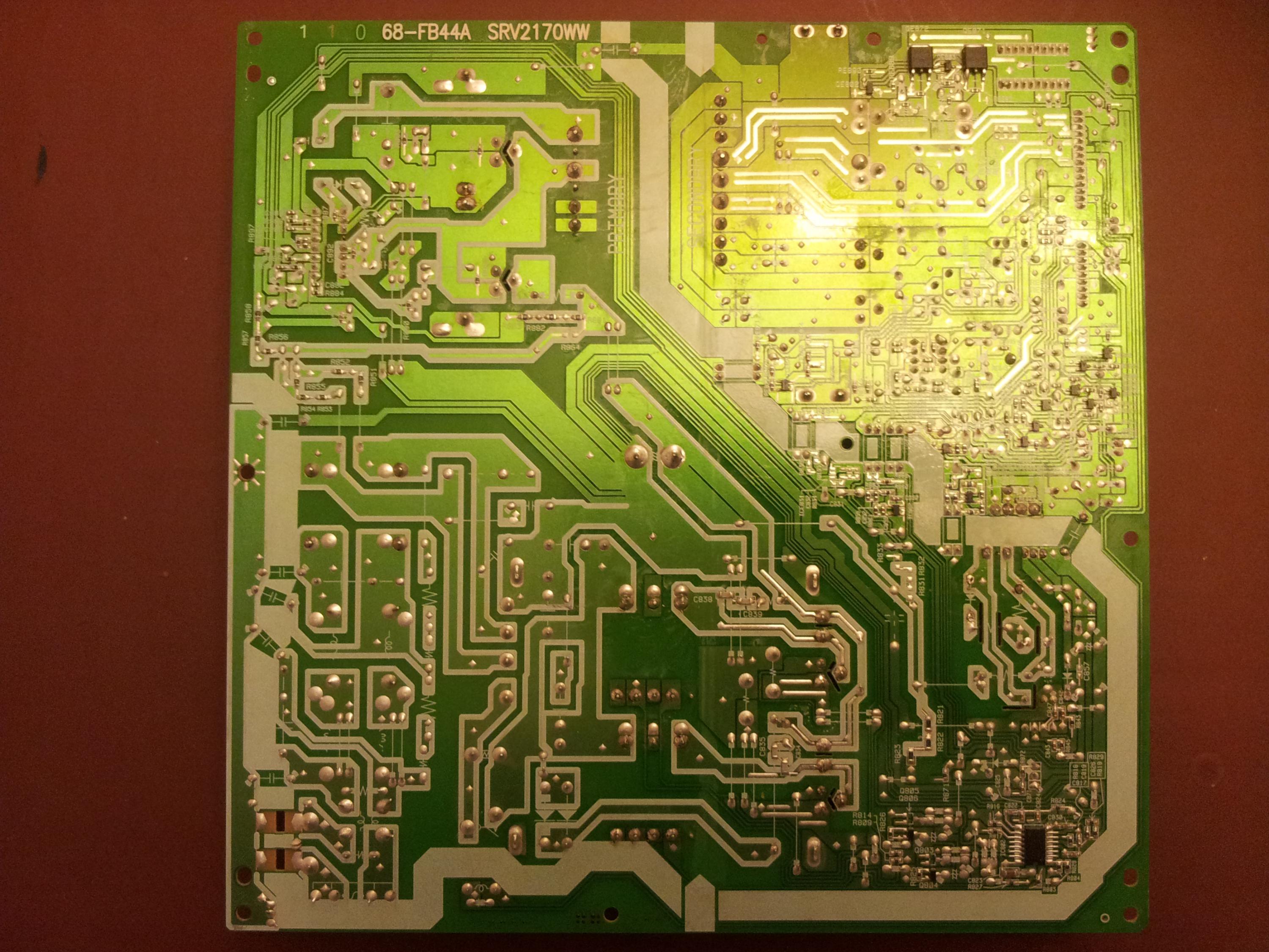

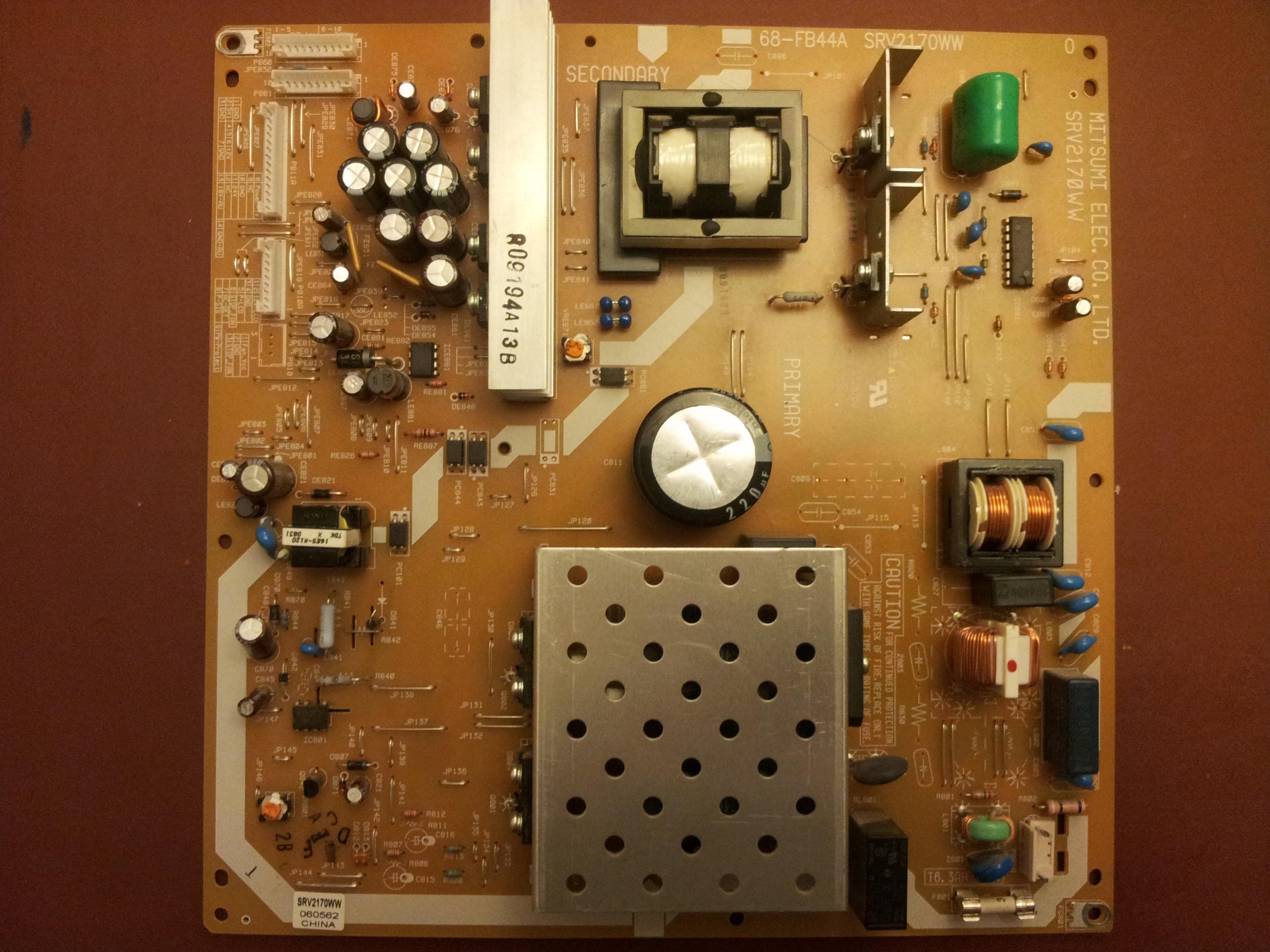

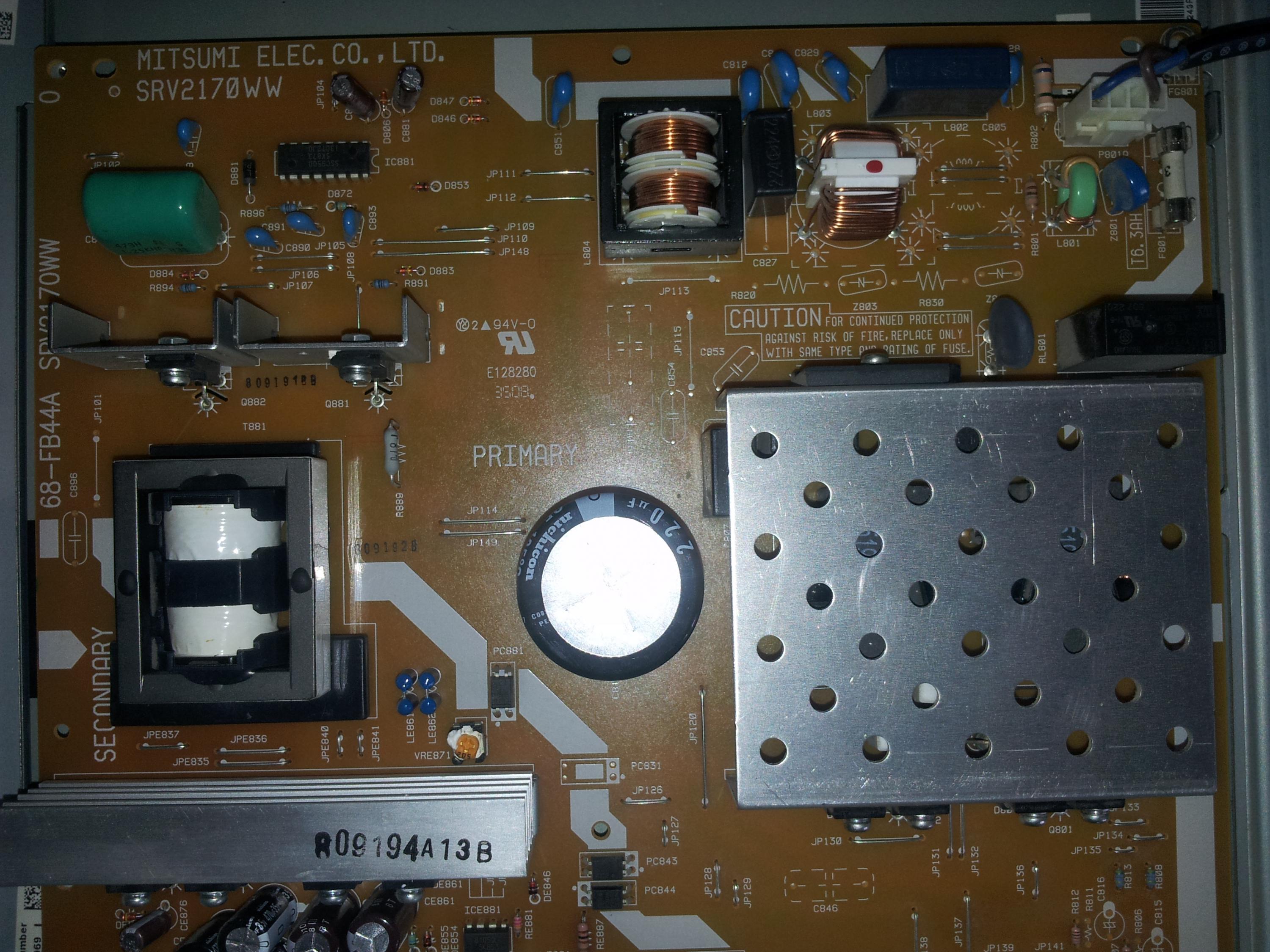

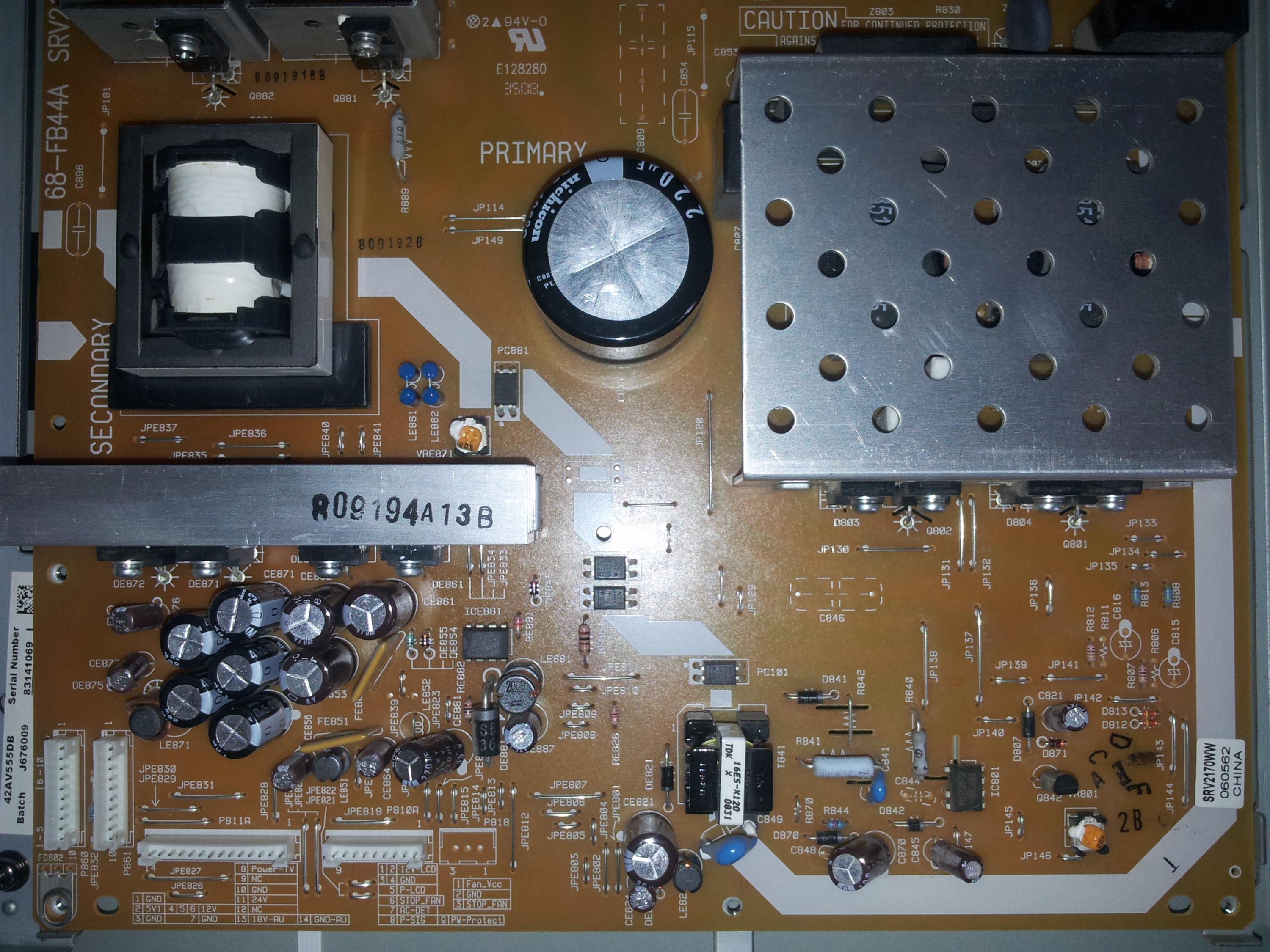

                            Can we see the straight shot picture of the whole power supply both top and bottom side?

                              Re-visiting the psu I checked the diodes to find one shorted, D841 - PR1007L (LT8728).
                              Dmm on diode setting revealed a low reading both ways so unsoldered one leg to confirm its the diode, gave a reading of 26 both ways, then resistance read 29ohms both ways.
                              What can this be replaced with?
                              Checked the resistor R841 which appears ok.

                                  Here are the psu photos as requested, hope they are ok, hopefully not needed now.

                                    Re: Toshiba 42AV555D not starting up
                                    That Diode is the snubber diode for that STBY SMPS IC.
