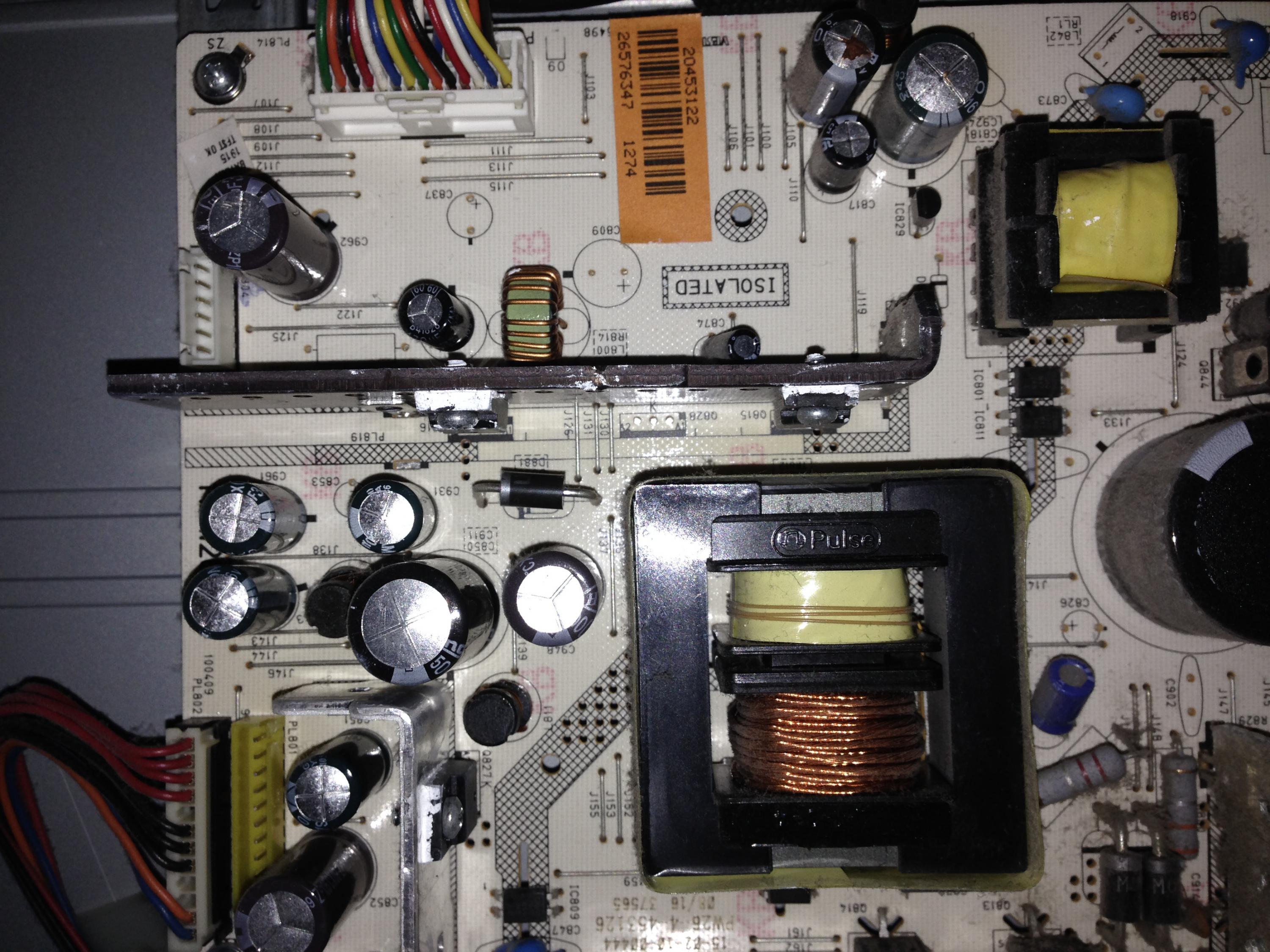

    Hi all i have a bush 40inch lcd tv set,on my board there is a few bulging caps,not burst,do these need changing,as my set it taking forever to switch on,but ok when is.

    Yes they will need changing thats what is proberly causing your problem
      • 31087
      Re: capacitors question
      the 2 in the top right have burst.

        Digikey or Mouser are good sources for caps. The bulging ones need changed for sure and although the others look good they might be on their way out as well. Don't let it cycle anymore as you can damage other components.

          Thank you,be right on it,the recommendations for caps are they eBay or Amazon sellers ?
          I need
          1000 50v 1
          1000 16v 2
          470 35v 1
          2200 6.3v 1
          2700 16v 1
          If anyone can do me a deal,
          Thank you
            • 31087
            your in the u.k. so buy from CPC for free shipping.
            get panasonic FR series.
            http://cpc.farnell.com/
            and edit your list, you need to put the diameter & height.

              diameter & height is that stated on the cap.
              or alternatively without me reopening and anyonec knows the board 17pw26-4,to advise me.
              • diif
                • Feb 2014
                • 6978
                • England
                I have a 17pw26-4 on my bench.
                1000 50v 16mmx25mm
                1000 16v 10mmx20mm
                470 35v 10mmx20mm
                2200 6.3v 10mmx20mm
                2700 16v 12.7mmx21mm
                http://uk.rs-online.com/web/ also offer free shipping.
                  Beware, there are several versions of 17PW26-4, so make sure to only order what's on YOUR board.

                    thank you,just looked on on ebay seller example ,470uf35V
                    10mm x 16mm x 5mm would they be the same ?

                        Do *NOT* order capacitors from eBay if you can avoid it. They are usually general purpose or cheap crap.
                        Get Panasonic FC/FM/FR from CPC. If you order more than £10 it's free delivery.
                        Be careful - Panasonic also sell "NHG" and "G" caps, these are not suitable. Only use FC, FM, or FR series.
                        By version - I mean there are several variants - may not just be v.1 but also different load variants so you need to check what's on your set's board.
                          That will be fine although i'd buy from cpc or rs as they will both be cheaper than ebay. And also less likely to be fake.

                              Load variants,where how do i check ~?

                                Read the capacitors values\voltages off the capacitors on your own board and write them down. Then go order replacements that match.
                                  http://cpc.farnell.com/webapp/wcs/st...&storeId=10180
                                  http://uk.rs-online.com/web/c/passiv...um-capacitors/ this site is slow.
                                  Both have the option to filter by brand or product range. Select Panasonic on the rs site or FM FR on the cpc site (They seem to have stopped stocking FC).
                                  You can then select by value/voltage and whichever size is closest.
