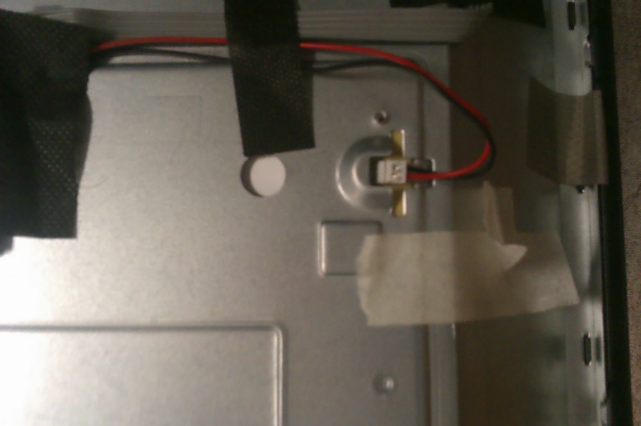

      Re: Toshiba 32W3451DB Backlight Problem
      If I knew what voltage to actually expect I would be measuring it.
      At present - there are two connections to the LED(s) and a DVM across this pair indicates something odd - may be pulsed DC of some form.
      Red wire LED to chassis approx. +27V DC. Black Wire LED to chassis/0V approx. 1.5/2.5V DC - but again suggests pulsed or something.
      Can I drive the LED's with something else to test them? If so what?

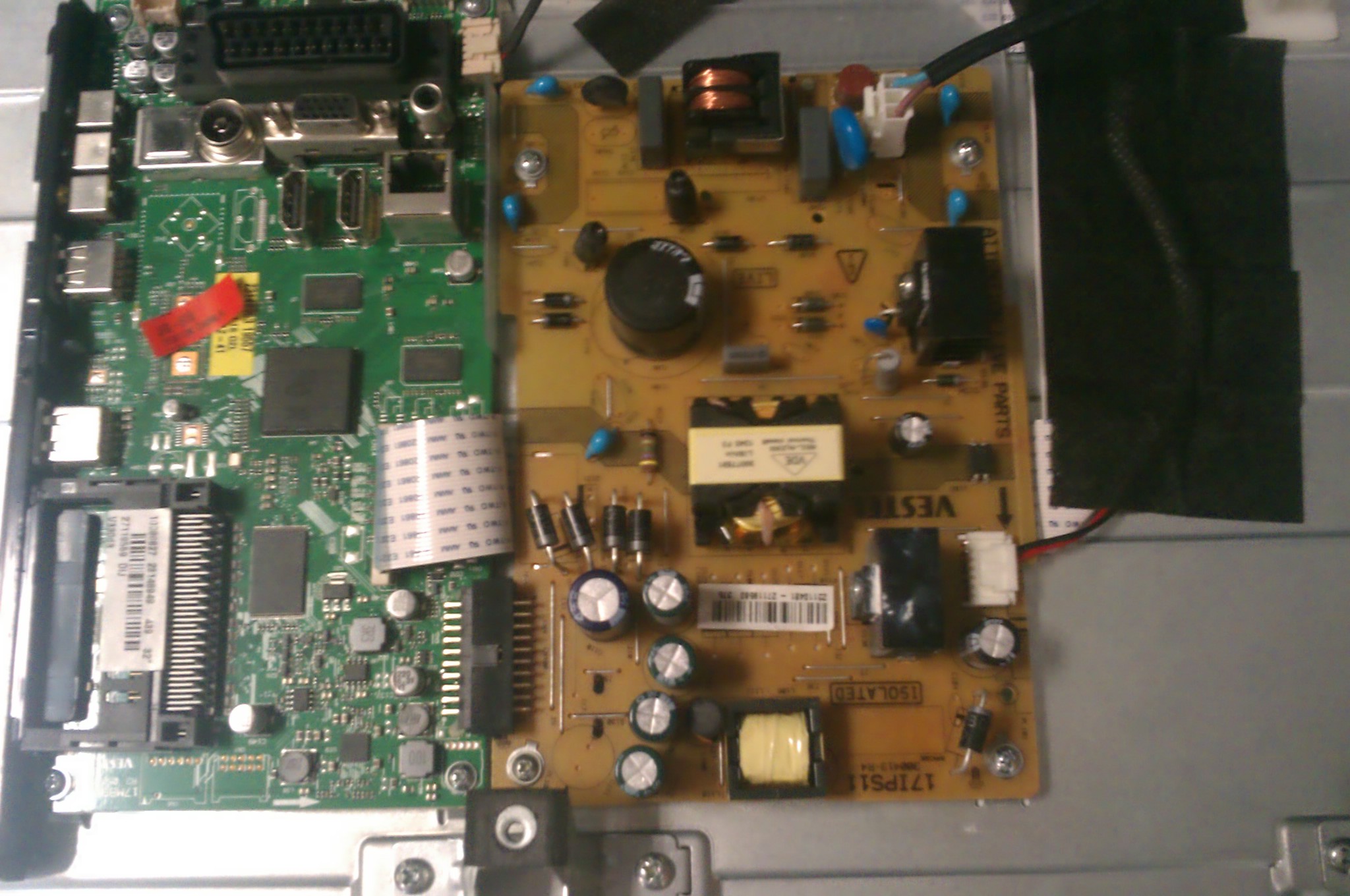

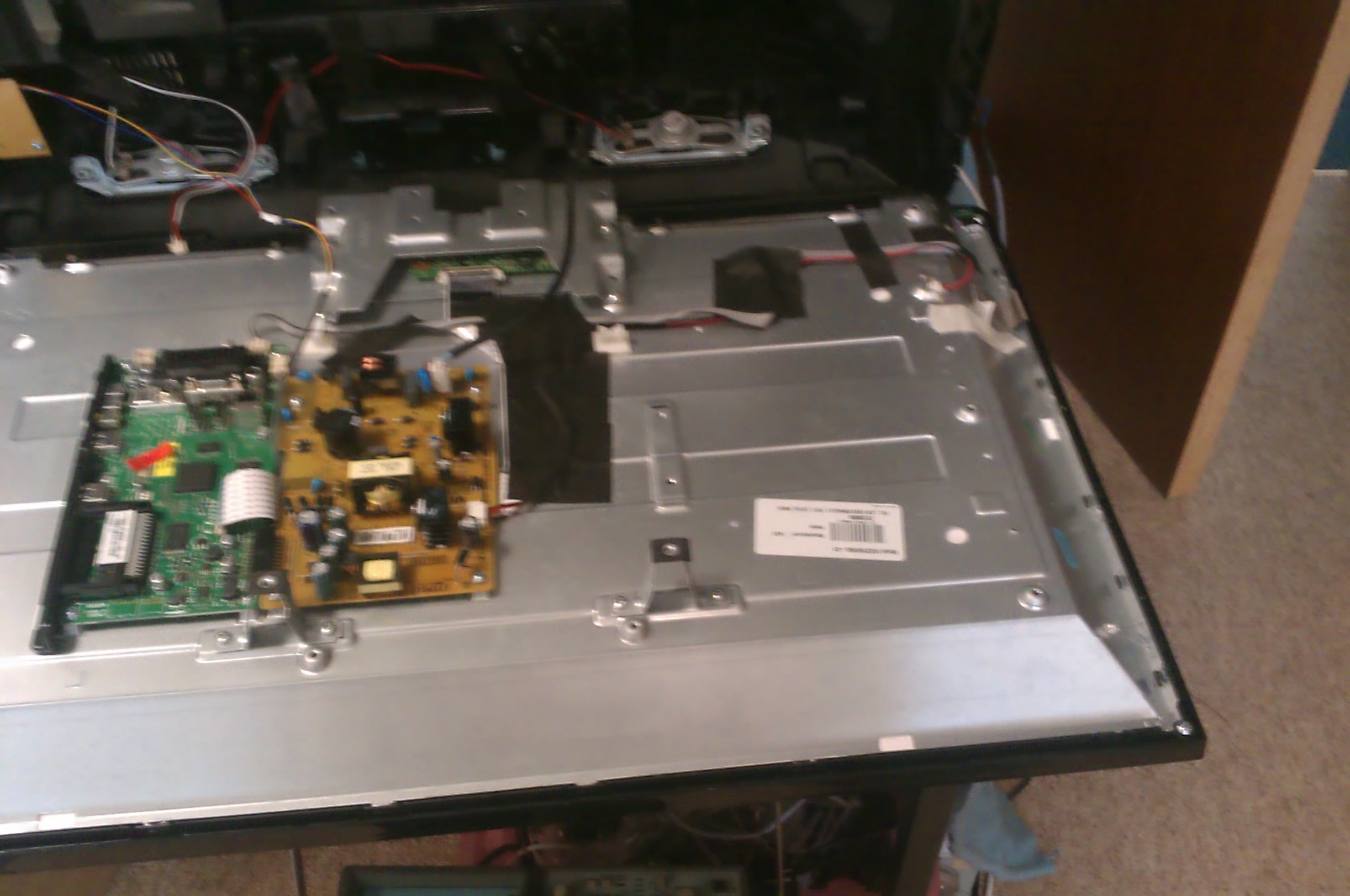

        Pictures so we can see all the boards and how they are connected together?
        • BBN
          • Jun 2015
          • 11
          No sure whether this is what you want - but basic overview
            Check the voltage read on those red and black wires going off to the panel - I think that is the LED backlight supply.

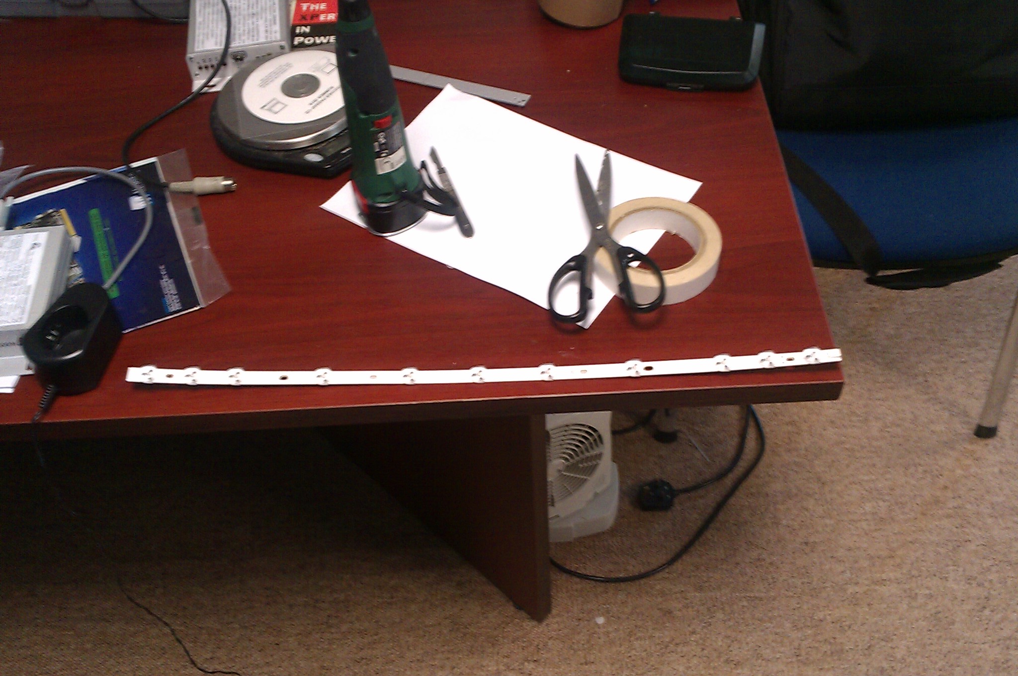

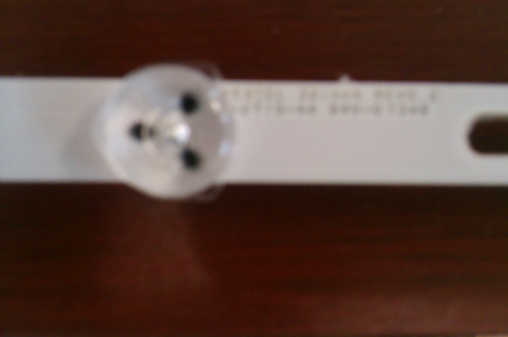

                            These are brief photos of the backlight strips
                            2 strips each with 11 leds approx. 575mm in length. and 12mm wide
                            Green PCB joining these is 17DB01.
                            Each LED strip has written upon it horizontally @ left hand end VESTEL 32 inch REV0.2 TIS-4A 94V-01346
                            Each LED strip has written upon it vertically @ right hand end LJ AHB2 1003 VES315 WNDL-01.

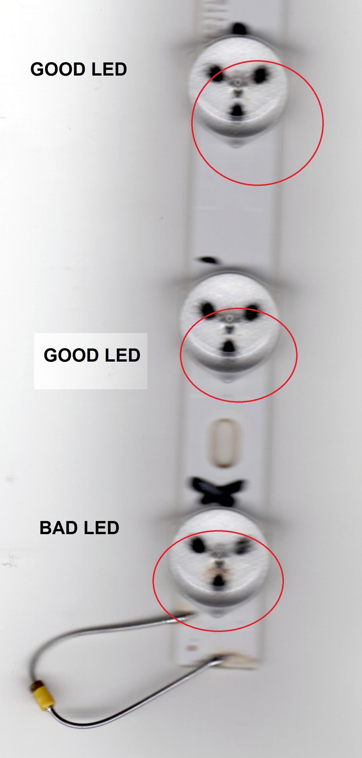

                                Having removed the strips I was able to wok out the connection/tracking using a DVM and two sharp scalpels to penetrate white surface of PCB/strips.
                                Again using DVM but set to diode test where a voltage reading is expected I was able to test each individual LED - one way round about 0.2V other no reading but very dim pinpoint of light on led connected. One LED @ one end of a strip gave no reading and no light and viewing this more carefully I think you can see a burn mark underneath it! (see attached).
                                I bypassed this with a 3V9 Zener diode (reverse biased) and then reconnected/repowered everything without rebuild. NOW all backlights come ON (except for bad one of course).
                                Hence we look to have actually found the problem, even if not cured it yet!
                                  Looks like the same failure as this one, one LED was open, one was shorted.
                                    Sorry this has taken so long, but I should be returning this now operational TV to its owner tomorrow.
                                    There have been considerable delays whilst I waited for particular components to be delivered and also a week ago I thought it was OK only for a another LED to fail and cause a new repair + long periods of soaking.
                                    As previously stated I found the initial LED culprit. I replaced this with a 1W cool white LED - which was overbright and whilst trying/testing two more LED's on that same strip gave up working - suspect mechanical failure here after strain put on glued strips when removing. I got these (and other) 1 W leds on Ebay .
                                    Replaced all three leds and all overbright, ended up masking a bit with covers made from polyester drafting film (a bit like tracing paper) and managed to reduce screen brightness further by adding an additional led in parallel, but fastened 'out of site' on backplate chassis of TV. Refixed strips in place with double-sided thermal tape and rebuilt.
                                    This was a bit of a compromise as now several 'bright' spots when certain colours - but I thought acceptable. I ran the rebuilt item for about 12 hours and then another LED (old one) started to flicker and then gave up O/C
                                    Fortunately, as this LED was 2nd in from left hand bottom strip and I had already replaced 1st and 3rd in I had 'available' connections to the 'bad' one and connected a Zener diode in parallel with the second 'bad' led - this was more of a test to check the problem was still leds, rather than a repair - but I then tried things.
                                    I do not know why, but now the two parallel back facing leds involved no longer shine, however even with the now 'missing' 2nd led in left hand bottom corner is only fractionally dim and I still have one 'bright' spot.
                                    I have kept this arrangement, run it for more than 30 hours and it seems a good compromise.
                                    I did find several places where I could purchase replacement LED strips - cheapest being from Romania. However, all of these were effectively 2nd hand, having been removed from 'broken units' . Having seen how much physical force was required to remove these strips I was not very keen on spending a considerable sum of cash on replacements on rather 'unknown' long term quality item. These alone would have cost me at least 10% of a brand new replacement TV.
                                    I will state several things about my experiences here:
                                    The LED's employed might be easy to get and replace IF you could find out exactly what make etc. was fitted.
                                    Many led's you can purchase (like those I got from Ebay) are like beacons in comparison - I did later get hold of what are termed 0.5W rather than 1W ones, but am not keen to try these (as yet).
                                    Taking one of these panels apart is a problematic process and you may well find it necessary to repeat things a number of times (I certainly did - at one point all looked well until in a dark room and white light was seeping out of the surround bottom). It is essential to keep the interior layers free from dust/bits etc; things must all be well aligned and there are a large number of plastic spring tabs involved that must be released/re-engaged that are very likely to snap off without care.
                                    Just taking the back off of this type of TV involves screws and a simple lever action. Getting down to the internal led strips/panel itself requires a lot more screws + plastic clips - a lot more to get right and go wrong + disconnection and manhandling of some sensitive parts too.
