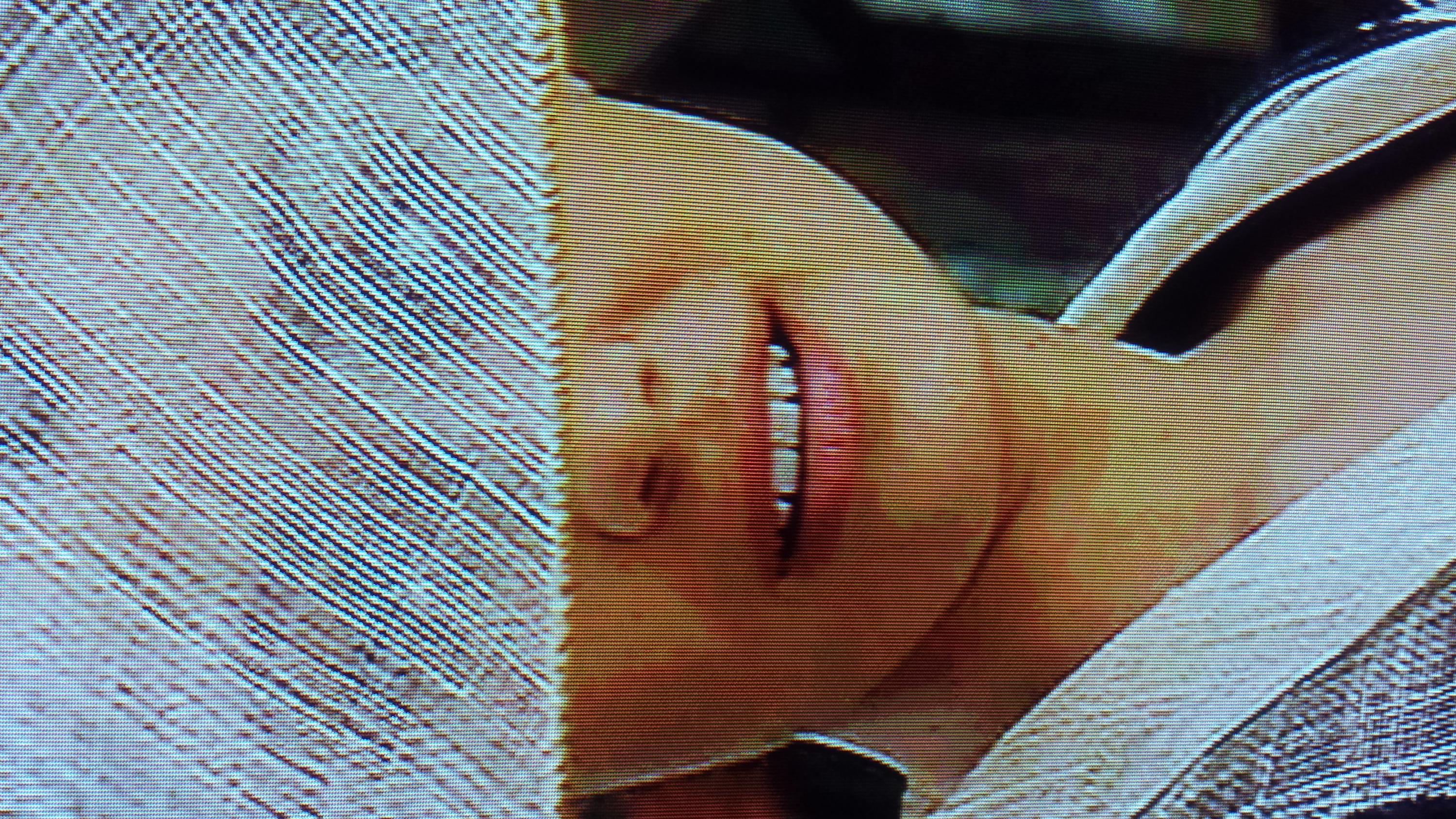

    I have an older LG DU-42PX12X/12XC.
    Yeah, I know, pony up and buy a newer model. But I have had this one for awhile, and don't want to spend the $$ unless I have to.
    I think, based on previous posts, that my problem could be those pesky solder joints on the coils, but wanted a little reassurance before I pull this thing off the wall and open her up.
    Problem: Color "posterizing", as it's been referred to on this forum. No other problems, and it has just started getting noticablly worse in the last 3 days. Not unbearable, but still like "paint by numbers" color.
    Am I right about the coils?

    I split your post off as it's an entirely different TV.
    Most likely, the fault is not the coils -- it's more likely an issue with the voltages, or panel maldischarge which requires a firmware update to the control board.
    Pictures of the fault would help a lot.

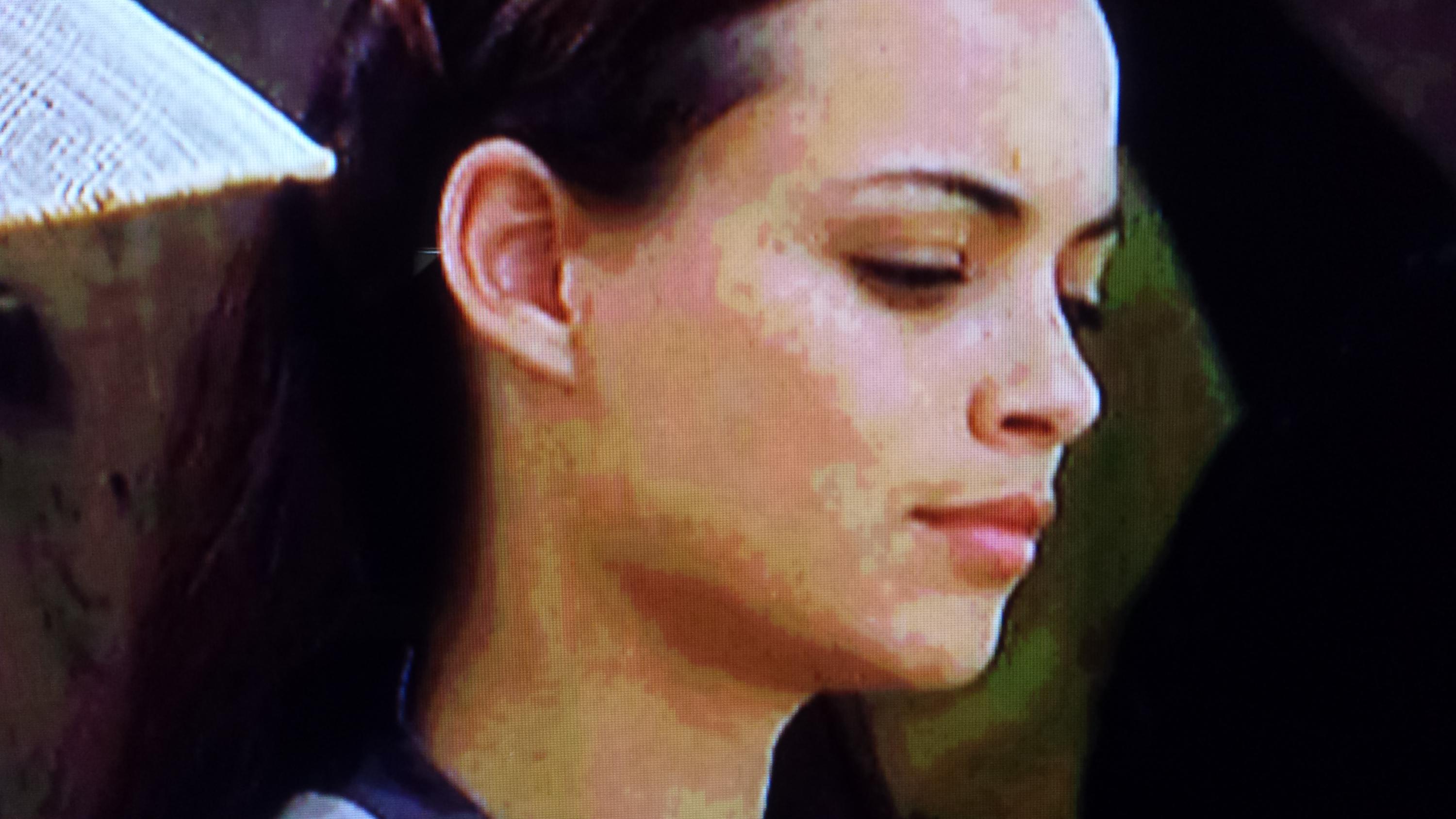

      Per your instructions, please see the photoa attached
      I hope I did this properly.
      The one photo with the fine lines is not as true as the other. The fine lines are a result of taking the photo off an operating display. My problem is the war the color doesn't "smooth" and looks loke a poster.

          Re: LG DU-42PX12X/12XC colour issue
          As tom said you need to take the back off and take some voltages to see if they are in spec as printed on a sticker on the panel itself.
              Check the voltages then run the internal test patterns. I don't think this is a panel fault if that's what you're asking.
