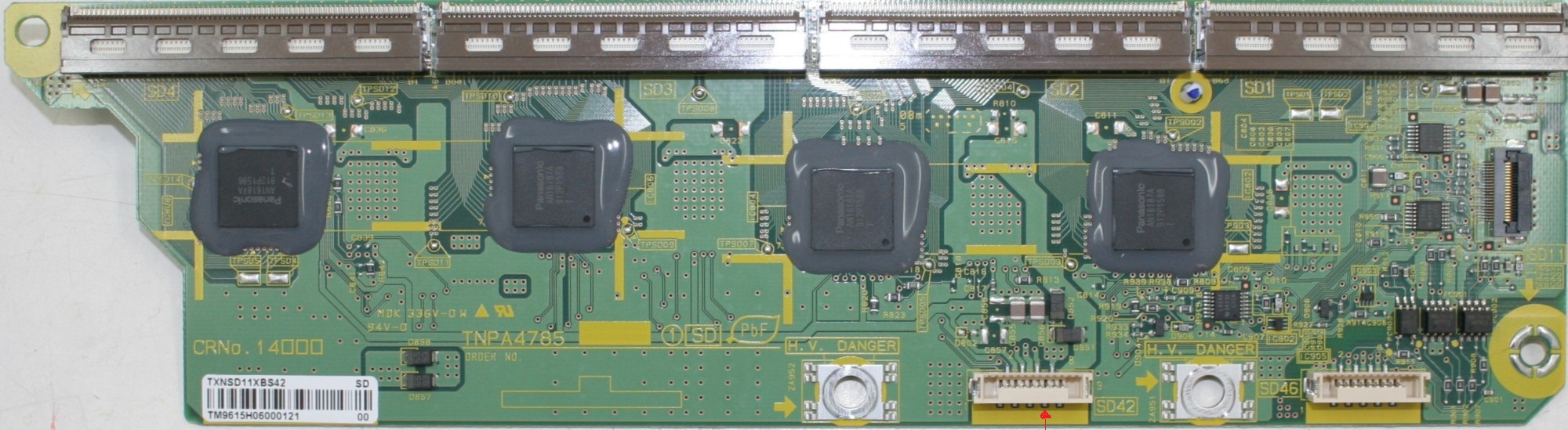

    Im repairing a Panasonic TX-P42U10E wich has a shorted buffer board.
    I ordered 1 from flattvparts but that 1 was also short.
    Ordered another 1 from ebay but it was defective on arrival , both buffer boards are missing the white connectors and 1 pad is gone .
    Attached is not the actual board but the arrow shows the pad thats gone.
    Can i still fix this board or do i need a new one? I cant see where the traces are leading to.

    The connectors are par of the Sc board. it is indeed possible if you have a bad buffer that it damaged the sc.
      Re: Panasonic TNPA4785 board
      No the SC board is fine. When i disconnect the buffer boards and use the jumper on the SC board the TV stays on.
      Problem is that on MY buffer board the white connectors are gone. On the picture you see the white connector thats gone on my board. I have a connector wich i can use but one pad is missing. Im talking about the pad on the picture with the red arrow......
      I need to know where the pad is going to so i can make jumper...... :/

        you're in luck, pin 7 is not used

          Hmm ok , lucky me but this is strange! Tested the board before i installed it and it had no shorts. Installed the board , turned on tv ....a small flash and 7 blinks again.
          Took the buffer boards out , measured again and again SAME CHIPS are shorted......
          What am i doing wrong?

            Have you seen this TV work? Could panel be shorted / cracked? Don't know to be honest?
              No i bought it with a 7 blink error! Panel looks visually ok , not damaged in any way.
                Honestly, don't know. only suggestion would be run it with just the sd with jumper in place. remove the Su or fully disconnect including the 2 Vfg bolts and run it to see if bottom half works.
                I've never done it, guide suggests it, not sure if it will do damage so at your risk.
                may help prove sd and sc ok but still if the panel has internally failed in the upper part then this probably won't prove that part.
                never been faced with this one except a tottlly shorted samsung panel that killed 2 buffers and made buzzing noises which I concluded shorted panel.
