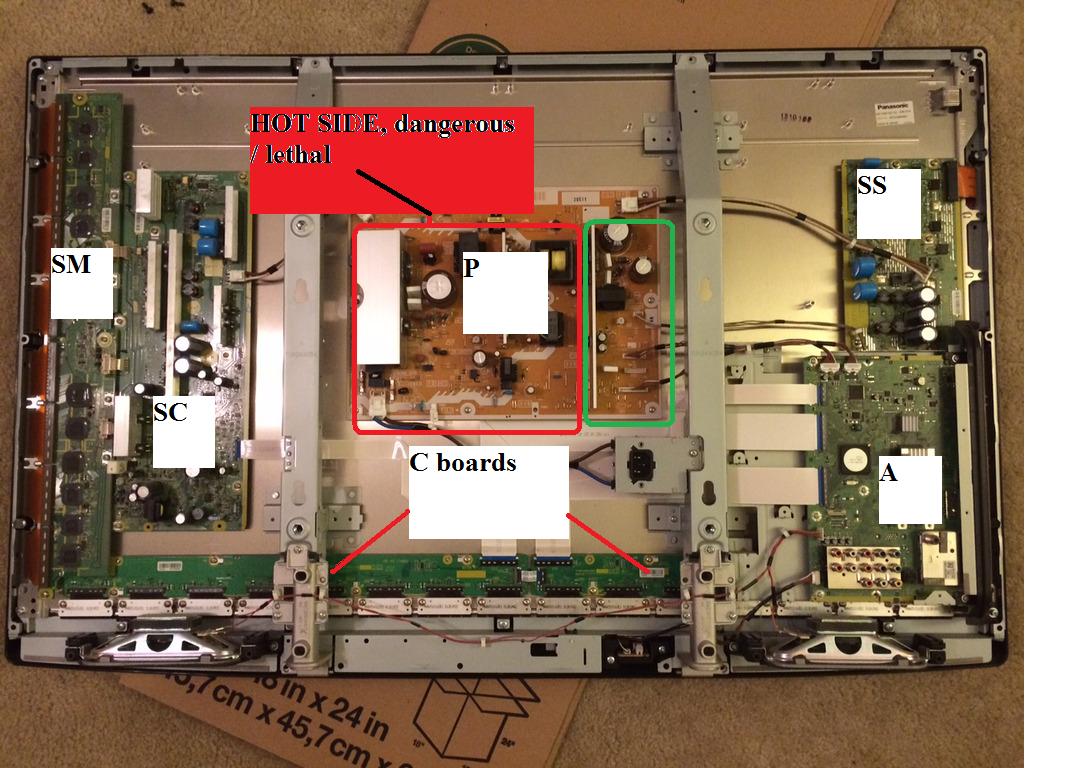

    Greetings all,
    I've got a 5 YO Panasonic TC-P42U2 that was working fine until yesterday. At first there was no picture but the TV menu and red LED power button light was still visible, a few hours later, no signs of life AT ALL. completely bricked. Haven't attempted any troubleshooting at all other than disconnecting the SS board cables, reconnecting and giving it another go, but nothing. Something note worthy is that in the 5 years that I've owned this set, I've never seen it do a self poweroff until the day I started having issues... correlation?
    I've seen quite a bit of threads floating around the webs regarding this make and model, but folks usually have some flashing lights to help troublshoot the problem. I have nothing other than a brick, so I don't know if that makes things more or less difficult to troubleshoot.
    My very uneducated guess tells me that it's the power board, but I honestly don't know. I've attached an image of the tv with the back panel removed.
    So what do you guys think? And please feel free to ask any questions! Thanks!

    I would think power board or main board here is the service manual to help you sort it out until Tom chimes in
    You could start checking fuses with an ohm meter, they should all read less than an ohm, also in the service manual should be a description of wiring harnesses to unplug and get the set to go into auto test if the main board is at fault

      If you have no front panel LED and yesterday you lost picture but front LED was on and still had OSD i.e menus etc, I'd be thinking the A board is dead. get a hair dryer and warm the A-board up and see if anything happens.
      Failing that, check for 5v stdby voltage, if present I'd again say A-board as it then generates 3.3v from this and then tiurns on the front LED.
      That TNPA5105 SC board would have some value if you scrap this. Finding and A board for this series could be quite challenging, ModuslinkPTS do repairs but I think $150 mark, you'll have to have a look.
      If you wanted to be real crazy, there may be a way to integrate a P42G20 main but unless it was a cracked screen scrapper going cheap with all boards and cables, there'd be little to gain.

          You're talking to a complete amateur here. I have a multimeter at my disposal so I can try a few of your suggestions and report back, but can you go into details on where to go to check for 5v stdby voltage?

            read the manual, identify danger, locate 5v stdby , plug TV in, turn on at wall, measure in DCv , the 5v standby voltage at A-board is connector A7 pin 1 , red probe on that and blk to chassis gnd

              tw2005- took me a minute to locate connector A7 pin1. Meter reads 4.97 DCv

                Main is at fault then

                      TNPH0831AG (txna1ljuus.) should be the correct board

                        tw2005- my board reads TNPH0831A3, so I think the ebay seller mad a mistake in his description or possibly used a stock photo as you pointed out... but his board is also TNPH0831A3, so it should be a correct match?
