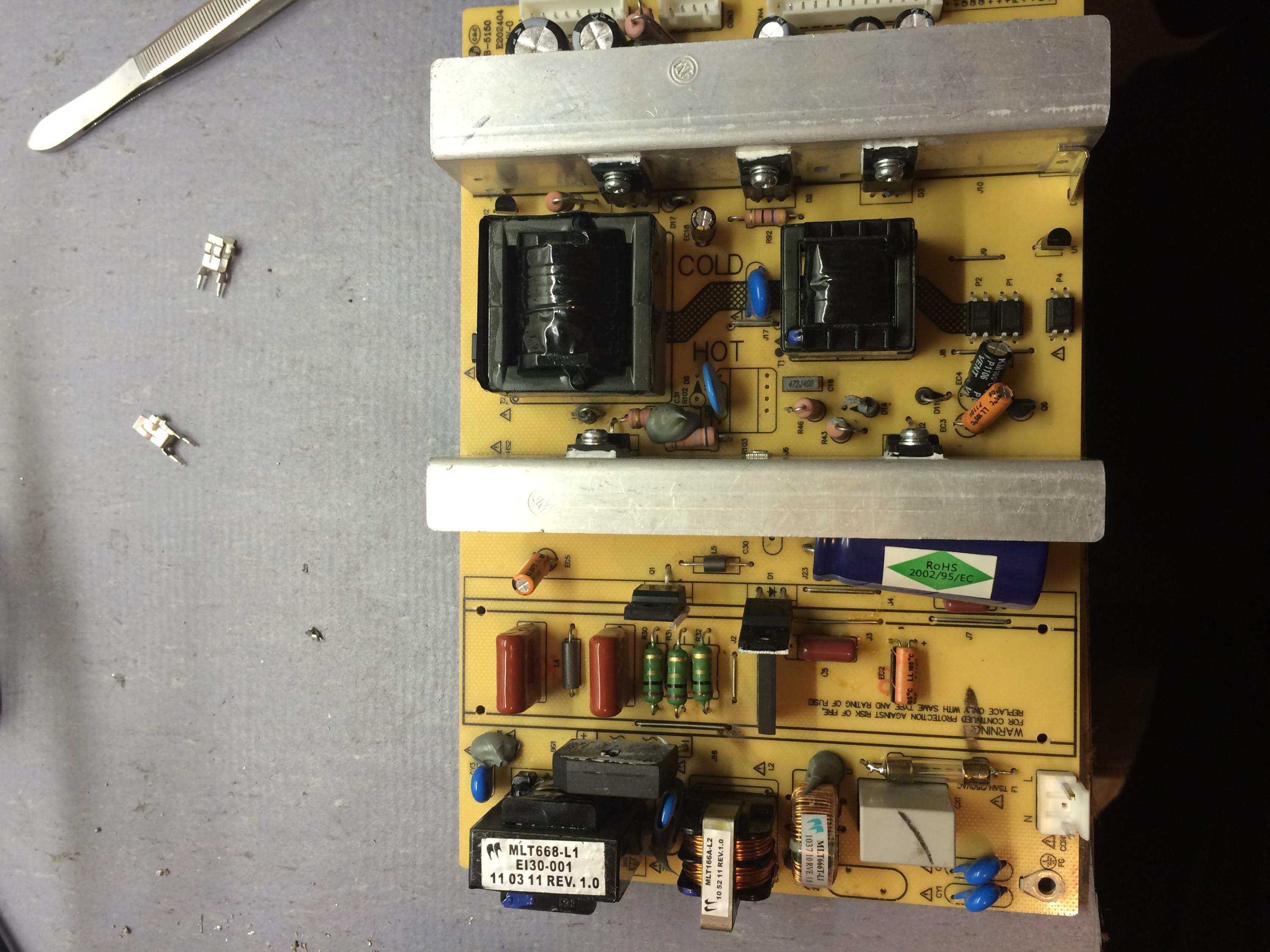

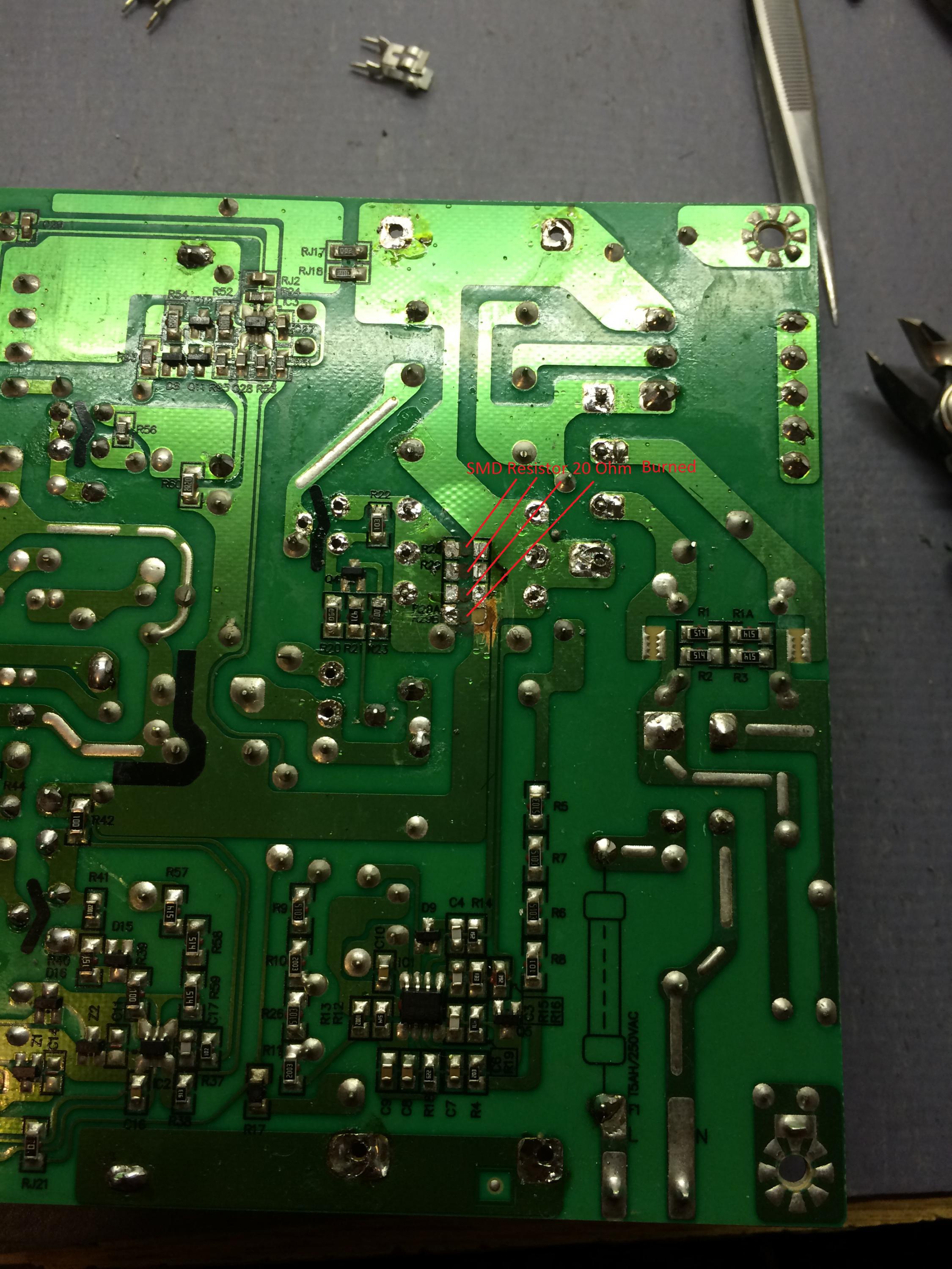

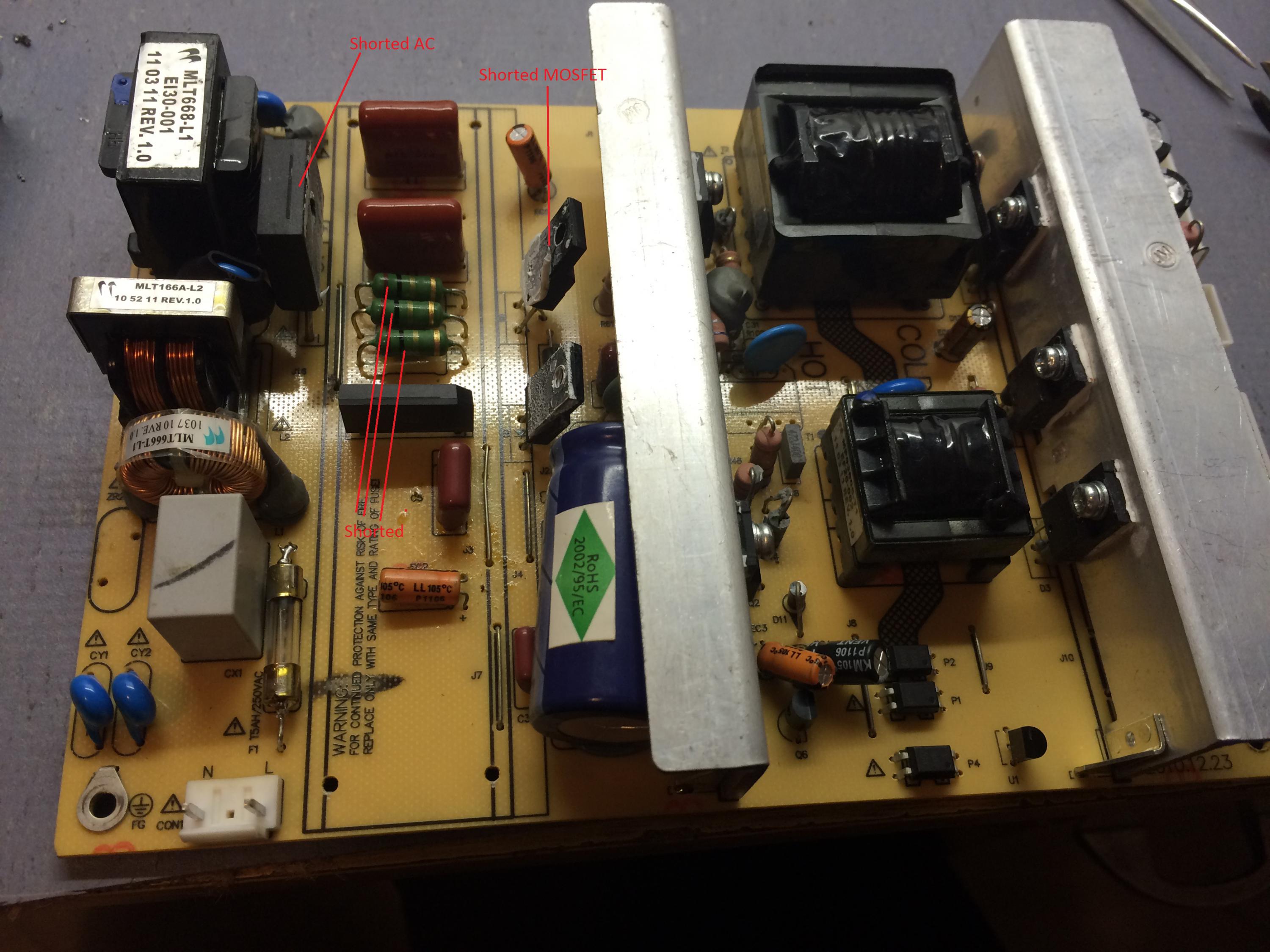

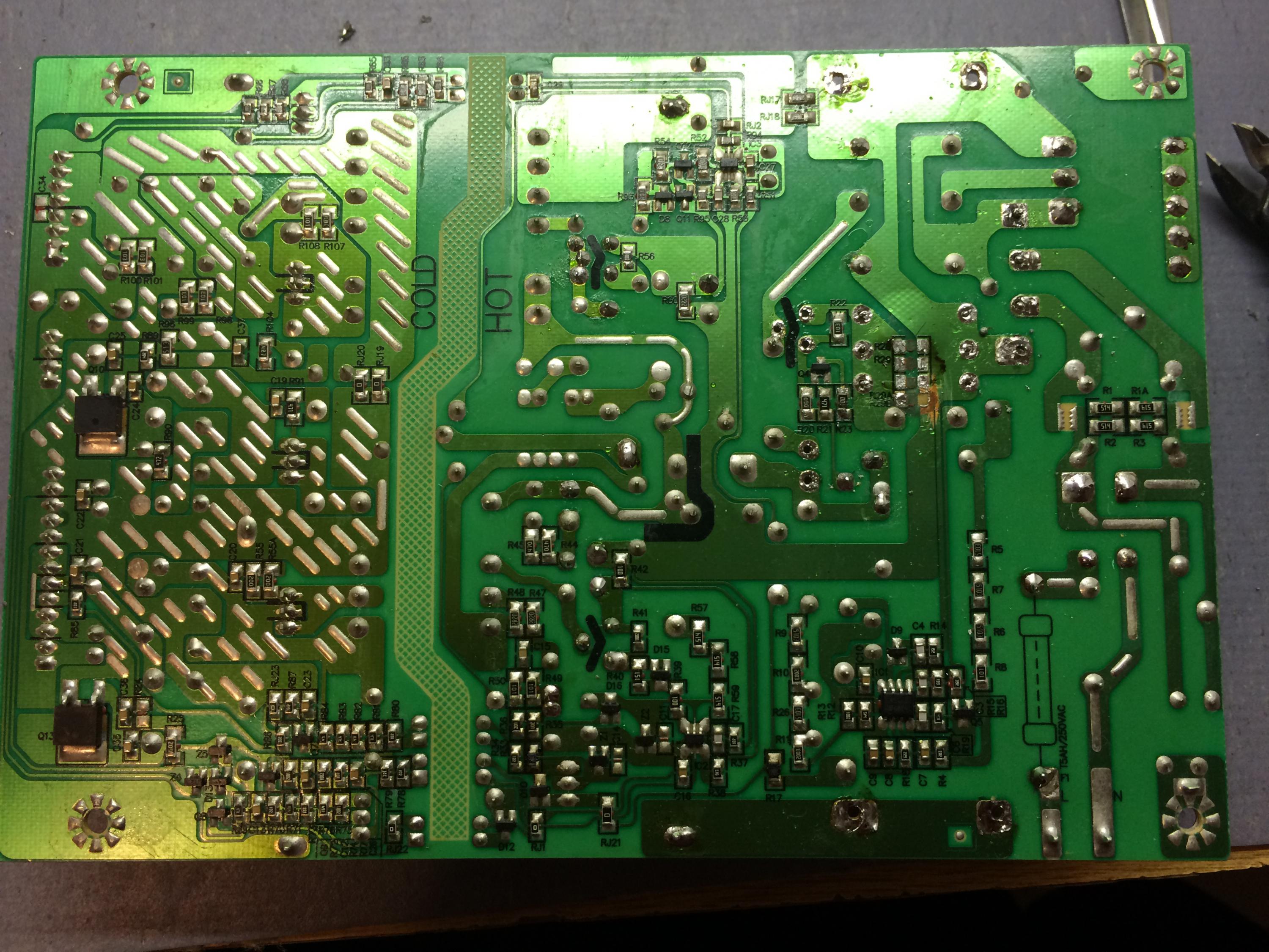

    Hello, i have this AKAI LCD TV that was burned. I found that mosfet was open and it burned. The bridge rectifier was shorted in AC, shorted 3 x1 Ohm resistor and 4 x 20 Ohm SMD resistor. I replace them and TV show red light (like stand by light) but it wont respond to POWER button.
    After some minutes i noticed smell, i check it and found that 3 x 1 Ohm was burned (shorted, 0 Ohm).
    I must say that i put different bridge rectifier instead RS405M i use KBU 810, but i do n ot think this will make problem.

            Is this bad steper coil of what ever it is called?
                Is that the board in its current state?

                  Re: AKAI AKFL3254HF1 dead
                  no, i replace resistor that was burned.
                    Just a resistor??
                    There are multiple missing components and components that have not been soldered in.
                    There is also a pad torn up
                    If that is that state of the board how do you expect it to work?
                      Those resistors are connected in parallel so the resistance will be very low, so did you check those 3 large resistors off the board, they usually go open circuit when too much current flow through them, they are for the Source resistor for the power MOSFET for the PFC Voltage booster circuit. Did you check to see if the MOSFET has Source to Drain shorted out. Without working PFC Voltage booster circuit, you will not have 12V/24V due to the circuit needs the boosted Voltage to operate. More likely the PFC IC controller is also damaged.

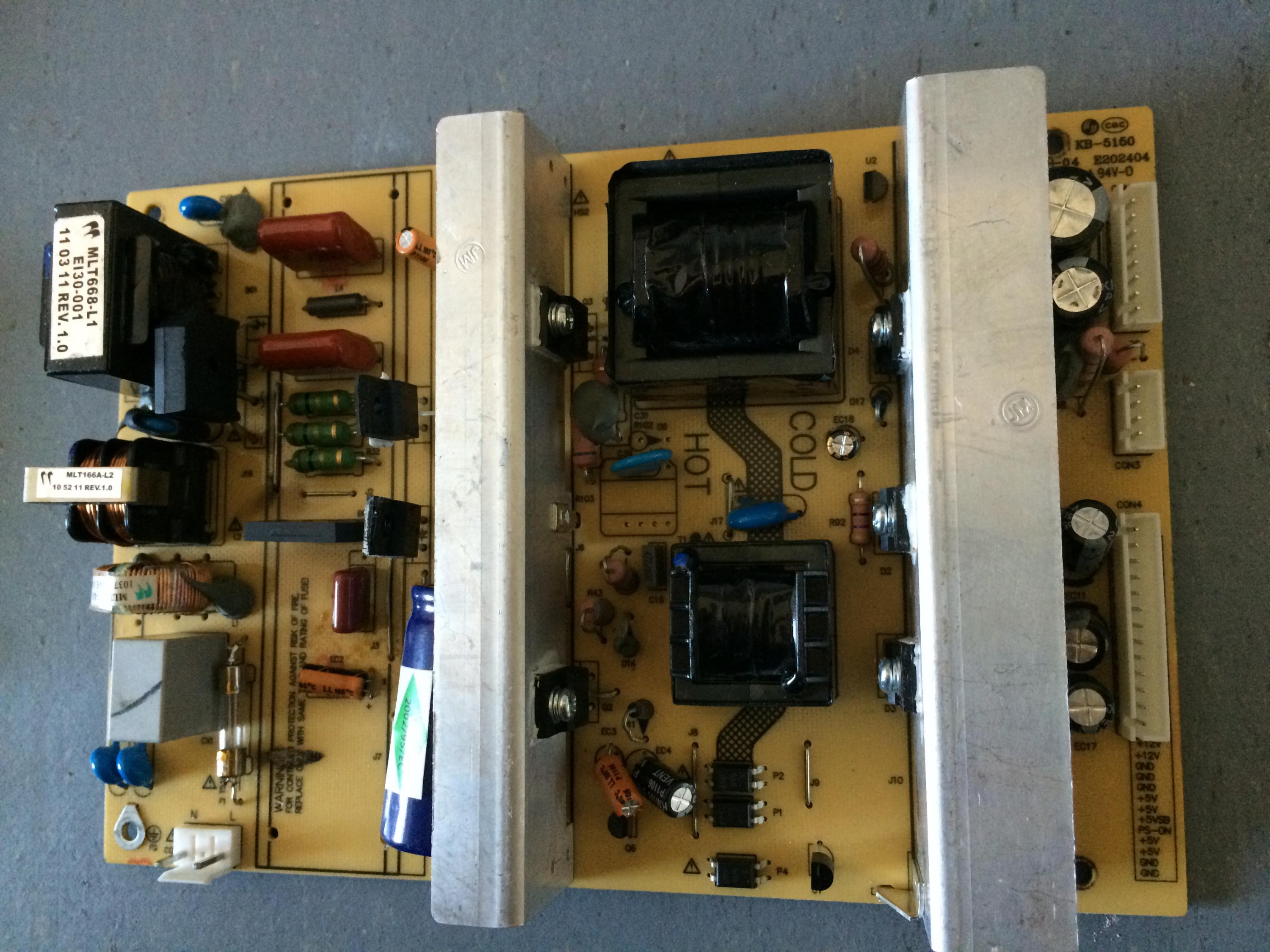

                        Originally posted by newtothis
                        Just a resistor??

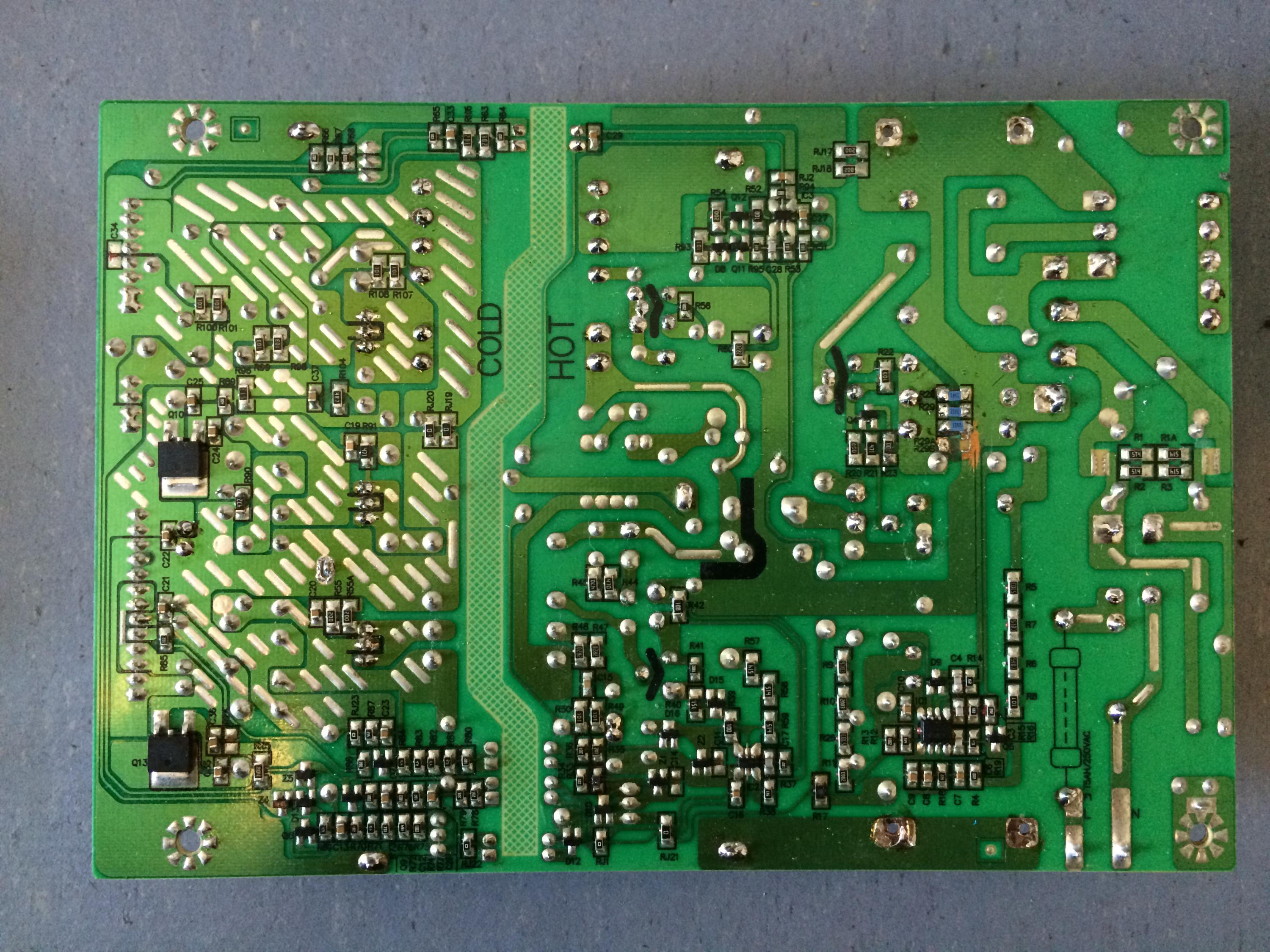

                        no i just use the old picture, this in new one

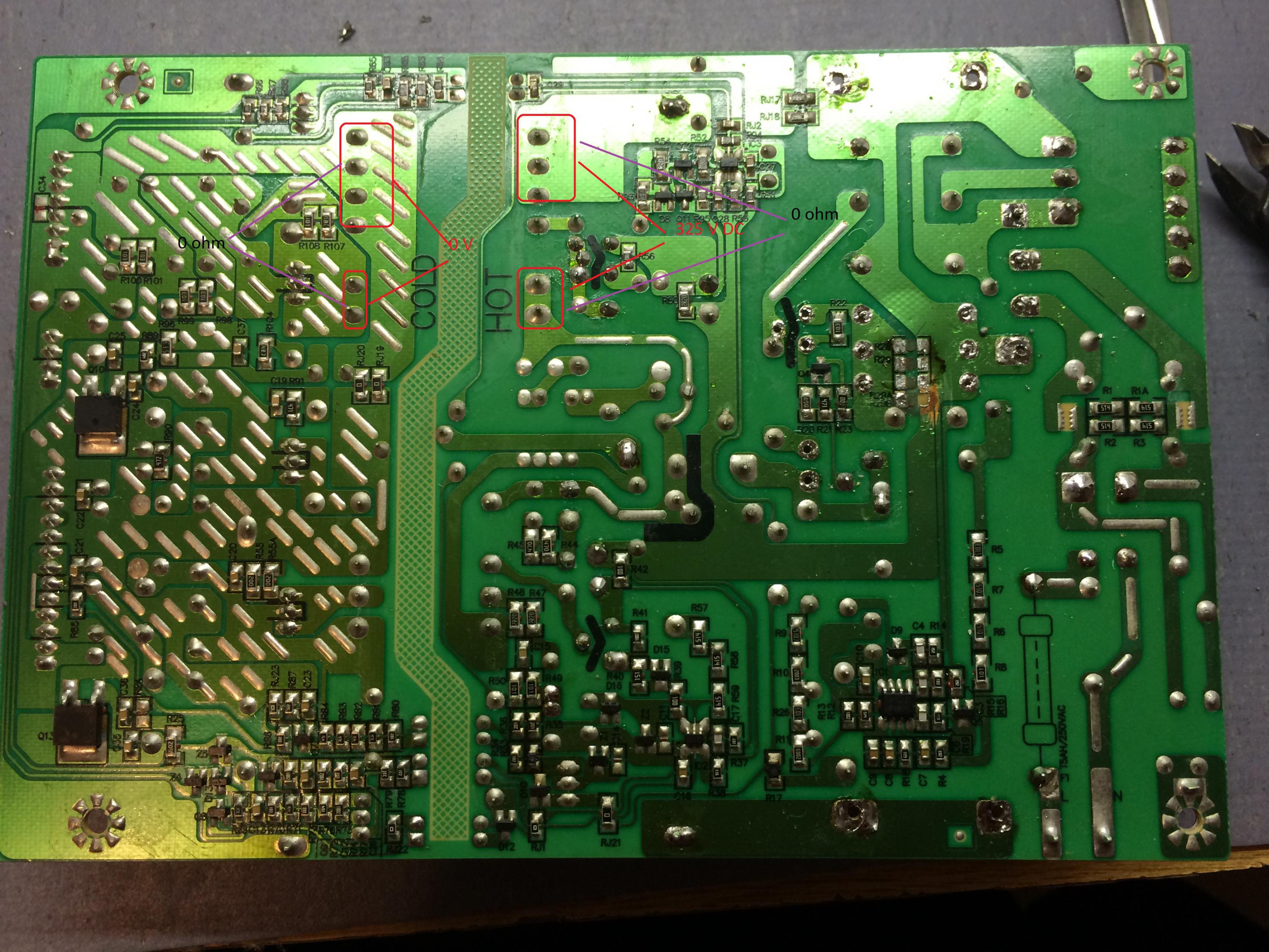

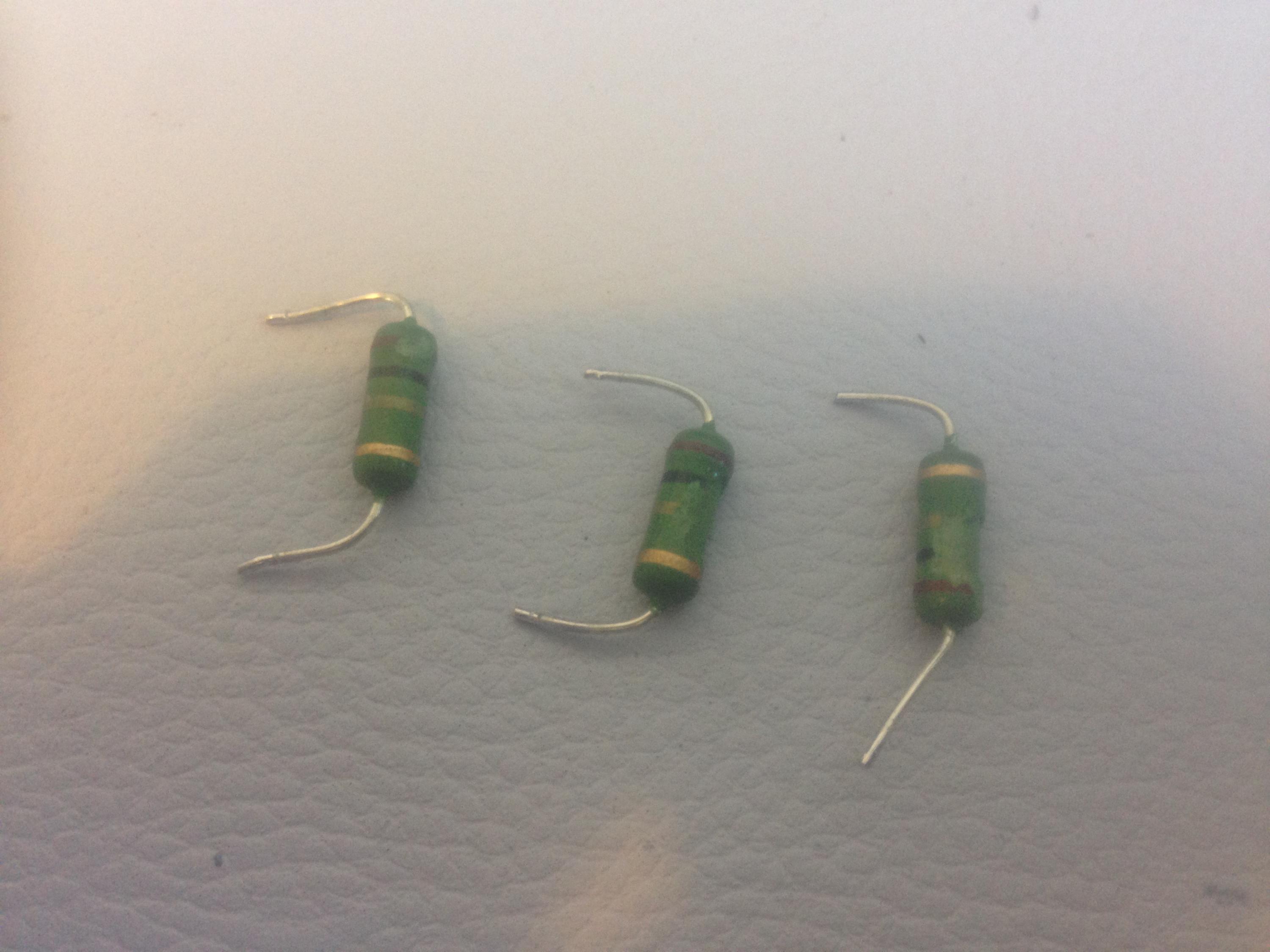

                          In first when i got the TV those 3 resistor wehe dead, MOSFET dead (shorted), i repalce 3 resistor with new one (1 ohm) and new MOSFET MDF13N50.
                          Now i take these new resistor away from board and they still show 1ohm resist but look on the photo what happen to them.
                          Can you point me to PFC IC on the board? how to check it?
                          ...the quieter you become the more you are able to hear...
                            When that PFC MOSFET is shorted out, it should have blown the main fuse.
                            No need to check the PFC IC (bottom right 8-PIN SMD IC closed to the main fuse), just replace it, and also need to check the Gate drive resistor/diode/transistor.
