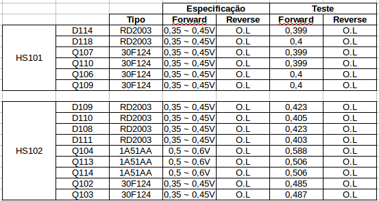

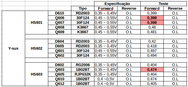

after 3 years my plasma TV is gone. I started some digging before send it to repair, even before I know that it I will come back to me.
The technicians just want to replace every single board in my TV. I can not see the point so I start the quest to fix it myself.
First the symptoms.
It started with RCA, sometimes the image was gone but with sound, the power cycle fix it, or even changing TV source. So far so good.
After, HDMI faced solarized picture (negative picture like). Power cycle was handle it. Strange it may sound, the menu had perfect colors.
At least, no image more. When I power I can see the plasma trying to lighting but going dark after.
The power source is ok.
The Y-sus is doing a smooth buzz noise.
Soon the tv enter in error mode the noise is different
I bought a new Y-sus, mounted it and worked fine for 10 minutes and again, the image is gone.
I asked for a EBR69839001 Y-sus and the seller send me EBR69839002. They were identical.
Some people told me to change Y-sus and Z-sus, but I read in this forum a person who made that and lost the two boards.
Well, I tested every cap with multimeter and the board shorts. Nothing found.
I can also identify a blinking error pattern in the T-con, but couldn't find the service manual.
I tried to remove the LVDS cable to check some picture or image and nothing.
Checked the buffers as well and nothing.
I have a scope and want to check with it, but I really need some guidance now. I did the basic which was possible with some reading. Now I need to get mad.
Please, anyone?
