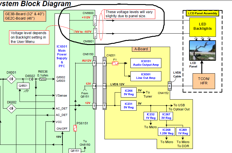

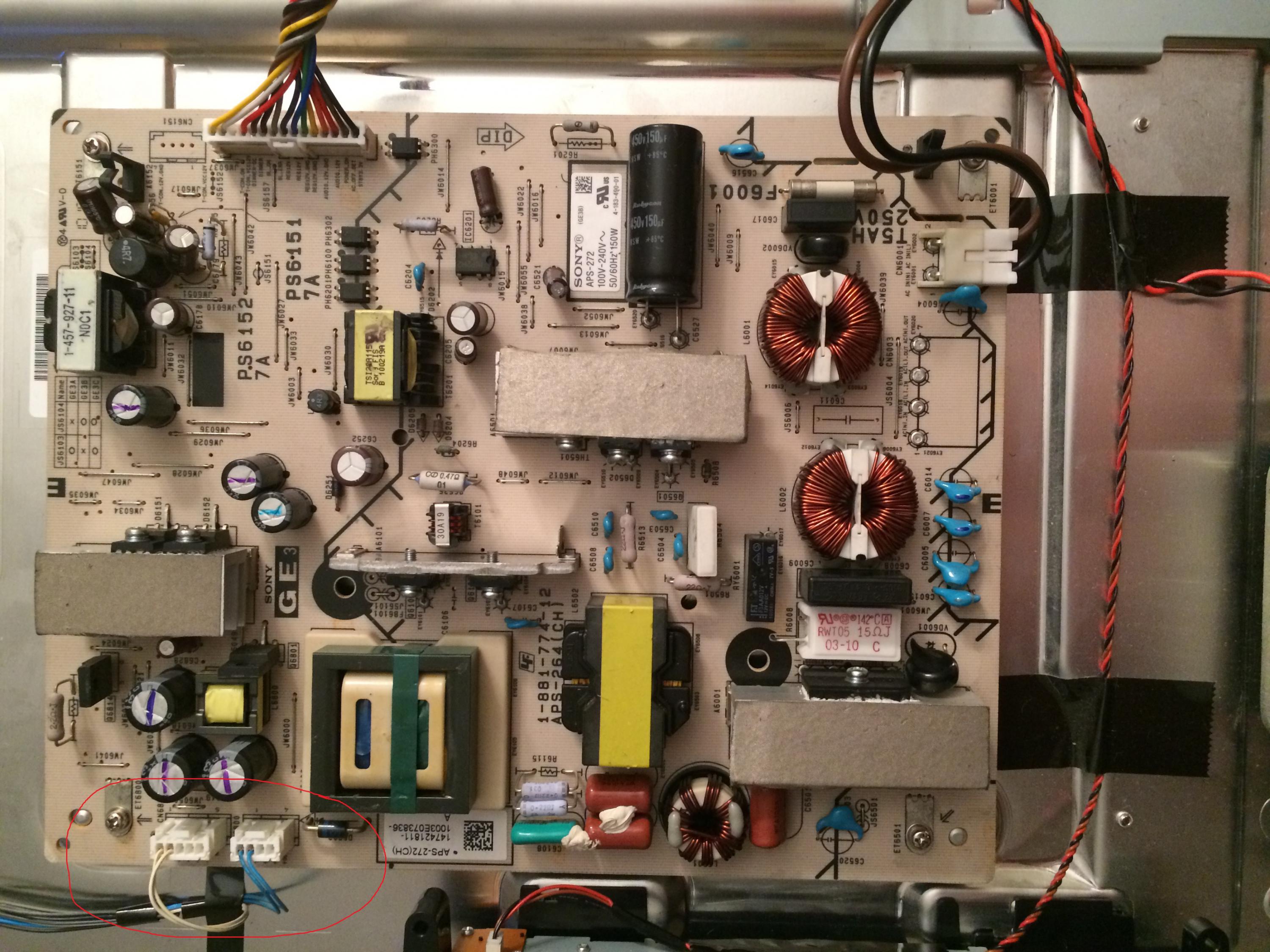

            Also i tried jumping the back lights on and i am not getting the high voltage power to the back lights. I attached a diagram using amnol handy manual to show you were i am taking my reading (circled in black). Also a pic of the same connectors circled in RED in the second picture of my actual PS board.
            Thanks for all the help!
              Re: New Power Supply and Main board Still No Power
              There is a concern that you still do not get the backlghts when you force on the backlights.
