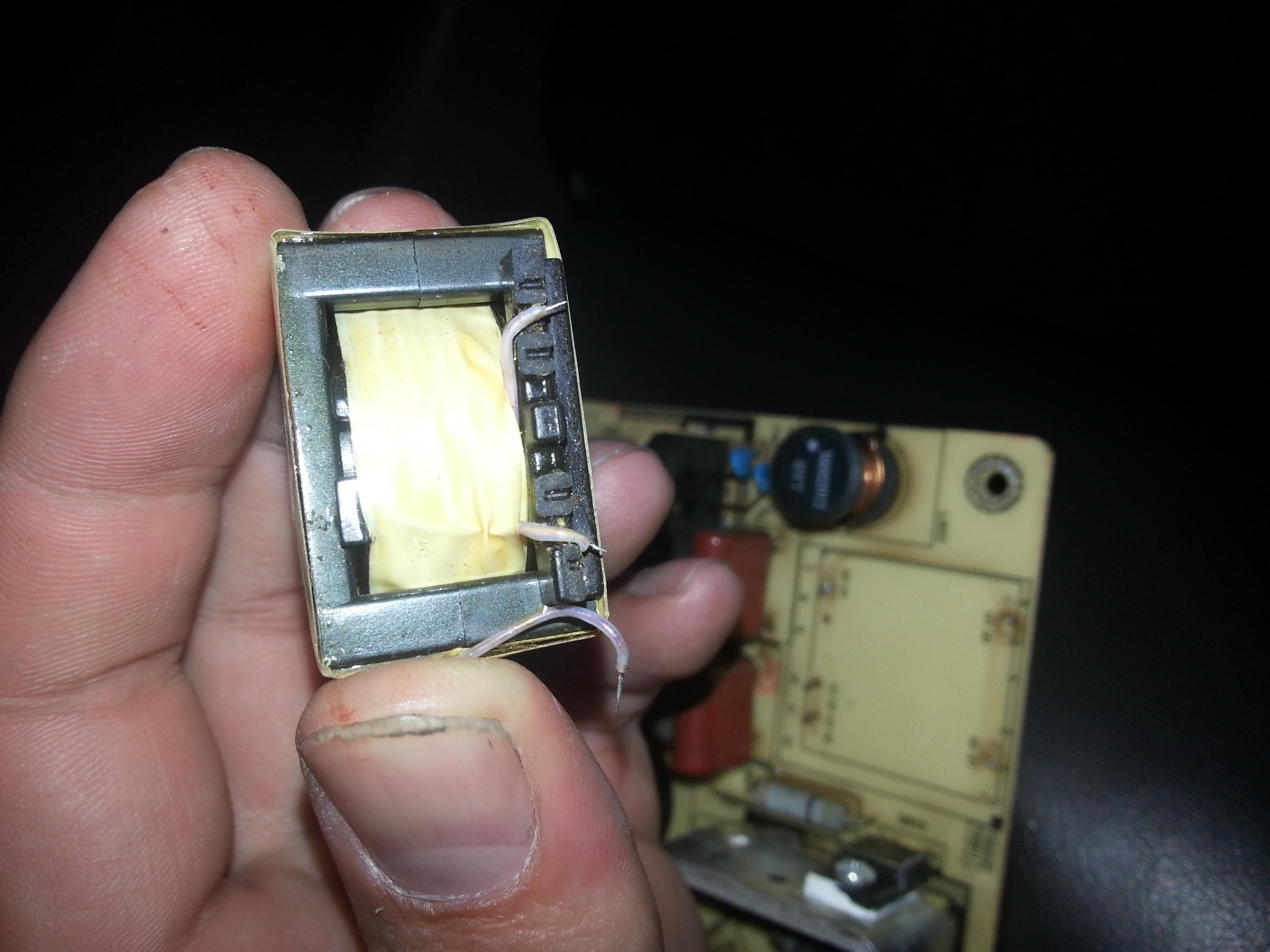

    was replacing some caps on this board and it decided to fall of the side and broke the transformer off could I repair the transformer or is a replacement needed? im not to sure where the wires go has anyone got any ideas? the transformer is30060103 lse lse-b9 1005f3
    • 31298
    Re: 17pw26-4 v.1 repair
    do you have the wires on the other side of that transformer?
    if you do then it can be soldered down.

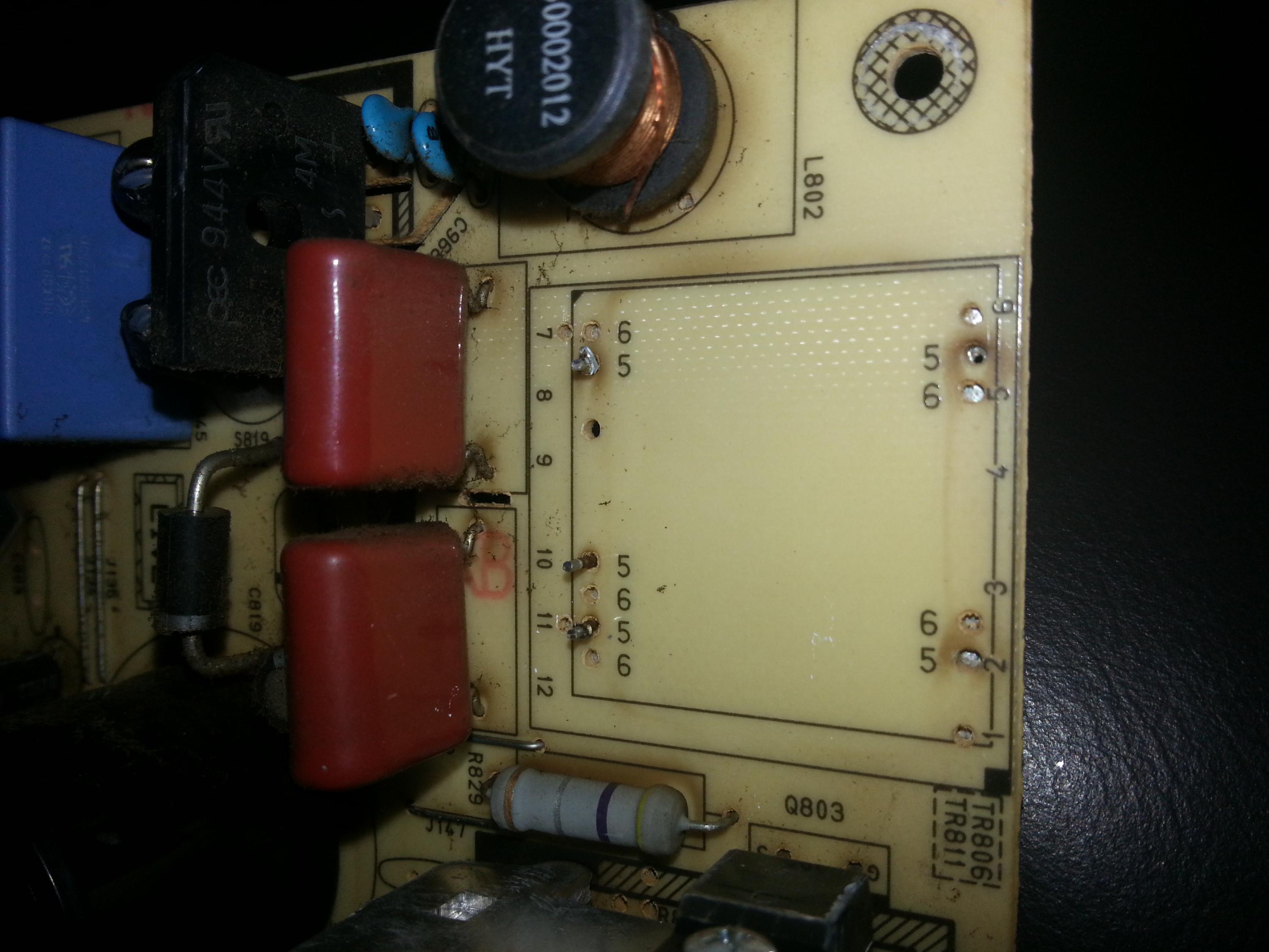

        do the 2 wires go to 5 and the other go on the other 5
          • 31298
          5?
          not all the holes are used.
          look at the pads on the bottom.
            Personally--I would bin that Tx and replace it complete--Seeing it looks as though its the PFC Boost Choke, and would be considered a 'Safety Component'......
            Loads of these hideous POS PSU's around to pull one from!
                          No, there won't. It's a custom part. Transformers and PFC coils are almost always custom parts.
                          Trying to get another part to work on there is likely to result in tears/fire/electrocution.
