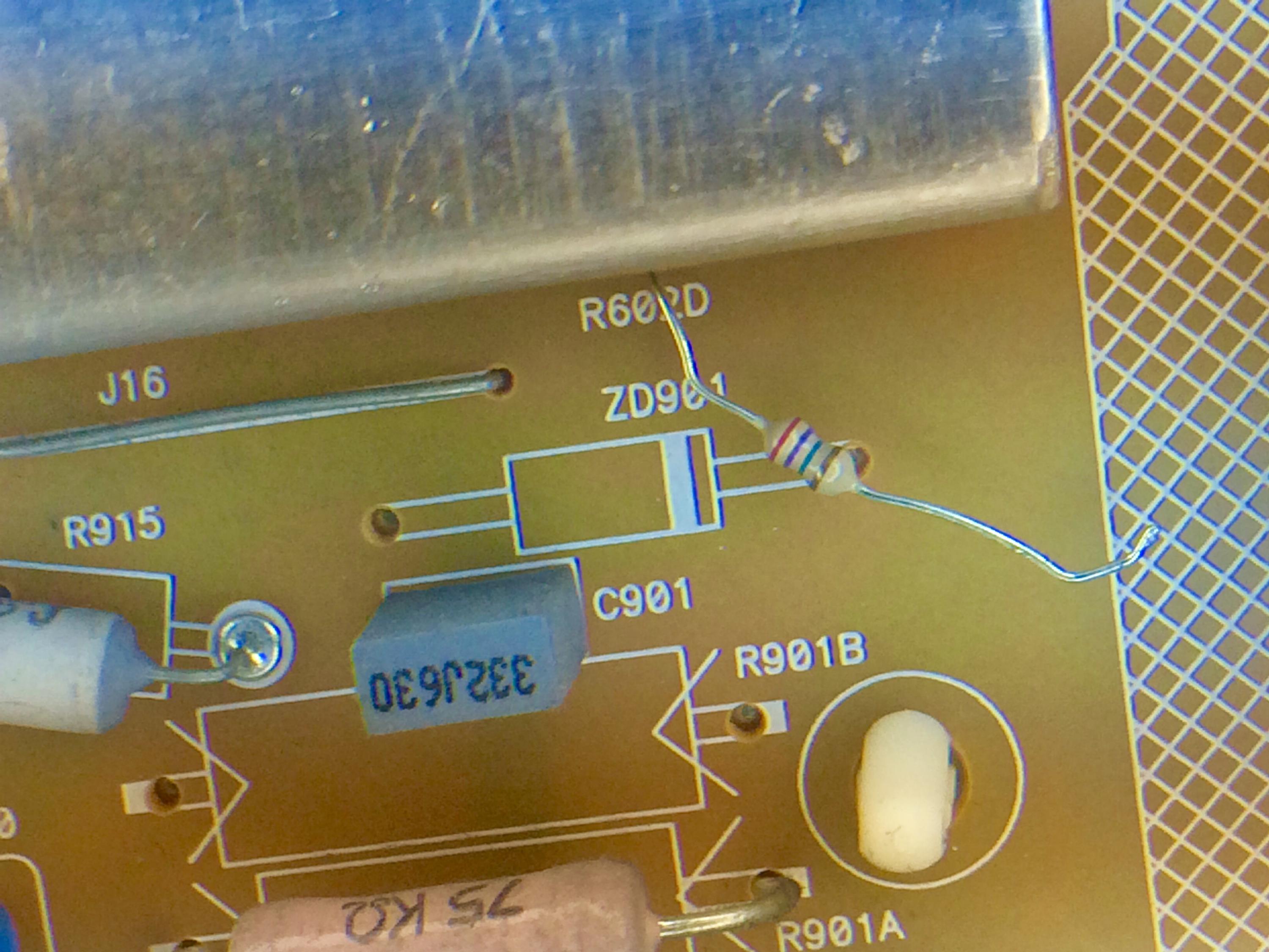

                    #29
                    Re: Sony KDL50EX645 Six Blink
                    In case anybody gets confused like I did. Here is a picture of R602D
                      #30
                      OK, I see now, 602A ~C are SMD, R602D is through-hole resistor under the heatsink. It looks like 2.7M Ohms.

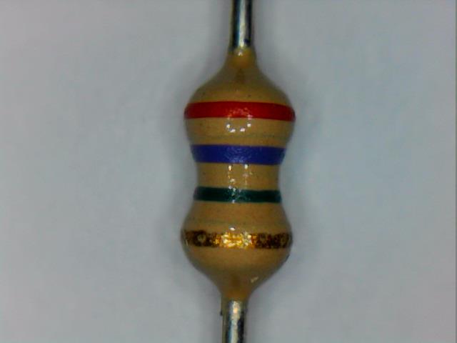

                                Does anyone know the actual value for R602D? I pulled the part to confirm it is open, but I am still undecided on the actual value. It appears to be Red Violet Blue Gold, which would make it 27 meg. The others R602A,B,C are SMD and marked 2704, so 2.7 meg.
                                And here is a Spanish speaking gentleman saying it is 27 ohms, but I know you can't believe everything on YouTube
                                https://www.youtube.com/watch?v=r94EW6CuJmo
                                Edit - Nevermind, I seemed to have missed page two which seems to identify this as a 2.7 megohm resistor.
                                • RDC55
                                  • Dec 2017
                                  • 180
                                  #36
                                  Nevermind, I managed to not see page two and the consensus seems to be 2.7 megohm.
                                  I attached a pic (best I could do) and it looks like Red Blue Green Gold
                                  • dick_barton
                                    • Aug 2015
                                    • 6643
                                    • Wales
                                    #37
                                    Strange, but it looks like 2.6 Mohm. Middle band looks blue in your photo.

                                      #38
                                      I guess it just depends on the light - under a bench top microscope the second band appears to be violet, but the third band looks blue. The photo was taken with a digital microscope and video captured, and I agree the second band looks blue. I am going with the 2.7 meg since the SMD R602A,B,and C are clearly marked 2704.
                                      I guess out of curiosity as I didn't see it addressed in this thread is why is the resistor opening and is it offering some protection because of some event? It seemed odd that they used 3 SMD resistors (3mm x 2.2mm) and then the oddball through hole at what appears to be 1/8 watt.
                                      • R_J
                                        • Jun 2012
                                        • 9625
                                        #39
                                        I suspect they used a through hole resistor because of the distance to pin 5 of the ic, They likely could have used another 2.7m smd resistor and then a jumper wire.
                                        They often use a few resistors in series when connecting the high voltage (385vdc) from the main caps dc to an ic. likely to provide some arc protection.
