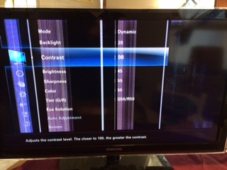

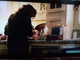

    I have been trying to figure out the source of vertical lines on Samsung LN40D630M3FXZA. The vertical lines do not effect the bottom 2-3 inches. No distortion in that area. The lines are over the menu and as the unit is on will migrate some, but that seems to be dependent on the intensity of the image on the screen. I have noticed that when I turn down the contrast to 50 the vertical lines will disappear once I exit the menu. Bright white images in menus will cause the vertical lines to reappear above and below the white image. Also shows up on bright app screen of apple tv. But playing movie with contract down it is almost normal. Has some thin lines in image except bottom 2-3 inches.
    Replaced t-con board. No change. Not sure if bad panel or main board. The only other person I found on line with problem said it was bad panel. But one person told him it was bad soilder on main board.
    Any help narrowing down problem would be appreciated.

    Bad panel by the looks of it.
      Re: Samsung LN40D630 Vertical Lines
      Agreed, another dead Samsung LCD panel. I have an LE40A656 at home which does this, turning down contrast helps.
        +1
        Bad Panel
