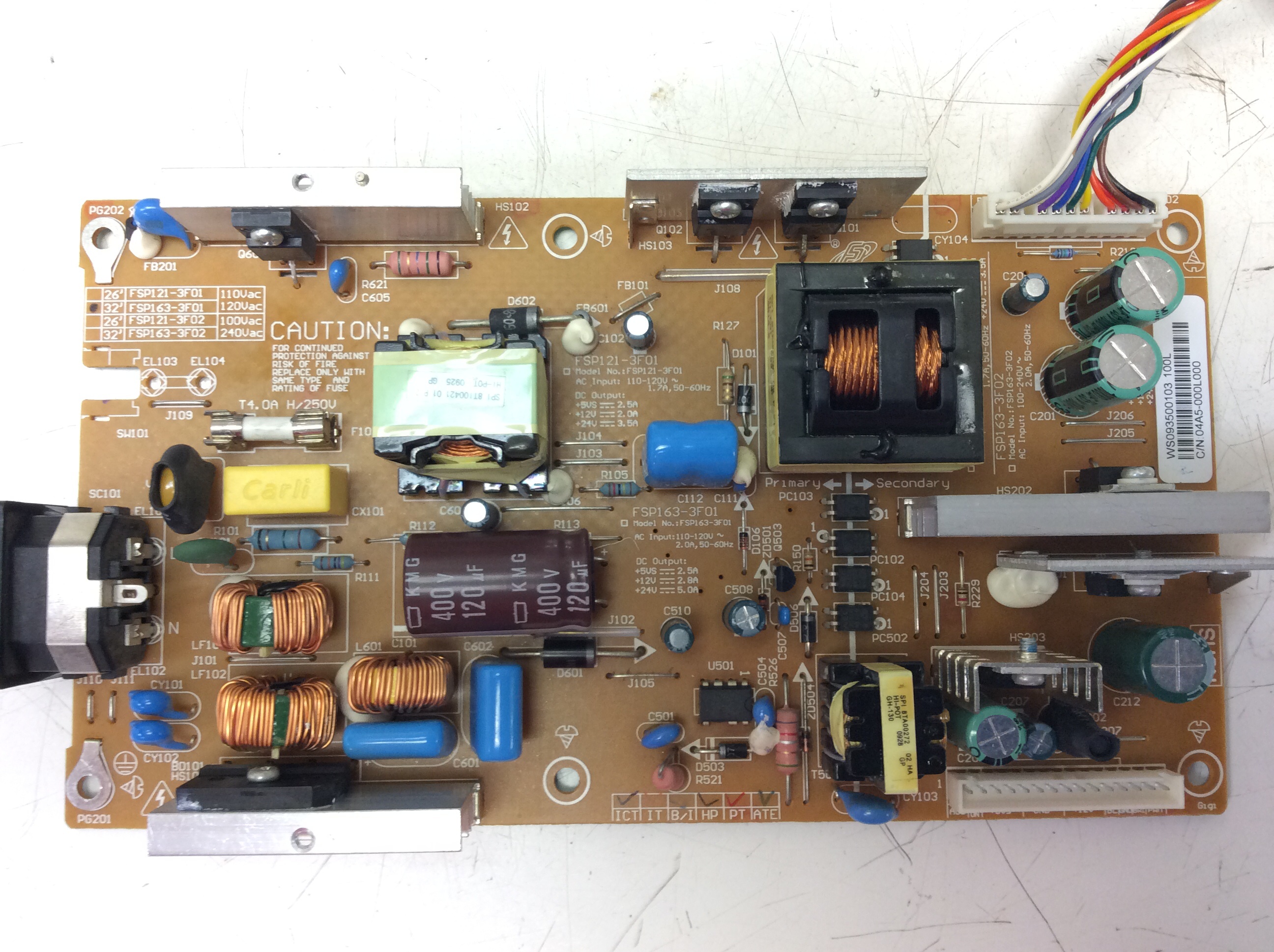

    I have this tv, that will not power on, and has no backlight. I have no readings on the main cap, which is 400v. Any help would be appreciated before I buy another board from shop jimmy.

    Re: Westinghouse 32h640g

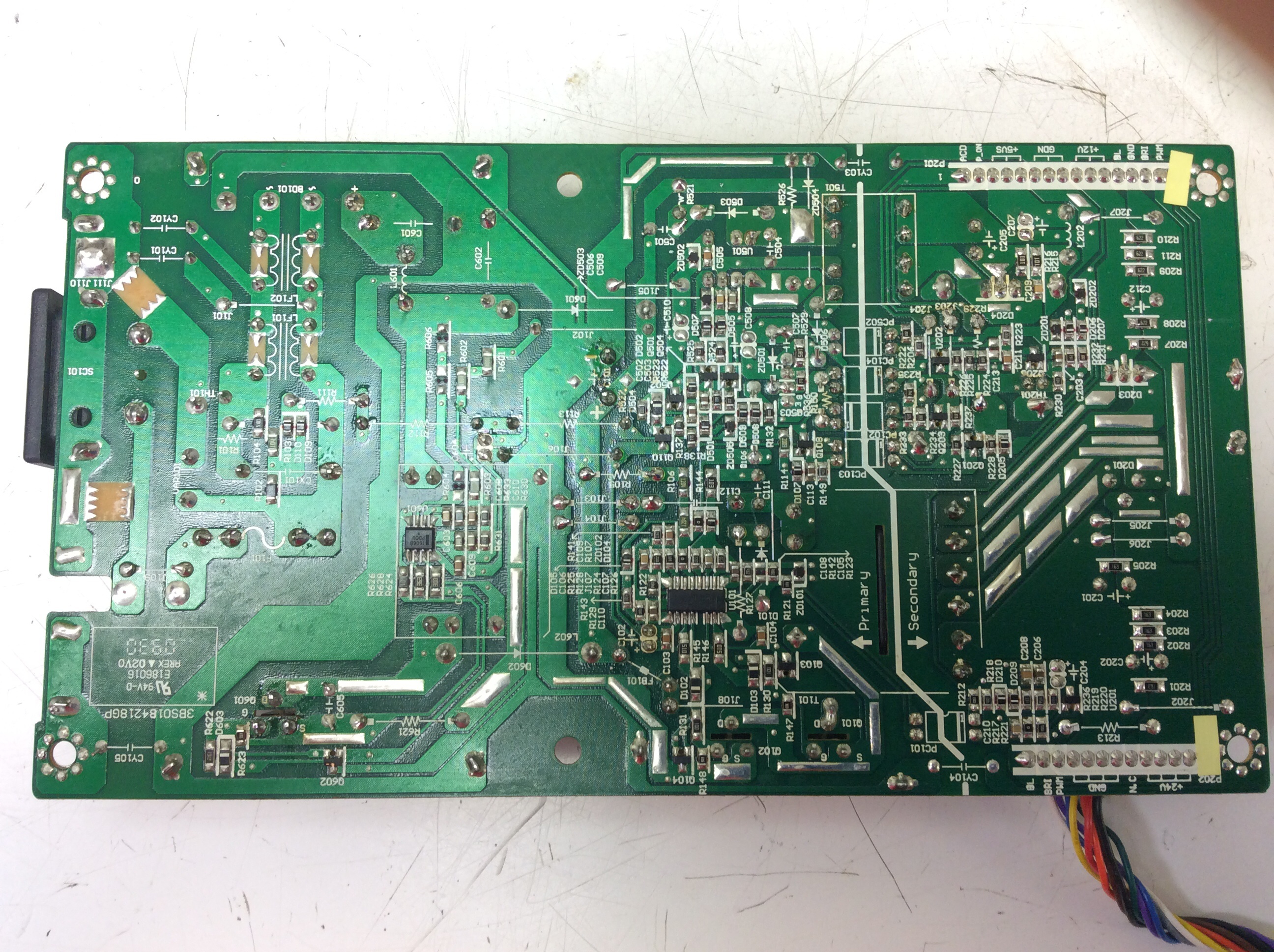

    Pictures of your boards please and overall layout.
    How did you test the cap?
    Fuses ok?

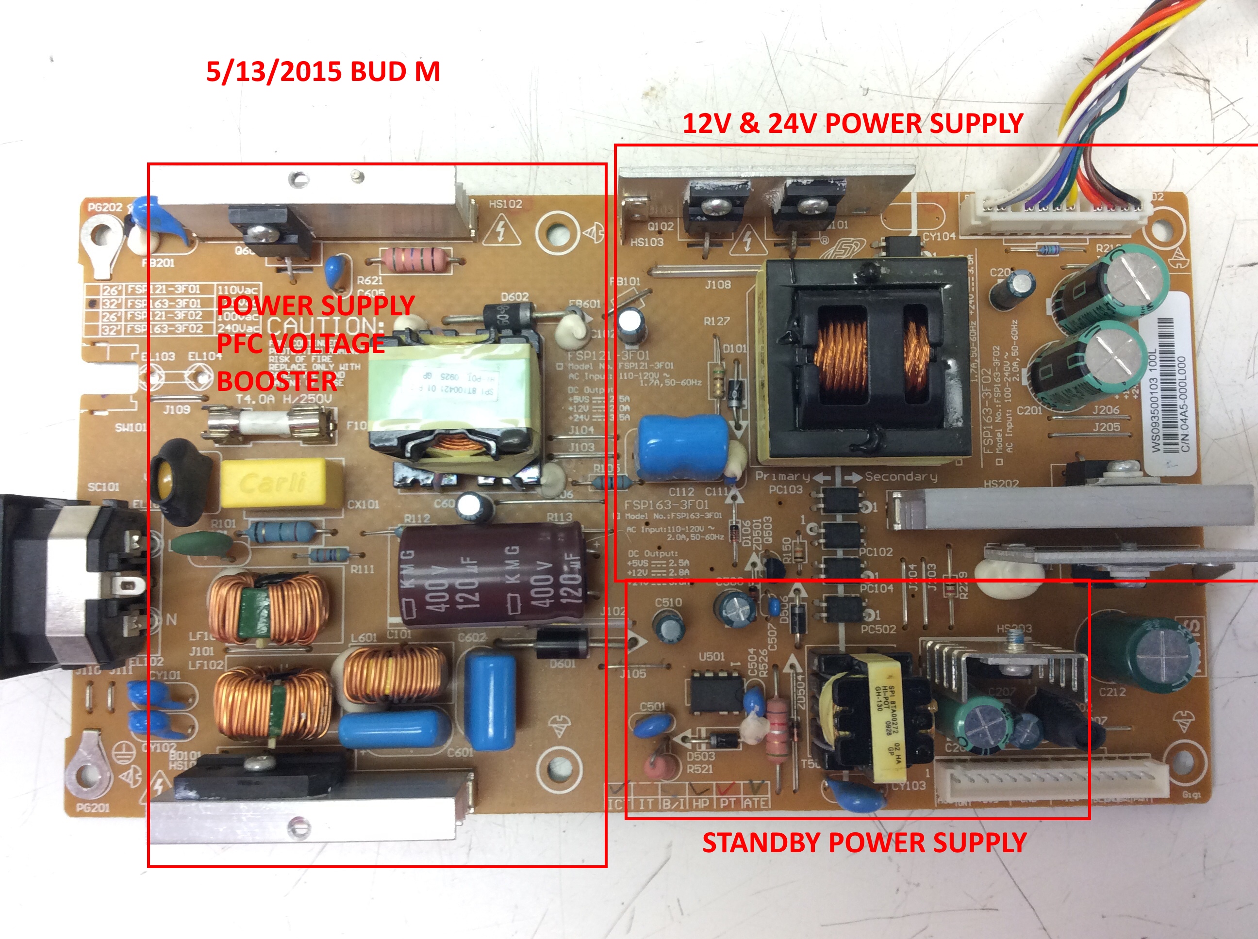

        Need picture of topside of PSU too please
        • ben7
          Capaholic
          • Jan 2011
          • 4059
          Originally posted by junkmale172
          Fuses checked out fine, had meter set on dc negative lead to negative to cap and positive lead to positive to cap
          Could you either get us a pic(s) of the two connectors on the right hand side of that image, or tell us what pins are labeled what? (Hopefully they are, looks like they might be, but I can't tell)
          Edit: WHOOPS, I read your first post as "the main cap has 400V on it", but after I posted I saw you said that it doesn't have any voltage on it, but it is rated for 400V. I must not be awake yet
          See that green thing below R101? (left hand side of the image)
          Test that to see if it is open circuit.
          Also, test D601 to see if it is bad.
          -Ben
            Ben beat me to it with testing D601.
            Can you just confirm you have voltage at either side of the main fuse?

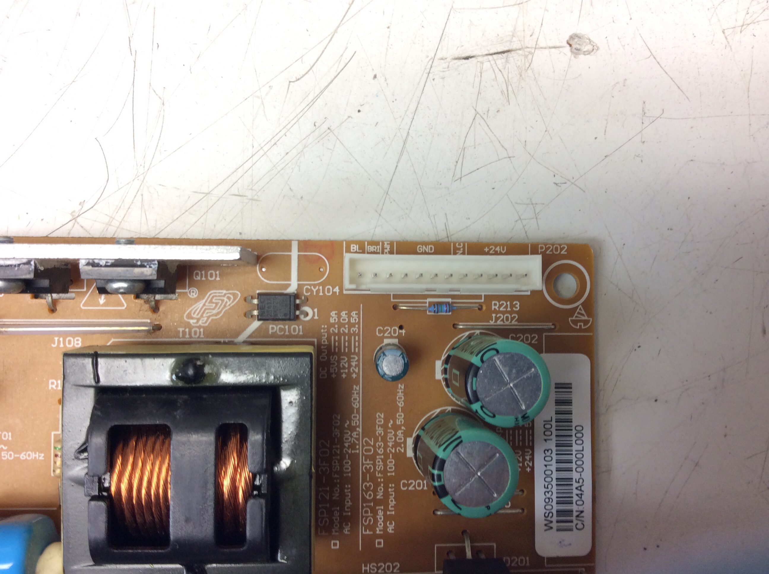

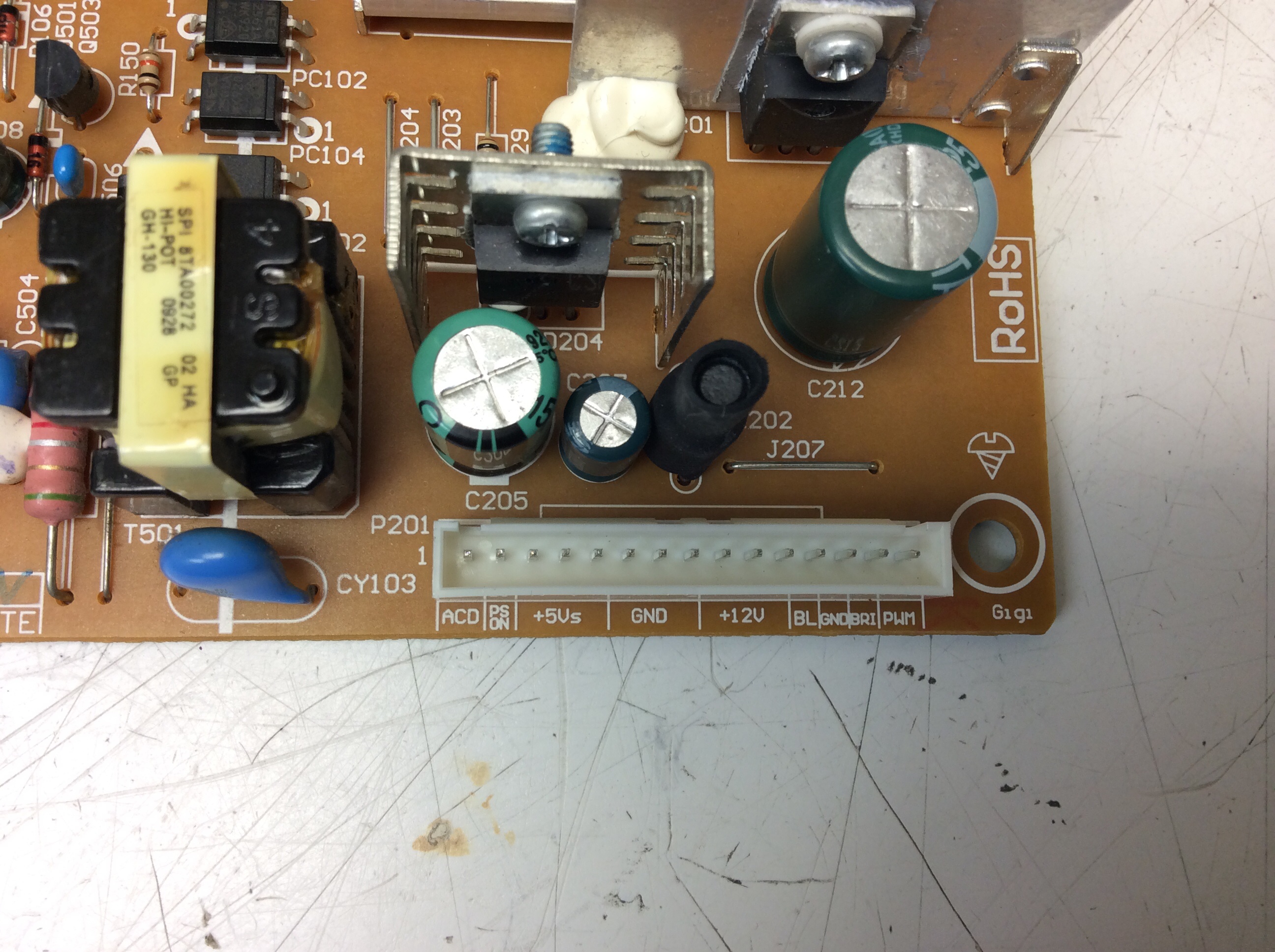

                Please also show the closed up pictures of the connectors so can see the labels for each pin of the connectors.
                      OK, thanks for the pictures.
                      Please take the DCV readings of all the pins when the TV is plugged in and when power switch is activated.
                      Please list all pin names and the readings of each to make it easy for to see what are missing.

                        ok update, put power supply in tv, and standby light comes on. Starts off amber, then when I press power it turns blue (yeah), now I have no picture on the screen, upgrade from where I started. These are the outputs from the connectors
                        plugged in amber light
                        acd 3.40
                        p_on .009
                        +5v 1. 4.99
                        2. 4.99
                        3. 4.99
                        +12v 1. 0v
                        2. 0v
                        3. 0v
                        bl .007
                        bri .001
                        pwm .001
                        power on
                        acd 3.40
                        p_on 2.844
                        +5v 1. 4.99
                        2. 4.99
                        3. 4.99
                        +12v 1. .492
                        2. .492
                        3. .492
                        bl 4.91
                        bri 3.232
                        pwm .004
                        this is the connector going to main board
                        • junkmale172
                          • Nov 2012
                          • 41
                          • usa
                          next is connector going to panel
                          amber light on
                          bl .007
                          bri .008
                          pwm 0
                          +24v 1. 0
                          2. 0
                          3. 0
                          4. 0
                          blue light unit switched on
                          bl 4.91
                          bri 3.232
                          pwm .004
                          +24v 1. .007
                          2. .007
                          3. .007
                          4. .007
                            So you are not getting the 12V on connector P201 ro 24VDC on connector P202?
                            OK, you updated the readings, so we do not have 12V or 24v.
                            Do you have >360VDC measure between the two legs of the main 450V filter cap?
                                That is measured with TV turned on? The booster circuit is turned on by the PS-ON which will make the Voltage on the cap jumps up from 160VDC to >360VDC if the PFC Voltage booster is working.
                                The booster circuit has to function for the 12V-24v POWER SUPPLY SECTION to work.

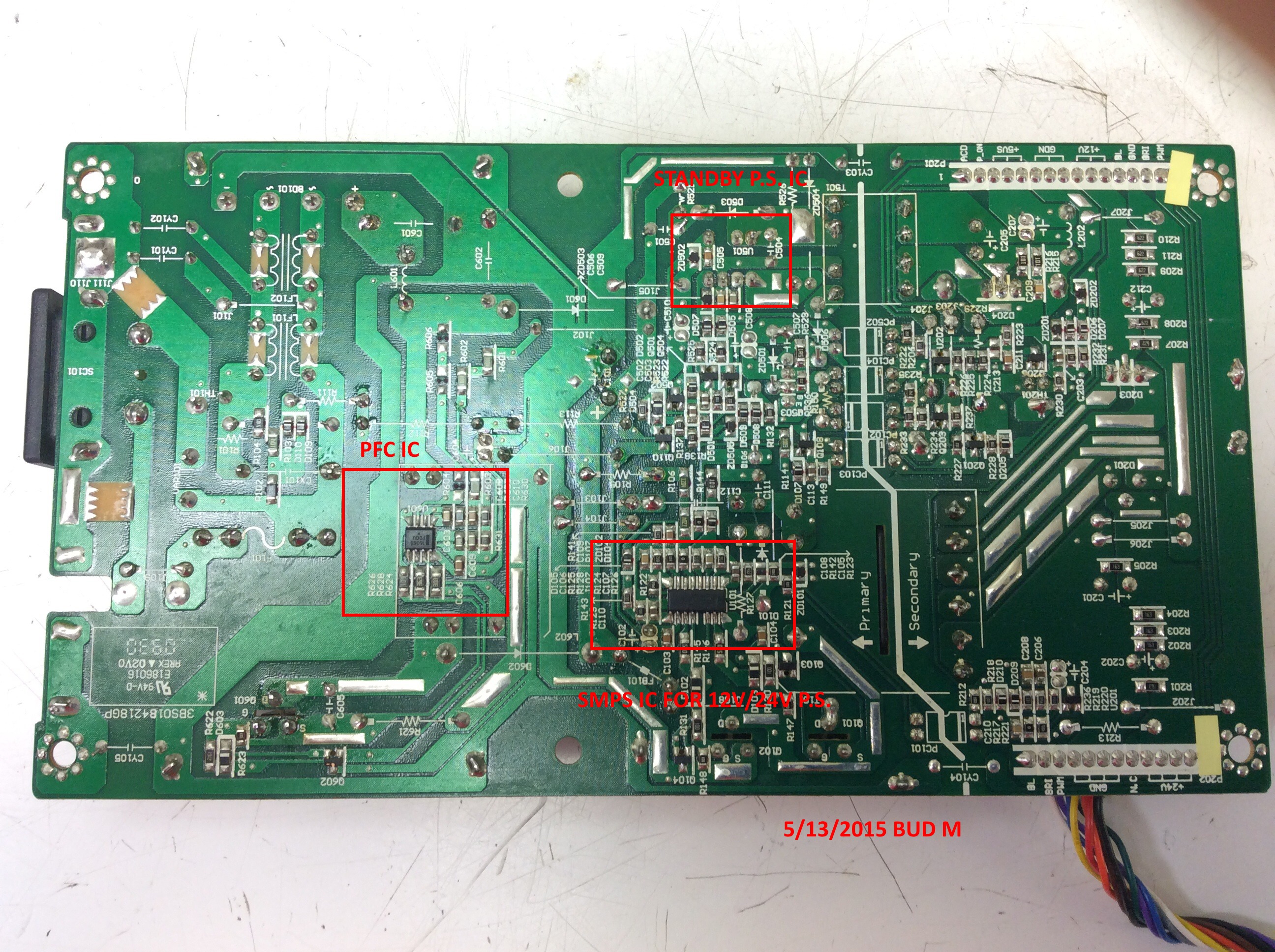

                                    OK, so we need to find out what is wrong with the PFC section first.
                                    So check the PFC Diodes D601, D602 to see if they are OK or not first.
                                    We need the P/N of the PFC IC.
