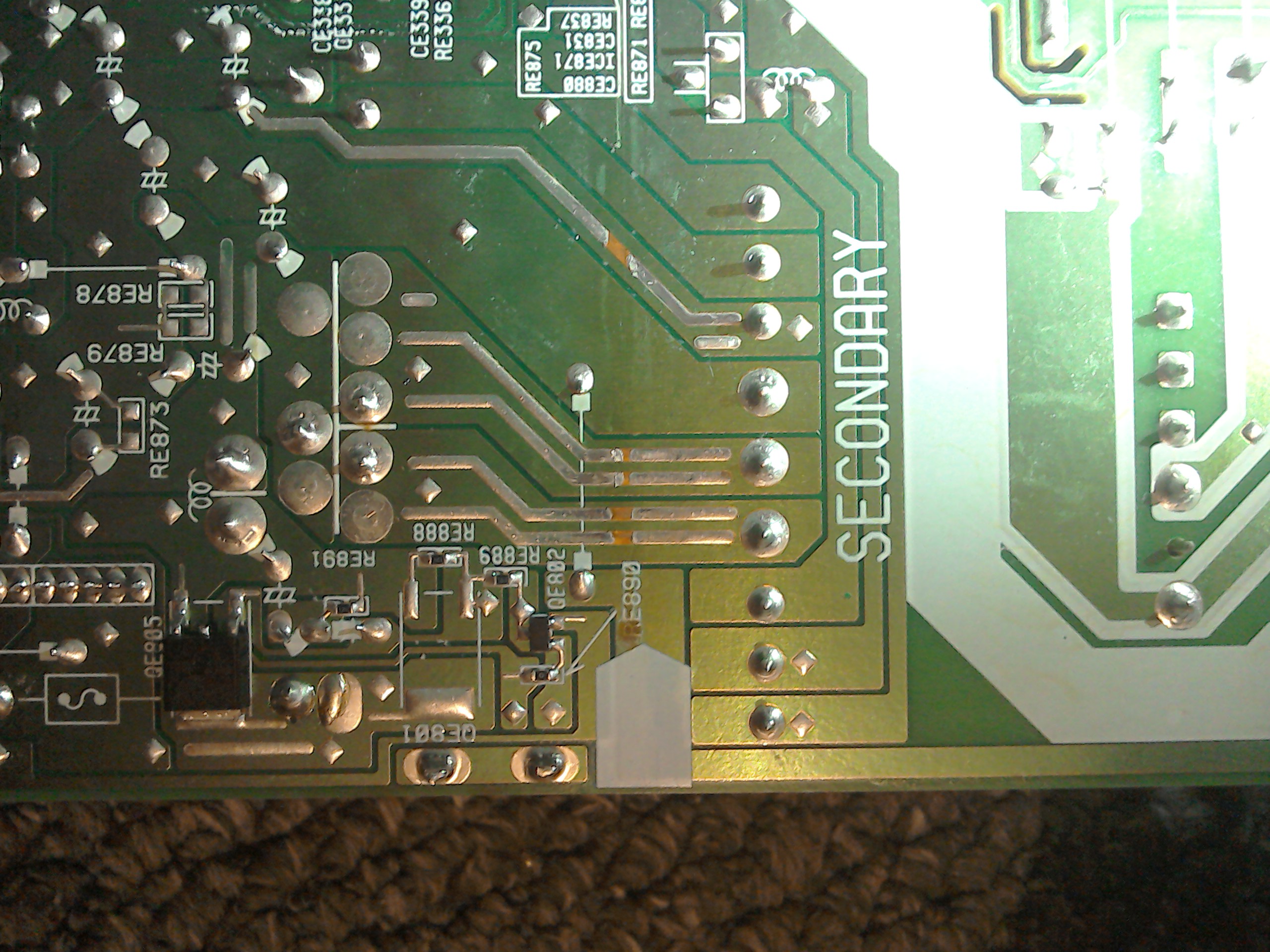

      The link is to the picture of the power board its the solder that just doesn't look right to me it looks like its been broken and I don't want to re-solder it I'm unsure if its meant to be like this or not.

                  Can't seem to find anything like it on google and heating caps didn't work. On the back of the power board there is 5 lines of solder but seem to break up to show a copper colour but also looks like its been scratched off I'm unsure as to re-flow these in case they are meant to be this way I don't want to cause more damage the lady I got the TV from said she had it from new and it just turned off one day and wouldn't come back on

                    Yeah need to see pics, from your description sounds like it might be a slightly botched repair job and the person has lifted the pads and had to scrape down to the copper to re-establish a connection.

                        Re: toshiba 32av555d wont turn on
                        Hope this helps
                        • Hamie
                          • Apr 2014
                          • 1383
                          Got it now, that shouldn't make a difference as the track it's still intact.
                          you could make sure by reflowing it all back together anyway.

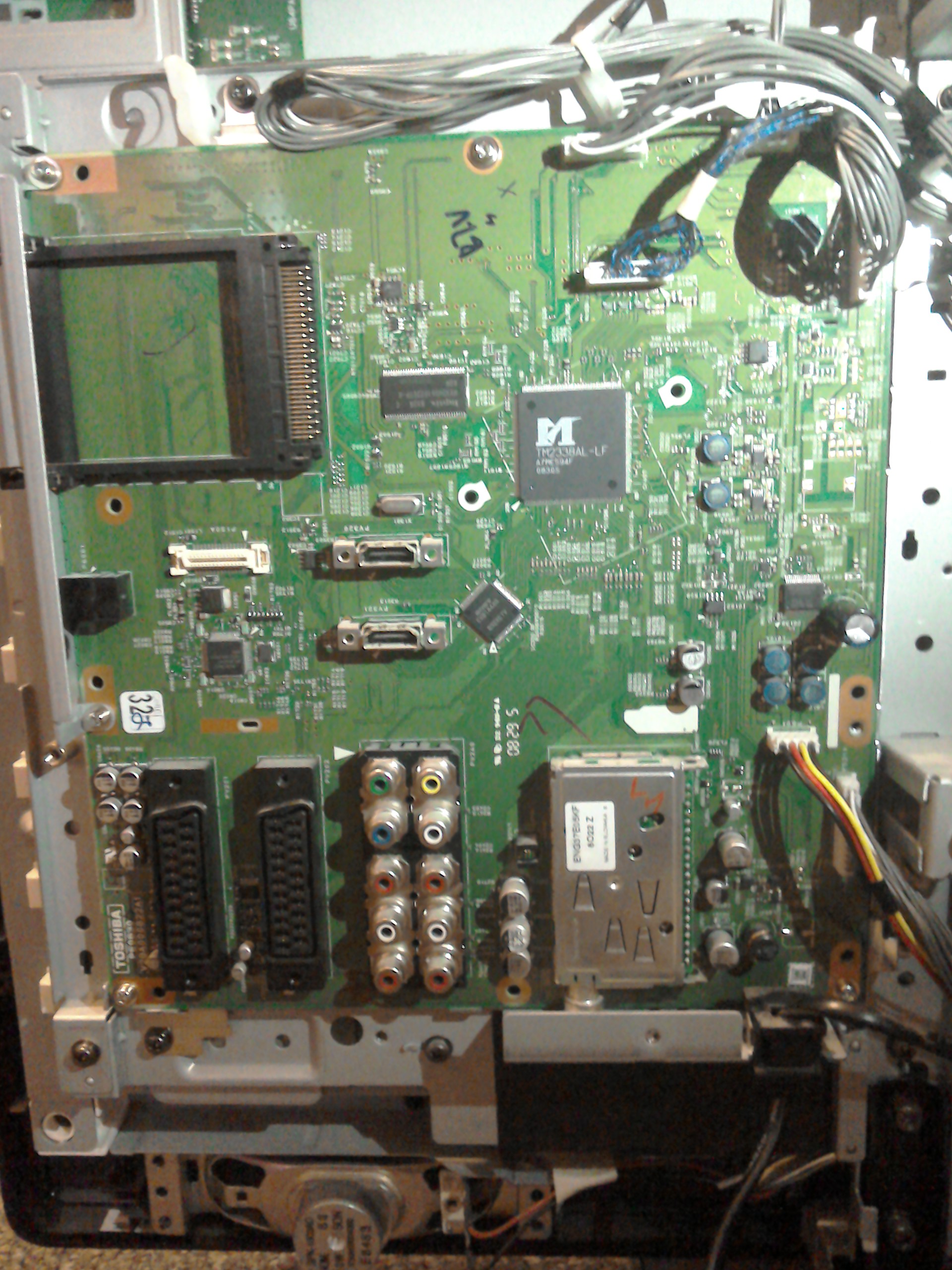

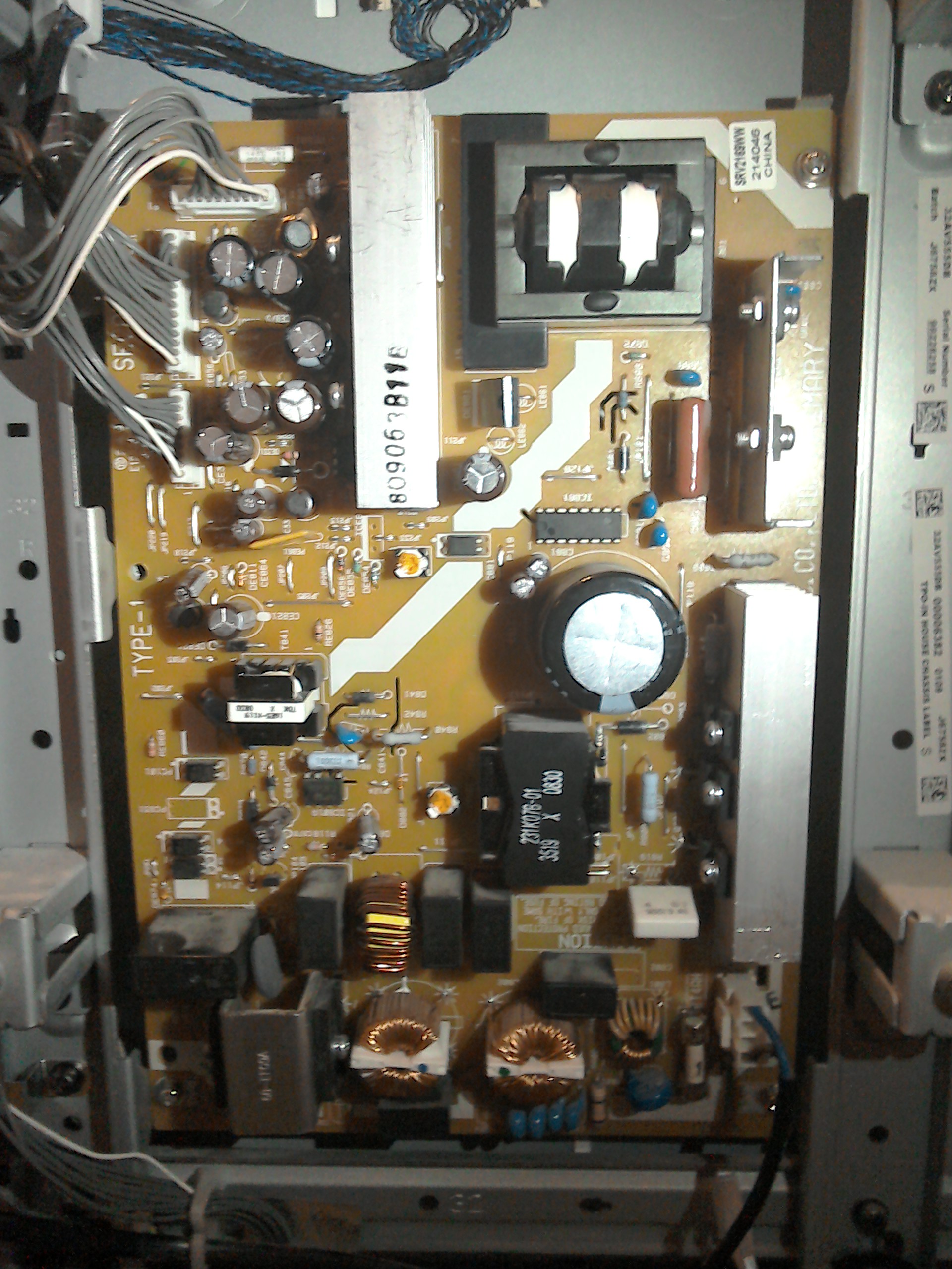

                                  Re soldering didn't work. I borrowed my multimeter out a while back will try and trace it or get a new one here are the pics of the two boards on the back of the tv
                                  • Hamie
                                    • Apr 2014
                                    • 1383
                                    The power supply doesn't have an inverter built into it, so I'm guessing there must be an inverter board under the mainboard.
                                    Really without a digital meter it's going to be hard to workout what's wrong with the TV.
                                    In the mean time, if you can unplug the inverter from the power supply. And see if the TV now powers on. If it does then you might have a problem with the backlight system.
